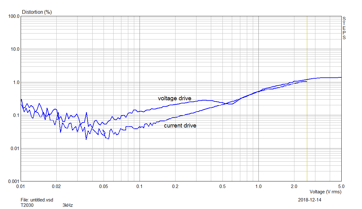

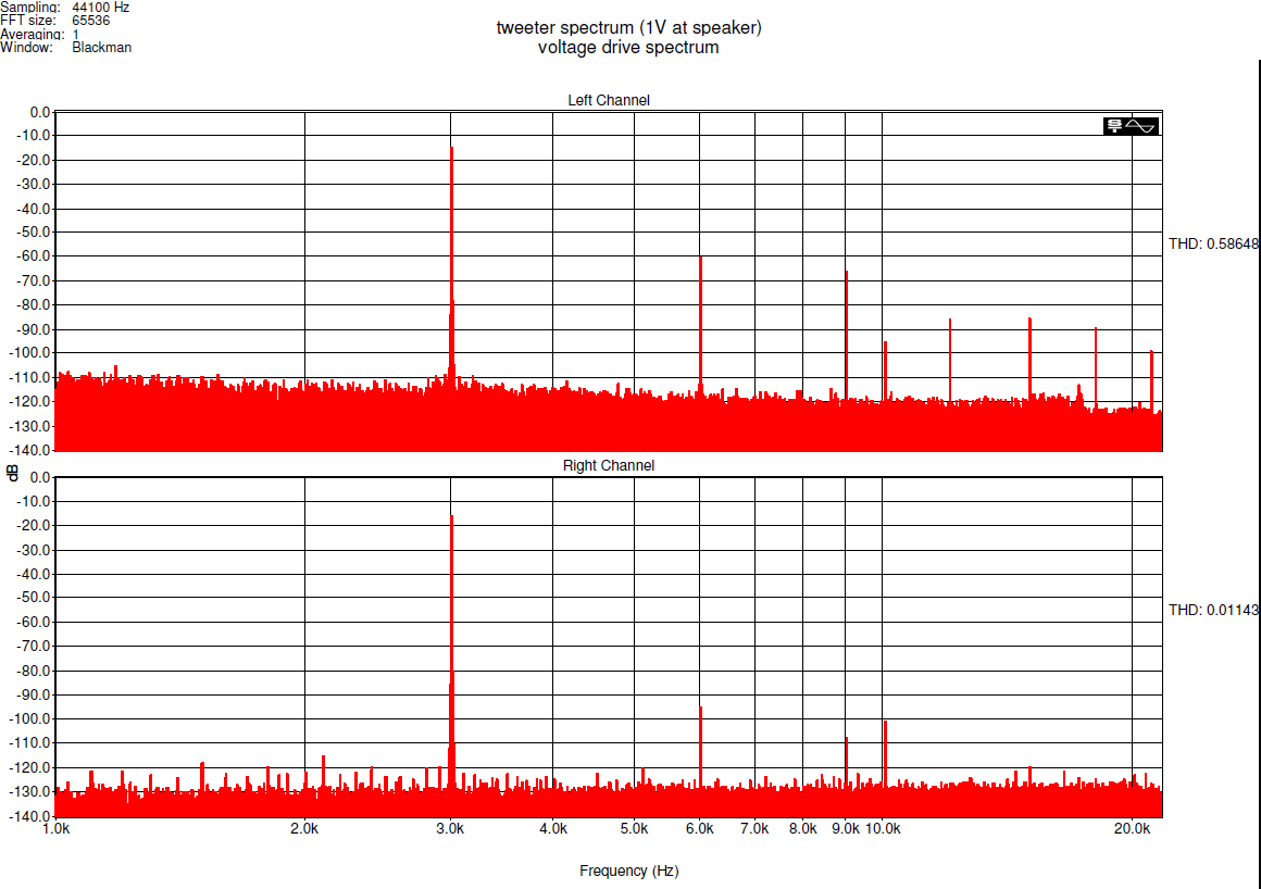

Now with a pure voltage drive, I get almost the same distortion and spectrum as with the current drive. So for this tweeter there is no improvement under current drive. This confirms what I measured years ago, the only notable change was for woofers.

Yes T2030 are, but other tweeters also did not profit from the current drive. T2030 is just the only speaker driver I have "free" and I can use it for the experiment. It was driven directly, no cross-over, and was placed on a rectangular baffle 30 x 45 cm, about 10cm left and top from baffle center.
When making thoughts about speaker distortion, it should be understood that there is not only one transformation in the speaker, but two. Speaker is an electro-mechanical transducer and also mechano-acoustical transducer. So it is not enough to consider speaker as an electro-mechanical transducer. Mechano-acoustic transformation is also non-linear, covering membrane modes, break-ups, etc. This is probably not expressed in the speaker current or in the second coil voltage. The possibilities to reduce speaker distortion by using second coil voltage are IMO limited and I would not expect improvement of 30dB, this is IMO overoptimistic. It is an estimate based on the level of second found in the difference as well as third. I made a mental graph of where the acoustic line would be if h2 and h3 were not there, then raised it the difference between the voltage and the acoustic. This without regard to phase info which is not in the amplitude plot. So it is indeed optimistic.Maybe I am not getting something, but I would be convinced after successful experiment that would result in an usable controlled speaker, I think we have already had quite enough of mental exercises. At some point, they have to be converted into practice.
Here are some of my voltage/current comparison results - measured with a non-distorting microphone, which is essential. The tweeter benefits the least but still benefits. The 3 samples have an aluminum VC former, which according to my observations limits the current-drive distortion reduction to about 15 dB. With non-conductive formers (that is, without their eddy current distortion, that is not curable by current drive), over 30 dB drops are commonplace in third harmonic and odd-order IM products.

Esa,
could you explain this? (in both cases, same voltage across driver).
[microphone distortion is a non-issue in the measurements I have shown, verified by low-distortion sound source]
Have you tested any speakers with shorting rings? With a non conductive former, you should be able to see the modulation of the eddy drag as the vc is behind center position. That would require a current drive of course, as Le(x) would be a confounder.

I don't know why the contention over one set of measurements on one speaker. We all knew from the beginning that current drive works better on some speakers than others. Clearly any single speaker could be perceived to justify or dismiss the merit of current drive but it would be entirely futile.
Surely we can move past "is current drive better?" to "where is current drive useful?".
and sorry I still can't help suspecting the mic. 1% THD at less than 1W is highish.
The same mic measures 0.2% with a better driver under same conditions.
Beyma T2030 is known to be quite poor, but it is the only one type I have uninstalled now. I have 3 pcs and one of them measures >3% at 2V and has sub-harmonics showing cone break-up.
