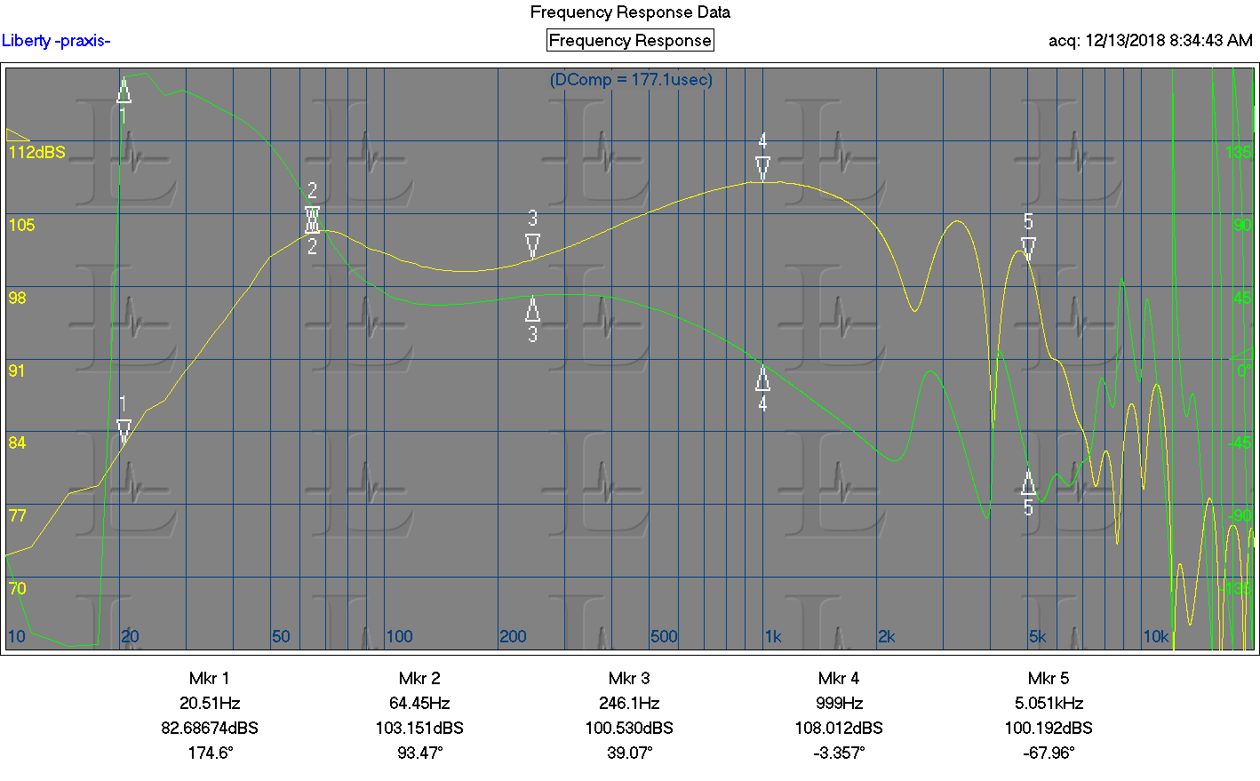

I have a 3886 amp that I'll be hooking this to but not for a few days (or maybe after Christmas the way things are going). I ordered these boxes for the test: Amazon.com: Absolute SQ6.5PKB 6.5" Square Box Speakers, Set of Two (Black) with Speaker Terminal: Cell Phones & Accessories I have a response curve I can post later. It is something of a full range driver.

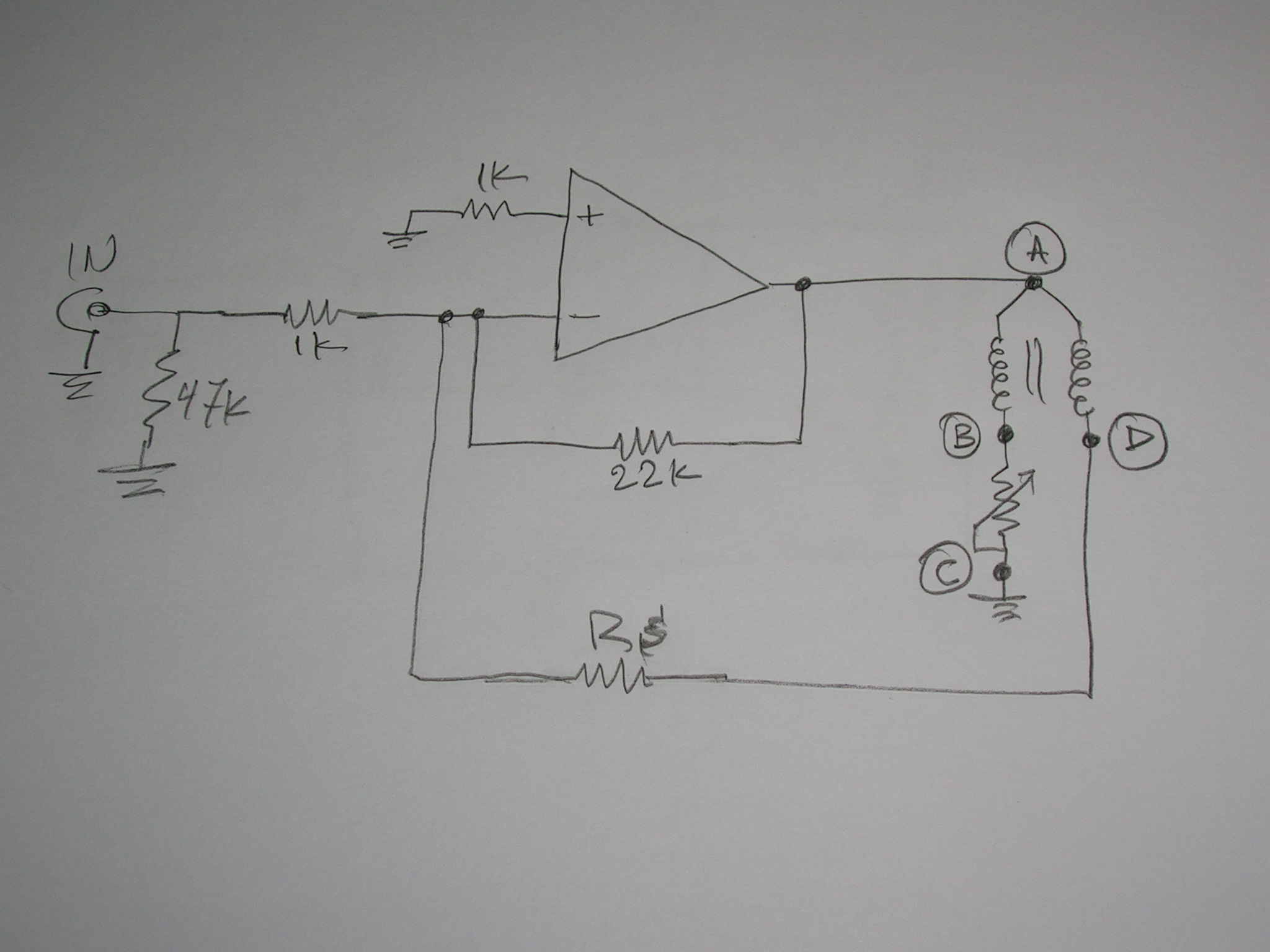

I guess I have to follow this circuit:
John Curl's Blowtorch preamplifier part III
For to make things a bit easier, can I use only one op.amp (the power amp chip) in inverting mode like I have sketched in the attached photo?
If yes, the Rs value should be 1k?
George
Yes. This is what I put in post #11255
If you want to see something interesting, put a pair of diodes antiparallel across your variable resistor and watch the amp attempt to linearize (except, it might kill the amp as it rails into the inductor..sorry). Better yet, put a resistor in series with the antiparallel diodes across the primary, this is to simulate a magnetic non linearity..

Jneutron, am I correct to say that the inductance of the coil is higher when it's velocity is high because it causes the eddy current path to become longer?
As I understand the DVC circuit (as conceived initially) will behave like current drive, except the matching of the coils will be the limit on the effective series impedance. So if the coils are mismatched by 10%, the effective series impedance (if compared to current drive) will be no more than 80 ohms (or more like the EMF has been reduced to 10%). The coil leakage remains in series with the resistance and so if your leakage is 400nH, the effective 80 ohms will be 80R+4uH (Bifilar wound coils would have very low leakage).
As I understand the reason this would work better than current drive is because by changing coil position/geometry we can be selective about which EMF sources we allow to affect cone motion. However I don't think there is any useful way to extract different EMF sources using this method, and I see no application benefits over current drive. Any failure of the coils to couple perfectly results in a reintroduction of EMF which resembles lower drive impedance, but worse because differing magnetic nonlinearities between the two coils are added in.
Mine in blue
My comments in red..
My conclusion, as of now, is quite clear: "JN-drive" implements indirect current drive (a clear and concise name for it), just way less feasible (see below) and most likely less effective in distortion reduction (fine-print remains to be seen)(agreed). We have to mod the driver (*pita*)(see below)[special DVC, the sense coil being thin wire so as not to have lot's of "dead" copper eating volume in the gap] and the amp because we will need to install degeneration also to have some electrical damping(not sure), plus proper EQ to get a reasonable SPL curve (PMA's sim shows flat to over 1k, with a bump at 30hz, may be cabinet controlled, say a critical damped scheme.)[I meant the high Qts(=Qms in this case) bump at resonance. Qms can easily reach two-digit numbers, depending on the driver and cabinet]. Wrt damping, especially those cheaply built drivers with high nonlinearity are really prone to nasty "jump resonance" chaotic phenomena with no damping even if the acoustic loading is benign.

That's what discussion and discovery is all about. I also look forward to data on harmonic distortion as well as phase out to over 3K.
What is this driver's high end response limit? looked back at Demians data and do not see anything of it's upper frequency limit.[HF response of this kind of driver is chacterized by decoupling the outer area of the cone and breakup: The harsh breakup "talks" very visibly into the impedance plot. I wouldn't use that driver above 1kHz max]

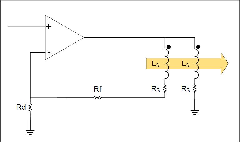

jneutron, your circuit can be solved to Re in series with 2 EMF sources opposing each other, one per coil. If one coil is 90% coupled to the other coil, the total EMF is 10% of the original EMF. So it's like 90% current drive, letting 10% of the EMF back in.
If the coils are not perfectly coupled that implies they don't occupy the same physical space, which means the leakage flux paths will encounter different nonlinearities. So you could scale the output of one coil to match the EMFs, but there will be a residual which contains only distortion. So the distortion reduction when compared to equivalent impedance drive will be less than expected. Although with bifilar winding the coupling could be very high.
Also, no rejection of thermal compression.
