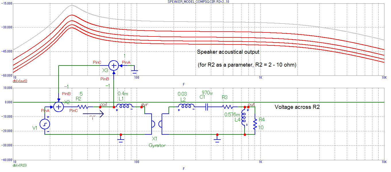

The circuit I drew is a very simple gain stage. It is designed to put the correct VOLTAGE across the resistor Rs. It does that because I am feeding back the exact reading from across that resistor to the negative feedback network.
In a single coil speaker, I do not have access to the resistive part of the coil equivalent model, I can only see the sum of the two elements Ls and Rs.
Because I am using only the voltage across the Rs as feedback, I am controlling the VOLTAGE across the resistor. And, my circuit does not care what the actual resistance Rs is as I am not measuring it.
I am not contesting this, in fact we both agree on your description. The green plot below shows that voltage across the Re is kept constant.
My question is if it would be different, in distortion reduction, from current drive. It seems to me, and the simulation is saying so, that resulting driver transfer function is same as with the current drive.
My conclusion, as of now, is quite clear: "JN-drive" implements indirect current drive, just way less feasible and most likely less effective in distortion reduction (fine-print remains to be seen). We have to mod the driver (*pita*) and the amp because we will need to install degeneration also to have some electrical damping, plus proper EQ to get a reasonable SPL curve. Wrt damping, especially those cheaply built drivers with high nonlinearity are really prone to nasty "jump resonance" chaotic phenomena with no damping even if the acoustic loading is benign.
So, why not just impress the current directly rather than trying to isolate a quasi-constant resistor and relying on V/I transfer to obtain the current by impressing a voltage, with that V/I-transfer not being perfect since the isolated transfer resistance isn't perfect (if alone from thermal drift, and I'm sure we will find residuals of other distortions as well). And then use the dual VC to best extract the velocity signal with a balanced version of the servoing Birt bridge and degenerate the current drive with this (introducing an amount of MFB), rather than using the "polluted" terminal voltage.
As I've written before, real world check by impressing a current and looking at the distortion of the "JN-Drive" voltage will most likely reveal quite a bit of distortion left, coming from the transfer impedance imperfections, matching issues etc.
While it is not completely impossible that some of this distortion might cancel with other distortions that aren't addressed by current/JN-drive like BL(x), BL(i) and reluctance force, I would think the chances are nil.

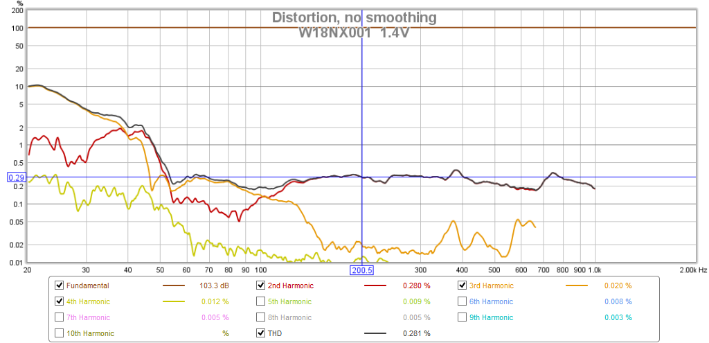

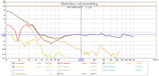

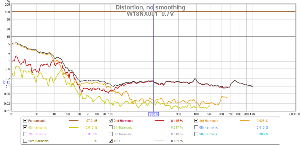

I would like to add some "real life" measurements recorded just now to show how quickly speaker distortion rises with level and also how fast is the distortion rise below resonance (as discussed earlier together with Klippel's 60% that look to be perfectly on target).
We can see linear rise of distortion with level (above resonance).

And voltage as shown is rms?... We can see linear rise of distortion with level (above resonance).
Yes, exactly.
Patel, as I think about your model, I have to ask.. Why are you not looking at the voltage across re only? That is what the circuit does.
I suspect your model is not consistent with my design. Please go back and look at my recent diagrams.
It may be easier and more accurate for you to use a 1:1 transformer to represent my pickup coil design.

Pavel, I see you plotted v across coil r2 as flat, I didn't notice earlier.
How do you put position dependent inductance, velocity dependent dissipation, and current slew dependent coil resistance in?

PMA's simulation shows the driver which has a free air resonance of 64 hz, when hooked up using my scheme, now has a peak (assume resonance) at 30 hz.
If I were to use my pickup coil scheme with this woofer, would I be better off using the driver specifications to design the cabinet, or do I now have to consider the new free air resonance in the cabinet design?

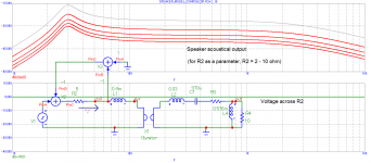

My conclusion, as of now, is quite clear: "JN-drive" implements indirect current drive (a clear and concise name for it), just way less feasible (see below) and most likely less effective in distortion reduction (fine-print remains to be seen)(agreed). We have to mod the driver (*pita*)(see below) and the amp because we will need to install degeneration also to have some electrical damping(not sure), plus proper EQ to get a reasonable SPL curve (PMA's sim shows flat to over 1k, with a bump at 30hz, may be cabinet controlled, say a critical damped scheme.). Wrt damping, especially those cheaply built drivers with high nonlinearity are really prone to nasty "jump resonance" chaotic phenomena with no damping even if the acoustic loading is benign.
So, why not just impress the current directly rather than trying to isolate a quasi-constant resistor and relying on V/I transfer to obtain the current by impressing a voltage, with that V/I-transfer not being perfect since the isolated transfer resistance isn't perfect (if alone from thermal drift, and I'm sure we will find residuals of other distortions as well). And then use the dual VC(wait a cotton pickin minute, you just said above that it was a PITA, now you wanna use it?? 😉 ) to best extract the velocity signal with a balanced version of the servoing Birt bridge and degenerate the current drive with this (introducing an amount of MFB), rather than using the "polluted" terminal voltage.
As I've written before, real world check by impressing a current and looking at the distortion of the "JN-Drive" voltage will most likely reveal quite a bit of distortion left, coming from the transfer impedance imperfections, matching issues etc.(again, jury is out)
