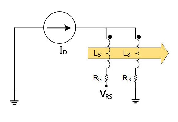

Well, that was one of the first things understood.jneutron, your circuit can be solved to Re in series with 2 EMF sources opposing each other, one per coil. If one coil is 90% coupled to the other coil, the total EMF is 10% of the original EMF. So it's like 90% current drive, letting 10% of the EMF back in.You have a strange way of looking at it. 😉 I understand what you mean however. That is why I would prefer bifilar.
If the coils are not perfectly coupled that implies they don't occupy the same physical space, which means the leakage flux paths will encounter different nonlinearities. So you could scale the output of one coil to match the EMFs, but there will be a residual which contains only distortion. So the distortion reduction when compared to equivalent impedance drive will be less than expected. Although with bifilar winding the coupling could be very high.we also agree entirely. If I nest the pickup in the interstitials of the top layer, even scaled one has to consider the pole piece may interact differently w/r to the front plate, and also a shorting ring may affect the nested more than a two layer.

Is it also expected to get usable acoustic distortion component on VRS with current drive on the DVC?If you look at Demians plot, fourth one, it shows that the electrical voltage on the second coil has harmonics that exactly match that of the acoustic distortion....

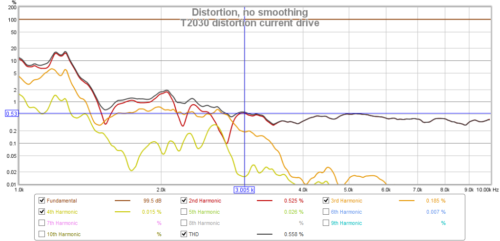

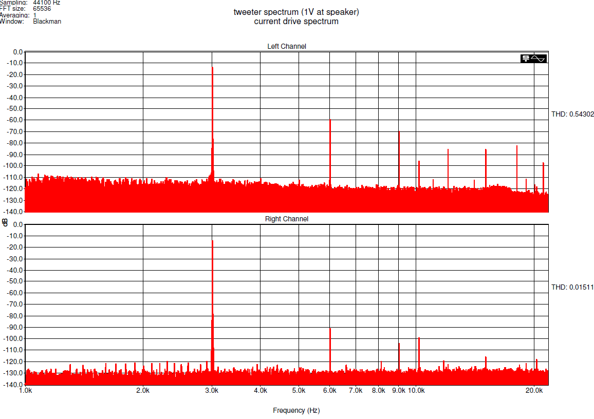

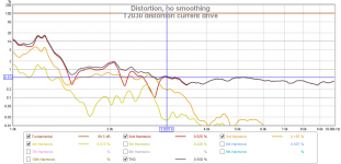

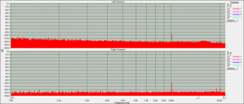

I have "reactivated" my current drive setup (it took all time from breakfast to lunch break). In principle, it works this way:
Then I measured simultaneously tweeter (Beyma T2030, new) acoustical output and also the spectrum of the driving current. Please see it attached and you will see that acoustical distortion is much higher than driving current distortion. It is measured at 1Vrms across speaker terminals. Please note that acoustical distortion is about 30dB higher than current distortion.
Hi Pavel,
Any idea what's happening just above 10kHz? On first glance thought was H4, but it's too low for that.
Hi Pavel,
Possibly folded back aliases? Lots of HF action I wonder what the distortion residual looks like.
Hi Pavel,
Got it. It is a speaker nonlinearity that strongly depends on signal level. At some point it jumps up. So are some speakers.
Ah, I hadn't thought that would appear as an amplifier current distortion. I clearly need to go away and get my head around this.
I had a ribbon tweeter once that exhibited chaos and non-harmonic output. KSTR mentioned it, the first time I recall seeing anyone talk about it.

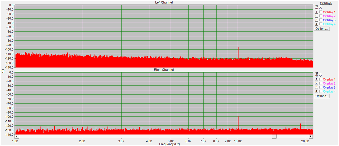

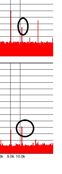

I am not sure what you speak about. It is only in the acoustical output. Top trace is acoustical measurement, bottom trace is current spectrum. At some point, above certain level, acoustical output is messed with HF, though driving current spectrum remains unchanged.
I assume they are Al cone breakups.
The peak just above 10k in the bottom trace
It is catching that single peak from the air, it is there even without signal when measuring noise. The amp is not in the box, it is a "true DIY" , I think it catches some EMI, DC/DC chopper or so, maybe into measuring groundloop. It is unimportant, as it does not change with signal or level. I find much more interesting that the idea that acoustical distortion is mirrored in current is not general and may cover only certain cases. IME it is misleading to rely on such idea.
