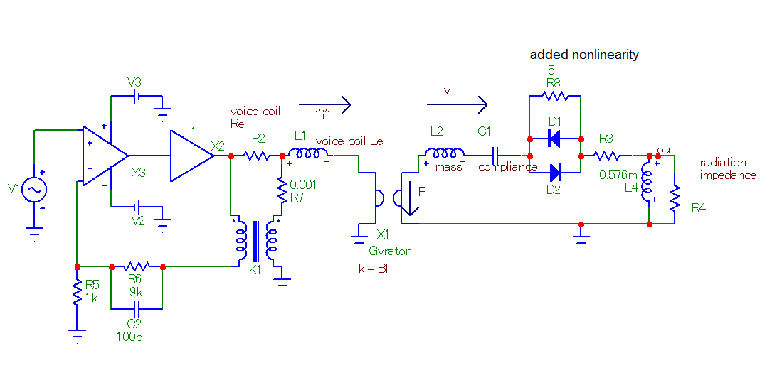

What is R2. When the gyrator pulls non linear current, how do the voice coils see that current? It looks like it can disturb the drive voltage of the drive coil , bu I do not understand your choices. Can you explain please.
Jn
R2 is a voice coil resistance in a braked state (Re). I have not used the second coil. Instead, there is a 1:1 transformer monitoring voice coil voltage. Nonlinear and frequency dependent resistive drop on voice coil is thus eliminated in the model. Voltage across voice coil resistance equals amplifier input voltage multiplied by gain, which is 10 in this case. If the input voltage is flat with frequency, voltage across coil resistance is also flat and equal 10*Vin.

PMA,
It looks like you are taking the non linearities through the resistance, and that IR drop is showing for the drive coil voltage.
I believe those currents should go through the drive coil. That way they couple directly to the feedback coil.

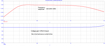

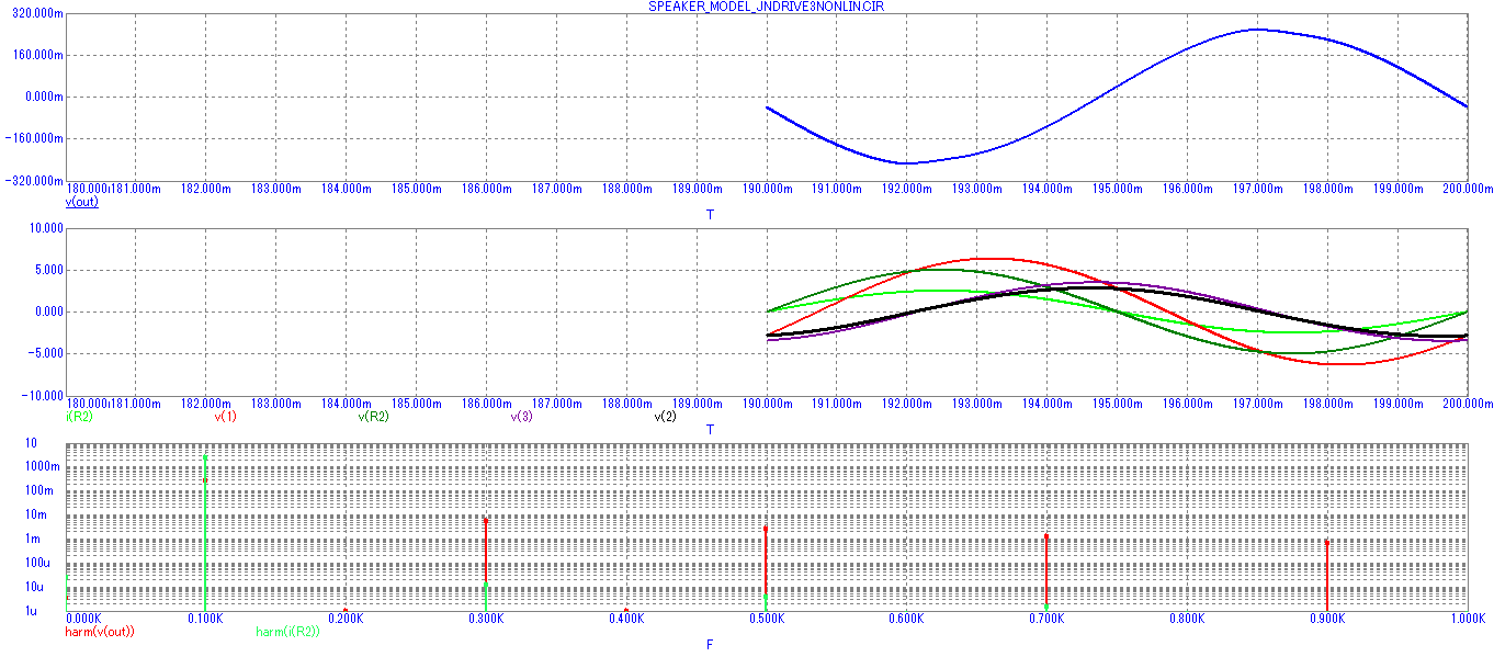

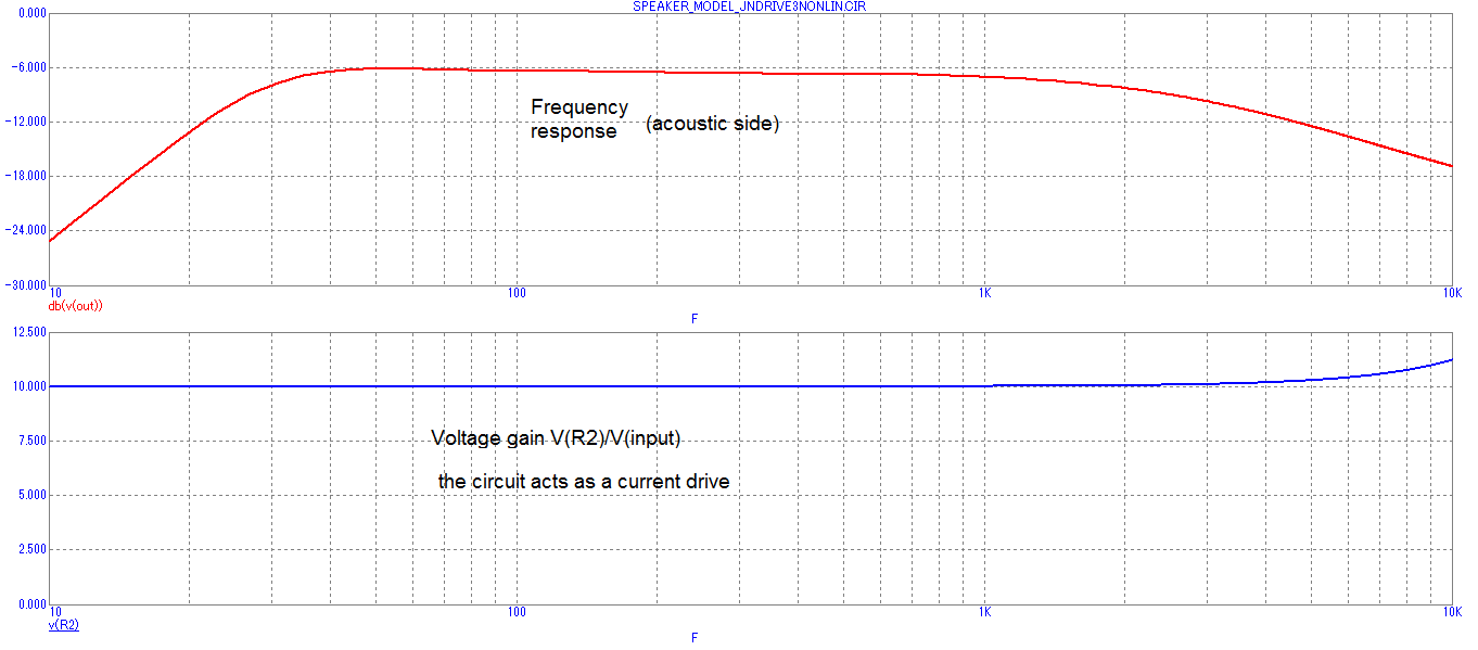

I will try to explain how it works and why my doubts about distortion reduction.
The circuit is driven from AC voltage source V1. Starting at R2 there is a speaker circuit model. Before the gyrator there is a voice coil R2 + L1. Behind the gyrator there are mechanical elements of the speaker. L4//R4 is a radiating impedance transformed to the mechanical side via 1/S^2 transformation. R8//D1//D2 were added to simulate a non-linearity, though it would be a mechanical non-linearity (like excursion dependent e.g.).
Now, the K1 trafo (1:1) is subtracting voice coil voltage as you have suggested and you are using a 2nd coil for this. Because of feedback, voltage across R2 is just V1*(1 + (R6/R5)), it does not depend on frequency or amplitude. Thus, the coil R2 + L1 (+ primary side of the gyrator) is always driven by current and this current is undistorted, it is V(R2)/R2 as far as R2 is constant. Now we have a non-linearity on the mechanical side of the driver, in the secondary of the gyrator. This non-linearity is in series with the mechanical impedances, however after transformation to electrical side it transforms as parallel! Remember that the gyrator transforms parallel to series and vice versa. Voltage goes to force, current to velocity. So, even if the primary current of the gyrator is undistorted and current driven due to feedback used, the nonlinearity in the secondary makes the velocity flow nonlinear. This is shown in the time domain plots attached.
Output signal v(out) is distorted, though the input current i(R2) is undistorted. The i(R3), representing velocity, is distorted as well, in the similar way as v(out).
So, we have clean current drive due to feedback and coil voltage subtraction, but despite of that, due to mechanical non-linearity, the velocity i(R3) is distorted (not shown) and the output sound v(out) similarly as well and there is no cure this way how to make a correction. It should have been a different circuit, different correction philosophy, IMO.
