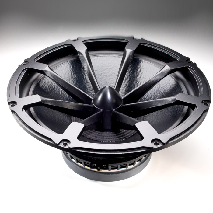

An example of speaker with an extreme design (to minimize power compression).
(Is it worth going this far?)
PMC Loudspeakers MB2S-XBD-A Three-Way Active Studio Monitor with XBD Bass Cabinet- Pair
The unique 12" Radial™ driver features two cooling systems. In addition to the conventional rear vented magnet it uses the patented, front mounted Radial™ chassis, which acts as a giant heatsink. This keeps voice coil and magnet temperatures exceptionally low resulting in superb reliability, 3dB less power compression and tight, clean bass even after prolonged periods of high SPL.
I'm sorry...what means this phrase "is it worth going this far?"😕

I meant, does the approach make a significant enough difference to justify the very high cost?
I suppose it does, if the user listens at a high SPL for a long period. But that is not a good practice in studios afaik. (The product is aimed at the studio segment.)
Hang on, people here talk about the benefit of $500 capacitors and very expensive flooby snake oil devices that, as far as anyone can tell do naff all from an electrical perspective. So surely a REAL improvement must be worth something.
To me the Volt units look a bit like the bass units a Dalek would chose, but I am sure that, in the target market they are appreciated for their performance.
