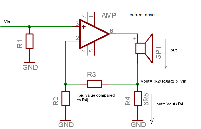

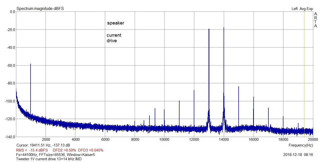

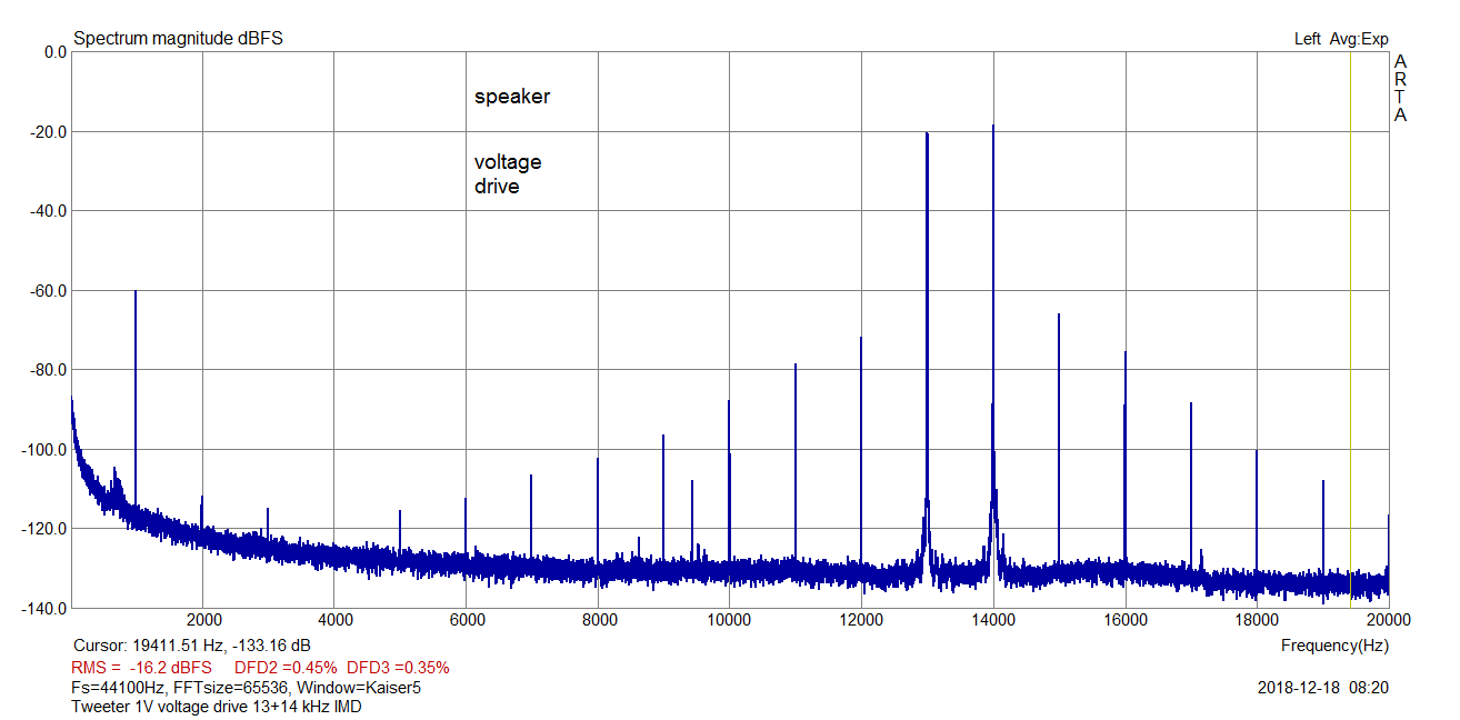

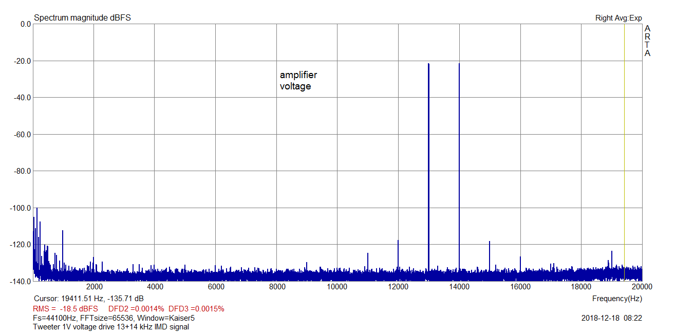

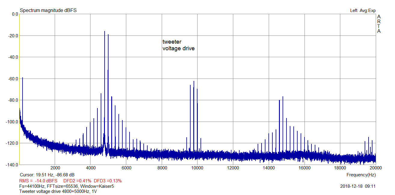

Some real measurements
Finally, I got some useful result. Measuring 13+14kHz intermodulation, tweeter acoustical output, there is a notable improvement in H3 (almost 20dB) under the current drive, compared to voltage drive. 1V across the speaker. Again Beyma T2030.
I will need to revise my web page re current drive :).

If current drive makes good in HF but is a problem at LF (resonance) - it should be possible to make the feedback frequency dependent so that one uses low impedance around driver resonance and then go to current drive higher up - no? (Thinking about my XO less line source with 16 fullrange drivers)
Exactly. This is the feasible real-world appliciation of current drive with typical drivers under typical acoustic loading which results in a high-Q system resonance.... too high and too unstable to be EQ'd out and often too high to be free of chaotic "jump resonance" problems under large excursion. The damping applied doesn't need to be choosen so strong as to give flat SPL (as per being <= 0.71), it is enough to arrive at a system Q of no higher than 3 or so which can be EQ'd reasonably. This will ring slightly for external signals applied to the cone (including its own distortion) but it doesn't sacrifice too much of the current-drive properties. A compromise, as always.
EDIT: Of course each driver should ideally have its own amp, since both parallel and series connection will skew the results unless drivers are very well matched. Again, compromise...

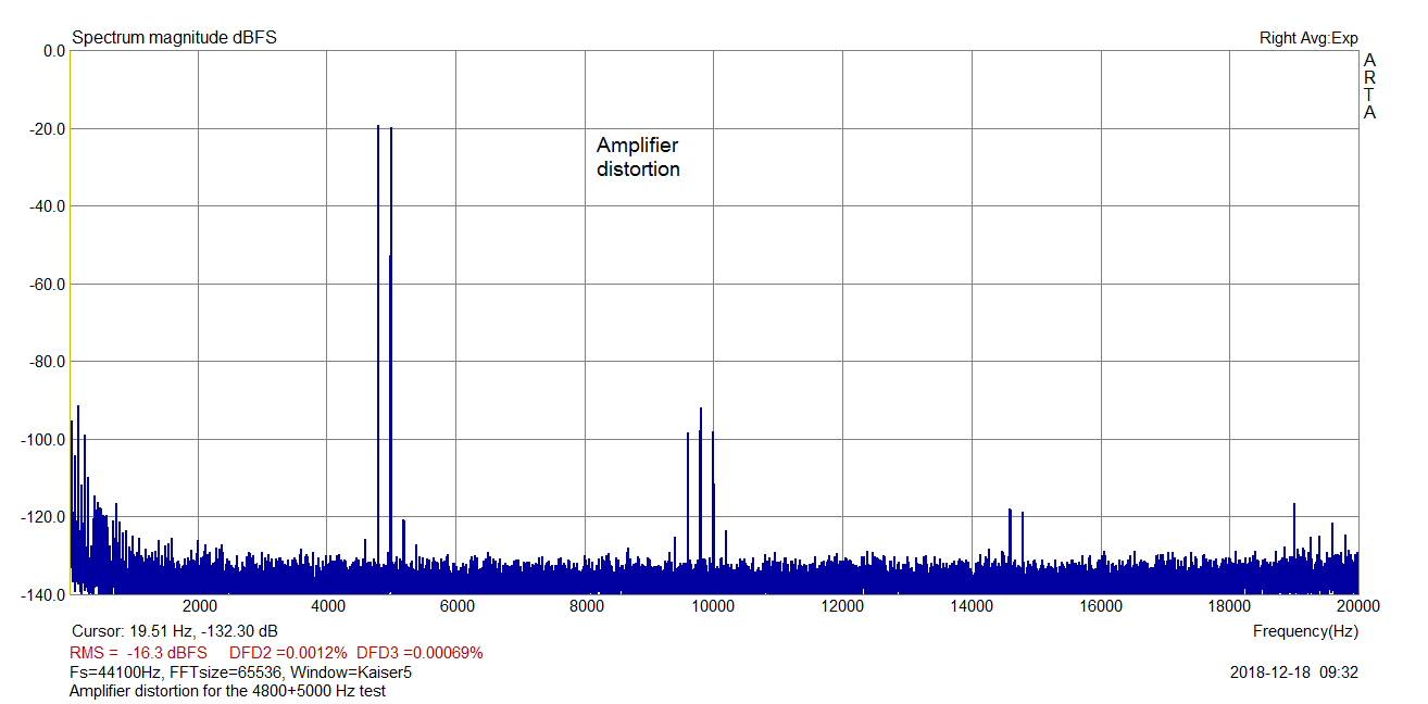

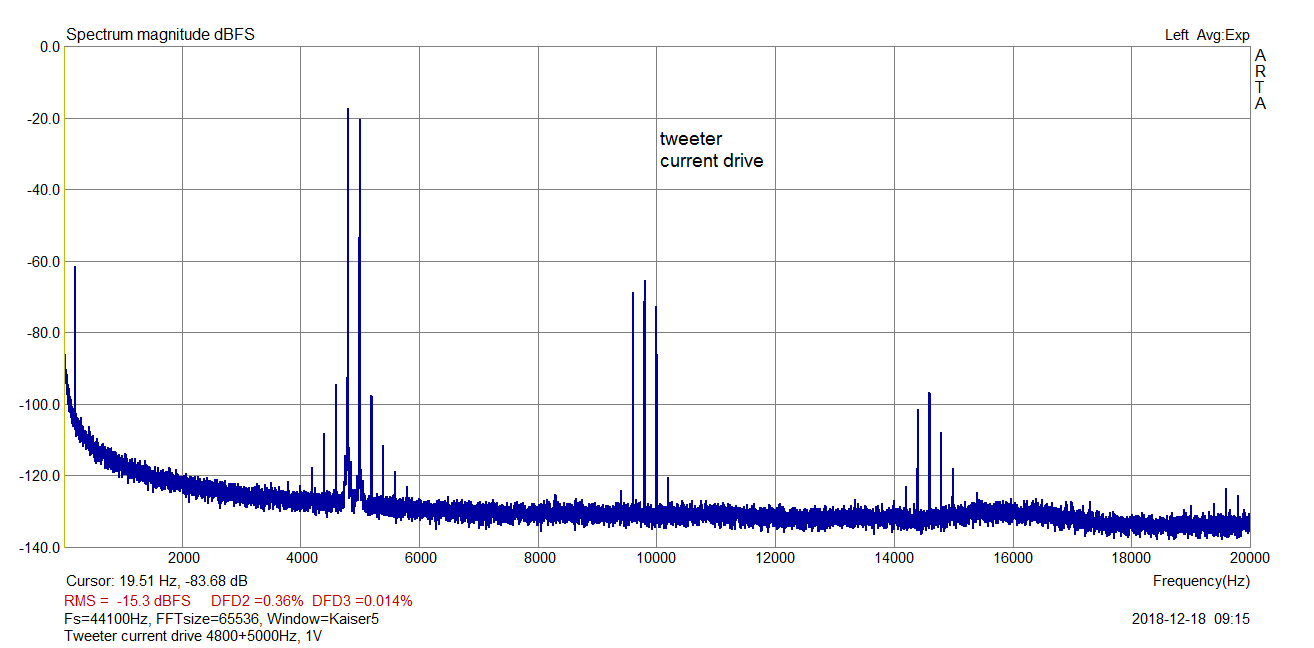

Very interesting. I did current drive experiments looking at just THD and wasn't convinced it had much to offer. Will now do the same looking at multi tone. Thnx.
Thank you. I also did THD before, without a notable result. Twin tone with closely spaced tones is nice, as it enables to distinguish, very quickly, between even and odd harmonics, without messing them together.
The 4800+5000 shows both intermodulations and harmonics, again easily distinguishable between even and odd ones.

I got exactly the same result, re distortion, with current drive and with my simulation of your drive. However, I assume you consider my simulation of your idea invalid, so let's wait if someone gets a different result (Keantoken?), or better, if someone measures something related to distortion on a double coil speaker, however the last option might take ages, IMO.
