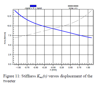

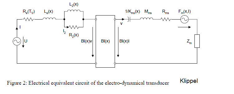

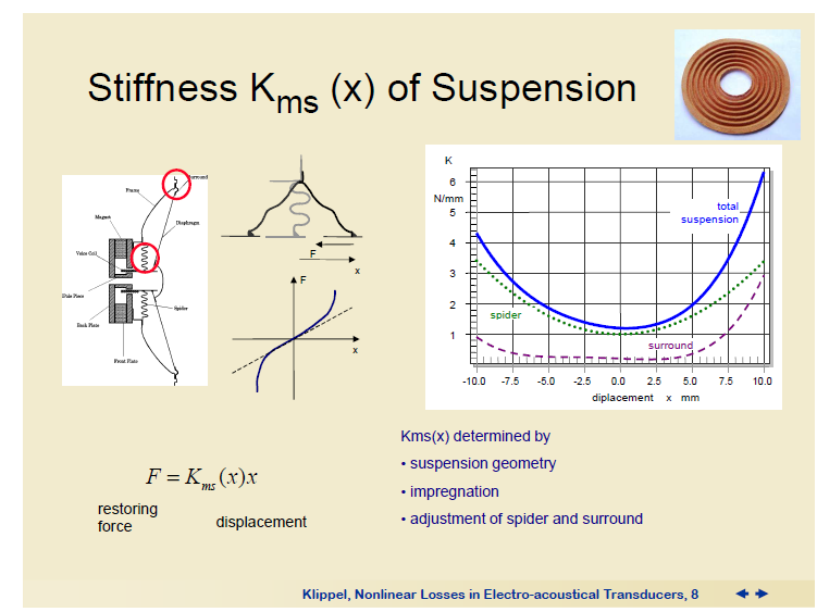

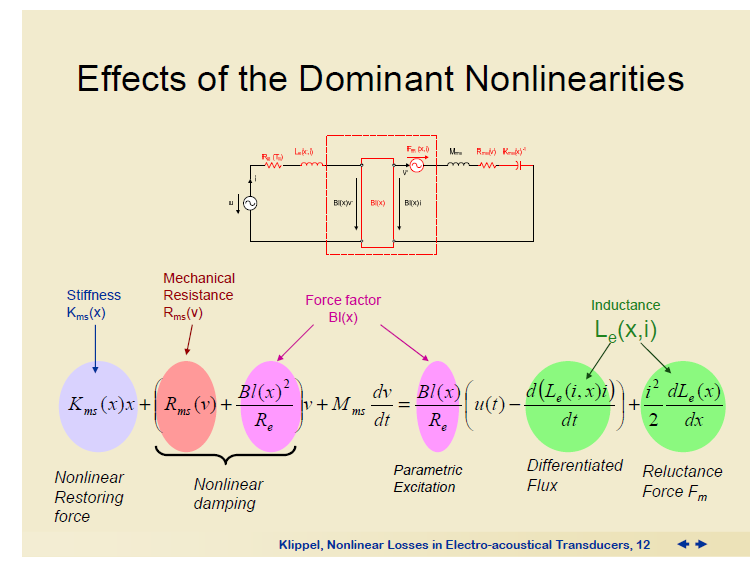

Let me ask a humble question, are we really concentrating on dominant speaker non-linearities? Please let me add 2 images from Klippel presentation and I would like to point to stiffness vs. displacement plot, e.g. and also the asymmetry of stiffness vs. displacement in tweeters (my yesterday measurements). Last, the speaker circuit diagram by Klippel ("gyrator stuff", as JN used to say).
I concentrate only on the magnetic non linearities and the resistive non linearities.
All the mechanical non-Lins are important, but I am concentrating on E/M.
My pickup scheme may be of assistance in diagnosing some of the mechanicals however.
I can even envision a system of using current drive for its good aspects, and the pickup coil as a second feedback signal to get the speaker even closer. As I said, current drive doesn't know or care what the cone is doing, the second coil may be able to help in that.
