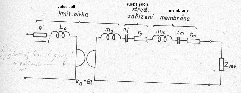

@JN: You are using a double bifilar voice coil for the correction, right? So they make a transformer, with inductances of Le (L2 in my circuit) PLUS the gyrator primary voltage, that cannot be separated.
But even if the K1 correction voltage is taken from gyrator input, it still does not help to kill the distortion. Remember, current drive, current is linear, serial elements behind gyrator transform as parallel R//L//C to primary side, R or L or C is non-linear, driving current is linear, but partial current through R or L or C is not.
The voltage across L2 is supposed to be the exact same voltage as the primary of the transformer.
Is it in your model?
The non linearities you have tacked into the right side, they are in series with the inductance of the voice coil. So, as frequency goes up, the non linearities decouple.
But the L2 inductance is the cause of the non linearities, not in series with them.
I suspect your model is insufficient for the task. Nice work, I am glad to look at it, but my thinking is that because this coupled coupled yada yada stuff is two weeks in the making, the models are not there yet.
Yes, the voltage across L2 (which inevitably includes the gyrator primary voltage or call it EMF if you want).
The non-linearities plus mass, friction and compliance are connected to common velocity and transfer as a parallel circuit connected in series with voice coil on electrical side.
The speaker model used is a standard model used in electroacoustics theory, textbooks and the one that Klippel uses as well. It is the basics of electroacoustics. You can make its elements non-linear, if needed.

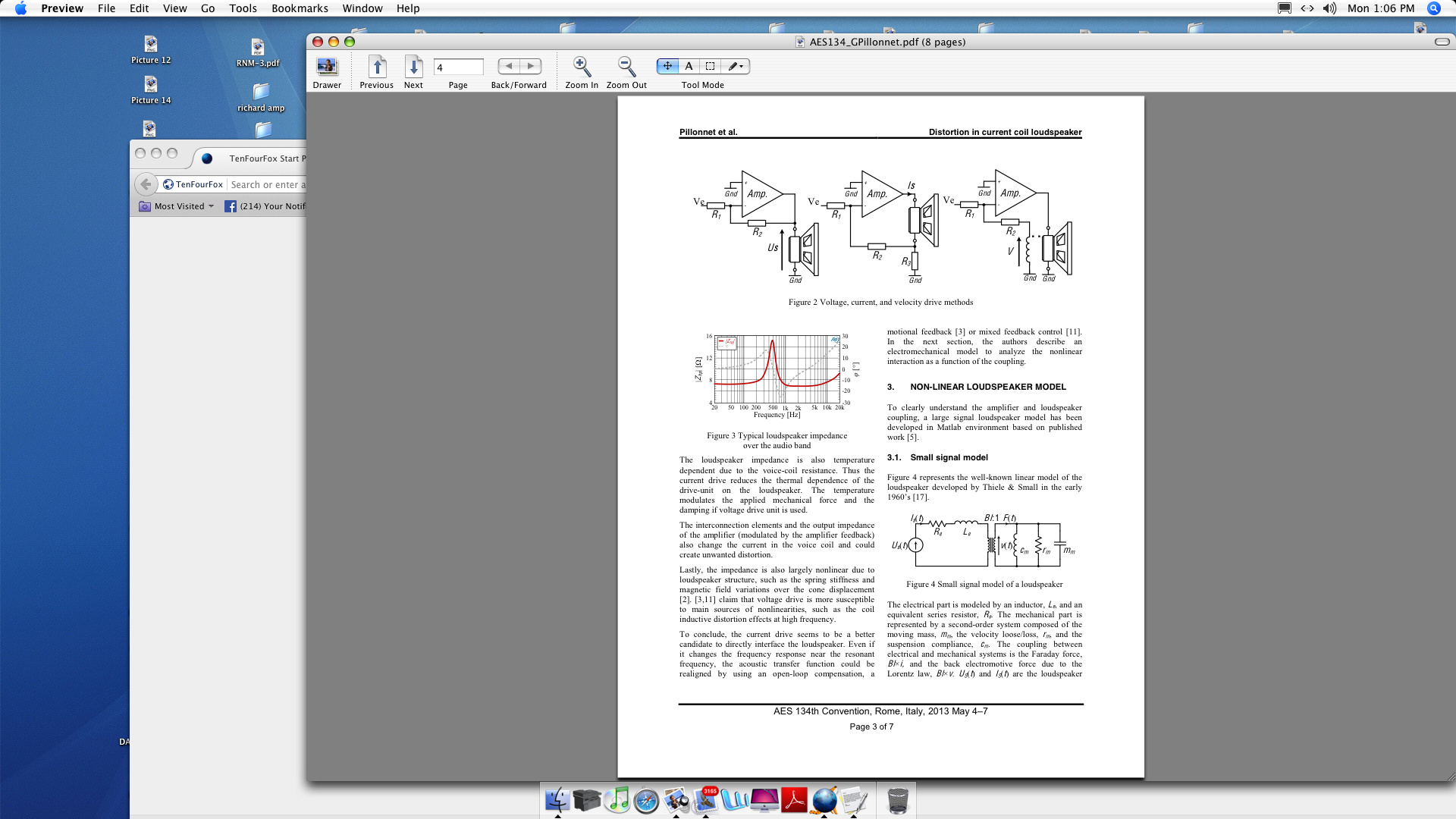

Here is my simulation with Bl(x), Bl(I), Le(x) and Le(I) nonlinearities added which I can turn on and off with parameters. I tried to match the distortions to this paper:
https://www.almainternational.org/y...ses_in_microspeakers_alma_2013-1.10691701.pdf
But it seems Klippel included time-dependent behaviors in Le(x) and Bl(x) (no mention of Bl(I) or Le(I)) which I haven't tried to model without a good hint at their functions. The distortions in my model still always decrease with frequency. I added a abs(d(x)) term to the Le(I) function, but distortion still doesn't rise with frequency.
Should I just keep expanding the model using empty nonlinear functions to be filled in later? I haven't included mechanical nonlinearities yet, but I can, even better if someone can give me their functions in a way I can plug into the simulator.

That Klippel paper again makes clear that the BL(x) nonlinearity is still the major distortion contributor for large signals / high excursion and none of the simpler methods (current drive, including JN's -- degenerated or not; using the VC as velocity sensor; etc) can address it, only the driver design can (either genererously underhung VC or generously overhung with very symmetric magnetics)... or a true independent sensor MFB (still with some means to soft-limit the excursion...
I have not seen Klippel give the equations for the reluctance force that is given in that paper.
