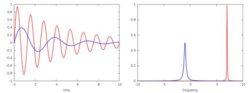

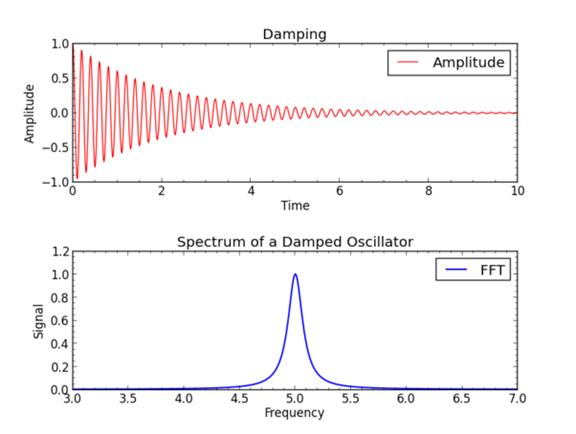

From my previous example, I looked for and found this: the spectra of a damped sinusoid.
Note the spread of the spectrum around the fundamental.
If this is scaled to 20 khz for example, the energy heads out to 22K. If the decay is faster, the spread is more.
Odd, this is apparently bog standard MRI stuff.
Second pic shows two, the blue damped faster. Note the spectra is wider. The text associated with that find mentioned that.

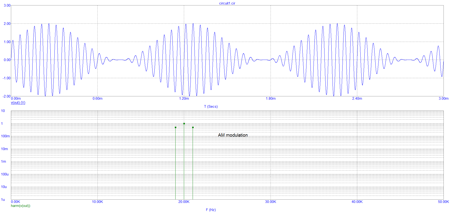

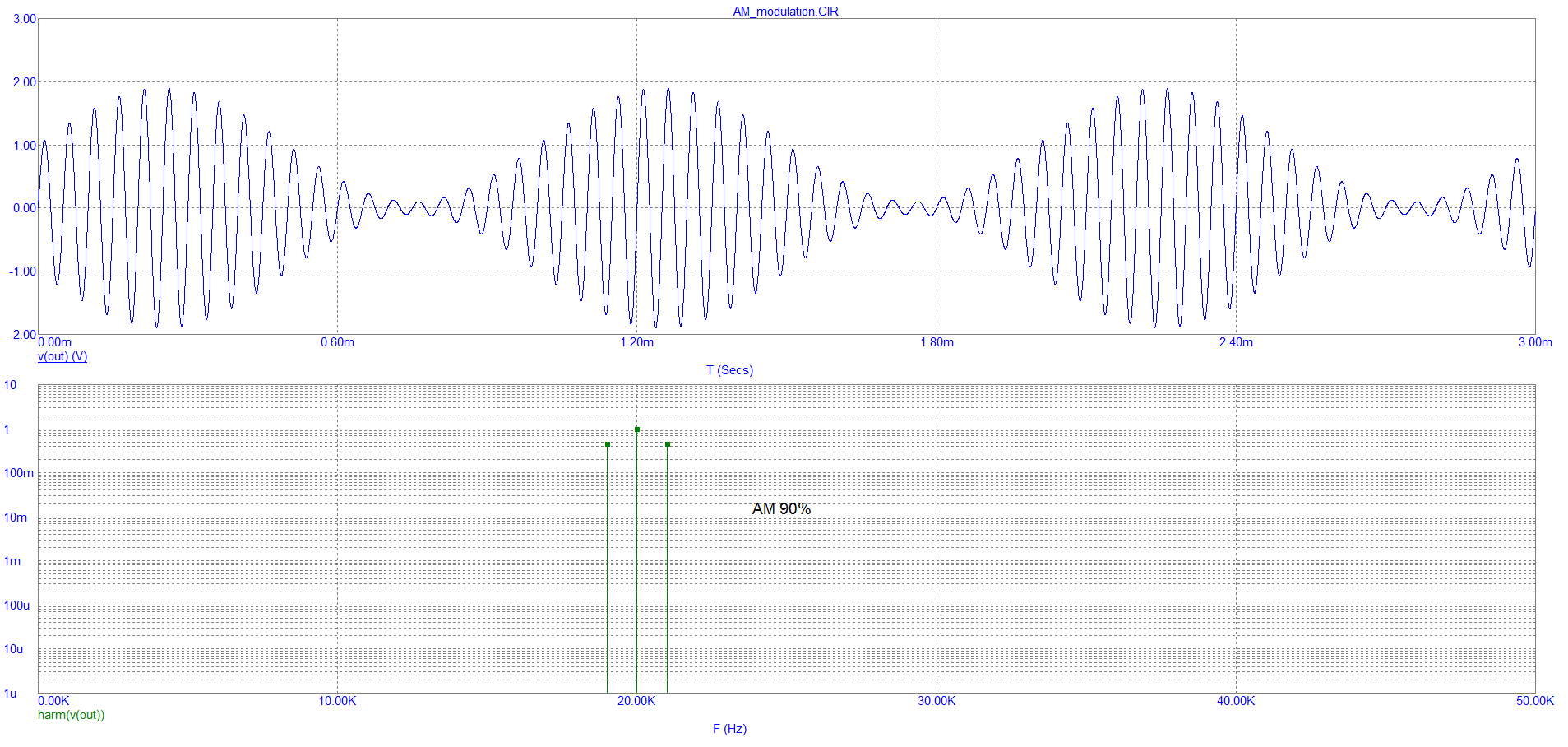

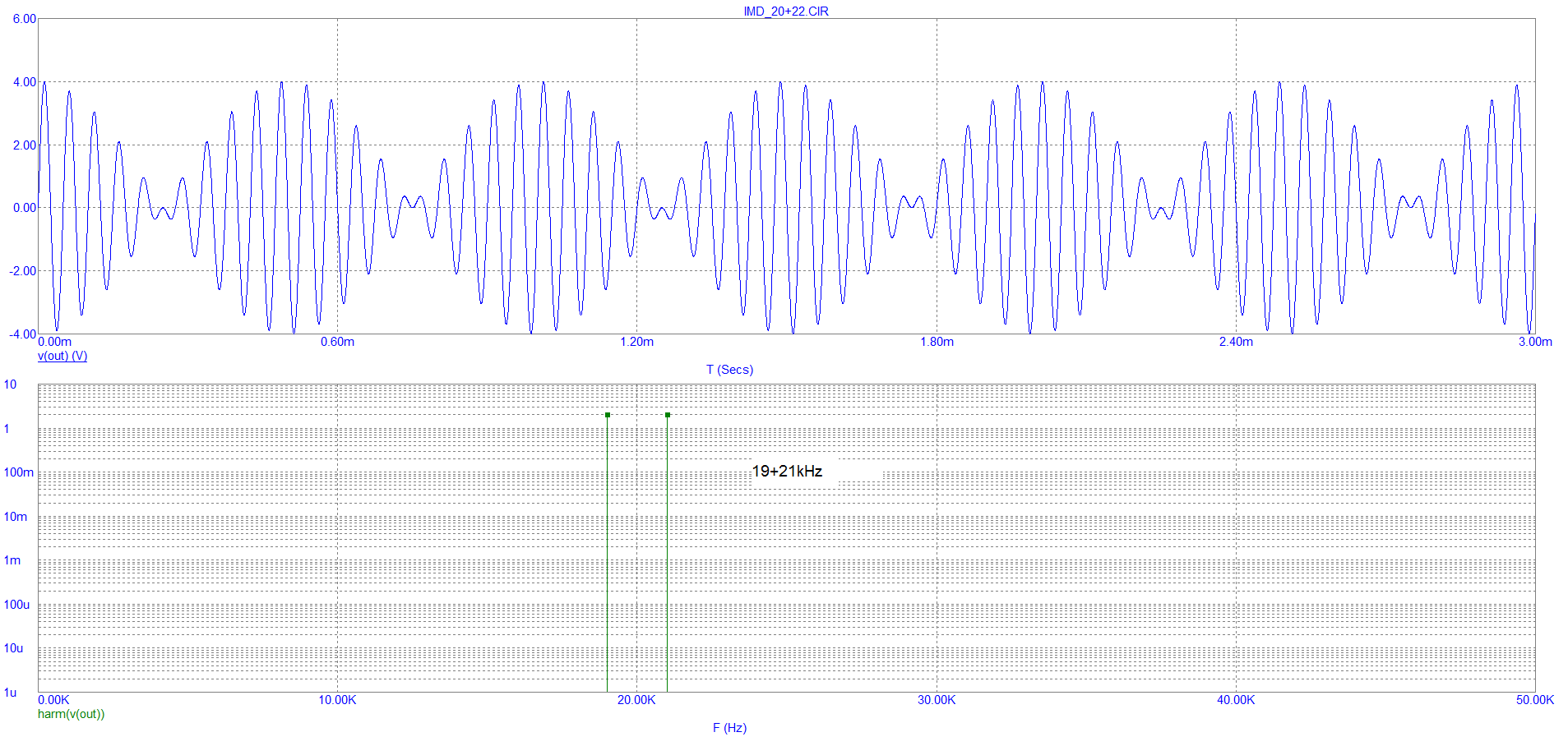

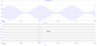

Not sure this would make any sense however I would try. AM modulation x two tone summation.
Nice pics.
Note that the AM modulation envelope you present is entirely different. Every single lobe is exactly the same, whereas a true 100% modulation flips phase of the carrier every lobe.
I see a large deadband between envelopes. When a line is fit to the tips of the carrier, as it goes through zero, it must continue through to the bottom of the next lobe. That yours doesn't means you changed the modulation away from a true cosine modulation.
How long did it take you to modify the results until it matched what you wanted to say?
Please modulate using a true function which reverses sign every lobe.
Nice try though.
Edit. I retain exactly what I said above for clarity.
PMA, I apologize. I have found instances of both on the web, so retract my statement that you were in essence being nefarious.
That said, in both cases, a sideband exists that is above filter cutoff, so you still prove that there is content above the cutoff, which when removed, leaves sonething that is not the same as the original.

AHA, the distinction. PMA is modulation with the envelope varying from zero to peak, in other words a sine that is offset so it never crosses zero. That always preserves the carrier as there is no flip in sign of the envelope.
The math of two sines in beat is exactly the same as amplitude modulation where the envelope passes through zero and is symmetric to it. As a result, half of the carrier is 180 degrees out of phase, and the resultant FFT show no carrier..
In both cases however, the sidebands are still there.

Modulation and simple summation are two absolutely different processes. You still seem not to take it into account. The similarity of time domain waveforms is not any proof of the process sameness. You seem to try to hold some strange integrity of your initial false assumption that two tone summation is an AM modulation.
