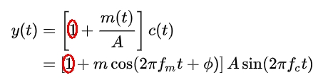

There is no carrier, as people keep trying to explain. Scott Wurcer already told you the waveform you have is double-sideband suppressed-carrier.
You see, or don't see, when AM radio is modulated digitally the carrier has to be added back in with the sidebands. Otherwise, the carrier gone after perfect multiplication is used for sideband creation. That's why you see the 1 circled in red in the equations attached below.
The reason old radio transmitter designs didn't have to do that and had to filter out baseband audio instead was because they didn't have perfect analog mulitipliers, so they used non-excessive intermodulation (distortion, actually) to get the job done.
Again, what you see is an interference pattern, not the same thing as a third frequency at all (when talking about frequencies, filters, and sampling).

20k or 2.5k it is only 17.5k and 22.5k remove the 22.5k and you have 17.5k there is no frequency translation.
Of course. Who said anything different?
Of course, that is only in an FFT. If you look in the time domain, it is all 20k in the envelopes. Just look at the overlap plot I put up.
The fact that an FFT doesn't see the 20k is because the phase of the 20 k flips 180 degrees every envelope.
And, remove the 22.5, and only 17.5 is left.
I am confident you cannot do a good FFT on only one lobe, right? You could pull every other lobe if you wanted to detect the 20 k.

You are not tracking the discussion, I assume it is accidental.
AM straight modulation retains the carrier. As per PMA's posts show.
Cosine multiplication modulation retains the carrier as well, but inverts phase every lobe. 200% modulation, which are not good for broadcast. But is exactly what adding sines does.
And again, you are diverting from the crux of the discussion.. Envelope modulation will cause sidebands.
I am worried about such sidebands crossing the filter threshold with music, particularly cymbals and such.
Jn
