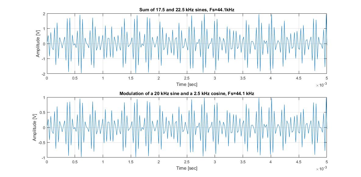

I keep not quite understanding the point, if you modulate (fully) a 20k sine with a 2.5k sine there is no 20k sine. If you filter away the 22.5k sine the 17.5k sine is all that is left. There is no 20k in 17.5k out.
you have to argue with whever defined that trig identity. I honestly did not expect the result Hans provided, and in digging very far, found the math.

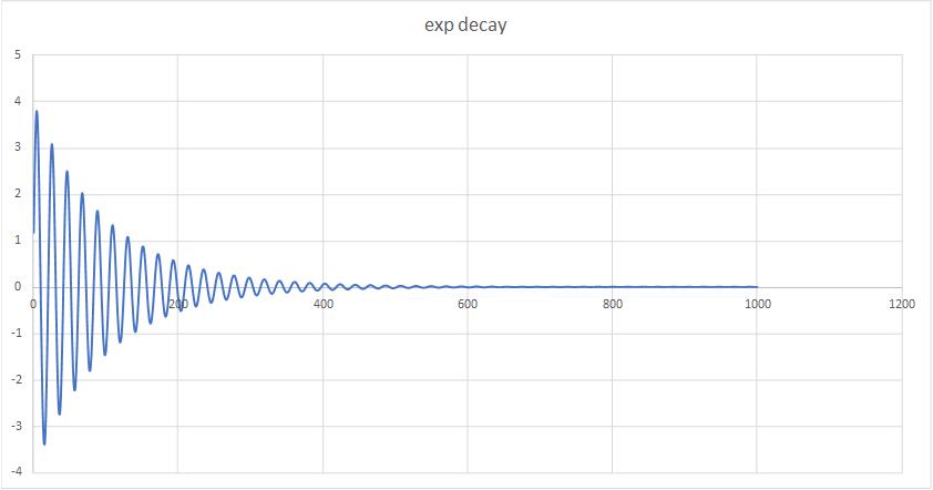

I just updated the wave I was trying for, this is a bell hit with exponential decay. The leading edge violates ny-baby, the start of the trail edge may or may not at the start.
If we were to raise the fundamental frequency and increase the decay, I bet your gibbs envelope through a filter would show huge at the start, and tailor off much faster than the actual envelope as the envelope slope gets less steep.

Here is my attempt at calculating the addition and multiplication of the signals quoted by jneutron.
The upper plot is the addition of the 17.5 and 22.5 kHz sines, the lower one is the multiplication of a 20 kHz sine with a 2.5 kHz cosine.
All signals have a sampling rate of 44.1 kHz.
There is a factor of two difference in the amplitudes, the lower plot result agrees with "Signals and Systems", Oppenheim et al., 1986.
Is anything missing in my calculations?

Yah, and he also said the two waveforms were identical. Which they very clearly are not.
This was the explanation I was thinking of, particularly the last sentence?
It isn't, and any filter cannot change that. You are still mistaking the peak magnitude point of the filtered response as the point where the carrier freq is situated, which is only true when no additional EQ is present, obviously. With EQ, the peak point in the spectrum does shift but the carrier and the sideband frequencies are not changed. In a single cycle of raised cosine window the components have widespread leakage, in the periodic equivalent we see distinct lines at 20k carrier and 15/25kHz lower sidebands and that picture doesn't change when additional EQ is applied to this.

Look at the exponential envelope. Ignore the leading edge, we all understand that.. Lobe to lobe of the hf signal is dropping severely at first, then easing up as it tails. That initial envelope steepness is high frequency envelope modulation that will sideband..as the steepness declines, the sidebands pull in to the carrier. As they pull in, they may cross the frequency threshold where the full content gets through, where the initial sidebands were cut out.
