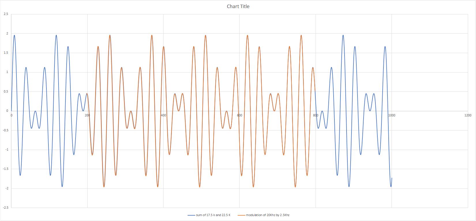

Here is a comparison of the waveforms between the sum of 17.5 Khz and 22.5 Khz (in blue) and the product of a 2.5 Khz sine and a 20 Khz sine (orange).
I had to truncate the product (orange line) from zero to 200 points, and 800 to 1000 points so that it was evident that a blue line was even on the chart. I guess I could have shifted one up or down a few pixels, but then someone would claim they weren't identical.😀
Needless to say, these two techniques for producing that waveform prove that the trig identity holds.
It also proves that multiplying a 2.5Khz sine times a 20 Khz sine is indistinguishable from the summation.
It also shows that an amplitude modulation using two in band frequencies (2.5 k and 20) will generate a signal at 22.5K.
You continue to miss the point. However a waveform is created in the first place doesn't matter. Once it is created it is only one entity, in the case of your example there are exactly two frequencies resulting. That's the answer.
We agree on that, its not a sticking point.
No, I don't... you miss it.
How's that for talking past one another...😀
My exact point.
For this simple example, yes.

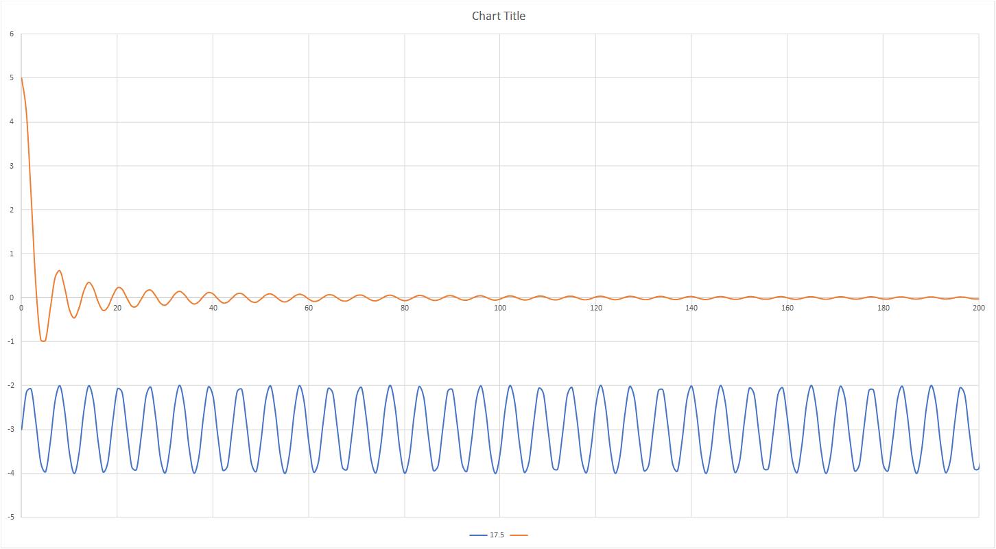

Music. I can post an example in a few minutes, wait...
If you say multiplication occurs, how do you personally distinguish if something is multiplication or interference?
For the cited example, it was already stated that they are indistinguishable.
here is a ridiculously simple representation of a bell being hit. I modulated the fundamental frequency by 1/x. (and yah, I should have increased the fundamental frequency at least a factor 5 to put a lot more wiggles in..)
The leading edge of course totally violates nyquist. The trailing edge, the steep part could depending on the fundamental frequency, the tail, nah.
