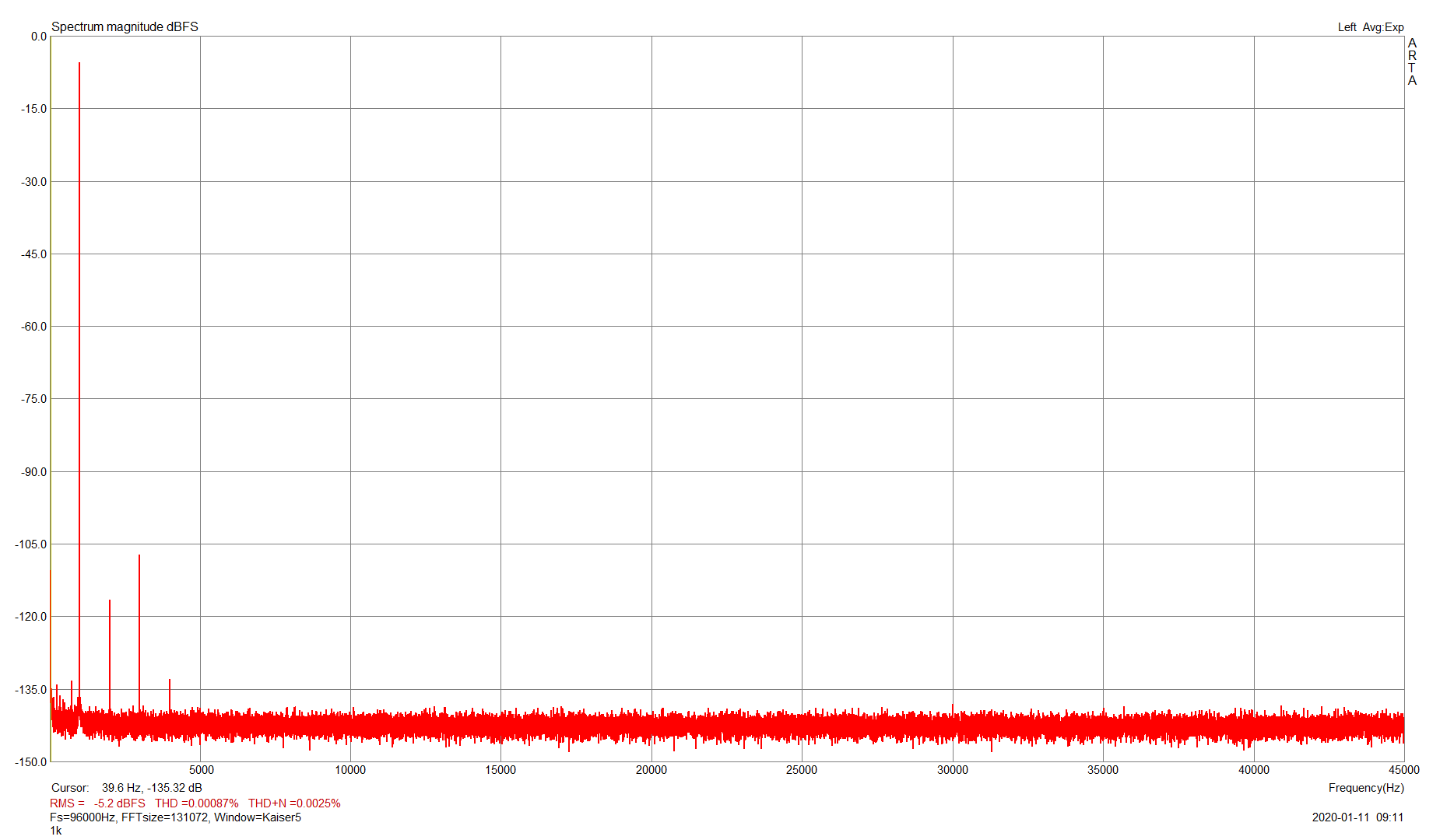

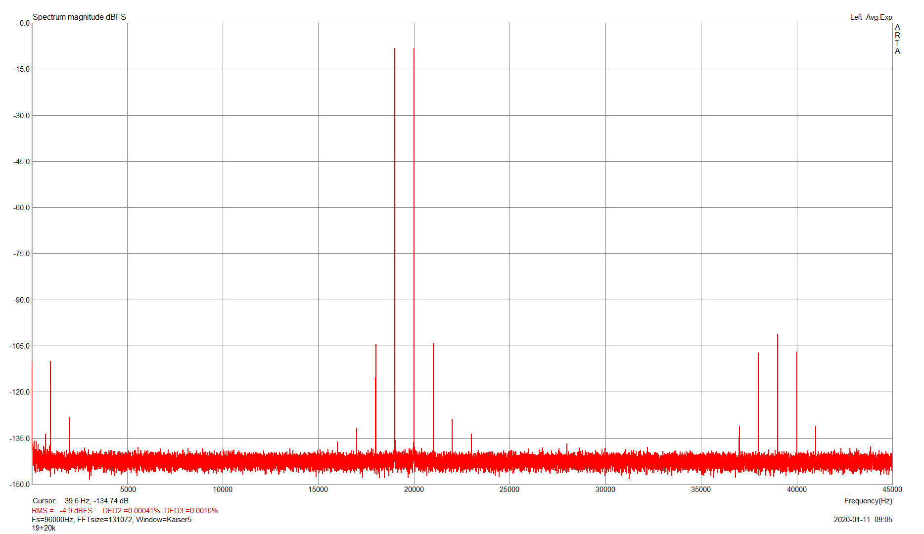

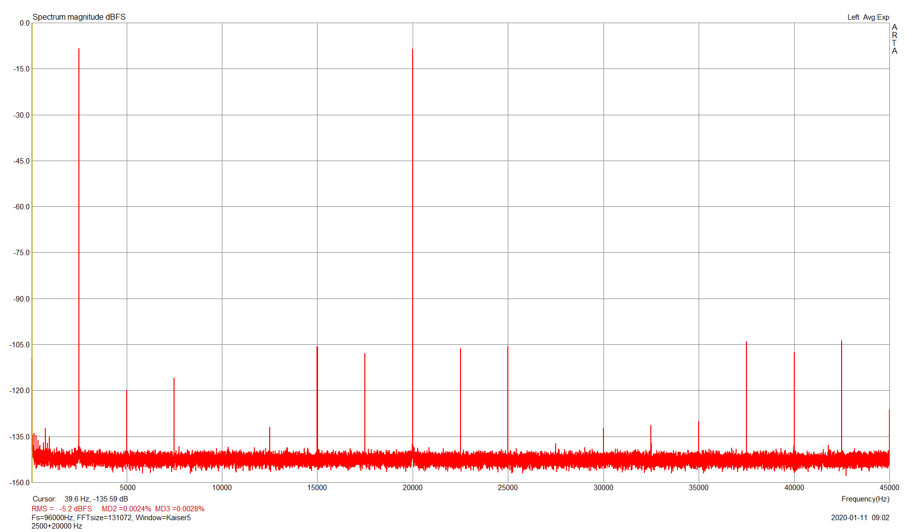

Let us talk about intermodulation distortion. Often tested at 19,000 & 20,000 hertz test signals. It is almost always well below 1% for decent gear.
What happens if we use test signals of 20,000 and 2,500 hertz? Will the level of distortion change?
Hi Ed, attached, for this DUT your proposed test is more severe.
