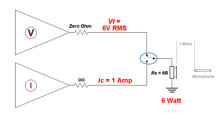

I did supply quite a bit of that earlier, showing an equivalence test (current versus voltage) that proved, and backed up by maths that variations in dBSPL is directly proportional to current.
Amplifier 6V, driver 8 Ohm with Re of 6 Ohm, hence I = 1A. That was then compared with a current source set also to I = 1A and the difference using a microphone measuring the dBSPL at 1M.

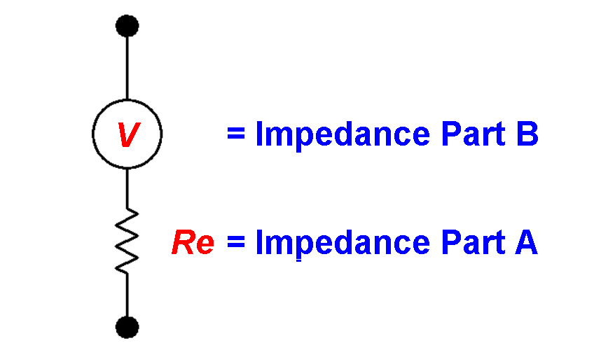

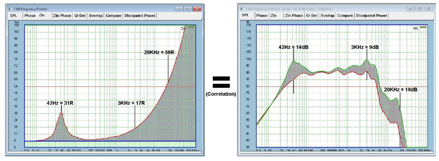

See attachment below. After I posted that and the associated numbers/maths that backed up those changes in dBSPL and that it proved 1) that the dBSPL is entirely proportional to current and not voltage and 2) that the back-EMF impedance is the impedance above Re (hence total impedance is always >Re) is a real impedance.
I then got the biggest laugh of the year when somebody here (I forget who, so he can be thankful) that "Just because it looks like an impedance, it doesn't mean that it is." I stitched over with laughter, so it is an impedance that is not an impedance? So 'he' was not as smart as he thought he was and 'he' was correcting me? What a hoot!

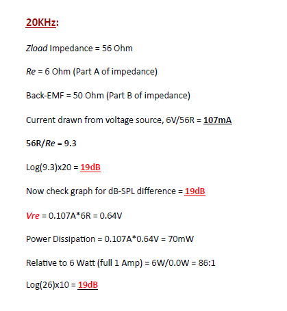

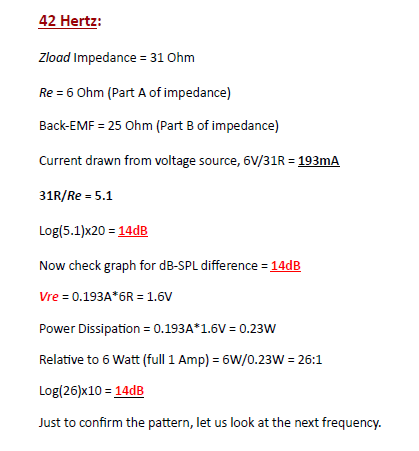

I also posted the maths concerning the motional impedance at Fs = 42Hz = 31R. But anybody with a calculator and a Log function can do that using the numbers in the equivalence test (you know the current, the voltage and the two parts of the impedance, you can repeat the same at 3KHz which is primarily back-EMF impedance cause by the inductance of the voice coil and same for 20KHz), this is not exactly rocket science, the numbers are clear.

Yes, the back-EMF of a driver is a voltage source and can be measured in Ohm, and yes it is an impedance because you can measure the degree (and calculate) because it impedes current (that is what an impedance does, it impedes current, not voltage). It looks like a duck because it is a duck!
But the back-EMF also being a voltage source, unlike Re it does not dissipate heat, the only heat that is being dissipated is across the Re, the DC resistance of the voice coil. Because the driver has a low efficiency of 0.5%, the dBSPL of the output (measured with a microphone) is also proportional within 1% to heat dissipation. So that is also a confirmation that the maths is 1% accurate. You have a nice correlation there and it is not a coincidence.
So it is both proportional to current and heat dissipated, but alas not the voltage. If some can't see that, then so be it.

I have even decided to post clips of the maths regarding the three frequencies, but they are actually so straight-forward and can be repeated at any frequency and by any person, not just those three examples.

I just checked your web site it has plenty of measurements so you know what we are asking for, instead we get this verbal fountain of misdirection. What is the distortion of the acoustical output of your speakers with and without the shunt networks!!!
