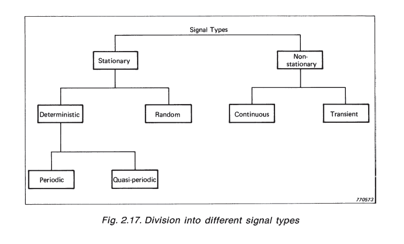

Not sure who uses the term "static" , the usual suspects denote such signals as "steady-state" or "stationary" signals. 😉
Signals are basically divided to stationary and non-stationary. If you are asking who uses the term "static", please look here where the original post is quoted
John Curl's Blowtorch preamplifier part III
however the original post disappeared since yesterday. Not only he uses this term. At least to me, "static" signal is DC.

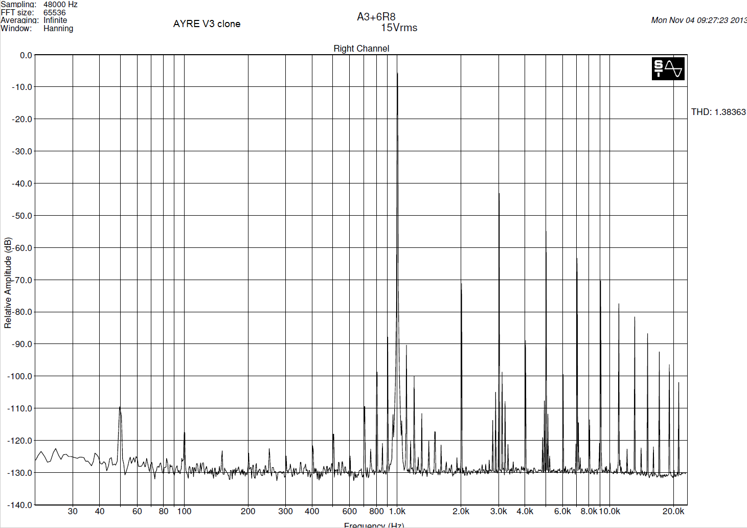

This discussion (at least when I joined it after @Terry mentioned the artifact) hasn't so far been about audibility. Rather its been, all along about visibility of the artifact in the measurements. Terry said it was visible, you said you'd never seen it so I joined the fray to point to where it can be seen. Nothing has been claimed by myself, nor I believe by @Terry about whether the phenomenon is audible (or not). That's an entirely separate, but related question.
So given that you're moving the focus of discussion to 'concern' and 'audibility' can both @Terry and myself consider you now accept its visible in the measurements? If you do now accept this then my job is done in this instance.
Well, you found a datasheet that shows it, albeit indirectly, so I will concede this point. It's literally the last AKM DAC datasheet that has an FFT plot in it, and the rest of the measurements are in the EVM pdfs.
I still have some concerns as we don't exactly know that the behavior isn't the ADC in the AP? I don't know how to reconcile the fact that the FFT noise floor appears to move vs level on the AK4399 (but not 4497), yet the THD+N vs level plot is flat until what I presumed was distortion rising out of the noise. Even if it is the noise floor rising, it's still really low and only at very high input levels. AKM does not post the FFT length or window used and if they changed any of those settings.
To be fair, I did not move the discussion to audibility. It started there, and moved to a dare to even show it in the typical datasheet measurements.
That is quite possible in respect of the 'grass' in the FFTs. Even on the AK4490 you attached there's a >10dB shift between the 0dBFS and -60dBFS. I'd be much happier to trust it wasn't anything to do with the ADC if they'd used the AP's notch to dispose of the fundamental prior to digitization. Which is a point I've heard Bruno make on occasion.
I don't know how to reconcile the fact that the FFT noise floor appears to move vs level on the AK4399 (but not 4497), yet the THD+N vs level plot is flat until what I presumed was distortion rising out of the noise. AKM does not post the FFT length or window used and if they changed any of those settings.
You presume its distortion rising out of the noise but in my way of looking at this, the 0dBFS FFT doesn't show enough distortion to make it that. So I take it to be noise, not distortion. I'm downloading the EVM data now for the AK4490 to see if there's any commonality.
Fair enough, I must have missed that earlier context.
I took another look and agree. I had edited my post but you were too quick. It's close at 0 dBFS depending on the part you look at, since the THD adds all the harmonics, but below that it's probably noise.
The THD+N vs level seems for AK4490 seems to indicate that if you listened below -10 dBFS this practically doesn't exist. Even if you listened to pop music stuck near 0 dB all day with no digital attenuation, Rob Watts is still full of it in terms of audibility.

On the AK4490, I've had a look and given its much lower distortion from the FFT I'd stick my neck out and say they've solved the noise modulation issue. This from cross-checking the THD+N vs level with the 1kHz 0dBFS FFT. The grass issue on the two FFTs @1kHz I take to be the AP's ADC as its not evident on the THD+N vs level plot to that degree - the rise can be accounted for by distortion alone.
