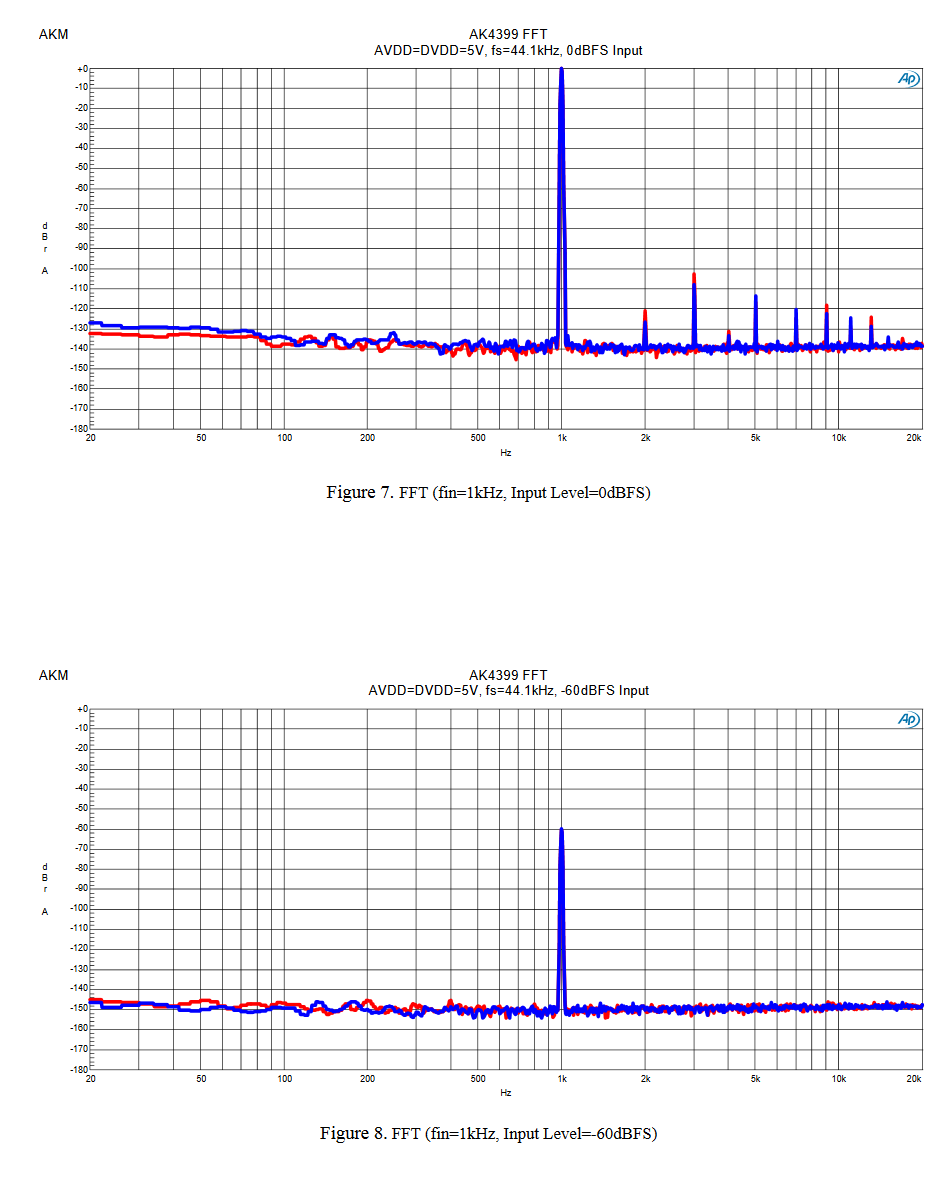

Sorry I didn't look at one of the hundreds of available parts that you say exhibit this phenomenon. Maybe you or Terry could post the part number in your infinite wisdom before we search.
Let us take a minute and go one further than the extrapolation from a table that may or may not be correct on that forum and look at the evaluation board measurements for this 10 year old DAC part. See attached.
Looks like a huge problem :rolleyes:.

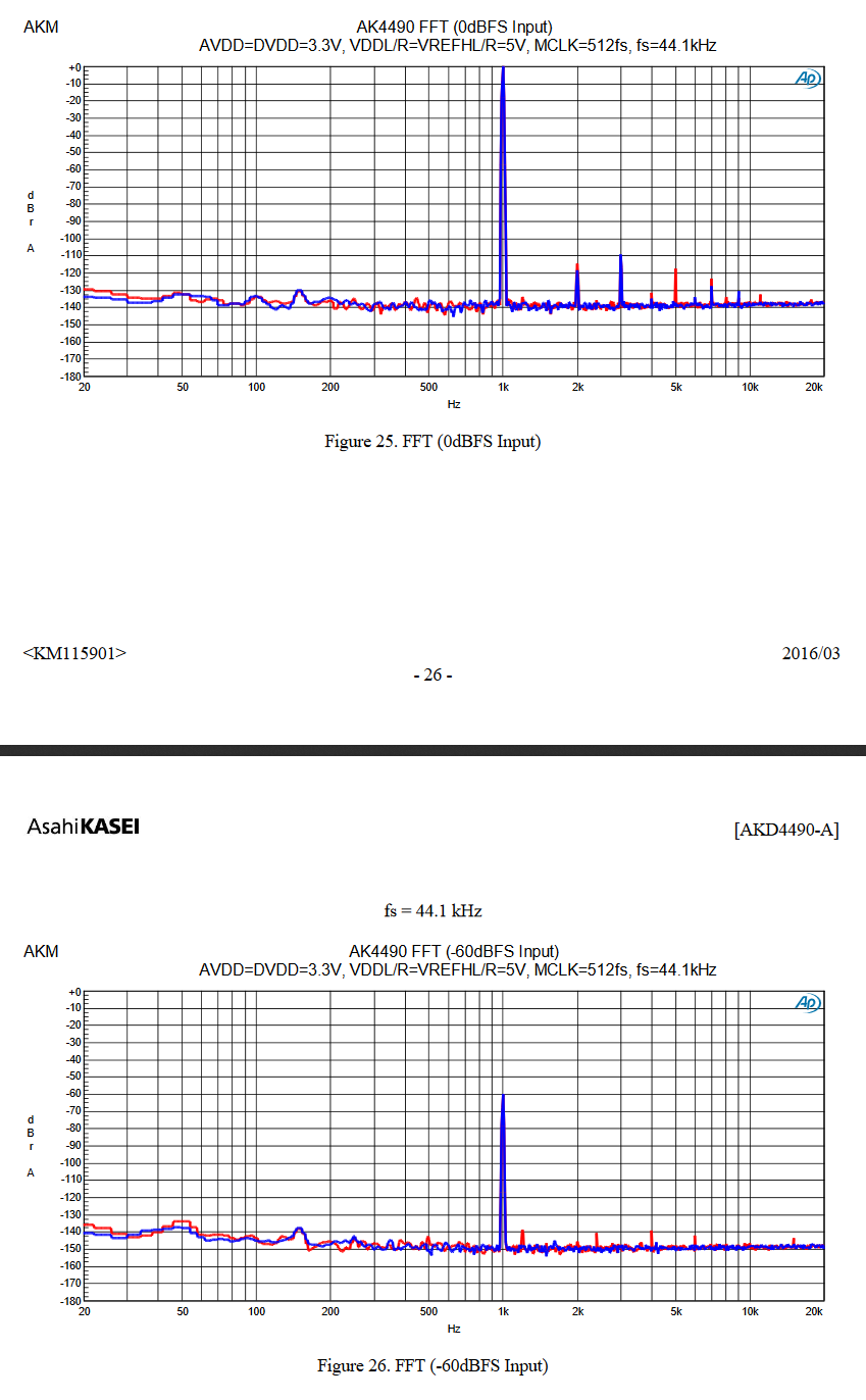

How about a more recent $5 part in singles at DigiKey, AK4490. Second attachment. Whew, I bet my wife could hear it in the kitchen. Time to break out the TDA1541.
Sorry, I looked at high end DACs, not parts that are worse than AD1955 from 17 years ago (not that AD1955 is bad, mind you).
So you're saying you cannot determine whether or not the explanation offered there is correct?
I will take a look at your plots in due course, just want to deal with the customary tilting at windmills first. Where would a post from @chris719 be in the absence of windmills being tilted at?
Talk us all through what you reckon those attached plots are showing (or not showing as the case may be), I'm all ears.

The explanation seems correct, but if you have experience with AKM's datasheets and tables, you might think twice before you assume they captured every footnote correctly and the measurement conditions are the same for each entry. I was talking about the AKM table. Maybe you didn't read the post you linked, either.
I'm lazy because I don't scan every datasheet for every DAC ever produced, and you can't be bothered to click an attachment that you can almost read without clicking on to zoom. :)

Look, I don't know what you don't understand about what I posted, nor do I care, but you seem to delight in word games, and I really don't care to play them with you. I posted the FFTs from 3 different parts, if you don't know what the "problem" being discussed was or if you have an issue with the interpretation of those, then post it and stop beating around the bush. Otherwise, shhh.
You posted the plots - are you saying then that AK4490 doesn't show the same issue that AK4399 shows? If that's your claim then support it from the measurements (and datasheet table(s)). Merely playing debating games doesn't help with understanding.
Maybe the first sentence I posted that you misinterpreted is poorly worded. I did not mean to insist that you've identified this "problem" with 100s of different parts personally. I meant to say, I did not go through 100s of datasheets until I found this specific part you are talking about (AK4399). I apologize for that terrible sentence structure.
Still, my point is that I did not go through dozens of datasheets and eval board measurements. I went to the EVM measurements of some modern high-end parts and stopped there because I saw nothing of concern - it is all highly likely to be inaudible.
There is still nothing of concern (IMO). The AK4490 shows some of the same behavior but less. The AK4497 shows virtually none. Why don't you go look in the evaluation board manuals and look at the THD+N vs level graphs they have, I should have posted them but they are even less interesting. You can find them for AK4399 also. The THD+N is flat until distortion (or noise) starts to rise out of the (flat!) noise at around -9 dBFS. So, if the THD+N is dominated by noise, if there were significant noise floor modulation vs level then why would it not show up in a sweep of THD+N vs level? I am sure you will correct me if I am missing something here. The THD+N vs level is ruler flat until near full scale.

This discussion (at least when I joined it after @Terry mentioned the artifact) hasn't so far been about audibility. Rather its been, all along about visibility of the artifact in the measurements. Terry said it was visible, you said you'd never seen it so I joined the fray to point to where it can be seen. Nothing has been claimed by myself, nor I believe by @Terry about whether the phenomenon is audible (or not). That's an entirely separate, but related question.
So given that you're moving the focus of discussion to 'concern' and 'audibility' can both @Terry and myself consider you now accept its visible in the measurements? If you do now accept this then my job is done in this instance.
