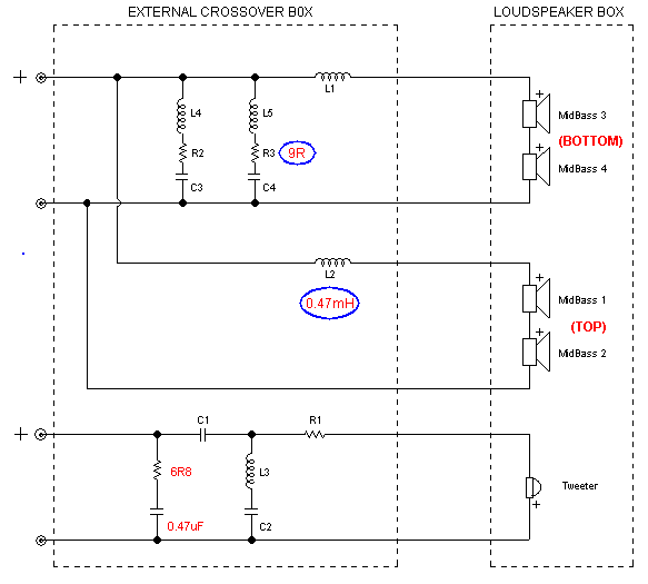

That has nothing what-so-ever to do with this subject.
Neither does what you mentioned Joe is NOT putting any resistance in series with the speaker. Why don't you look at Joe's schematic he has posted it.

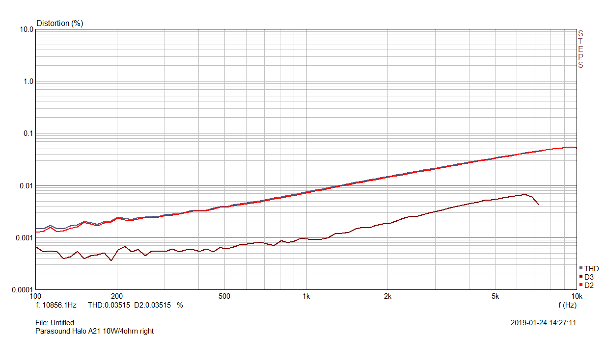

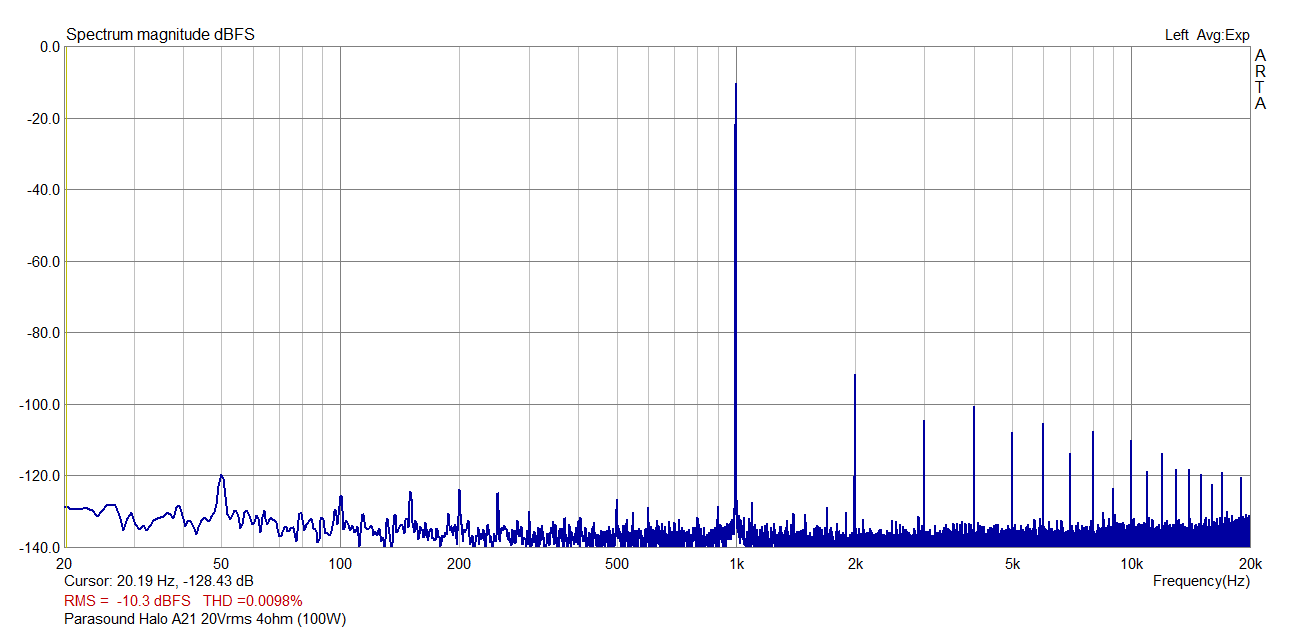

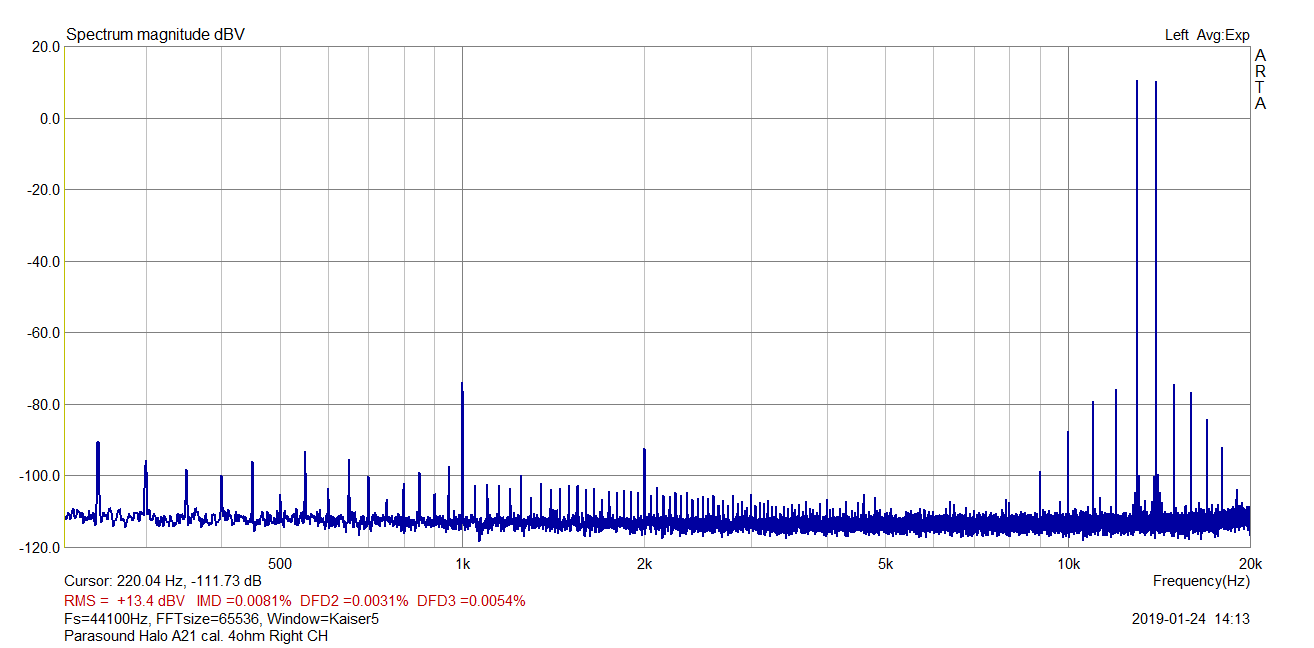

Loudspeakers, because they operate open loop, SEEM to be much more important than almost any amp, static measurement for static measurement, BUT low distortion in amps is usually achieved by adding negative feedback, AND this does not seem to improve the sound much, if any. A good 'open loop' amp with modest distortion (compared to others) might sound better than a 'zero distortion' amp. That is our experience, and has been for more than 50 years.
No mention of room acoustics? :scratch:
Huh ...
So, this is "good"? Yes, "static" measurements considered by some. I do not think so. And we are not in 1970.
