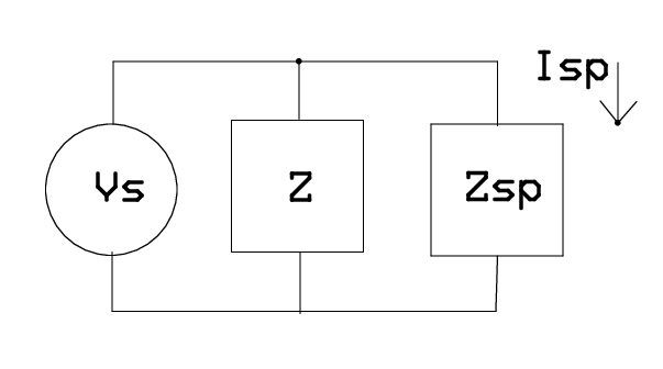

Here Joe the I in the speaker is the same no matter what impedance Z has. It's known as Ohm's law. We understand you are not using current drive, but you are not controlling the current in speaker either.
Correct, but amplifier output current is controlled, ie amplifier output current is in phase with/matches amplifier output voltage. Eliminating amplifier/cable/loudspeaker harmonic currents removes a bunch of system dependencies and this is just standard simple electrics 101, Joe is correct except for his terminology. Another way to describe Joe's approach is that circulating currents are between loudspeaker input impedance compensating network and crossover/drivers and not between amplifier and loudspeaker, same deal this is electrics 101. As per electricity distribution systems, elimination of circulating currents reduces resistive losses and effectively improves system efficiency.
Dan.
But it doesn't, all the speaker current still flows in the amplifier. Sorry introducing the garbage amplifier argument is a misdirection. The claims are a class A/B amplifier can't be made that works, this is wrong.
Come on, the shunt networks increase current and degrade efficiency.
- which makes no benefit if the amplifier is not ill-designed. Additional load only increases distortion, though this may be unimportant. Additional load concept is a nonsense. I will probably be very strict for the reason that people like you and Joe are spreading superstitions and and technical nonsense which the beginners may take as a fact. I am not sure why the nonsense is supported, one reason is the ignorance and the second one are commercial reasons.
I am not claiming that a Class A/B amp can't work with reactive load. I am saying that the output stage drive voltage is quite different for reactive load compared to resistive load and will contain harmonics in order to maintain constant output voltage condition.
In my experience the result is counter, ie with speakers measuring flat impedance out past 40kHz amplifiers run cooler at high output power.
