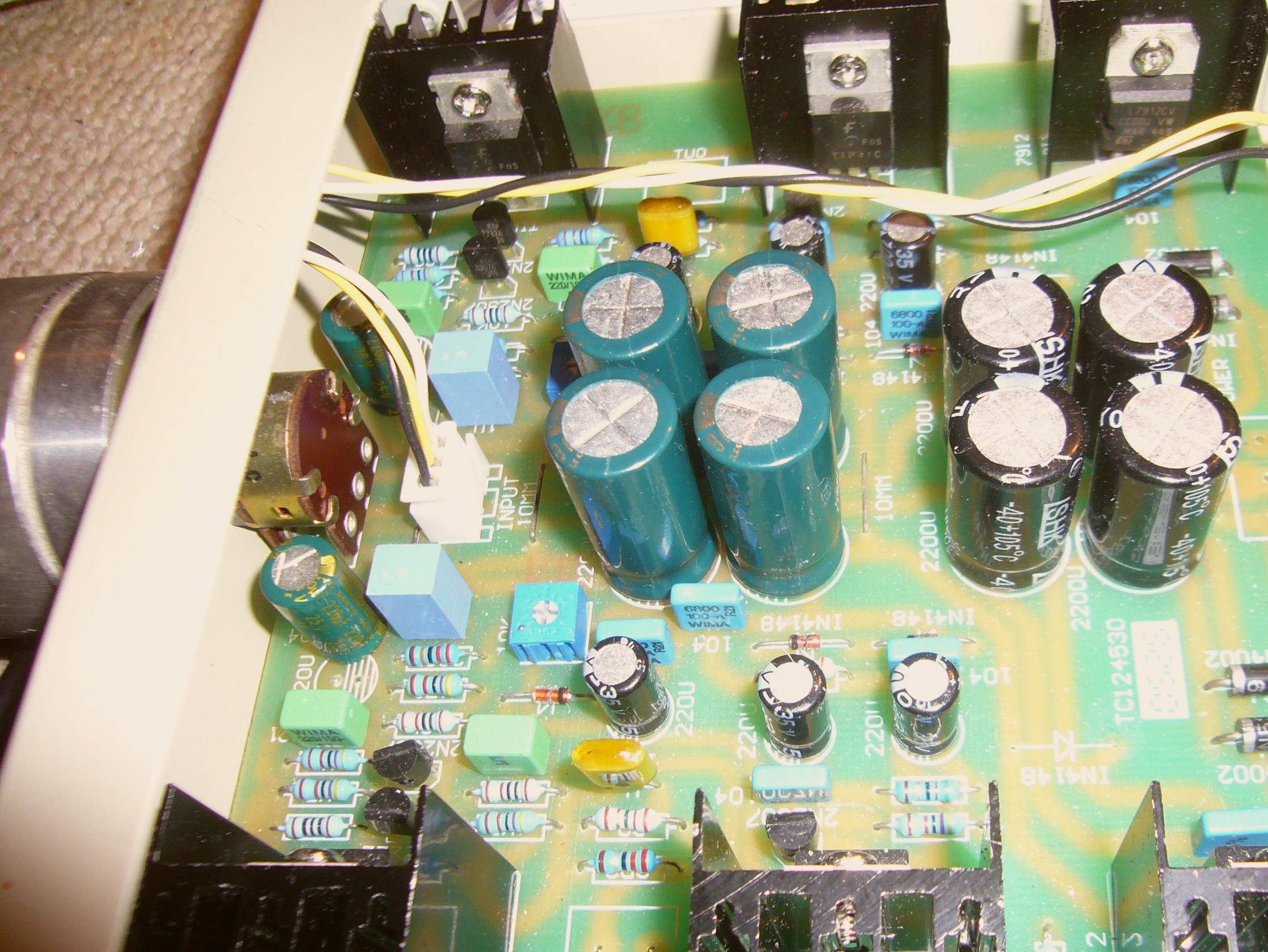

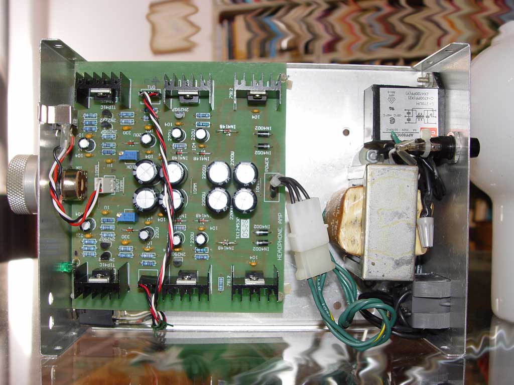

I bought one of these on fleabay (see pic) and wasn't too impressed with the initial sound It turned out they had used horrid ceramic caps on the input,
they were first to go, this brought immediate gains in fidelity.
I then decide to pull all the ceramic bypass caps and replaced with wimas,
more improvement.
Onto the electros, feedback cap 220uF replaced with quality low ESR Sanyo cap
The four smoothing caps replaced with Nichicon low ESR
I felt there was too much gain in the amp to drive HD565 ovation cans, so the 470 ohm was raised to 2K2 .
This thing now sounds fantastic very quiet clean crisp highs and great bass.

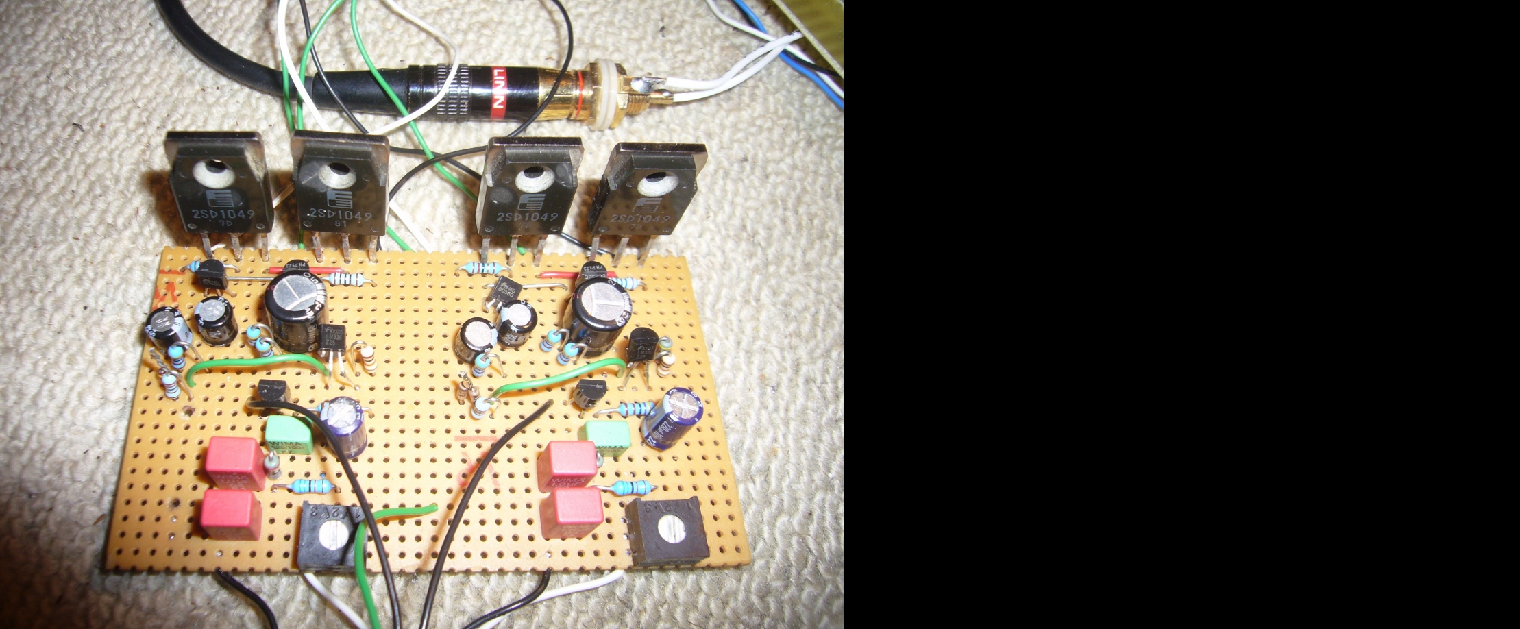

I felt the size of the thing was overkill to drive a pair of headphones so decided
to build one on stripboard the new one is less than half size including the 317 337 power supply.
R11 is now 12 ohm R5 is 4K7 C5 R8 C8 and R12 have been omitted. C4 is now 470uF
LM336 2.5v voltage ref used for DC offset.
I cant believe how good this thing sounds for only having 5 transistors
Its dead silent no hum no hiss just great clean music.
And no it doesn't oscillate.

.... I am also interested in this circuit.
Do you have an update?
* If you mean modifications...No. I wanted to make a new board but various unrelated problems have delayed everything
What ended up as your final configuration?
* The only main difference was to use an LED instead of the two diodes D3 and D4
Does it work well as a preamp AND headphone amp, or should it be optimized for one or the other?
* Works very well either way. No modifications required.
What PS?
* I used an Lm7812 and LM7912
Other observations or comparisons?
* Sounds better than some other preamps I have like Rotel's. I don't have a megabuck preamp to compare it with. Basically with preamp in or out of the signal path to a power amp , I prefer using the preamp.
* Concluding. If adding the preamp doesn't degrade the sound ( often improves the sound in subtle ways ) and your ears like it ........it is YOUR own mega-buck preamp ! Build it. It's very musical and no loss at either extremes of the frequency range.
Note I think someone complained about offset drift in the split supply circuit. I never had that problem. Drift it might but by very little. Depending on the dissipation of the output transistors you need to use a suitable heat sink to keep the temperature rise to acceptable levels.

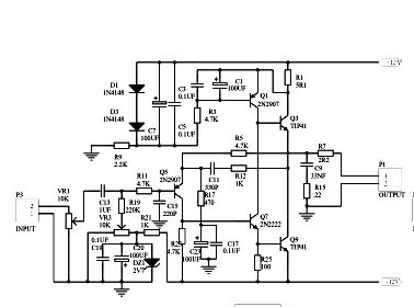

I think the feedback cap was supposed to be 100 uF. What happens when you double the value?
Hotiron, Hope you replaced/didn't use the input volume pot during your listening assessment.
The four smoothing caps sit 'behind' the 78xx/317 reg. ICs so the amp does not "see" them, or the rectifiers or the transformer.
If you double the 100uF feedback cap the LF roll off of the NFB loop will go down. F-3db = 1/( 2*pi*470*100E-6) = 3.39 Hz
That's pretty much out of the audible range. So you might not gain anything.
Your input capacitor is 1uF with an input impedance of about 220K on the amp. Hence F-3db here is = 0.72Hz ! However note that you get phase shift even if the db levels are low. So raising the F-3dB frequency will increase phase shift at low frequencies. If it is large it might affect how transients in the bass can sound.
You could get F-3db at 7.2Hz by using a 0.1uF cap instead of the 1uF cap. Chances are you can get a much better sounding input cap at 0.1uF or 0.22uF !
Cheers.
Cheers.

Synchron Hi.
The NFB cap that came on my board was a very cheap and nasty 220uF and still is 220uF but its a Quality Sanyo low ESR Job.
We also have four smoothing caps after the regs which sit "between the regs and the amp",
Its quite clear in the pic which ones I've replaced.
Had I had eight of them to hand I would have replaced all eight!
Because the ones infront of the regs are just as important, any spurious crud
infront of the regs will hinder their operation and flood the amp with noise! Its Class A remember.
So this will of course happen, Once my stock is replenished.
