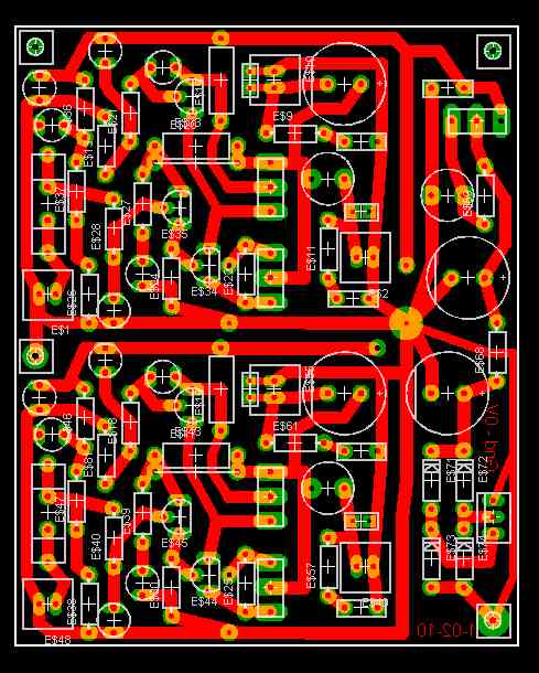

The ground point is actually a 5mm round pad . Capacitors connect up on one side and the amp grounds connect about 120 degrees away from it.
However I just realised that one channel has 40mm of track common to the transformer 0V line .😱
I can fix that easily. Will do it and compare the FFT to see what it has done with and without a test signal.

Yup. That shared section made all the difference. It's dropped to about -76dB wrt to the output at 1 volt. That's close to a 20dB drop !
It's close to the 2nd harmonic level. I must try to get it down a bit more.

My current layout is not good enough. I have had to cut traces and add external wires to sort out the earth. Let me finish the modified layout. I'm trying to keep the pcb size down which is already about 80 x 100 mm .
The additional earthing traces require space or I will have to move the parts around and see if that can reduce the tracks. It's and interesting problem but will take some time.

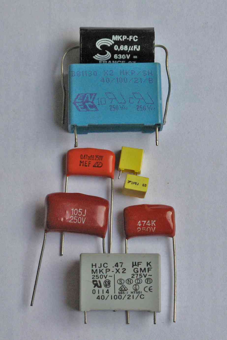

Did some more listening tests with different input caps. From what I have I'd pick the Solen followed by the Epcos X2 caps and then the low cost film caps. I'll post a picture rather than descibe them. Top would be best and bottom would be least preffered. However I'd like to point out that even the bottom one sounds quite good by itself. If listened to with large time gaps I think it would be difficult to differentiate between them.
Here are the caps. Best one on top and going down with decreasing performance. Most are quite decent though the grey X2 cap at the bottom doesn't sound as good as the rest. The blue cap is an Epcos 1uF X2 cap.
Caps in the same horizontal line are fairly similar to each other.
I'd say the Solen ( 0.68uF) has a slightly fuller sound on voice and bass ( just a wee bit ) and piano notes are just a bit more incisive.
But the difference is not 'night and day' ! The nay sayers might say that there wouldn't be a difference. Well it doesn't matter. I'll just put the cap that suits the cost of the rest of the board and which doesn't 'sound' bad. That might be the yellow box cap !

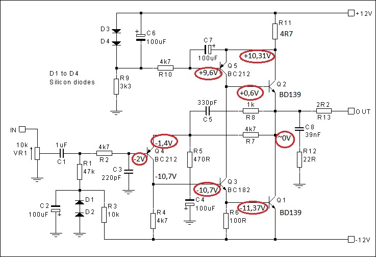

Hi!
I built the first JLH amplifier with +/-12V supply.
In my opinion something's wrong with it. The heat sink becomes very hot within half a minute. The heatsink is quite big, much bigger than Ashok's one on the photo as I see. It eats about 400mA, that's too much, isn't that?
I am afraid it may die if runs too much, but I measured some part of the amplifier . I attached a picture. On it there are some value that I measured using a multimeter.
What do you think? Is there any problem with it?
Thanks.
Thanks.
Why is the base of Q5 measuring 9.6V instead of 2x Si diode drops below 12V?
Plus R10's drop, I would have expected to measure something in the high 10's.
Check if D3 D4 are oriented correctly in the real circuit?
Kenpeter is right. The voltage at the base of Q5 should be about 10.8 volts. You can change R11 to reduce the bias current in the output stage. Right now it appears to be about 0.110 amps . Additionally you must make sure the heat sink is well installed on the transistors. Silicone grease is a must on both sides of the insulating mica washer !
You must remember that in my circuit the supply is a "single" +12V supply. Voltage across the output transistors is about 6 volts each and so dissipation is "half" of what you have. You can drop the output current to just about 80 mA ( R 11 = about 6.8 ohms) to drop dissipation and you will still get enough output on a 32 ohm headphone to permanently damage your hearing ( over 110 dB spl ).
The base of Q4 also seems to be a bit high. It should be about -1.2 volts. R1 and R2 voltage drop will reduce this voltage a bit ( sim value -1.18 V ). Diodes oriented correctly ?
Do you really get 0V at the output with the components shown ? The sim shows +0.904volts ! R7 and R4 determines the output dc voltage. R7 is supposed to drop the difference of the two diode drops - (R2+R1) drops - Vbe drop of Q4. Any missmatch here will cause an error. R4 could be adjusted to get 0 V at the output. Note that R7 and R4 have the same current flowing through them (approximately). But R4 has 1.2 volts across it. So R7 will have too much across it to get 0 volts at the output. Alternatively D1/D2 should actually have one more diode in series with them! Easiest method I think is to adjust R4 and/or R7 to get less than 1 mV at the output. We will have to check how much the dc drift will be with time.
