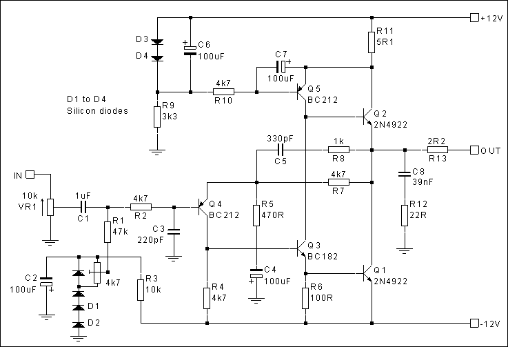

I found what the problem was with my amplifier. I used BC212 transistors as a E-B-C, but there are two kinds of BC212. My ones are C-B-E. Damn! Fortunately, after I changed the polarity, the amp got up well. Its temperature is very good, and the bias current is about 100mA (R11=4,7ohm). But you were right. I got +0,9volts at the output 🙁 But I am still happy to have a well-operating amplifier 😀 There remains no more but to find out the solution how to get 0V at the output.

Hi, I gave you the solution to fix the output dc voltage.
Just use a pot for R4 . Or use a fixed resistor in parallel with a variable pot.
Like say a 10 K resistor in parallel with a 10 K preset. Set it to give 4.7K ( measured with a DMM with power off) and then adjust it with power on to give you < 1mV at the output.

I tried to use a 11,52K for R4 instead of 4,7K. Output DC was nearly 0V, but it was changing slowly. Starting from +13mV to -12mV, then up to about +10mV again, and back 😀 It took minutes, not seconds.
Using 12K R4 it was -40mV, with 10K it was +100, so I will really need a potmeter. The problem is that the voltage is not fix, it is changing.
I don't expect the dc to stay fixed.It's referenced to base emitter voltages and diode drops. These are not in physical contact with each other and hence not varying by the same amount ( deg C ).So dc will vary from the set point. Best to set it ( several times) after 30 minutes of power on. It might have a reduced variation. Varying isn't the problem. Varying too much is the issue. I wanted the diodes to be mounted on the same heatsink as the output devices. Unfortunately I am getting no spare time to finish my pcb ! I hope this weekend is good.

I changed the circuit to set the DC to zero. I use a 10K pot, not a 4,7k.
It seems to work. I can set the DC to be about zero, but it's changing a bit. After a long it moves slightly, max. 1-2mV. But the heatsink is very hot. It's not a small one, so I don't know if it's normal or not. And the heatsinks on the 7812/7912 are very hot, too. Maybe the 4,7ohm R11 is too low? But as I measured, the offset is 110mA, and the stab ICs are 2A ones.

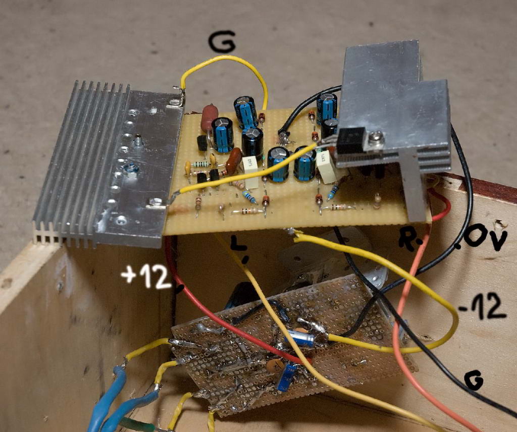

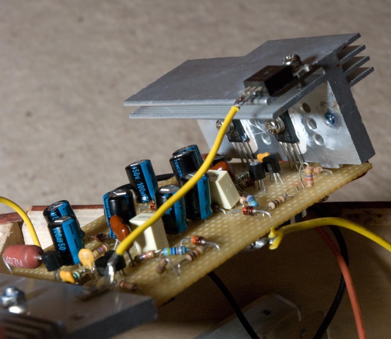

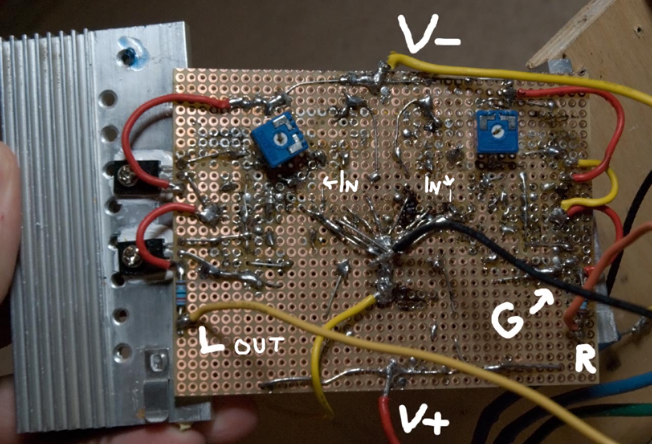

Here are some picture.
The chassic is wooden. 🙂
"Low level ground must not 'ever' carry/share any dc supply path." I don't understand this sentence. What do you mean? What am I supposed to do?
Anyway I tried to grounded it to the earth, but it didn't help. As you can see I connected the heatsink to the ground, no success. Not to say, since I did it, It has made a noise when I touch the heatsink with any metal.
I have recorded the sound effect from its output. I hear that when the 'Left' output cable draws close to the 'Right' cable, or if the headphone cable writhes (spiral).

Check any capacitive coupling ( due to close wires ) between output and input.
The input and output are far away from one another as it is seemed in the picture I attached.
But, maybe, I found the source of the problem. I bought the C5 capacitor as a 330pF, but at home I recognized that it was only a 33pF, because the text on it is '33'. I will try to get a truly 330pF and see whether it solves the oscillation or not.
I hope your amp will be all right 🙂 Good luck!
I think you might have to look elsewhere. Maybe even the power supply ?
In my sim of the circuit 33pF does not show up any problems . All transistors are BC5XX and BD136 output . I didn't really think the 33pF caused the problem as it would just oscillate and not whistle with a variable frequency like it is doing now. It's like a signal generator , sweeping over the full audio band !

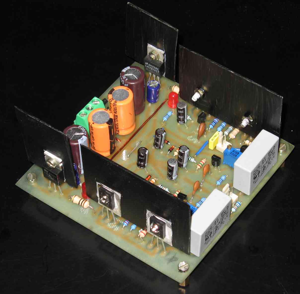

OK I finally finished the board and assembly. One channel seems to have a problem. I'm sure I made a mistake somewhere becaused I reversed the board layout ! I'll fix it tomorrow.
However the other channel works. I'm able to set the dc output to around +/- 1mV . The meter reads 0.000 V . It didn't change for about 1 hour that the amp was on. Will have to look at this closely tomorrow. I did set the dc offset after a 30 mins warm up period.
Frequency response was flat ( 0dB ) at 20 Khz and -0.2db at 20 Hz with a 33 ohm load. Max output ( 1% dist ) was about 3 Volts rms into 33 ohms.
Max output into 10 K ohms load was about 7 volts rms( less than 0.1% dist).
Second harmonic was at -74.2 dB and 3rd harmonic at -75.8 dB. All other harmonics were at -95dB or below.
Pity the second channel had a problem. I couldn't listen to it. Note that I'm getting a higher level of 3rd harmonic distortion now. The single supply unit had practically only second harmonic distortion. Must try to see why that is so. The noise floor is also very low and you can hardly see any power supply harmonics ! So there should be no hum on the can's.
The heat sinks do heat up but I didn't measure the temperature. Quiescent current appears to be at about 0.1A in the output stage.

Which version did you build? Is the potmeter for the 0 DC instead of R4? Could you show us the schematic of power supply? I try to find out why I have hum.I'm able to set the dc output to around +/- 1mV . The meter reads 0.000 V . It didn't change for about 1 hour that the amp was on. Will have to look at this closely tomorrow. I did set the dc offset after a 30 mins warm up period.
Could it be the problem that I have +11,7V and -12,1 voltages at the power output?
The one with the split supplies. The red LED is used in place of D3 / D4.
...Is the potmeter for the 0 DC instead of R4?
Yes the potmeter is used in place of R4. I used a 10 turn preset as I had that.
10 K ohms.
