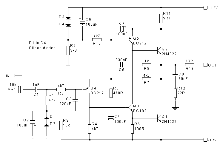

I tried the JLH headphone amps as a preamp. Works very well. Doesn't make the source sound slightly softer like many average preamps do.
Doesn't it make some noise? It's output has low impedance but a preamp usually has high impedance at the output. Is it not a problem?I tried the JLH headphone amps as a preamp. Works very well. Doesn't make the source sound slightly softer like many average preamps do.
(I look forward to the PCB's 🙂 )
"........ a preamp usually has high impedance at the output....."
I think you mixed it up. Typically a preamp has a high 'input' impedance and low 'output' impedance to enable it to drive the cable and power amp load.
If you wanted a slightly higher output impedance , all you need to do is to add a 100 ohm ( or whatever ohms ) resistor in series with the output .

Melorin. The preamp has a low output impedance so that it can easily drive the power amp which is not always a high impedance ( unlike tube circuits). It can be as low as 1K ohm in some cases and typically 10k to 20 K ohms. It also needs to drive the interconnecting cable which will have capacitance. With the output impedance of the preamp this becomes a high pass filter. So depending on the value of the capacitance and load impedance you can determine the limiting preamp output impedance to ensure no loss of HF . Often you will find that if a preamp has a 100 ohm output impedance , it is due to a resistor put in series with the output by the designer. The preamp circuit having a very low intrinsic output impedance by itself. It also prevents the preamp from facing a direct capacitive load ( of the cable ) which isn't liked by many circuits.
However this does not mean that a high preamp output impedance will not work ! It will act as a signal divider and will reduce the effective signal available to the power amp and the capacitance loading will have to be looked at very closely to ensure that HF roll off is outside the audio band.

Further listening tests as a pre amp.
Some more listening tests with the JLH headphone amp as a preamp.
I raised the gain from x 3.2 ( +10dB) to x 5.7 ( +15 dB) because on some discs the signal level was quite low and and even turning up the volume to max didn't clip the power amp output.
Well, it sounds very good. My best configuration was a Solen cap at the input and with no output cap. The power amp has a Solen at it's input. Sounds very good ! The single supply version isn't very far behind either. Though it has about +6 V dc at it's output we can remove the output cap if the power amp has an input coupling cap , which my amp has.

How did you rais the gain? I am thinking of easing down (?) the gain so that it can be too loud for me (could be if it worked well 🙂 ).Some more listening tests with the JLH headphone amp as a preamp.
I'm still listening to this combination! 🙂
Alter R13 and R8 from the circuit shown in the post #15.
I had used 3.3K and 1.5K respectively and changed it to 4.7K and 1 K .
To decrease gain you need to increase R8 from 1.5 K to (?) for example 3.3K . In that case the gain will be x 2 = 1+ R13/R8 . removing R8 will give unity gain. Must also check if the circuit is stable . R13 affects the output offset adjustment and you will need to readjust the preset if it is changed.

Single supply circuit hum as preamp !
I find the single supply circuit has some hum ( right at the speaker) . I guess the supply will have to be better than what is shown for use as a preamp. However the sound is very smooth. Like a tube preamp. The FFT did show fundamental and second harmonic with higher orders almost burried in the noise which is also very low.
You might want to use the best possible cap at the input. I don't mean by price but by sound. Someone will have to check which type is most suitable.

About the hum.
Ground path routing , Ground path routing , Ground path routing..................
might still need at least about 10dB improvement at 100Hz. Guess the psu can do that. I can hear a "faint trace" of 100Hz one inch from the driver ! 😱
For use as a preamp only...
You can change R6 ( 22 ohms) shown in the circuit found on page
http://www.diyaudio.com/forums/headphones/159202-jlh-headphone-amp-2.html
Increasing R6 will reduce quiescent current in the output stage and hence the output stage dissipation. Possibly go down to something less than 20mA and avoid a heat sink altogether. R6 could be something like 56 ohms. I used a string of resistors at hand (22+22+10 = 54 ohms) and it worked out fine at low loads ( 1 K ohm) . Maybe still useable with 300 ohm headphones .
Sim says that it will work fine with 300 ohm loads and should be quite listenable with 32 ohm loads at average levels. Distortion figures in the sim might be a bit too good ! Neverthless they shouldn't be too high either.

More listening tests.
This might sound odd but I've recently been using a LM1875 power amp for testing the JLH headphone map as a preamp. This is because the LM1875 chip has a certain quality about the bass end and mid range that changes dramatically with different front ends as compared to the direct input to the chip.
Especially the tight foot tapping bass changes remarkably with different front ends. Many tubed front ends also 'lost' the bass magic in this setup ! The JLH split supply amp comes very close to being transparent and retaining the quality of the bass end. However it also depends on the input cap on the preamp. Solens do well as do some Epcos caps. Final choice probably depends on personal taste. I find the Epcos slightly smoother ( rolled off a bit ? ) than the Solens. But certainly better than a cathode follower that I tried with a 6DJ8 .
I try very hard to understand why this is so but haven't been able to figure out why. The difference is very audible and I don't just trust my own ears. I ask unsuspecting friend to guess if there is any differenc in what they hear. I don't tell them what's being done. Just ask if the sound is the same or different when switched several times.

While listening to this system it occured to me that the dual diode used to bias the input transistor wasn't required if the circuit is used as a preamp as I have used it. This will cause a dc offset of about 1 volt or more depending on the value of the feedback resistor. But as the input to the power amp is capacitor coupled this shouldn't matter.
It sounds very nice and I tried switching between the two schemes ( with at least a two minute time lag ) and I think I hear a difference. I can't be sure if my brain is playing tricks. This needs to be checked with less time lag between the tests. I think I'll try a remote controlled relay.
