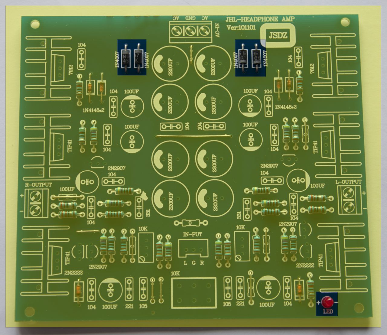

Step 5 and 6 Resistors and rectifier diodes II
Picture List
Comments
Tip : Please double check the 1N4007 direction
Picture List
- Rectifier Diodes and LED
Comments
- The 1N4007 has a sliver band which denotes the cathode and this band can also be found on the PCB,
- It is VERY important the 1N4007 are fitted the correct way around in the PCB
- The LED has a very tiny flat on the side of the round case with a longer leg this again denotes the cathode. This is the - or negative connection of the LED.

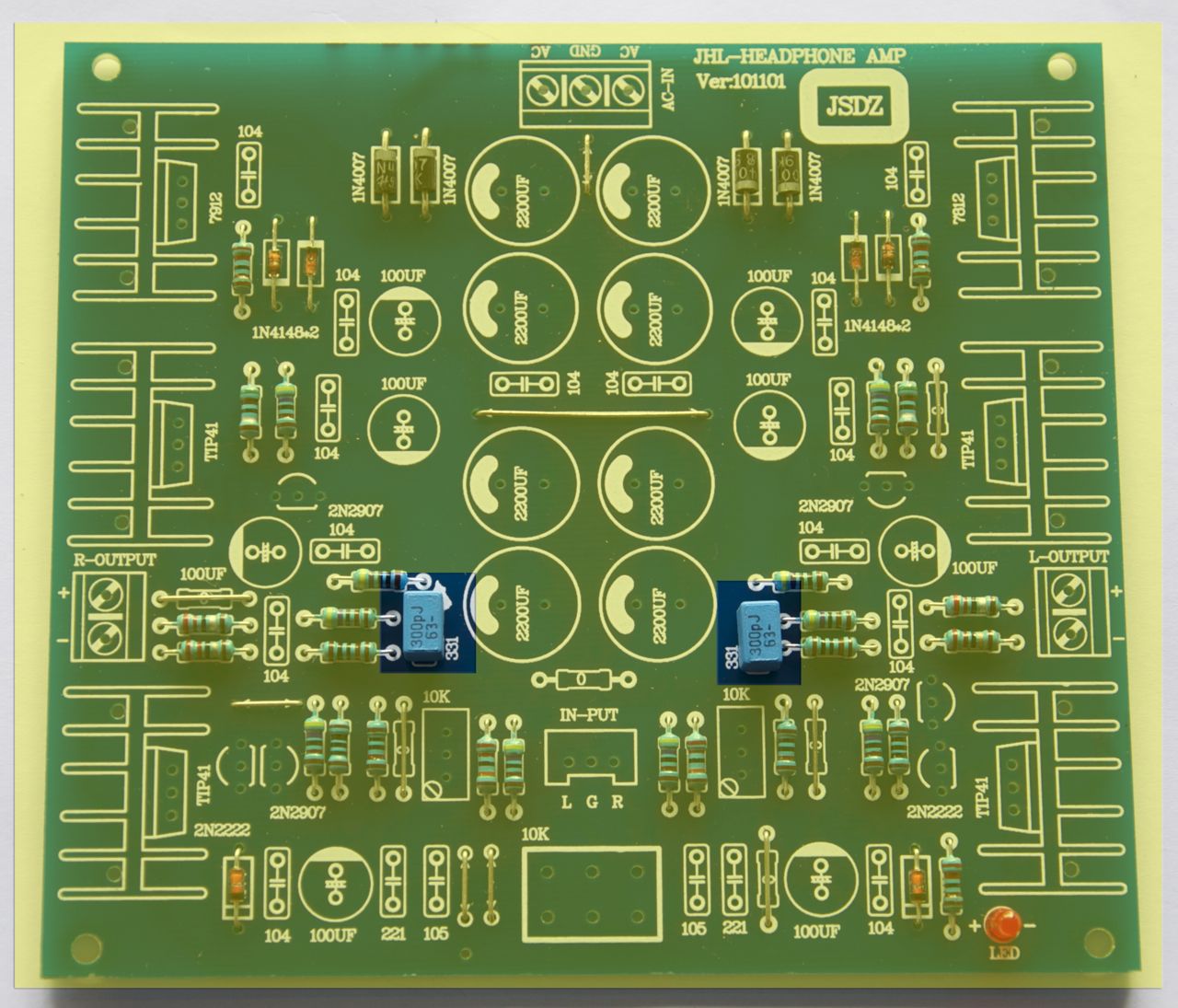

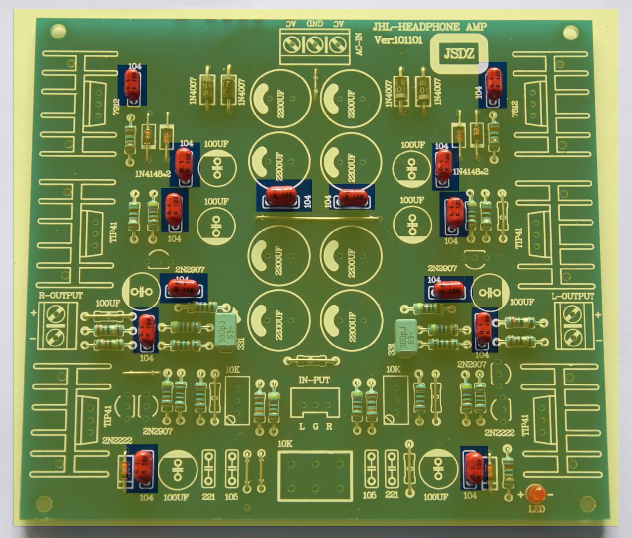

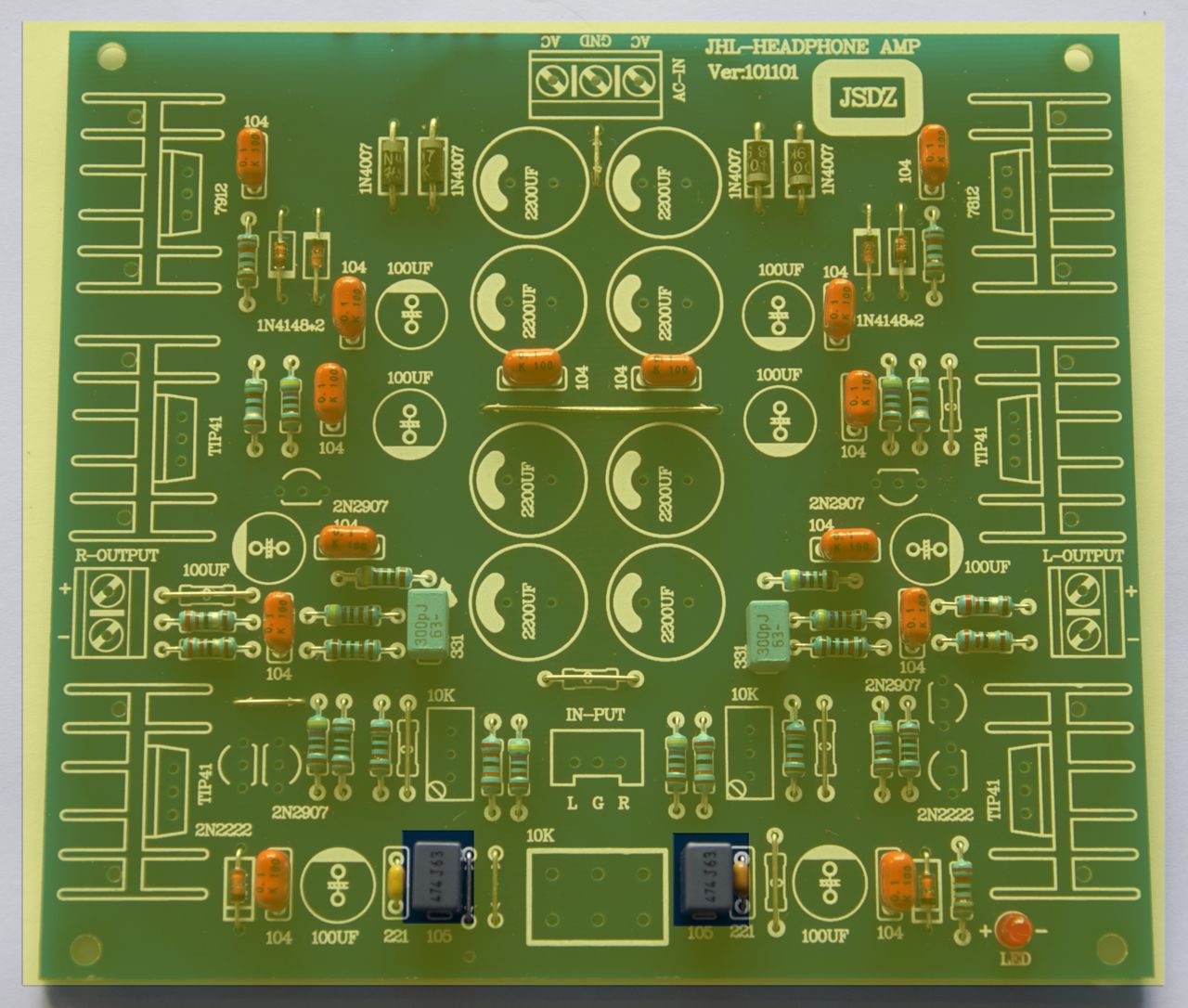

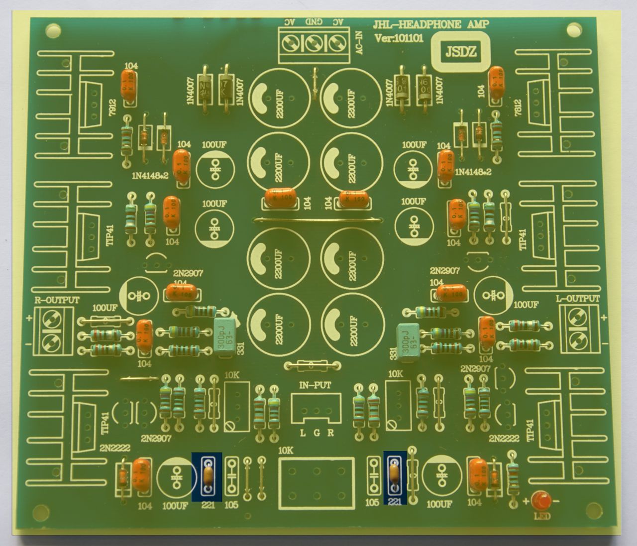

Step 8 Capacitors
Picture List
Comments

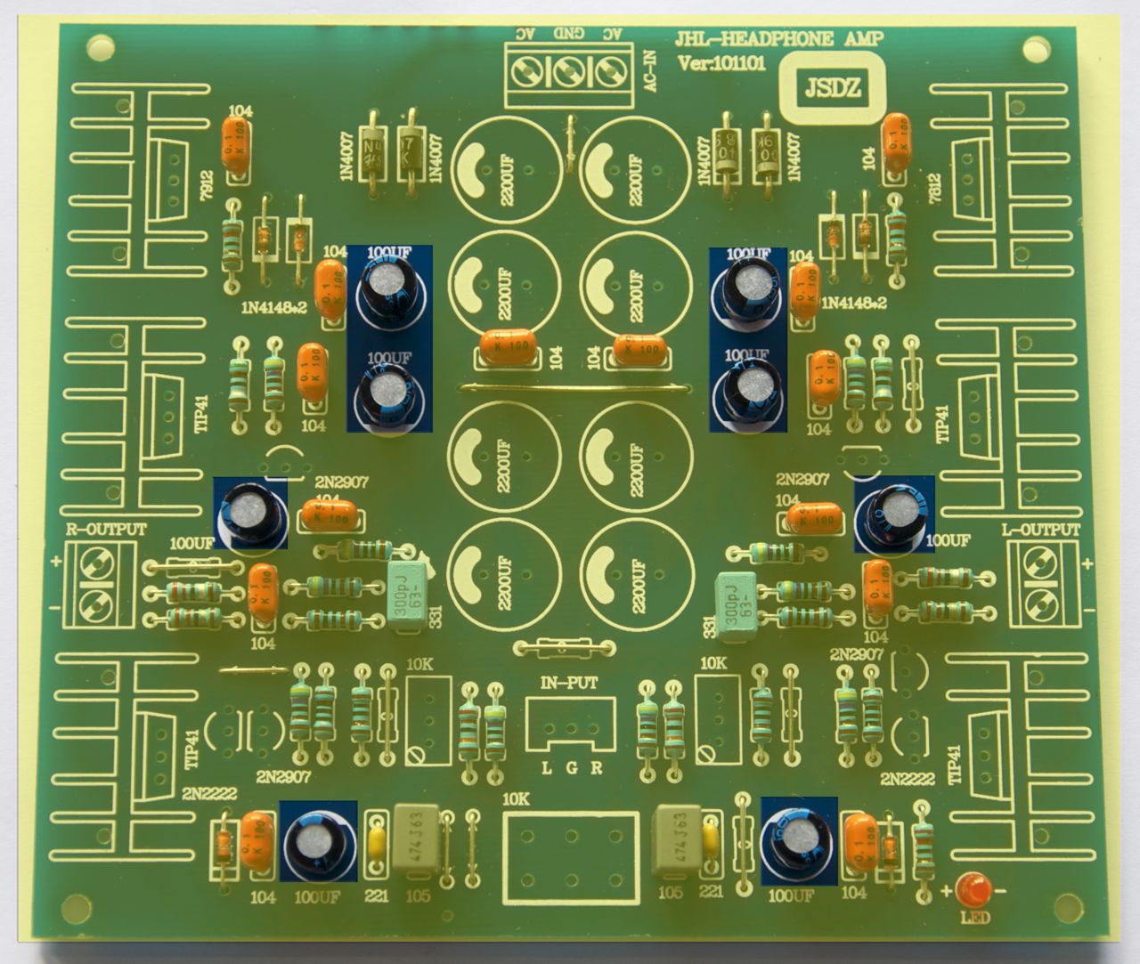

Tip : Solder ONE leg of a capacitor first. Then re-melt that soldered leg pushing the cap against the board. This makes sure the capacitor doesn't wobble .. Then proceed to solder the other leg in the normal manner.
Picture List
- Capacitor 330pF - 2 off
- Capacitor 0.1uF - 14 off
- Capacitor 220pF - 14 off
- Capacitor 470nF - 2 off
- Capacitor 100uF - 8 off BEWARE OF POLARITY
Comments
- I would strongly suggest that the build order above is followed, otherwise the small capacitors would become a real pain to fit.
- Either side of the potentiometer the board requires a capacitor of the value 105 which is shorthand for 10^5 or 1uF or 1000nF or 1,000 000pF These are NOT included in the kit of parts but 0.47uF or 470nF I believe has been substituted.
- The 100uF capacitors are marked on one side with a minus sign and a shorter leg. The PCB is marked with a smile and this is the negative leg.
- Failure to insert any electrolytic capacitor with the correct polarity can lead to CATASTROPHIC consequences.

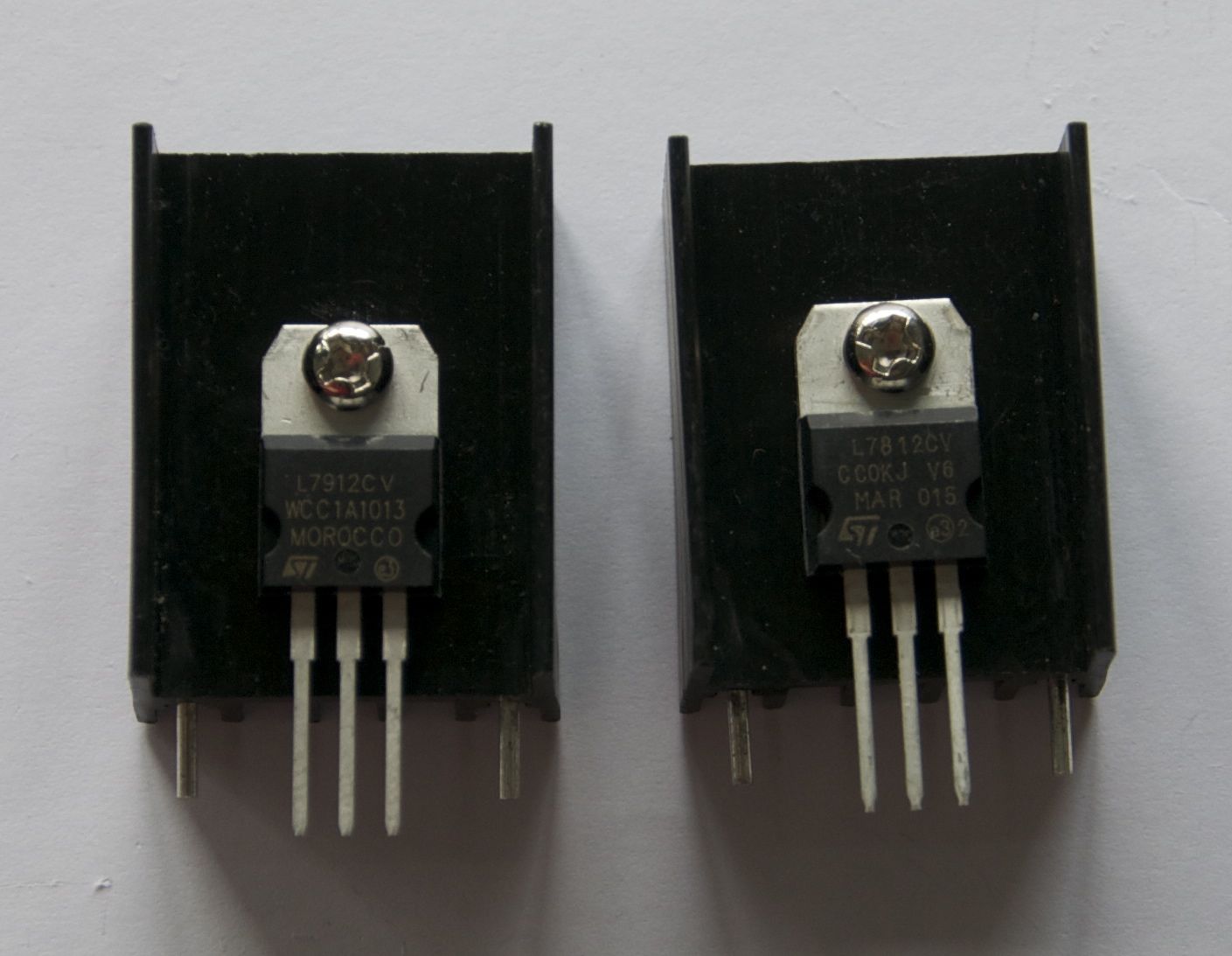

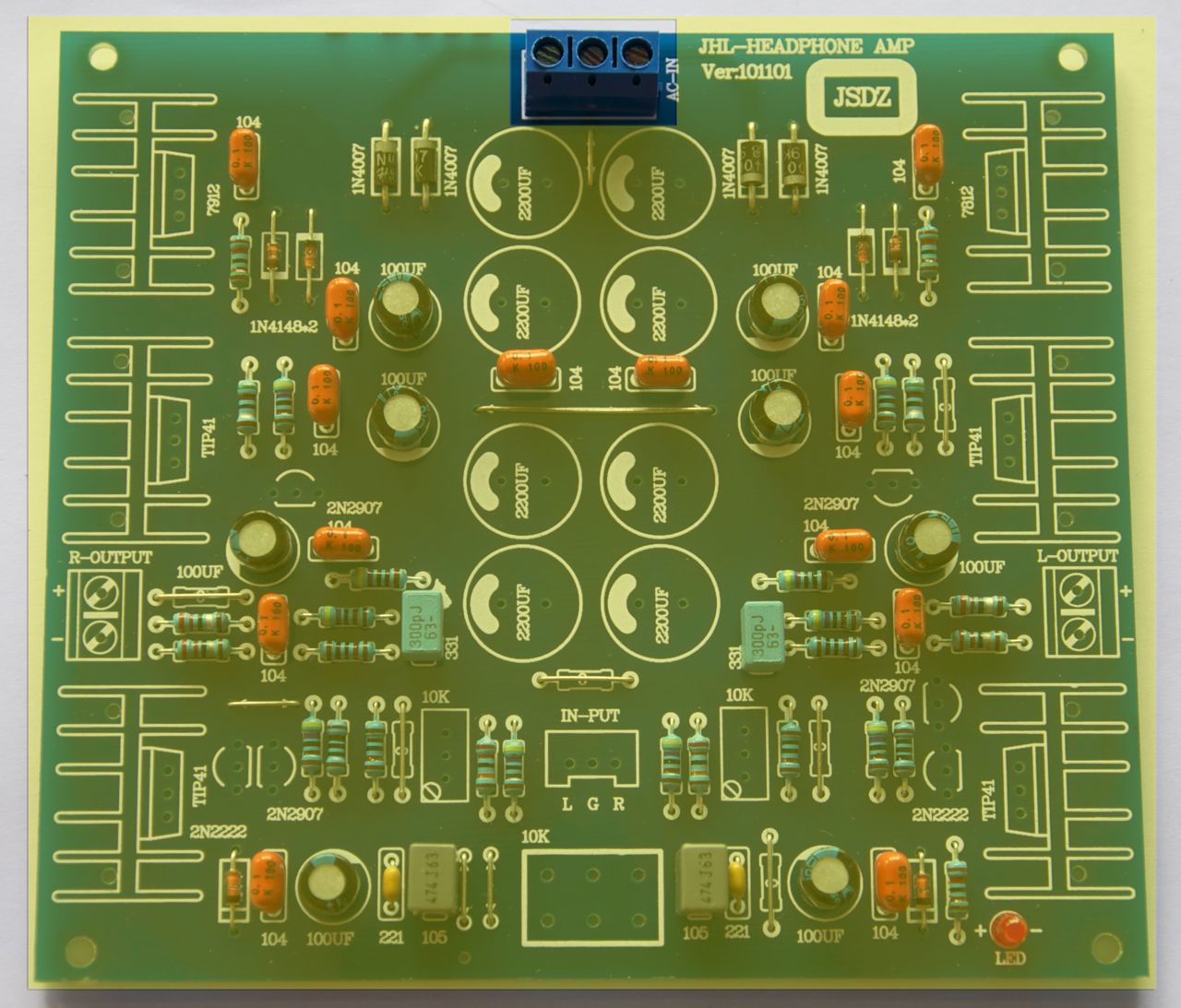

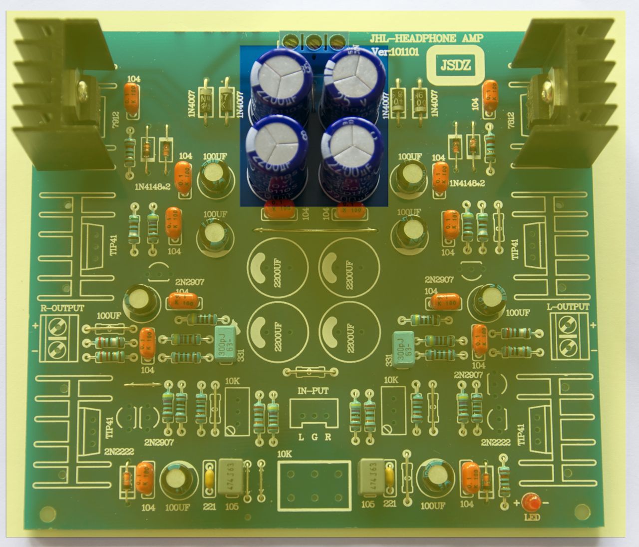

Step 9, 10, 11 and 12 The Power supply
Picture List
Comments
Tips

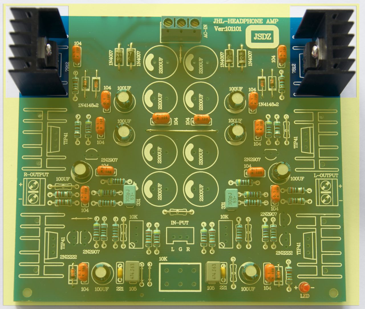

Next the power supply of the board needs to be tested.
Picture List
- Vin Connector
- Voltage Regulators assembled on to heasinks (See tips)
- Voltage Regulators mounted onto the PCB (See tips)
- Capacitors - Smoothing 2200uf 4off (Pre-Regulator) BEWARE OF POLARITY
Comments
- There is a slight misalignment between voltage regulator and the heatsink alignment holes on the PCB. The regulator pins are not quite straight when all is complete.
- The 2200uF capacitors are marked on one side with a minus sign and a shorter leg. The PCB is marked with a smile and this is the negative leg.
- The voltage regulator part numbers are very similar, 7912 and 7812 care is required at this stage. The 7912 is require for the negative -12V supply and mounted to the left of the board as shown with VIn at the top. To the right is 7812 which is the positive +12V supply.
Tips
- Soldering the Vin connector it is very easy to have a gap UNDER the connector to the board. Simple trick is to solder the centre pin of the connector first, check to see if the connector is flush to the PCB and solder the outer two legs..
- Can I suggets that the voltage regulators are mounted onto the heatsinks with the screws LOOSE...
- Solder the middle pin of the regulator first, then check to see if the assembly is mounted square and flat to the PCB. Now solder the other legs of the regulator and the heatsink. Finally tighten the screw on the heatsink.
- The large power supply smoothing capacitors are another component which it can be easy to leave a gap between to the PCB. Again solder one leg and check that the component is tight to the PCB.

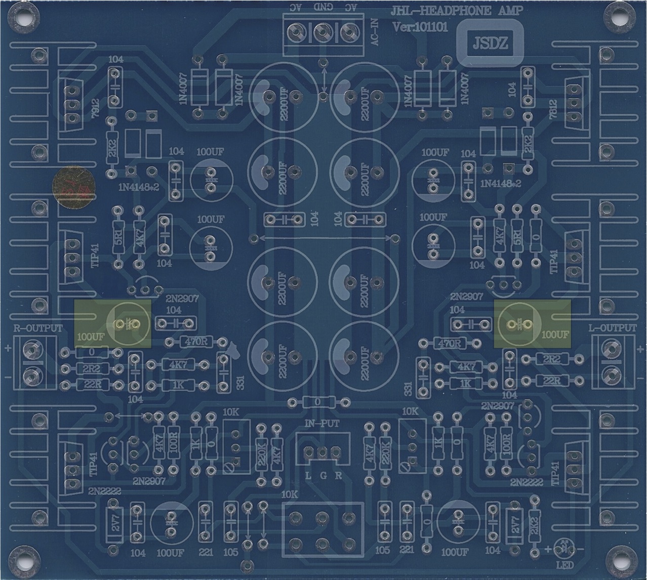

Hello all
Sorry for the delay but I seem to build and document very slowly..
Picture List
fj12centauro
I have to admit using TIP41 in the output stage my assumption was there may not be enough gain! Which type of source are you all driving from ?
hotiron
Thanks very much I will try that. On the Chinese Version it's R17 and R18 that can be found in the first picture below..
All
Attention must be draw to C23, C24 it has been highlighted on the composite image attached. The PCB and the schematic both show it the incorrect polarity!! Electrolytic capacitors are very sensitive to incorrect polarity so can I suggest this is replaced and a new one is insert with the corrected the polarity ..
This week I will try and catch up with you guys and get the testing done.
Hope this helps
Miles

fj12centauro
hotiron
All
Hope this helps
Miles
Sorry bout that Miles I was referring to the JLH schematic. 😕

This is a VERY good point ...
Hotiron, this is a VERY good point you have mentioned
Quite frankly the provided schematic is AWFUL and the part numbering is all over the place and it's on the list to be redone. This is the first build of 4 different types, and is a learning exercise for me with a bunch of new toys and a subject which I have messed with since being a young lad moving then onto my first degree ..
Please keep the comments coming, they are really helpful ..
Thank you
Miles
