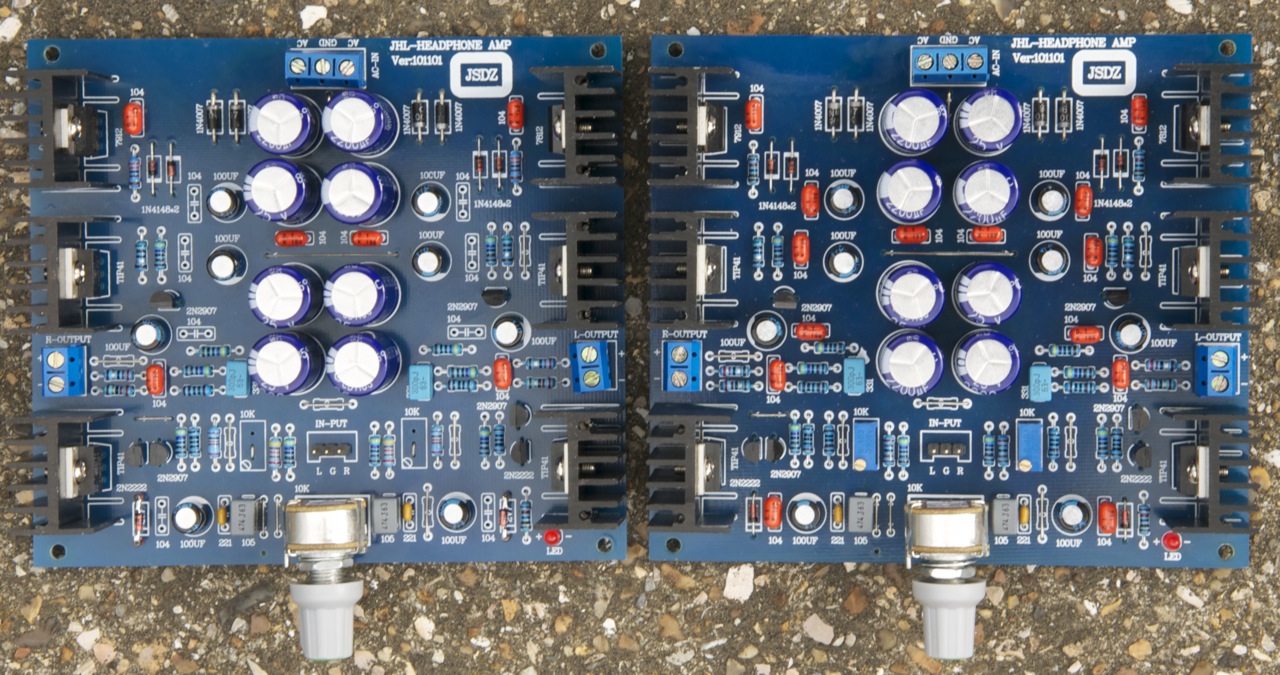

Two versions now built ..
Hi guys
Busy week and have done LOTS of work this week on the boards, I have now build and tested two versions ..
Lots of testing done with some very disappointing results, I have a very busy weekend of writing up todo ..
More soon
Miles
JLH MkI version from here
Hi guys
- JHL Chinese Version
- JLH MkI Version
More soon
Miles

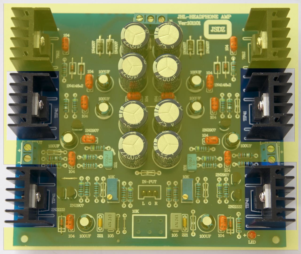

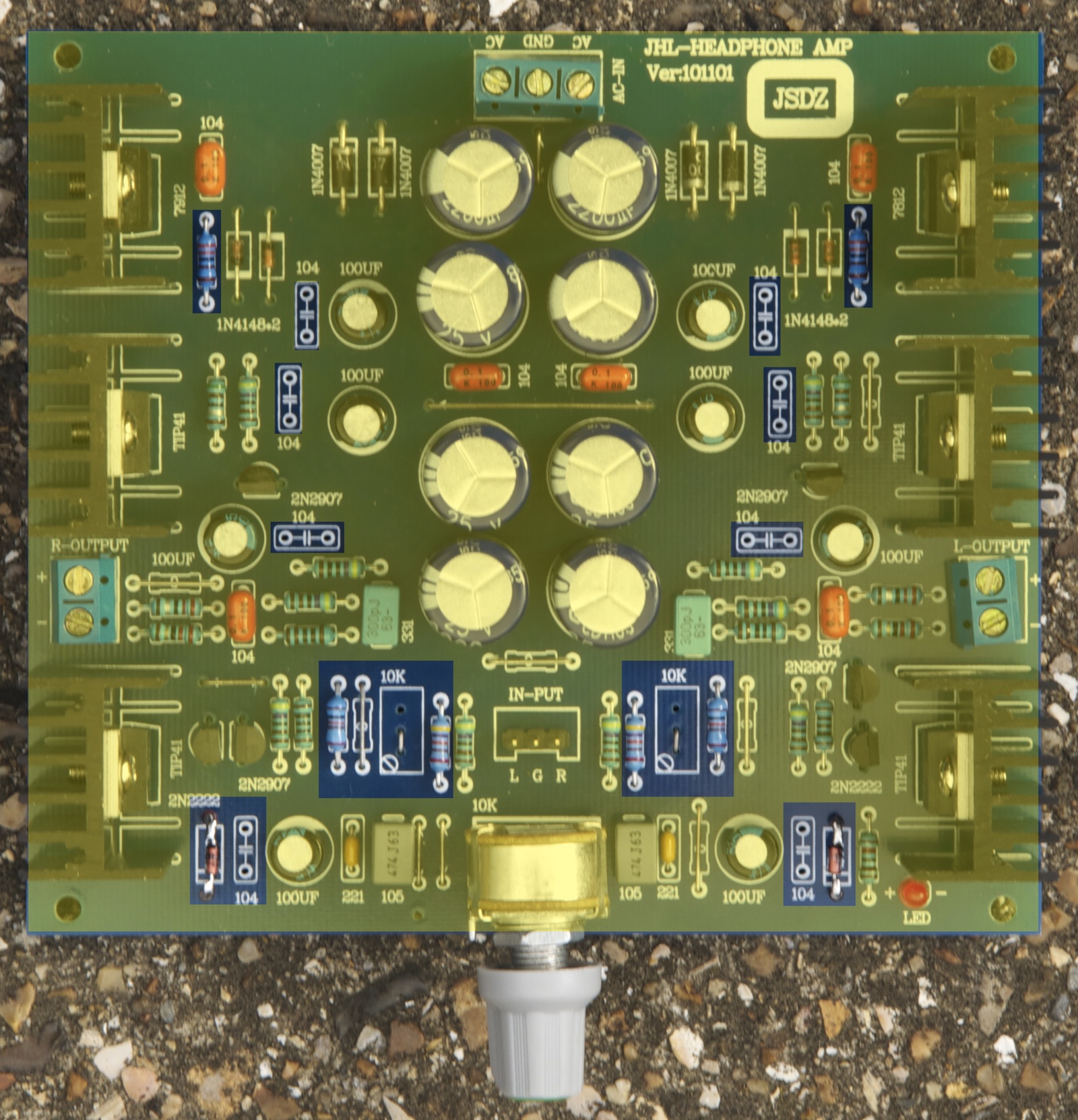

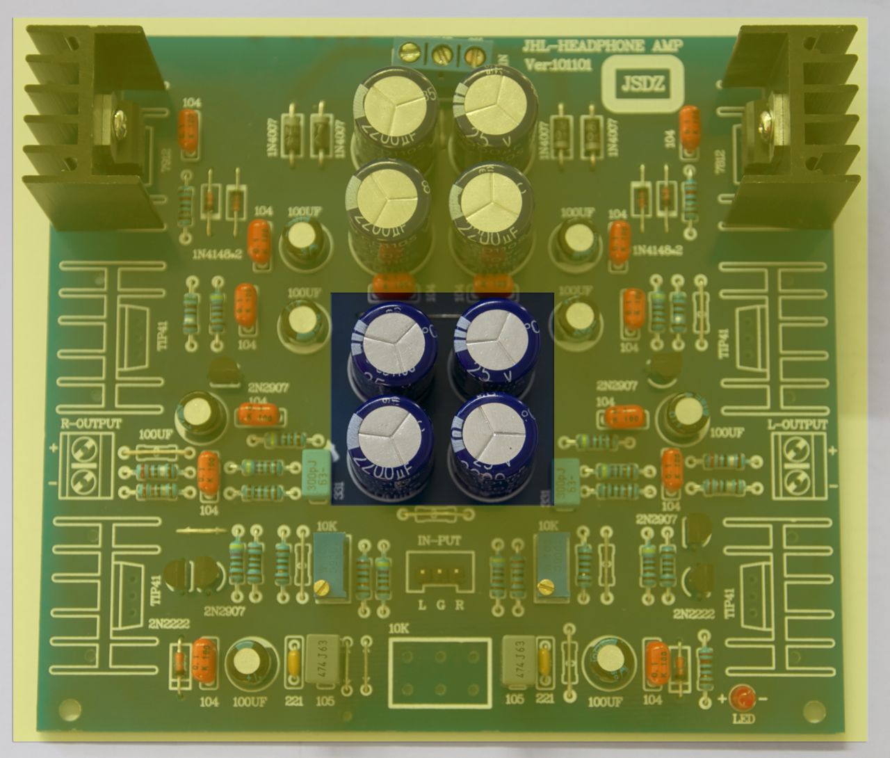

Testing the power supply on the PCB
Back on post #129 the board was assembled to the power supply stage and required testing.
The stage requires a good quality DVM, but a passive meter can be used at this stage.
Picture List
AC Test Points Assuming 12Volt Tx
DC Test Points

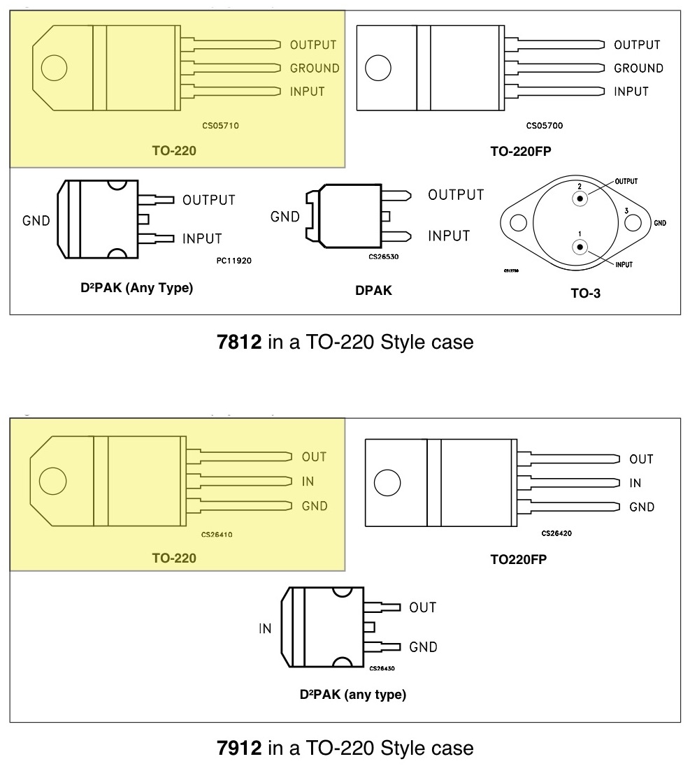

Using the attached datasheet for the correct pintout, which is read as if the device number is facing you.
The device is highlighted in yellow TO-220 style case. Note the subtle difference in pinout!
Always keep the NEGATIVE or BLACK lead of the meter to GND therefore using the Positive or RED lead for the measurements.
7812 Test Points
7912 Test Points
Tips

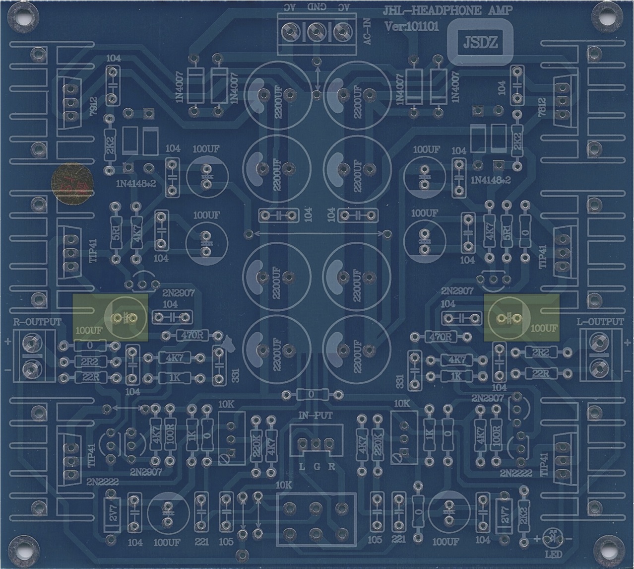

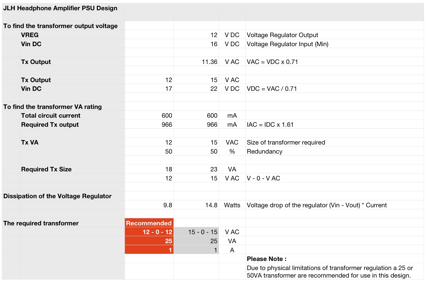

Picture List
- Transformer Calculations
- Voltage Regulator pinouts
- Set the meter to AC V
- AC (Left screw terminal) to GND= 13VAC
- GND to AC (Right screw terminal) = 13VAC
- AC (Left screw terminal) to AC (Right screw terminal) = 26VAC
DC Test Points
- Set the meter for DC V
- GND to 1N4007 (7912 Side of the PCB) bottom legs = -17VDC
- GND to 1N4007 (7812 Side of the PCB) bottom legs = 17VDC
7812 Test Points
- Left Leg = 17VDC
- Centre Leg = 0VDC
- Right Leg = 12VDC
7912 Test Points
- Left Leg = 0VDC
- Centre Leg = 17VDC
- Right Leg = 12VDC
Tips
- Don't forget to change the DVM from AC to DC for the second set of measurements.
- Take the time to satisfy yourself that the values are correct
To Done List
- Will Alps Blue Velvet fit the PCB ? - It will not physically fit on the PCB, it is just too big ..
- Is an output protection module required ?
[*]What is a sensible transformer specification ? - 12 - 0 - 12 VAC at 25VA (Bigger VA number rather than smaller) See below - Draw a logical and simple schematic

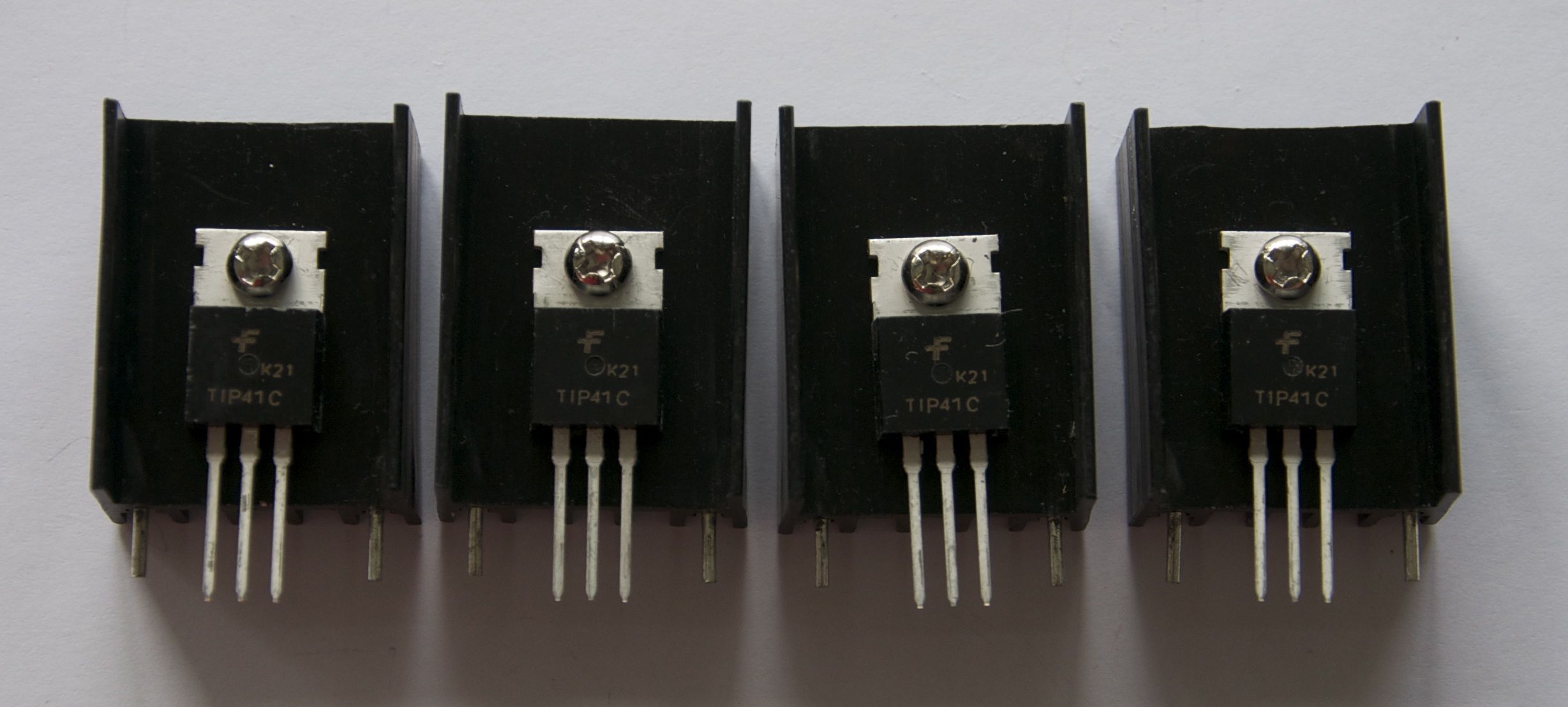

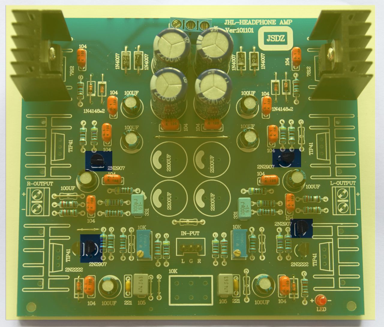

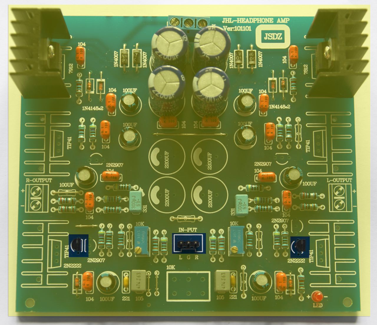

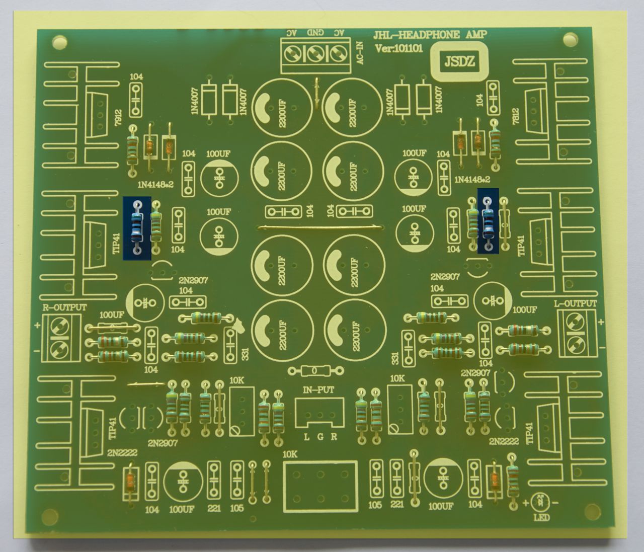

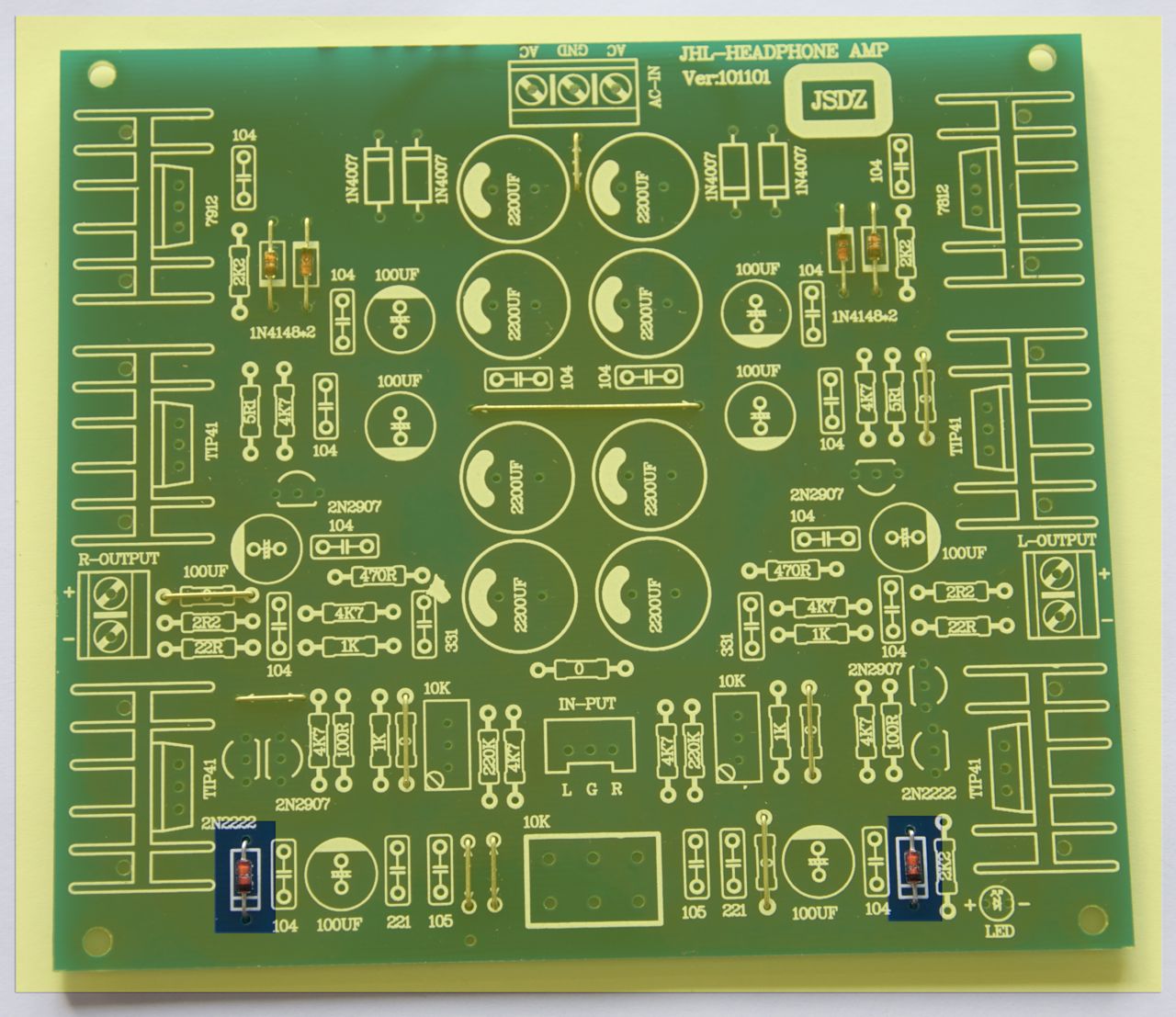

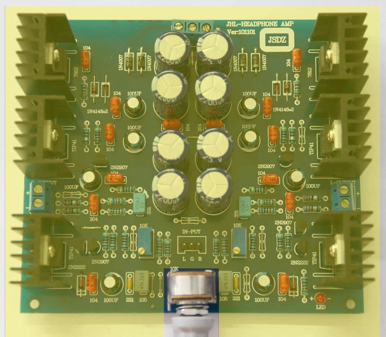

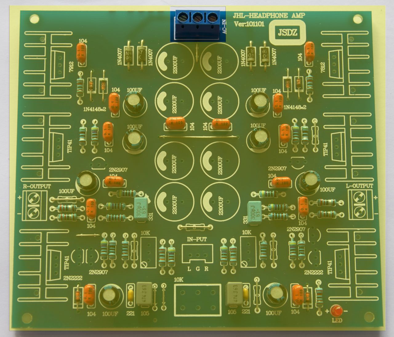

Final Build Stages
During the final stages of assembly it is very important these components are inserted in the correct orientation ! Transistors and electrolytic capacitors suffer catastrophic failure in power the wrong way around ..
Picture List
Comments
Tips
Now we are ready to power the board and finally test ...
Miles 😀

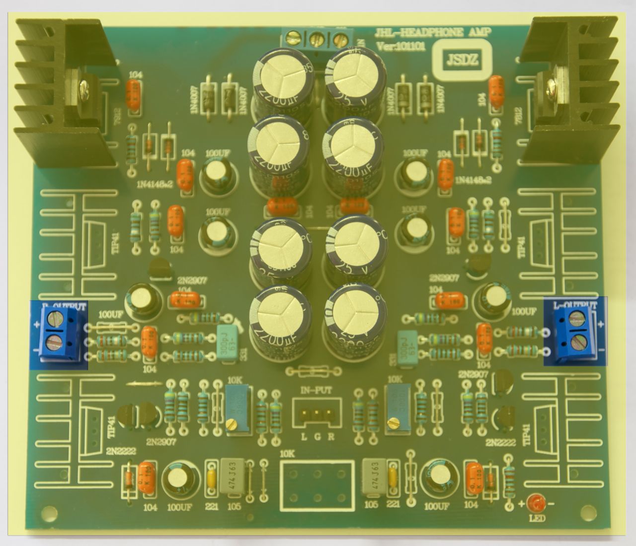

Picture List
- Input Connector and input transistor 2N2222 2 off
- Transistors - 2N2907 4 off
- Capacitors 2200uF - Post Regulator Smoothing 4 off
- Output Connectors
- Output Transistors TIP41 mounted on their heatsinks
- Output Transistors assemblies mounted on the PCB
- Potentiometer
Comments
- The 2N2222 and the 2N2907 are not interchangeable and must go in their correct positions and orientation. Looking from the top the device is in the shape of a D. On the PCB there is also a D shape and these flat sides allow the device to be inserted correctly.
- There is a slight misalignment between pins of the output transistor and the heatsink alignment holes on the PCB. The TIP41 pins are not quite straight when all is complete.
- The 2200uF capacitors are marked on one side with a minus sign and a shorter leg. The PCB is marked with a smile and this is the negative leg. Failure to insert any electrolytic capacitor with the correct polarity can lead to CATASTROPHIC consequences.
Tips
- Inserting the 2N2222 and the 2N2907 can be quite tricky and the legs will break if flexed tooo much.. I would suggest that the first and third legs are bent slightly out and the device then inserted with the bottom 5 to 7mm from the board.
- Can I suggest that the output transistors are mounted onto the heatsinks with the screws LOOSE... Insert on to the PCB and solder the middle pin of the device first, then check to see if the assembly is mounted square and flat to the PCB. Now solder the other legs of the transistor and the heatsink. Finally tighten the screw on the heatsink.
- The large power supply smoothing capacitors are another component which it can be easy to leave a gap between to the PCB. Again solder one leg and check that the component is tight to the PCB retouch the joint if necessary and then solder the other leg.
Miles 😀

Testing the completed board
I have tried to make this testing phase simple and painless, with all of the testing done with a DVM.
Some measurements are taken With Reference to Ground WRG Using the black test probe connected to the GND terminal of the AC input connector.
Before the board is powered a load should be applied across the output terminals, in my case 100ohm resistor at 1 watt. Please don't use your best headphones at this stage, if something is wrong this could be a VERY expensive mistake.
I have assumed that the board is on the bench with the AC connector at the top as shown in the picture.
Picture List
AC Test Points
DC Test Points
If all of the above measurements are correct, the heatsinks of the devices should start to warm up.. After about 5 mins a finger placed on top will feel heat. Both voltage regulators have over temperature, short circuit and over current shut down if anything is seriously wrong.
If all the above conditions are met the final stage of setup can be completed below.
Setup
The variable resistor is a 10 turn version which removes the DC offset at the output. With the DVM connected to the output connector with variable resistor should be turned until the offset is removed..
Comments
Please note : A limitation of this design is that the DC offset will vary over time and due to heat. 50mV = 0.05V is quite acceptable
At this point is VERY tempting to plug your best headphones in and kick back with your favourite CD .. Please don't .. Can I suggest that the board is now soak tested for at least 6 to 10 HOURS to allow any suspect components to fail .. If a semiconductor or electrolytic capacitor is to fail it will happen in the early period or end of a product life cycle.
Check the DC offset value once again and now FINALLY kick back and listen to your hard work ...
Next I will look at some AC testing of the board..
I hope this has been helpful
Miles

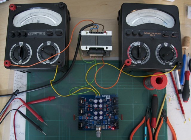

Picture List
- Test rig Two Avo 8's measuring the AC current into the board.
- AC Input connector
- Pinout of the voltage regulators
- 5.1 Ohm resistors
- Zener Diodes
- Finally the Output Connector
AC Test Points
- With the meter set to AC volts
- AC input connector WRG approx 13V at each AC input
- AC input connector approx 26V at between each AC input
- Voltage Regulator output pins WRG - a few millivolts
- Output Terminal connector of each channel WRG less then 5mV
DC Test Points
- With the meter now set to DC Volts
- Right side 1N4001 bottom pin WRG 17V DC
- Left side 1N4001 bottom pin WRG -17V DC
- Output pin 7912 WRG -12V DC
- Output pin 7812 WRG 12V DC
- Across the 5.1ohm resistor 0.6V DC (Red test probe top and black test probe bottom)
- Across the zener diode 3V DC (Black test probe top and red test probe bottom)

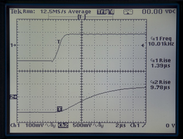

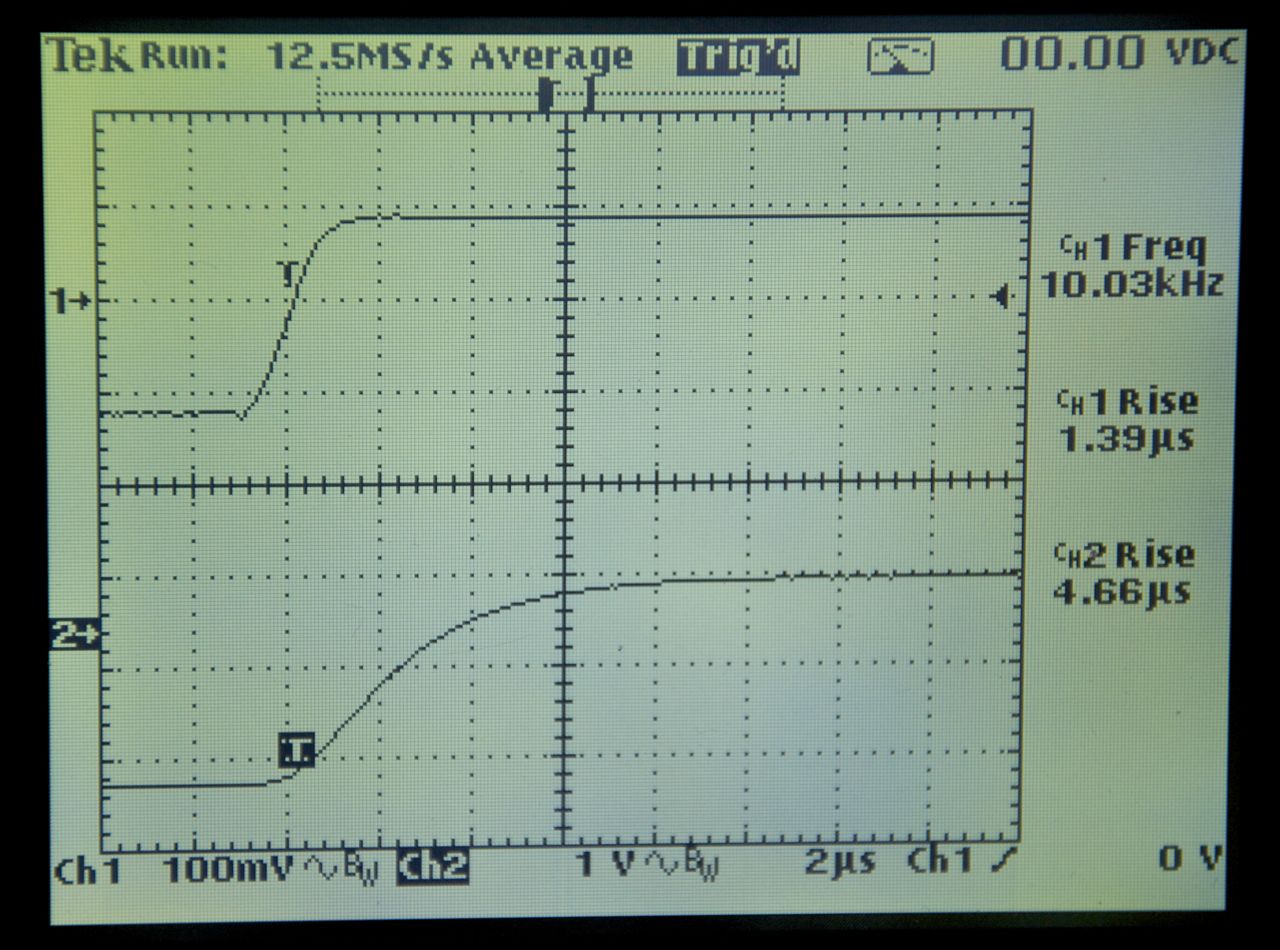

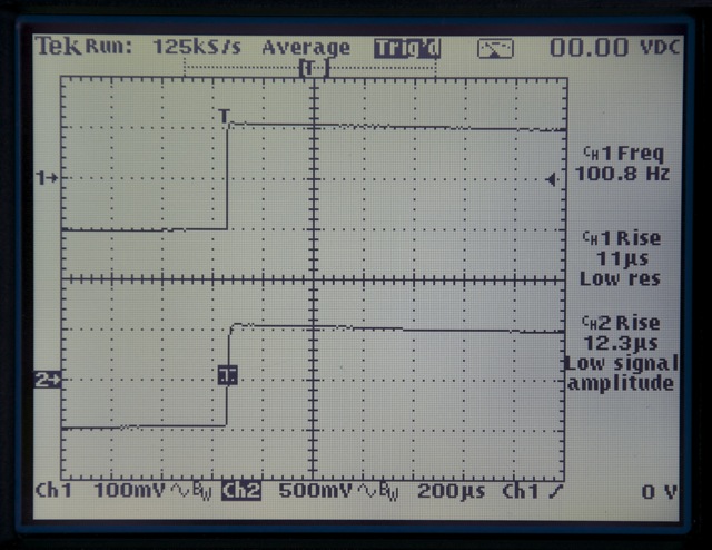

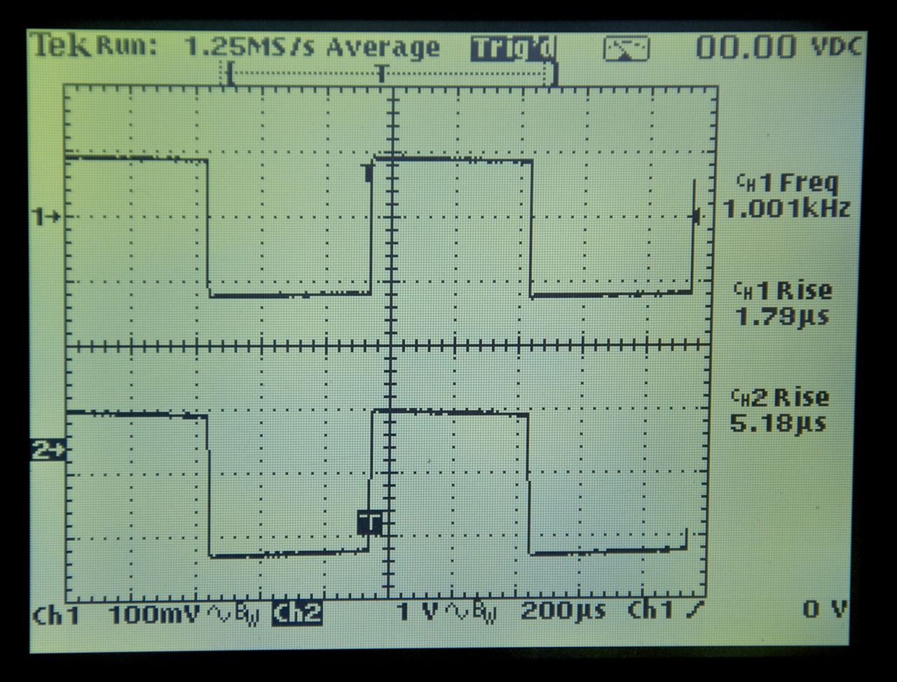

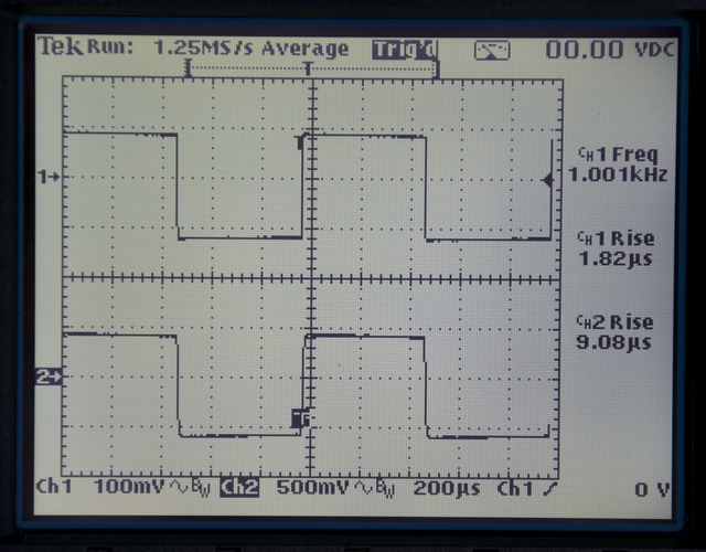

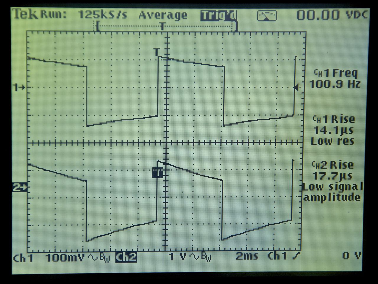

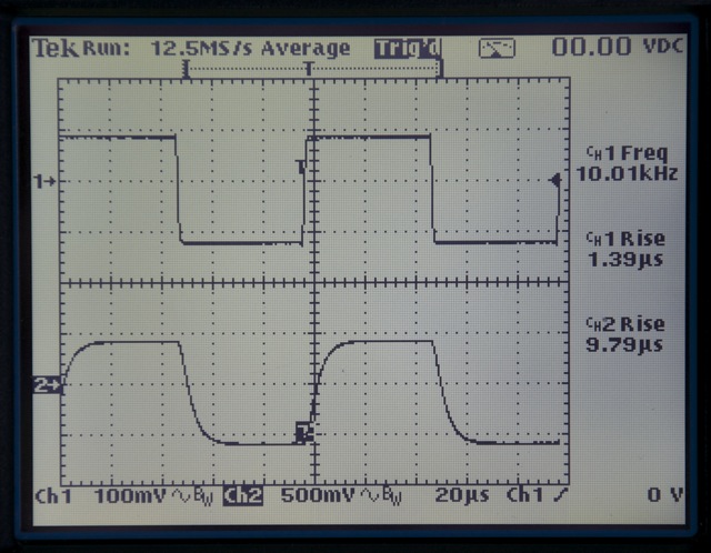

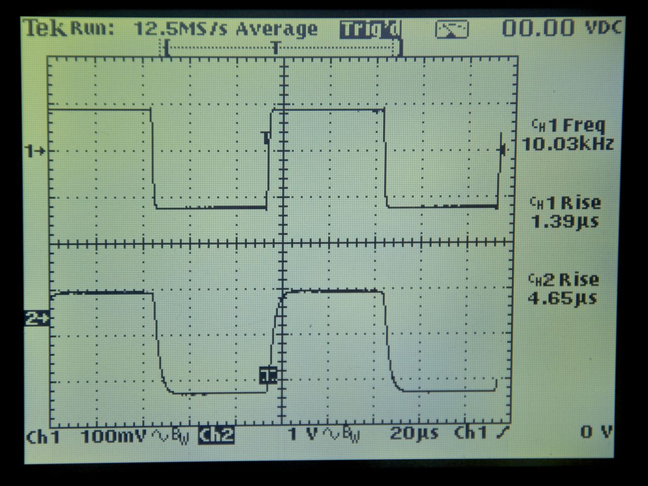

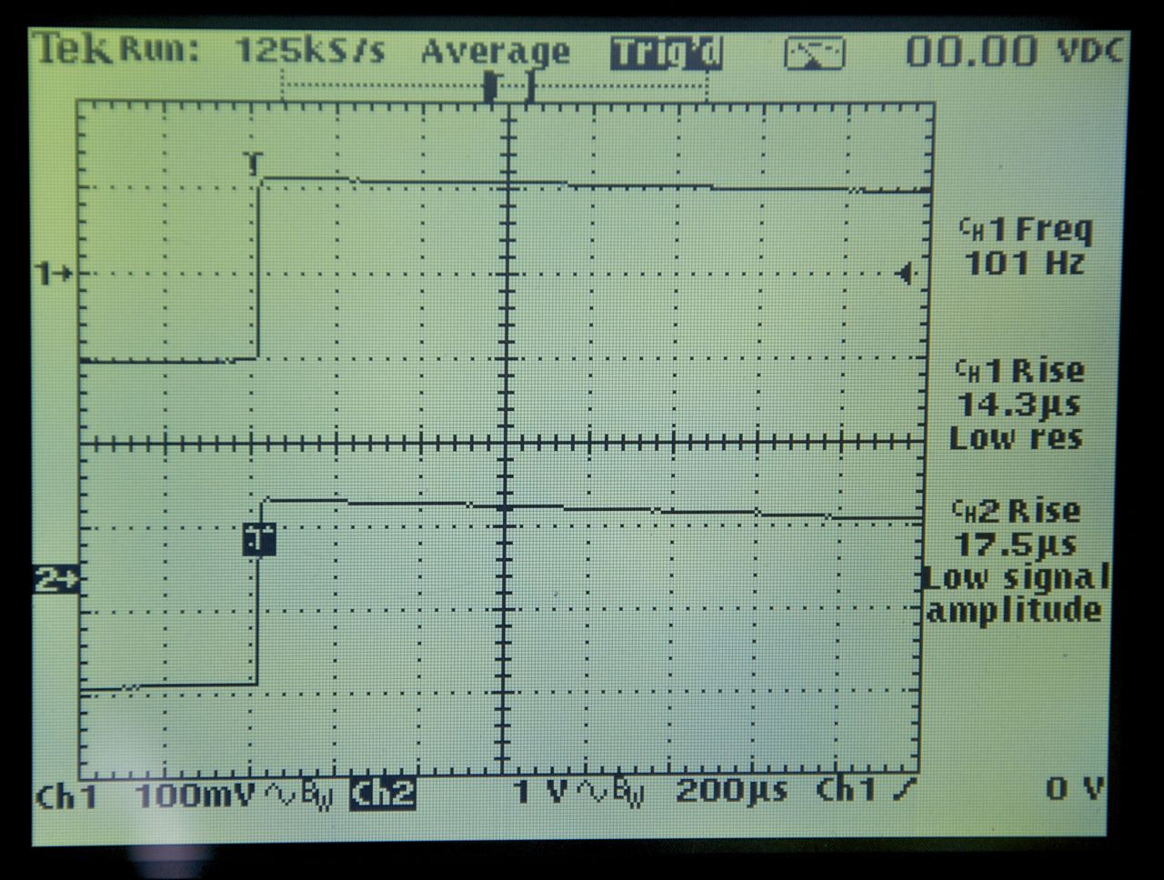

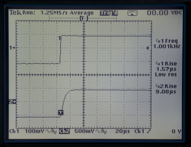

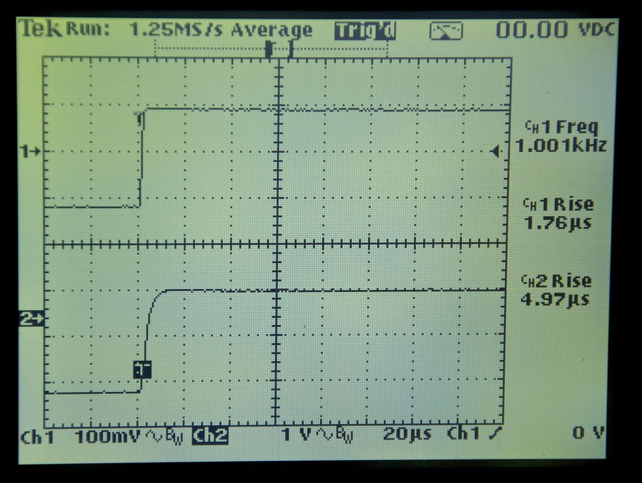

AC Testing
Below are a series of waveforms to test the design under ideal conditions by applying an impulse to the input, in this case a square wave and the output is displayed on an oscilloscope. The oscilloscope has two channels CH1 and CH2 which have the same functionality. The X10 (Times 10 or multiplied by 10) versions show an expanded X axis of the graph to quickly show the effective rise time of the amplifier.
Picture list
In the following tests CH1 (Top of the screen) displays the input waveform from the signal generator and CH2 (Bottom of the screen) displays the output of the amplifier. In a perfect world both signal should look the same and the rise time of each signal should match.
Testing the board
A square wave of the following frequencies is applied to the board and the output recorded.
On the right hand side of each picture there are a number of measurements taken by the scope which are helpful to understand what is happening..
Comments
There are 6 pictures, 3 sets of two for the following frequencies
Conclusion
The sharp increase in rise time and the X10 pictures clearly show the reactance of the amplifier rapidly increasing as the frequency increases, in effect reducing the high frequency performance.
So this Chinese version of the JLH design will sound dull and a bit lifeless ..
It must be strongly emphasised that the original design was capable of much better performance than this implementation. So the next job is now convert this board to the original JLH shown in circuit 1 here.
Please note : My waveform generator was made a technical college many years ago and had the latest 8038 device at the centre of the design.. Many years have passed and it can be seen that the square output at low frequencies is not very good at all, so a new version is required..
Picture list
- 100Hz Square wave
- 100Hz Square wave X10
- 1kHz Square wave
- 1kHz Square wave X10
- 10kHz Square wave
- 10kHz Square wave X10
Testing the board
- 100Hz
- 1HKz
- 10kHz
- The first is the frequency in Hz of the input signal
- The second is the rise time of the orignal signal on Channel 1 CH1
- The third is the rise time of the output of the amplifier on Channel 2 CH2
Comments
- 100Hz Picture 1 and 2
- 1HKz Picture 3 and 4
- 10kHz Picture 5 and 6
Conclusion

PCB Issues
C5, C6 - C19, C21 - C17, C18
The zener diode stated on the schematic diagram 2V7 = 2.7V The supplied value is 3V0 = 3V
The zero ohms links supplied are of poor quality and have a value of 0.4 to 1 ohm
In Summary
C23, C24 Require inserting with the correct polarity
There is also another layout issue around the input of each channel with regard to space C13, C14 - C15, C16 It seems a small ceramic capacitor of 330pF has been used to allow a fit next to the MUCH larger 0.47uf which by design should be a 1uF again would be larger still.
Some of the above issues with the PCB cannot be resolved and have to be put down to experience.
In an attempt to make the best of the current PCB and components available another two versions will be built
To Done List
PCB Issues
- C23, C24 : Are shown on both the schematic and the PCB with incorrect polarity
- The left and right swap sides on the PCB - the input connector is logically labelled L - G - R, however the LEFT channel is on the RIGHT side of the PCB and the RIGHT channel is on the LEFT side of the PCB!
- The ground track for both outputs is a VERY poor layout
- C9, C10 : 33nF However the supplied value is 0.1uf
- C13, C14 : 1uF Are supplied as 0.47uF
- C15, C16 : 330pF Is a ceramic capacitor which will perform poorly in this function
- C1, C2 - C23, C24 : Would benefit from having high quality components
In Summary
- JLH Original using the circuit 1 from here - Done and Tested
- JHL Simplified with correct component values - This month July 2011
To Done List
- Is an output protection module required ? - This month
- Draw a logical and simple schematic - When the circuit is finalised
- Reduced the gain of the amplifier for a 2Vrms input rather than the older 0.707Vrms standard
- Are larger heatsinks required ? - Due to the reduction in gain this may not be an issue
Mistake on last post
The link should point to here
Miles

Increasing the sizes of the heatsinks
The form factor of the heatsinks used would allow an increase in size if required. The attached drawing shows that the width and depth are fixed and the height is changed for the application.
Transformer Selection
The choice of 25 or 50VA transformer was based apon the regulation of the size of transformer, broadly speaking the larger the transformer the better the regulation. Further information can be found on the attached datasheet.
All of the above information has been taken from Rapid Electronics here in the UK. Over the past 20 years without exception I have always found them profession, helpful and a great company to deal with. (also their catalogue and website are much simplifier and smaller than others we can mention)
With all the future modifications I have tried to use easy to find worldwide sourced components from the big companies.

From JHL to JLH
Picture List
Comments
The performance of the JHL kit was not as expected or designed by JLH and having serious reservation with regard to the PCB layout proof was required that the project should continue. The work done for this post was to improve the amplifier performance at little or no cost and to check the PCB for function.

Impulse Testing
In the following tests CH1 (Top of the screen) displays the input waveform from the signal generator and CH2 (Bottom of the screen) displays the output of the amplifier. In a perfect world both signals should look the same and the rise time of each signal should match.
In Conclusion
These small changes have made a considerable improvement to the JHL kit with respect to the rise time of the headphone amplifier and therefore bandwidth. So in real terms there should be more detail and life in the top end..

- Incorrect capacitor polarity issue
- JHL to JLH - The PCB's side by side
- Component locations for change
- 100Hz Square wave
- 1kHz Square wave
- 10kHz Square wave
Comments
Limitations in testing
It must be made very clear that the test regime for the amplifier is currently very basic with a number of omissions, these are
- Poor input test signal quality at low frequencies
- The full bandwidth has not been tested
- The input signal has been limited to a small value of 200mV peak to peak
- Testing at 20, 200, 2k and 20kHz would be more useful and the design improves
- Both sine and square testing at the above frequencies
Stage 1
These simple changes will improve the performance of the board considerably.
- C23, C24 Require inserting with the correct polarity. The negative electrolytic capacitor terminals should face the centre of the board. If the board has been powered up can I suggest this component is replaced.
- Remove the 8 (0.1uf) capacitors shown in photo 3
Stage 2
With a small number of replacement components the design takes another step forward. Using picture 3 as our guide
- Implement Stage 1
- Change 2k2 for 3k3 resistors (2 off)
- Remove the two 10k variable resistors and link as required
- Replace 4k7 with 10k (2 off)
- Replace 220k with 47k (2 off)
- Replace the Zener Diode with 3 x 1N4148 in series (6 off) - Note the polarity is opposite to that of the zener.
Please note that there is a larger offset voltage which cannot be removed with this method in the order of ±100mV.
Impulse Testing
- 100Hz Picture 4 and 5
- 1HKz Picture 6 and 7
- 10kHz Picture 8 and 9
In Conclusion
- 100Hz Square wave
- 1kHz Square wave
- 10kHz Square wave
