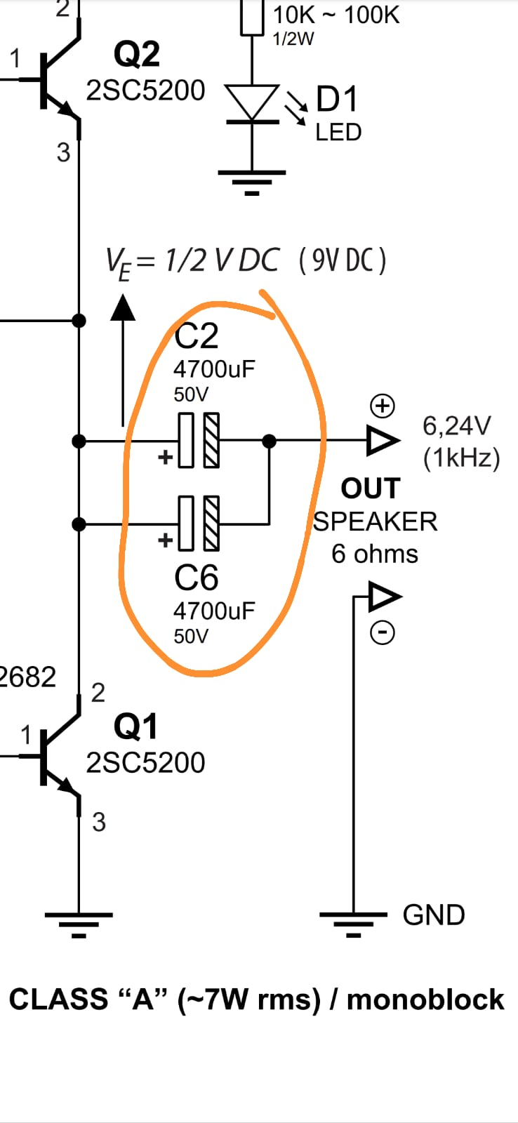

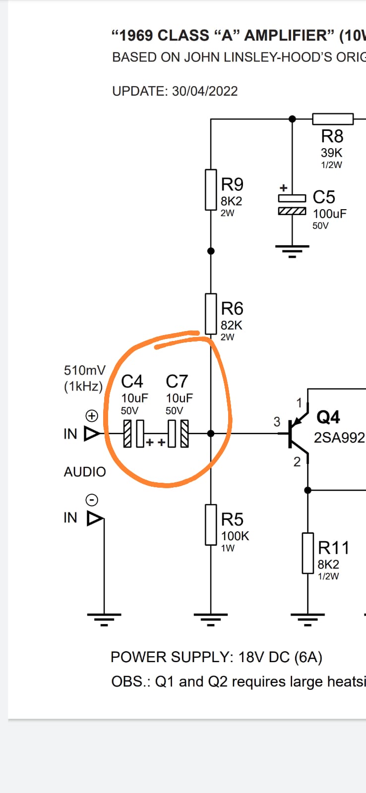

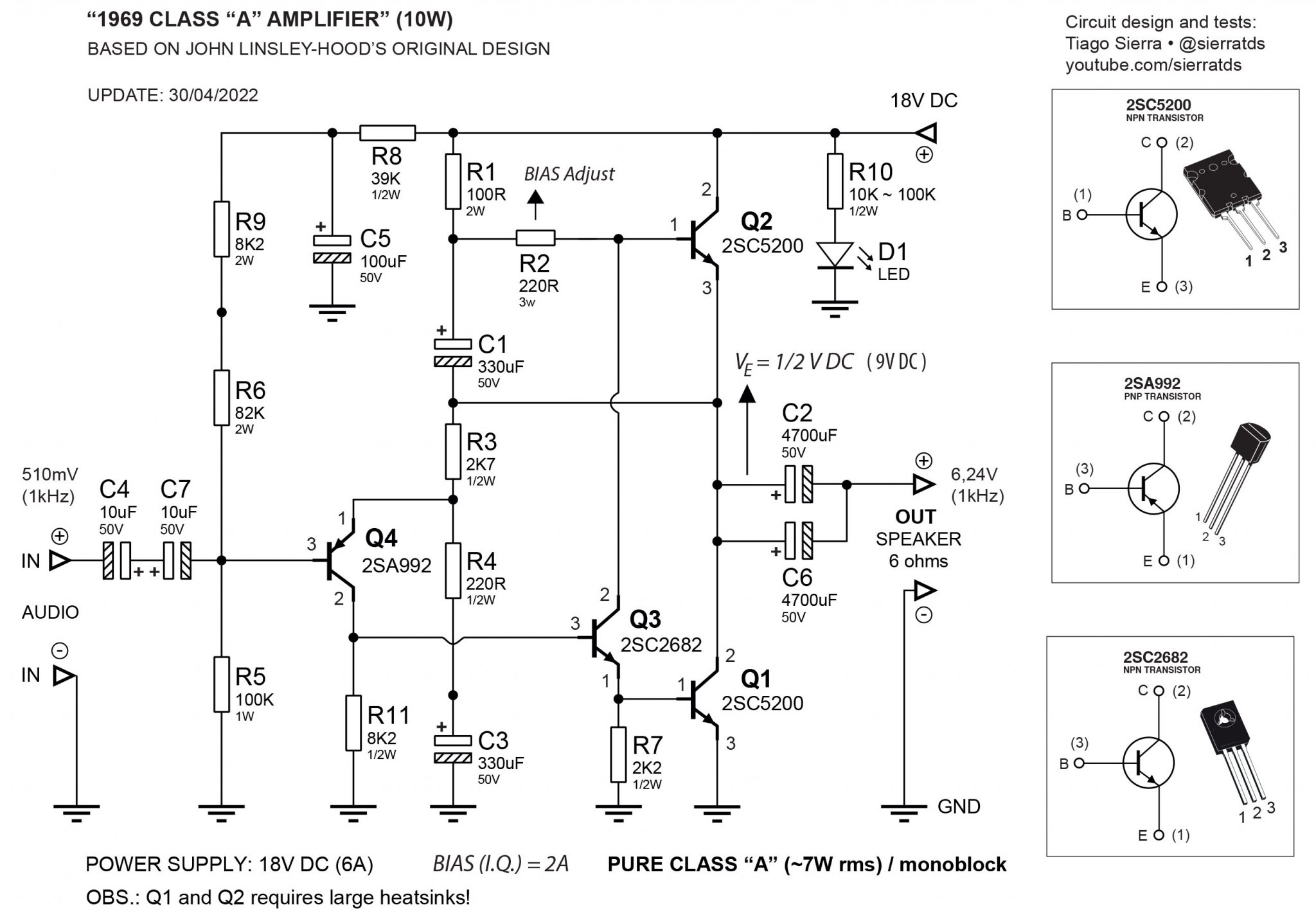

Guys, I made some changes to my amp. What do you think?
I changed the input capacitor which was 0.47uF polyester for two electrolytic series 10uF = 5uF capacitor (bipolar). C4 and C7.
And at the output, I put another capacitor in parallel of 4,700uF. C6.
I would not have thought it necessary to use two electrolytics back to back in the input stage as the base of the PNP is sitting at around half supply, so biases the electrolytic the right way (positive to the base, negative to input, that is).
You would only do this normally if an electrolytic works around zero volts or ac. even then I tend to use non-polarised caps for input connections and while I think 0.47uF was too small, probably 1 or 2.2 uF would be adequate.
Noise at low frequencies can increase with a high impedance so a larger capacitor is preferable, but VLF noise is not audible.
You should see a better bass response with the larger output capacitor.
I have not considered the time constants interacting but I would simulate the overall result to check. It's probably better to make the input limit the response rather than the feedback decoupling capacitor so that the voltage on the decoupler is minimised, reducing distortion it might cause.

Thanks for the answer. Would it be better to put a 2.2uF polyester capacitor at the input?
Yes, a polyester or polycarb capacitor should have lower noise than an electrolytic.
I'd also agree with increasing the bootstrap and feedback decoupling capacitors.
Time constant of the input stage: depends on gain of 2SA992. Typical min. 200 gives a min. value of approx. 220x200=44k.
parallel load of bias resistors = 47k, total approx. 23k. 1uF x23k=23ms. Rather high, depends on what you want the amp. LF performance to be.
Prob. 2.2uF better. Could be better if your A992 device gain is higher (typ. 500), but that depends.
Bootstrap probably more important to increase. Capacitor sees 100 // 220 so at 68 ohms or so 330uF x 68 is 22mS and somewhat high, and not so dependent on the gain of the transistors. 1mF would be my recommendation too. I would also increase the decoupling capacitor and try to make sure the input cap. limits the roll-off as far as the input/drive stages are concerned.
Output cap can be larger still if you like. 10mF or 22mF for better low frequency square wave performance. Depends on your speakers too. Many people thought 2.2mF Ok back in the 60's, but LF performance is definitely inferior.

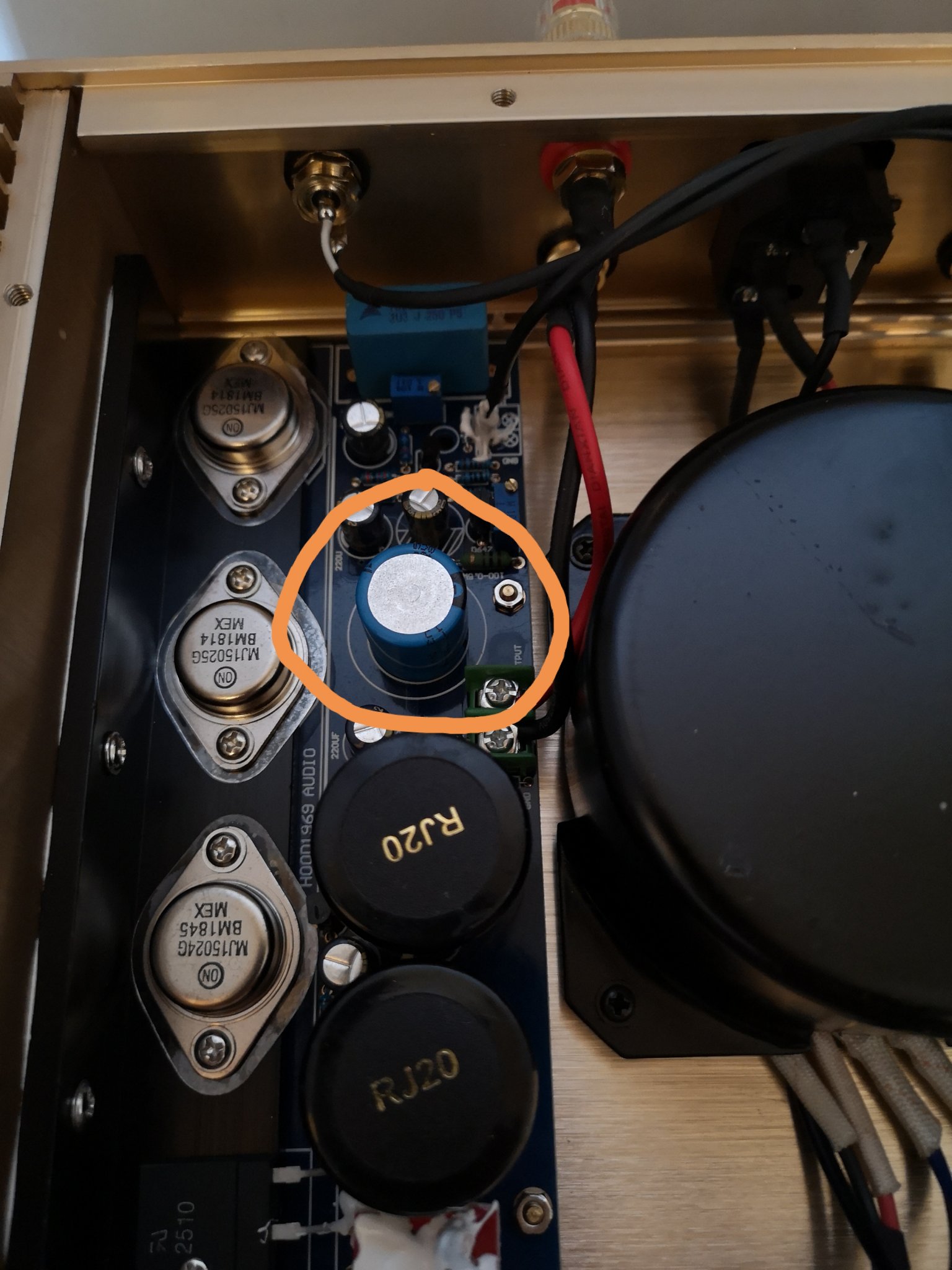

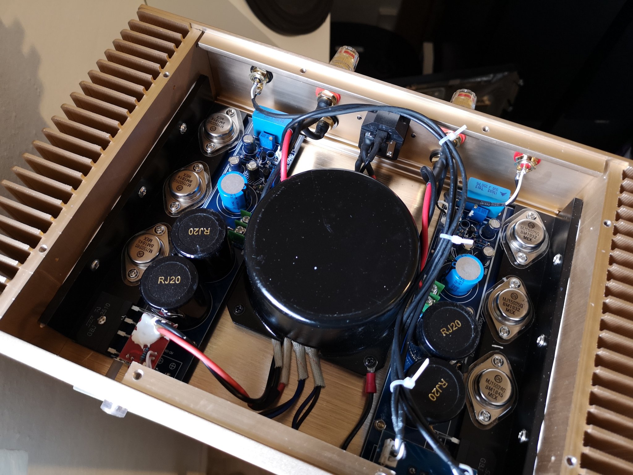

I would like to improve/upgrade my chinese made "JLH 1969". It was sold as "2017 18W model" with MJ15025 & MJ15024 transistors.
It does sound pretty good already, but I would like to upgrade components to get as good sound as possible. Since it is chinese made, I'm sure there is room for improvements.
For starters, I have bought new output capacitors (Mundorf MLytic AG glue on 2200 uF 63VDC 125C 2pin). Am I correct in assuming that they should replace these?
The blue ones are labelled as 1500 uF, but I was advised to get 2200 uF instead.
What would be the next thing to replace? I assume the transistors are counterfeit, so I guess that would be a place to start? Should I simply get legit versions of the same MJ15025/MJ15024 models, or would it be better to replace them with something else?
The speakers I am driving are Troels Gravesen TQWT (95 dB): http://www.troelsgravesen.dk/JA8008.htm
Thanks!

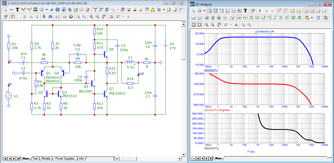

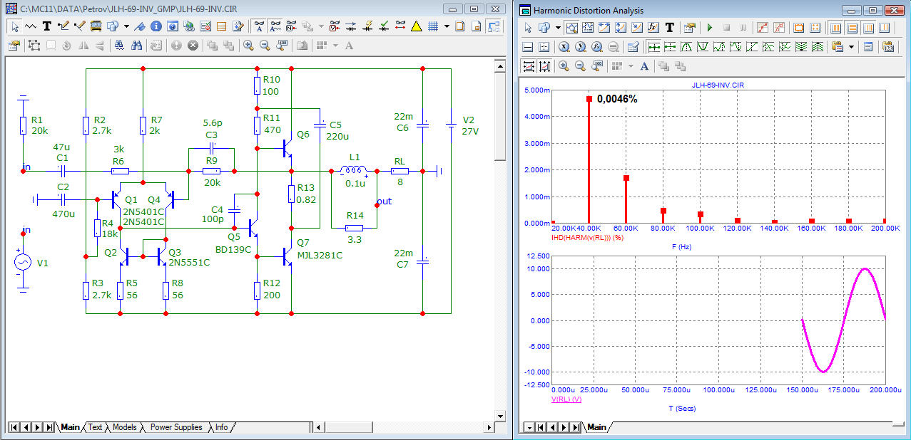

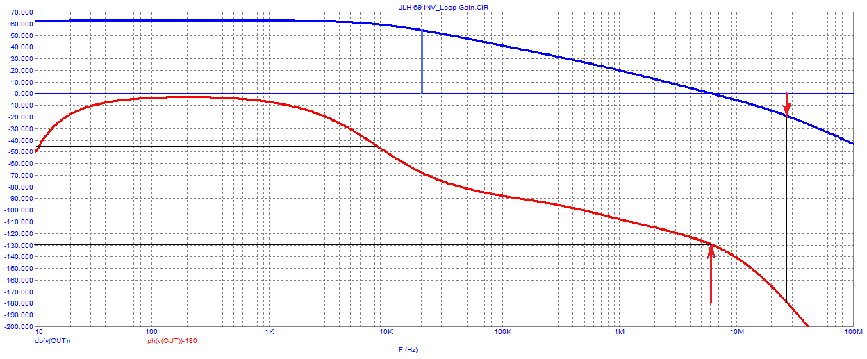

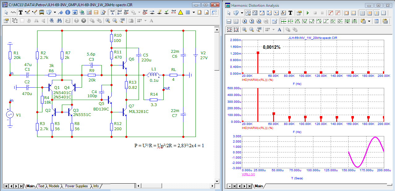

https://sound-au.com/tcaas/index-1.htm

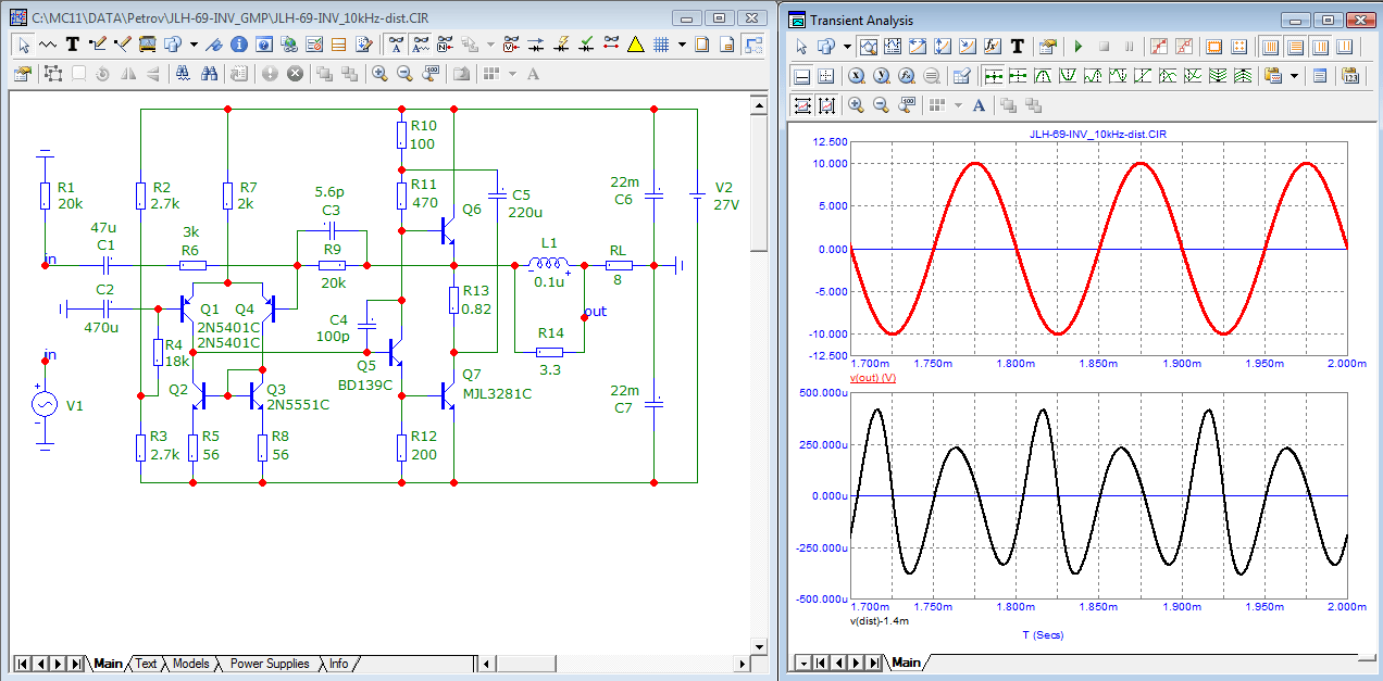

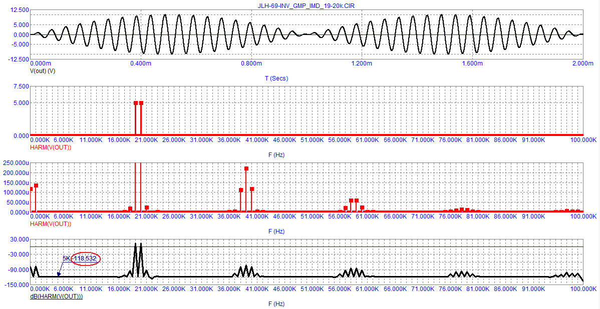

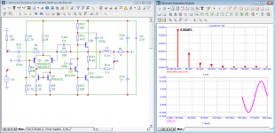

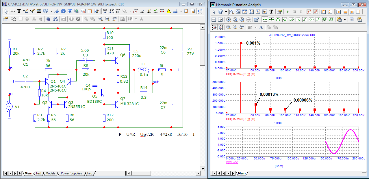

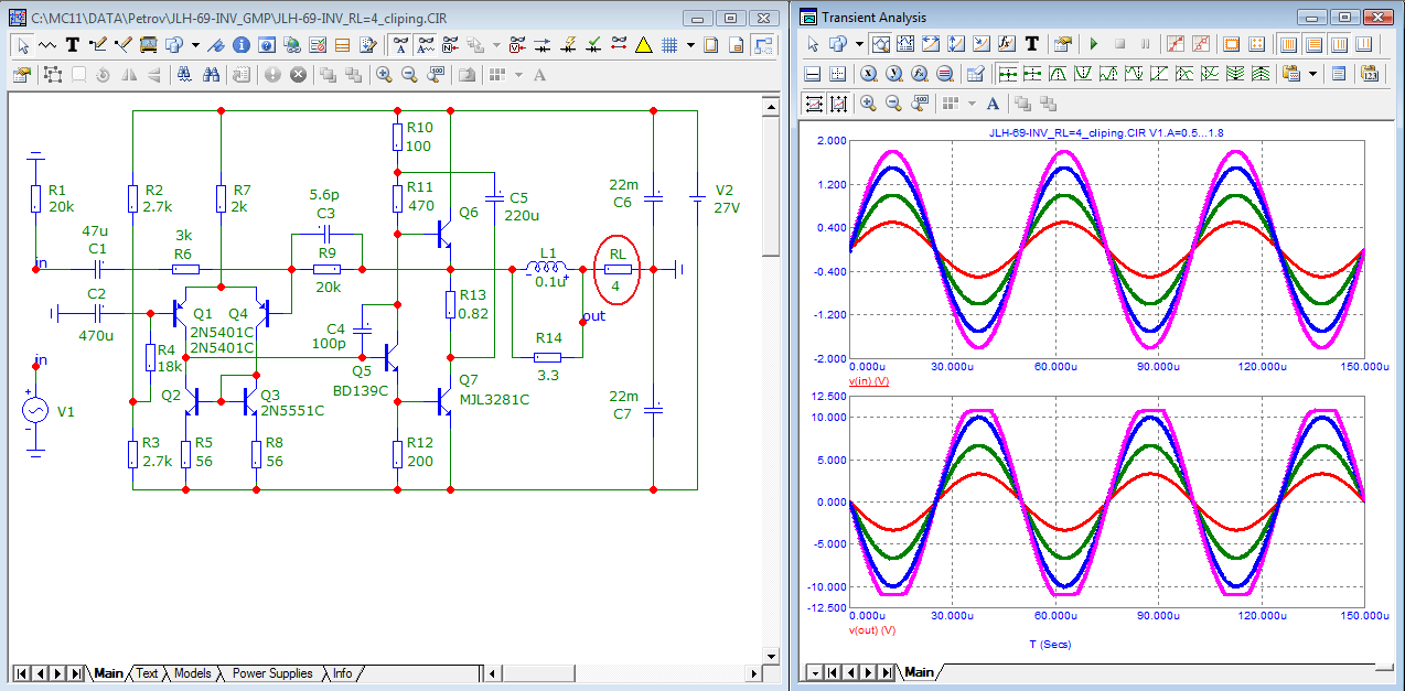

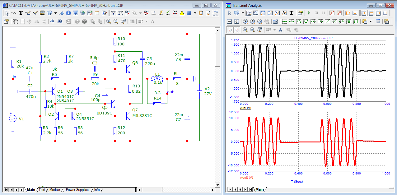

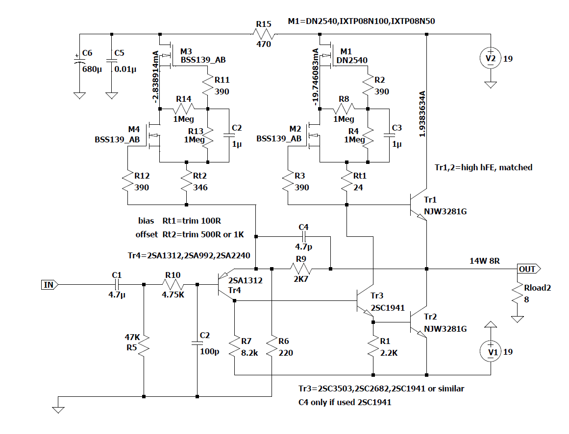

In general a JFET current source is much quieter than one using depletion mode MOSFETs.
Unless you need more voltage than 50V, I personally would use a 2SK208GR or 2SK209GR cascoded by a 2SK209BL to make up a 3mA CCS.
Fine adjustment with a single source resistor for the (lower) GR-grade JFET.
And just use multiple in parallel if I need more current.
