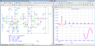

current source improves PSRR+

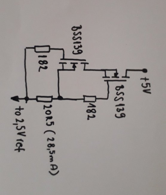

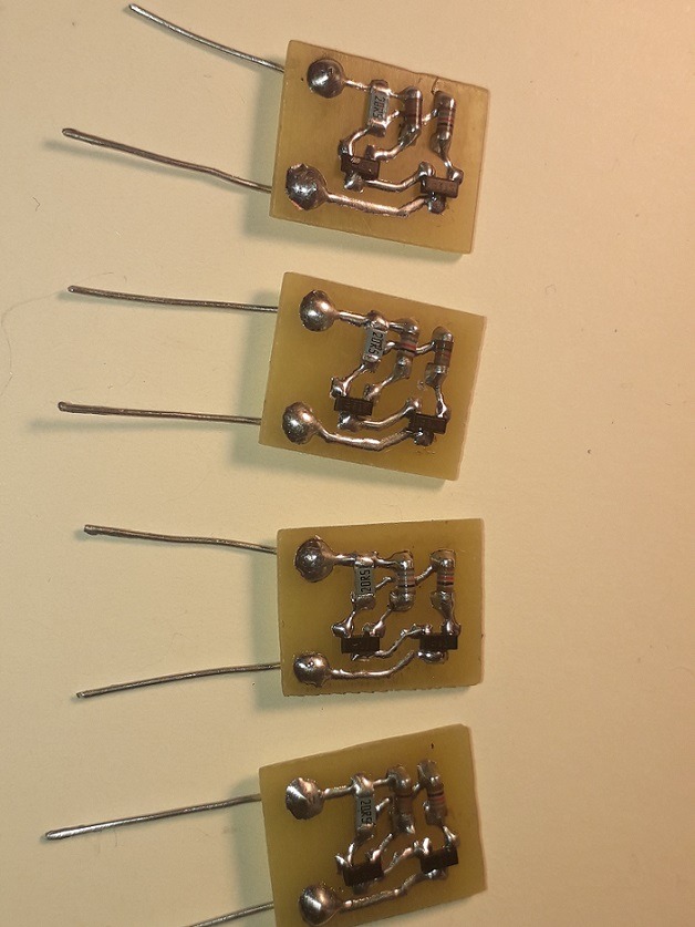

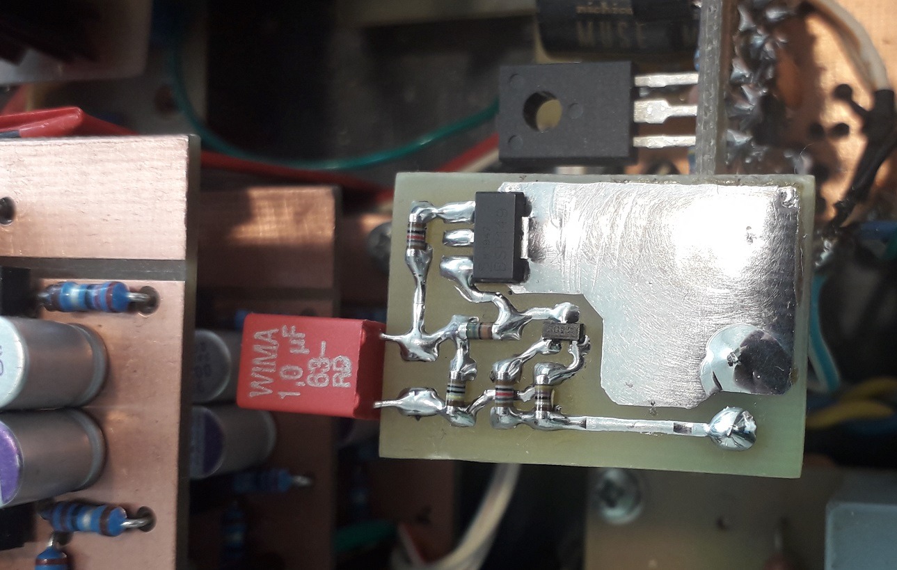

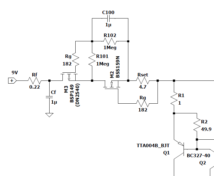

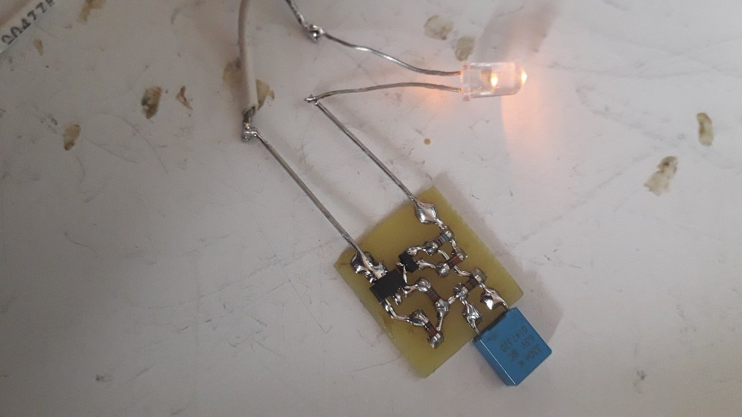

I already used jfet in CCS, I put a link to the old circuit in my post before.
However the last month I have experimented a lot with BSS139 and BSS159, with them I have replaced all the jfet I had in CCS's. Surprisingly, it works better than any jfet I've tried that is available today. The BSS139 even works in a cascade at just 2.5V voltage drop. Currents are a bit higher, around 25-30mA. Even as an anode CCS (14mA current) the combination of IXTP08N100D2 and BSS159 with bias multiplier works better than IXTP08N100D2 with double jfet.

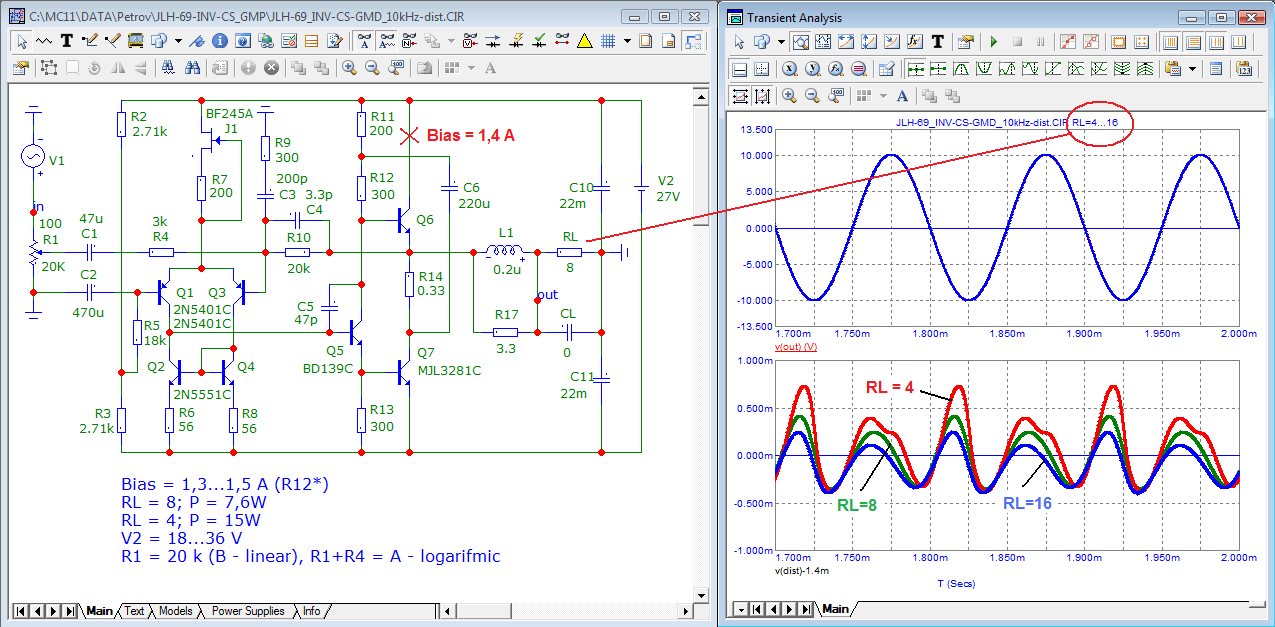

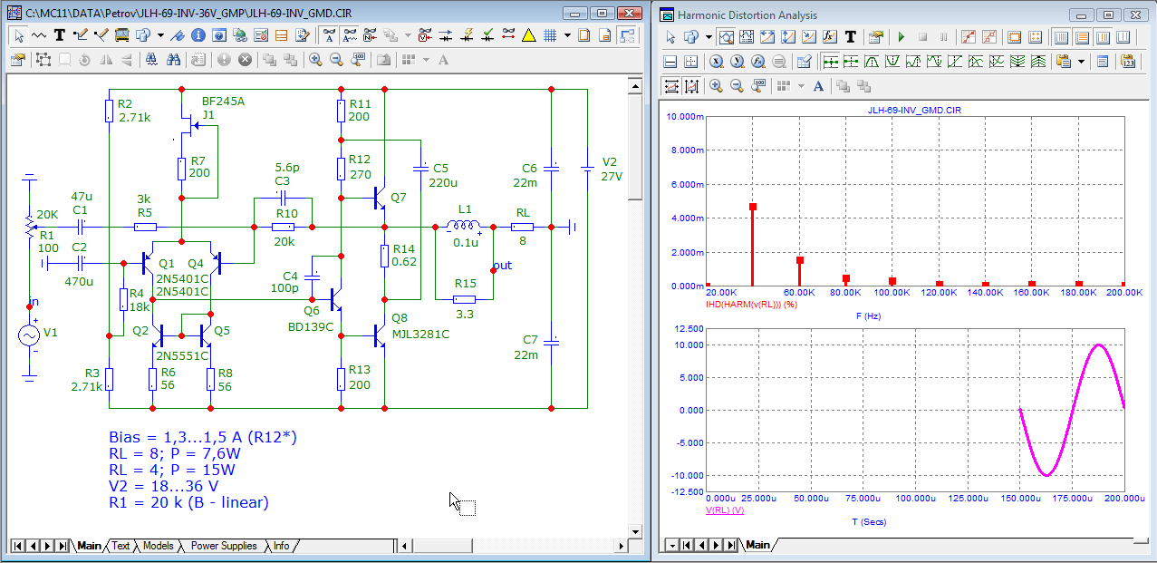

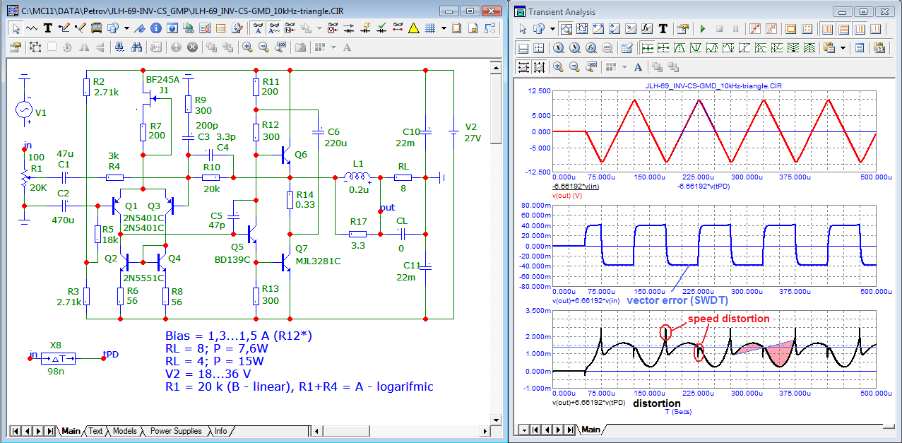

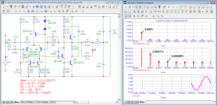

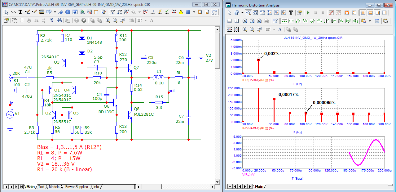

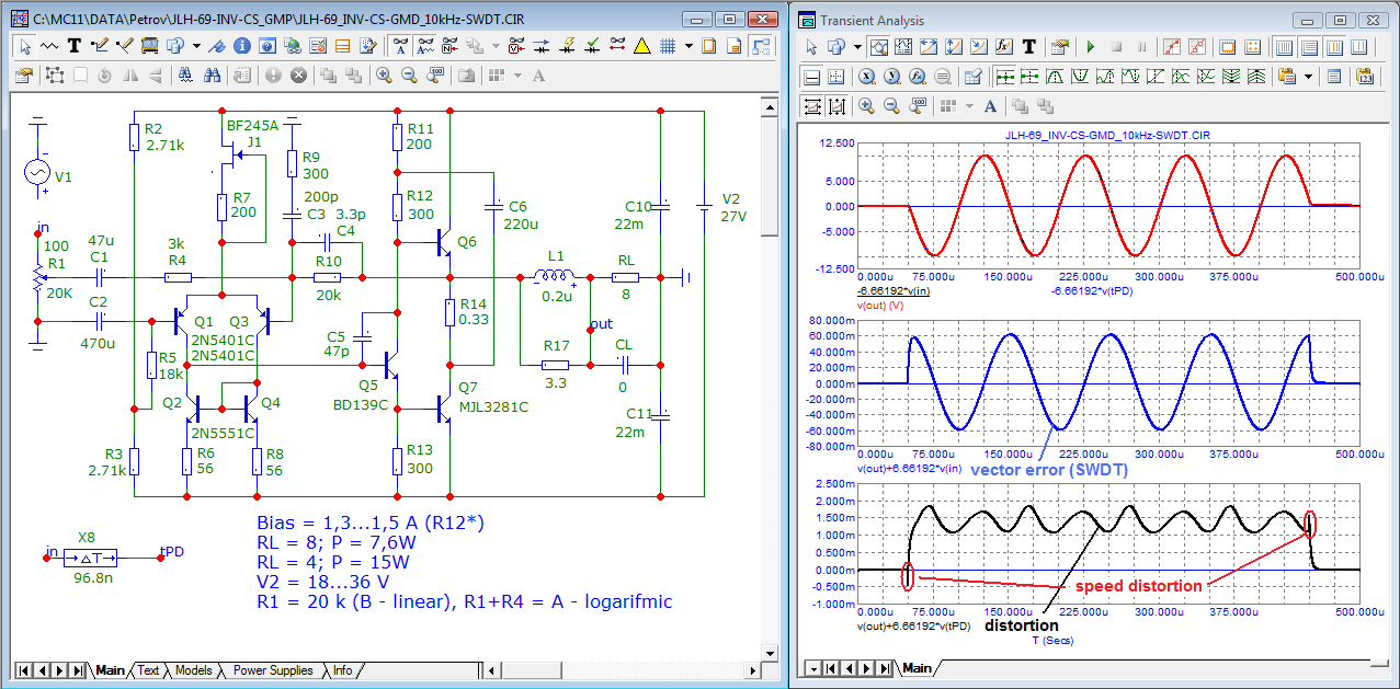

Huggygood, today amp design starts with modeling. When using correctly executed transistor models, the parameters of virtual amplifiers are quite close to the parameters of real amplifiers. I know that the JLH-69 amplifier is still very popular all over the world. Therefore, I was interested in the version of the inverting amplifier proposed by Dreew. What this modification gives, I tried to reflect as much as possible in the tests.
What does this version provide?
  • 30 dB more loop gain (30x);
  • introduced non-linear distortions are significantly reduced;
  • there are no switching distortions;
  • high-speed distortions are small, do not exceed the level of non-linear distortions;
  • wider bandwidth of full power;
  • the power supply is simplified - there is no need for an electronic filter that slows down the rise in supply voltage and the charge rate of the output capacitor.
I really hope that someone from the forum visitors will make a layout of this version in hardware and share their experience of setting up and listening to it.
Reactions: huggygood

In the past we have seen many parametric changes to the original design including many substitutions of different transistors. Also there were several more radical, structural changes. For example I have more recent 22W version, rather different from the initial design. Petr proposes an interesting radical change of the original design. I am eager to see what impact can this iteration bring in practical, real-world lay-out. From the published data this change may reduce distortion while maintaining the original sound character. I'm curious to see more.

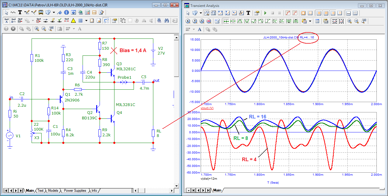

Here is the operation of the two versions when the load resistance changes. In the original scheme, depending on the load, a constant component appears in the distortion products.

......which has significant implications to the design and sound that it produces so, in which case, and with all due respect, it is not the original JLH amplifier. Yes there are many variants 'based' on the 1969 amp, but they are not the 4 transistor simple design. The answer to the first question is 'No'.
Further, where is the practical implementation and not just a modelling - the answer at the moment is 'No' and cannot be 'Yes' - see the answer to question 1.

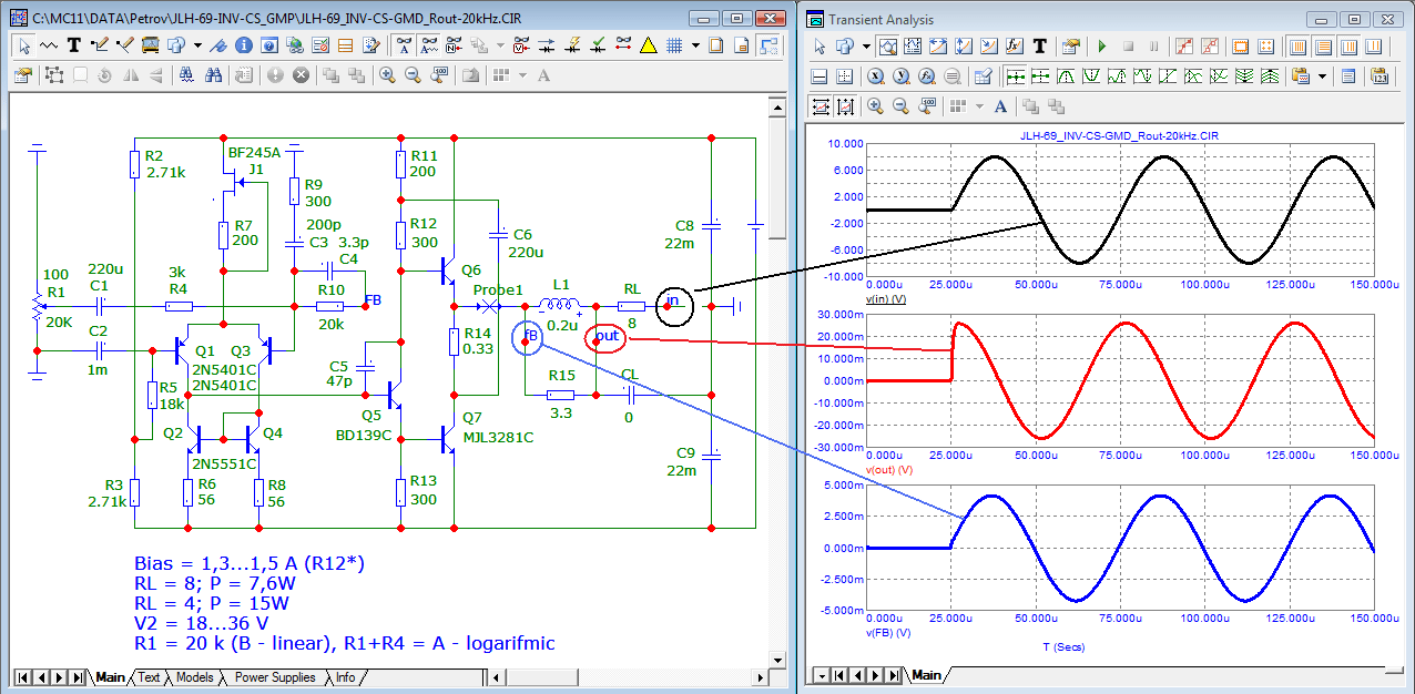

Many amplifier designers attach great importance to the damping factor, which is responsible for the output impedance.
For example, Mati Otala was a supporter of the high frequency of the first pole, in which the output impedance in the entire sound range is constant.

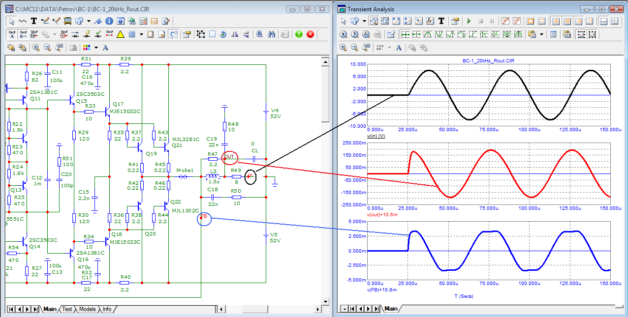

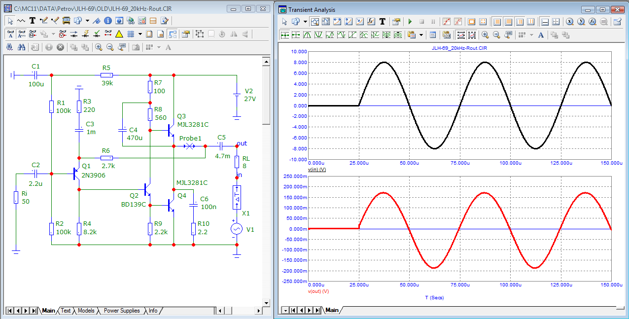

Let's check the output impedance of the original JLH-69 circuit and the modified version.
When a voltage equal to RL (8 Volts) is applied, the output impedance is approximately equal to the voltage drop at the amplifier output in Volts.
In this case, the output impedance of the JLH-69 is 0.175 ohms and is in phase with the external voltage.
The output impedance of the modified version is 0.025 ohms. In this case, the output voltage to the inductance L1 is only 3.75 mV, or the output resistance at this point is 0.004 Ohm and it is in phase with the external voltage.

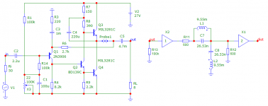

For comparison, let's check the output impedance of the BC-1 amplifier. The output impedance is 0.2 ohms and is out of phase by 90 degrees. The output voltage to the inductor L1 is 0.003 mV which means that the output impedance at this point is 0.003 Ohm, but it is highly distorted and also shifted by 90 degrees.
