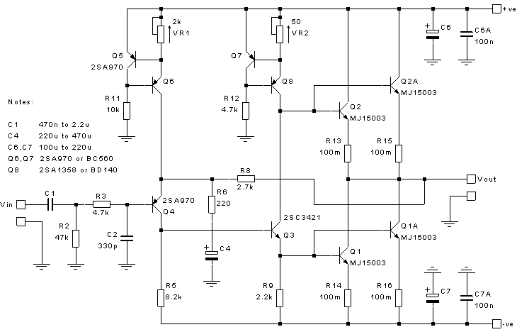

Hi, thanks for your reply.
Actually, I have 0.4V differences between both power supply i could not fixed but i am not sure if it as impact.
And for quiescent current I measured the voltage accross the R10 resistor (0.330ohm) but as I could not be 100% sure of its value, the quiescent current could have 0.1 A difference (at maximum)
You're fine. You won't be able to measure or hear any difference between channels.
I think if I just use a pair of series caps, then the two CC sources will pull the centre tap up via R11 and R12. So I'll either balance them with a resistor between centre tap and -v rail, or double the value of R11 and 12 and take them to -ve rather than gnd.
However, from what you say (quoted above) all works fine without modifying the circuit or adding the balancing resistor?
I'm away from home as we speak, and itching to get back to the veroboard...
Replying to my own thread...
I think this might be problematic. Returning the speaker to a 'ground' that's just AC coupled, a signal will modulate the CCS's and the input ground. THis could end badly.
So I tried a sim of AC coupling the speaker and fb cap (C4 in original) to PSU -v, the CCS resistors increased in valu and taken to the same point, and a new pair of resistors and a cap to create VCC/2 for the inputi This seems to work.
Any thoughts?

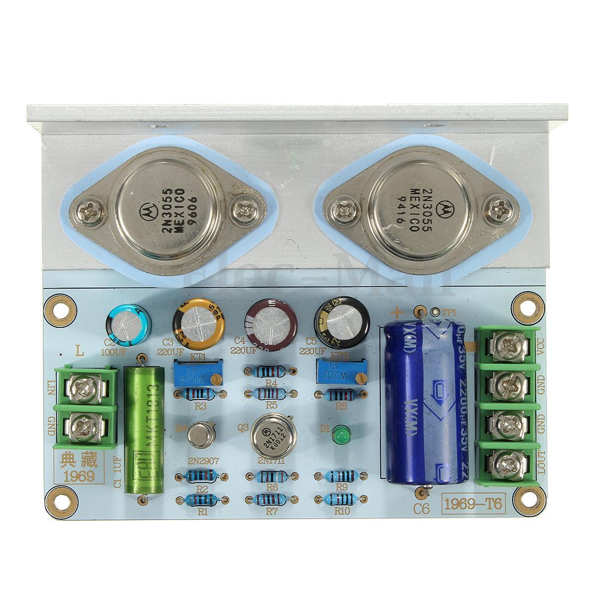

Reality check......What is the opinion of the cheap Chinese 1969 kits that you find everywhere?
https://www.ebay.com/sch/i.html?_from=R40&_trksid=m570.l1313&_nkw=393408084058&_sacat=0

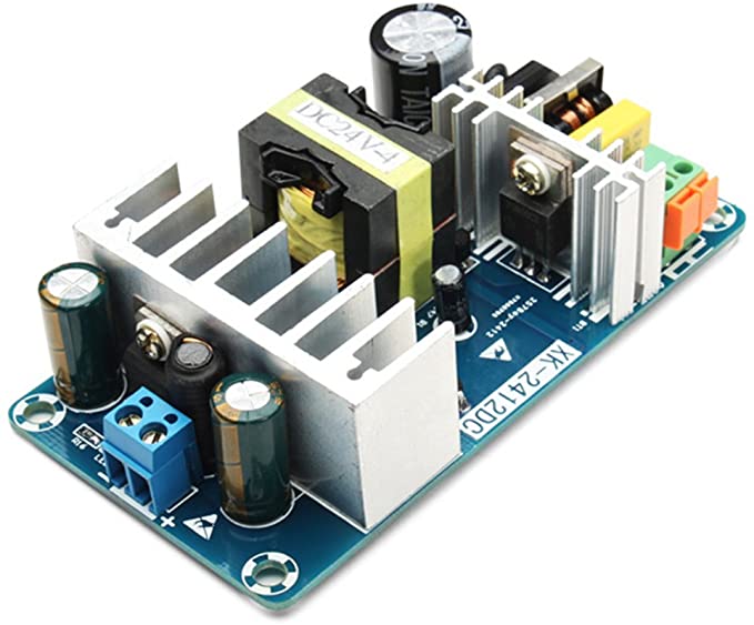

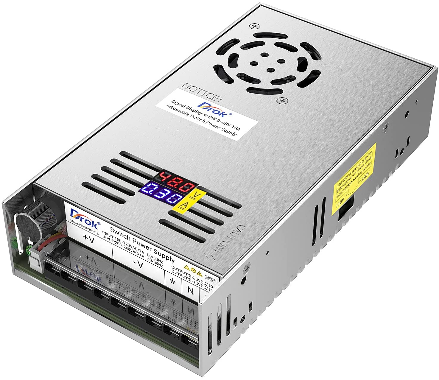

If one was to purchase two of these module kits, a couple big heat sinks and build some type of cabinet, , what is the easiest way to power such an amplifier.
Would buying a simple Buck Converter switching power supply like from "Mean Well" be a good idea?
Is there a COMPLETE power supply kit available that someone with my knowledge level could build?
What is the opinion of this type of PS...
https://www.amazon.com/gp/product/B01EE4UX18/ref=ox_sc_act_title_3?smid=A30Y6WWS77DGEW&psc=1
Can these amps run off a simple transformer?
Any help as I start this adventure would be welcome....Thanks in advance

Hah, I too read them all and tried not to get sidetracked.
A few here have built various eBay kits and as far as I recall noones suffered the release of magic smoke. I'd be skeptical of the thermal efficiency with that rather flimsy bracket. Better to mount the transistors directly onto the heatsink, there's a lot of heat to get rid of. Conrad do a very neat solution for to3 cases: http://www.conradheatsinks.com/products/single_f.html
You could use these with the eBay boards and recycle their angle. I've used these heatsinks, proper quality they are.
I'm using Meanwell smps for a class d amplifier with no issues and plan to use them with a jlh. Linear transformer and caps are bulky and expensive, and the series resistors or regulators chuck out still more heat that we don't need. A few forum members have used smps with jlh. I see no reason not to. Someone mentioned that if you're using two you might need to beware of beat frequency. I haven't had a problem with my two Meanwells.
Yes you can run any number of them from a single transformer. Just needs to be powerful enough. Ah... you said "simple" not "single". Yes, but you need a lot of capacitance and ideally some RC filtering. https://www.duncanamps.com/psud2/ is a very useful tool. Hours of fun, and you'll always come to the conclusion that there's no such thing as too many capacitors.

after if you have read the whole thread, you should know that the first price Chinese kits are very good, that it is necessary to change all the transistors by authentic ones, that it is not necessary to put power transistors super fast, that the pairing of these is important.
it's a simple amp, but simple doesn't mean easy, it just means it's easy to operate, but to get the best out of it takes hours and hours of work and testing.

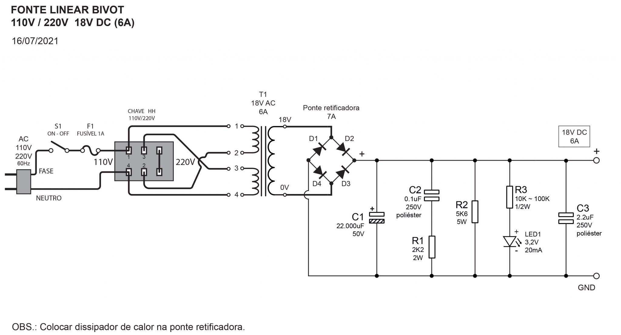

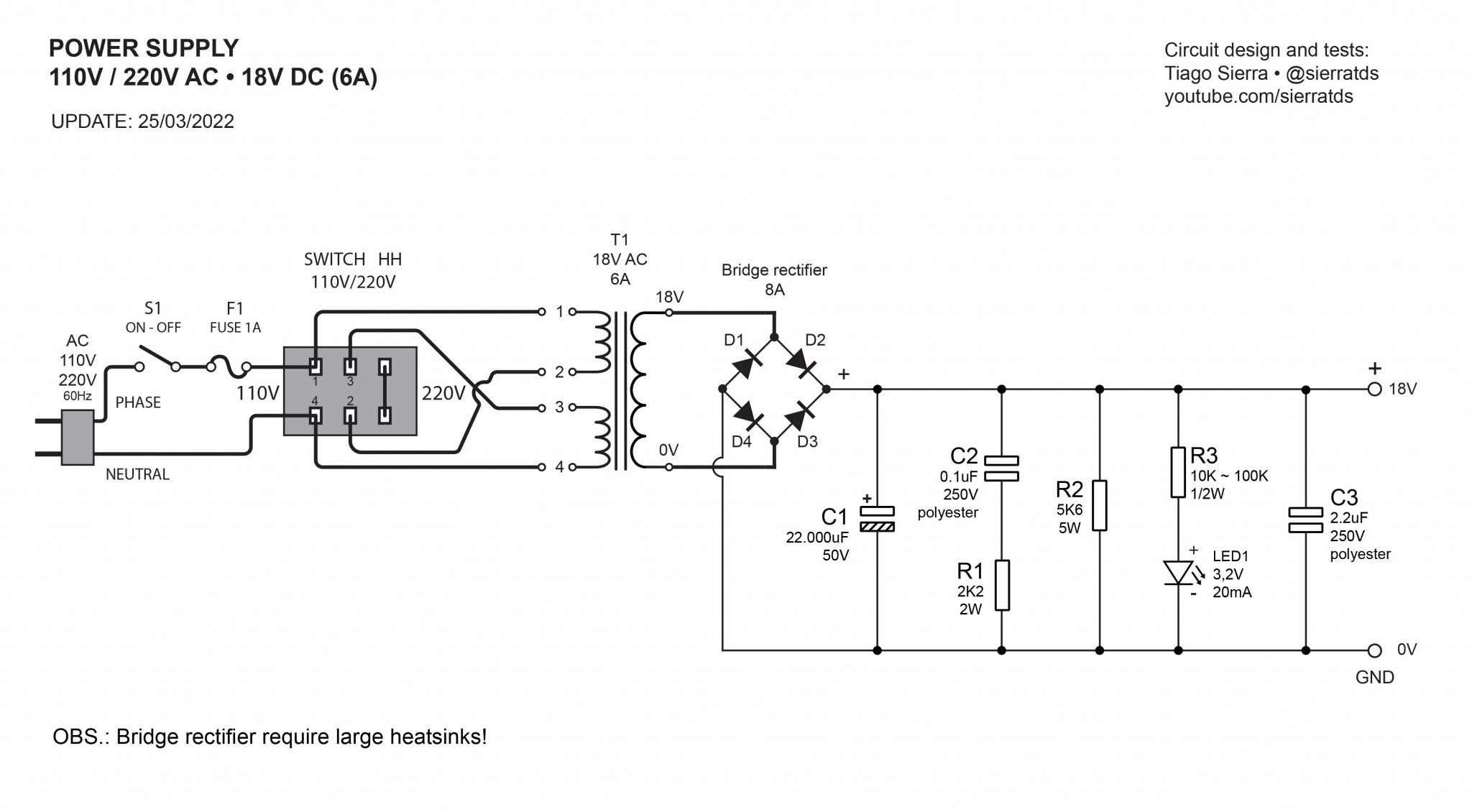

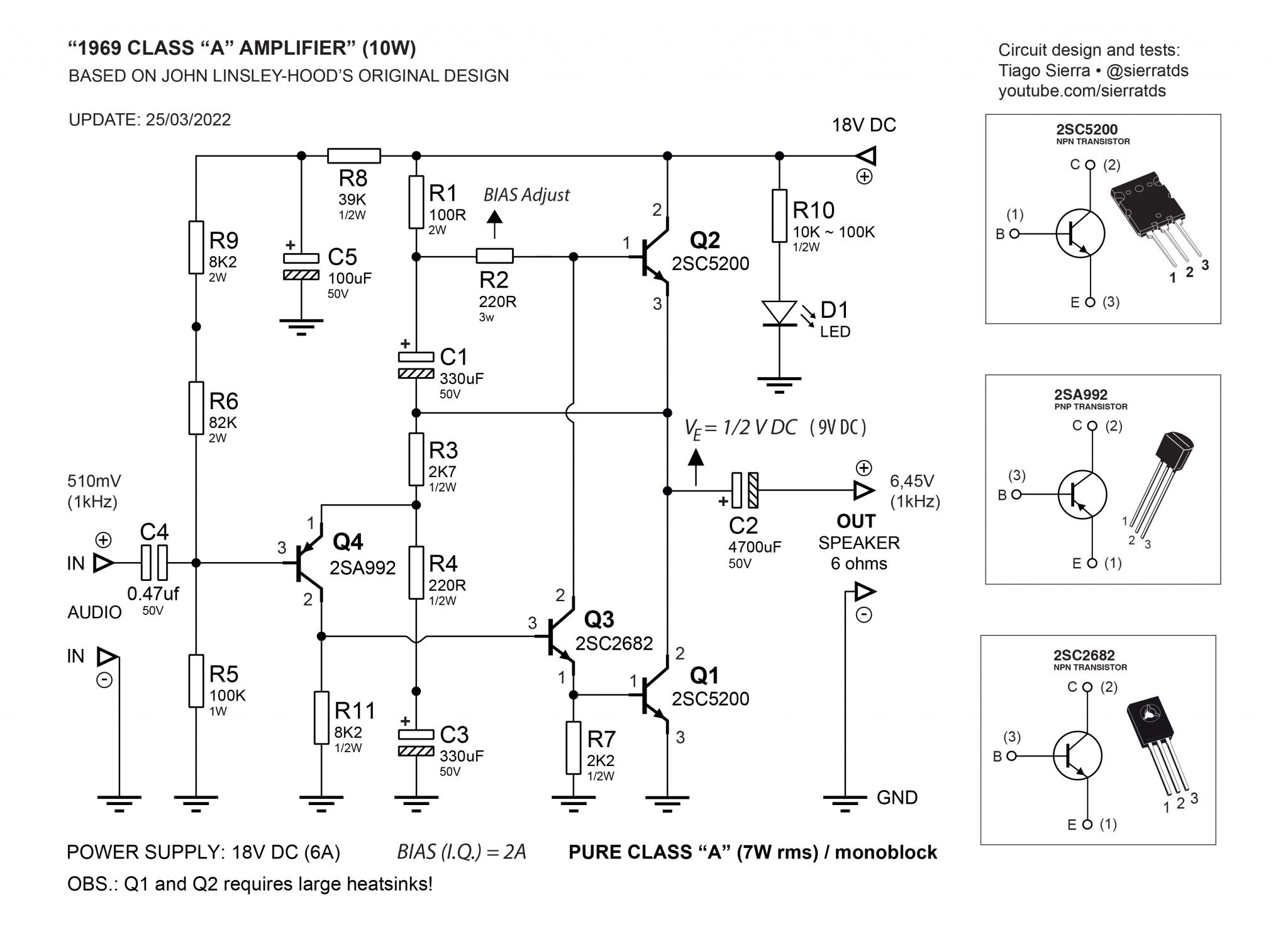

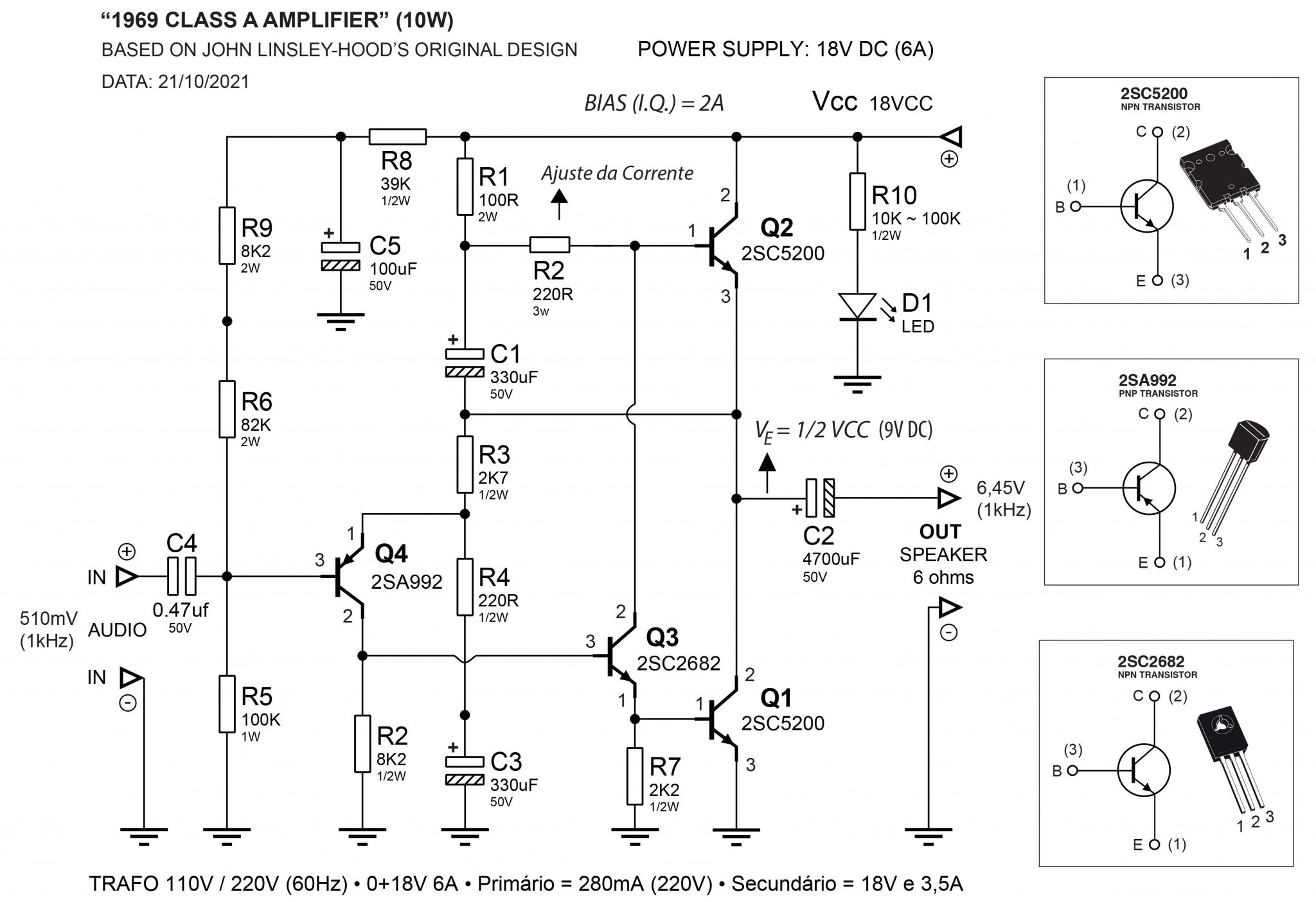

Hello, guys, I'm doing other tests on my JLH 1969 (10W). Putting signal to test the output. Maximum signal input is 524mV. Maximum output 6.45V. Test done with 1kHz.
In this video I show tests with other frequencies, to see the wave signal.
Input signal = 480mV
Specifications:
JLH 1969 (10W) monoblock amplifier.
I set up 2 amplifiers to make stereo.
Power supply:
Transformer: 110V / 220V (60Hz) / 0+18V AC 6A
Rectifier bridge: 8A
Capacitor: 22,000uF (63V)
Power on amplifier board: 18V DC
Bias (I.Q.) = 2A
Distortion-free maximum power (1kHz) = 7W rms (per channel)
Distortion-free maximum signal input (1kHz) = 524mV (-3.5dB)
Maximum undistorted signal output (1kHz) = 6.45V
Speakers = 6 ohms
Temperature in components:
Amplifier on for 2 hours.
Ambient temperature = 25°C
Transistor 2SC5200 = 55ºC
2SC5200 heat sink = 40°C
Rectifier bridge = 51°C
Rectifier bridge heat sink = 39°C
Transformer temperature = 40°C
Playlist videos showing the amplifier and tests:
https://youtube.com/playlist?list=PLfaWCRXEiDtwbxh9Z5zZtqOg1GG5cesc6
Circuit diagram PDF:
https://drive.google.com/drive/folders/1hqNqf1LpdyNb26nMPSwo5KOk3z-7M26V
Tiago Sierra
