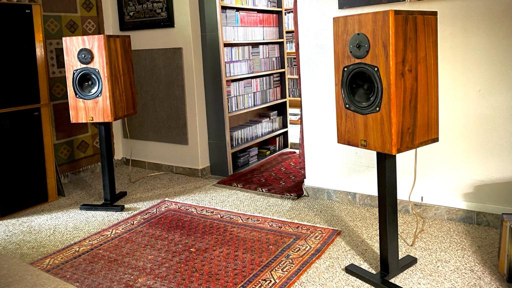

The listening room is of paramount importance for the sound of the audio system.new room

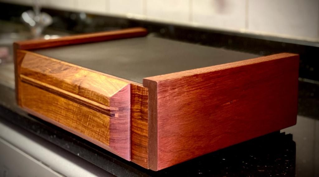

JLH centre top in wood. My brother is more fanatic than anyone else I know. He bought literally 10s esoteric amps (including Accuphase, Naim, Pioneer SA9100, Cambridge. Audio Evo 75, Krell KSA50) of amps over his mania period. He has not changed in I think 5 years, The built-up amp chassis was lying in my junk cupboard since maybe 1980 the sound to him is perfect, uses KEF drive units B200 plus T27, old audiophile units he eventually bought from hearing my very first speakers, Concerto almost 50 years ago. Furthermore, he is an audio nut. Will Never listen to streaming, only lately buy a Topping DAC was never impressed with it - collected I don't know possibly 7000 CDs, of every genre you can imagine and uses a classic Marantz DVD, player, swears by it.
Never listened to audio reviews in his life only trusted what he hears and liked, never had or will have a DSP or room correction EQ, never a piece of sponge, egg box or anything in his listening area - cared nothing about brand, always gave his amps and stuff to mates for free, so his wife did not get upset with his collection of crap as she called it. Never knew a thing about electronics, he is a devoted pastor, hardly has time for himself but cannot wait to get home just for an hour of bliss in his favourite leather recliner not even centred between the speakers. Hated the word Audiophile....... Travels the world works for Open Doors, spreading bibles to God knows where....... was locked up for three months in Vietnam for his illegal smuggling activities as a calling. Now, that is a devoted audio freak! Never listened to what I had to say, could not care less.
Your built in DSP (brain is)The listening room is of paramount importance for the sound of the audio system.
You guys are all spot on. Look at my previous reply. His auto Room EQ was momentarily corrupt. He has to do a complete reboot and re EQ and phase adjustment and reflection interference and Dolby recalibration and god knows what?
The rest will happen automatically with in a few listens, he will suddenly recalibrate, do exact DSP in his head, within a few hours, If he crawls around the floor to hear a sub that actually worked before is nuts. He would not know. It is an automatic processor called experience and preserved in E² only can be instantly corrupted by any external stimulus but has built-in auto protection, whether he is technical or not, is irrelevant.
