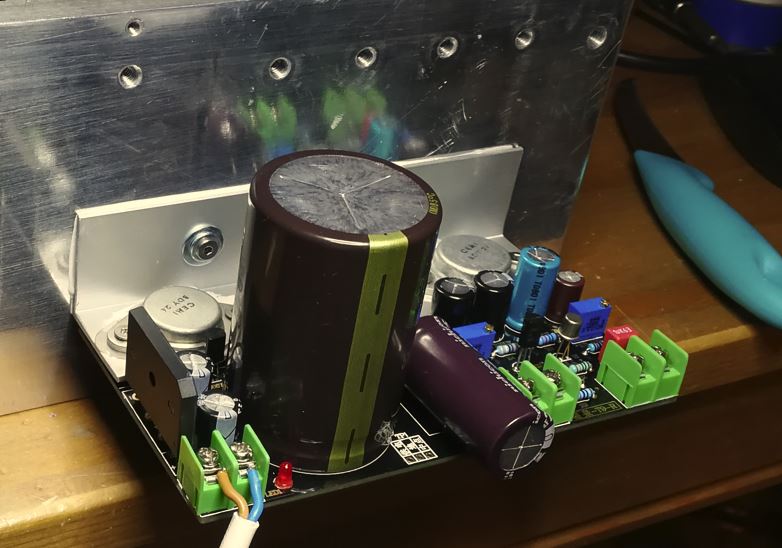

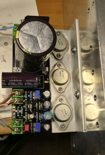

Hi!
I am finishing of my JLH build. It's Chinese clone with capacitance multiplayer embedded on the amp board (main caps = 22000uF/50V):
There is no schematics available or at least I couldn't find any. All the values on the board resemble the values I have currently mounted.
C9 - input capacitor - in my case it's 1uK WIMA.
As output transistors I used CEMI BDY24. Output capacitor is Nichicon 4700uF
1 toroidal transformer for each channel (dual mono) going into 8 ohms speakers + separate transformer for pre-amp:
30VDC rail. Point of work set for 15VDC with 1,2 Amp of current flowing through.
That's all about the setup. Now, it sounds VERY good, clean and sharp. Although, it lacks on base. I don't want it to be a thumping machine, that's not what this design is for - but to slightly increase it.
Does any of you could halp me with any suggestion of what can I modify to achieve this? Or any other advice to further sound improvement for that matter.
If more detailed description is needed, please let me know and I'll post an update.
Thanks!

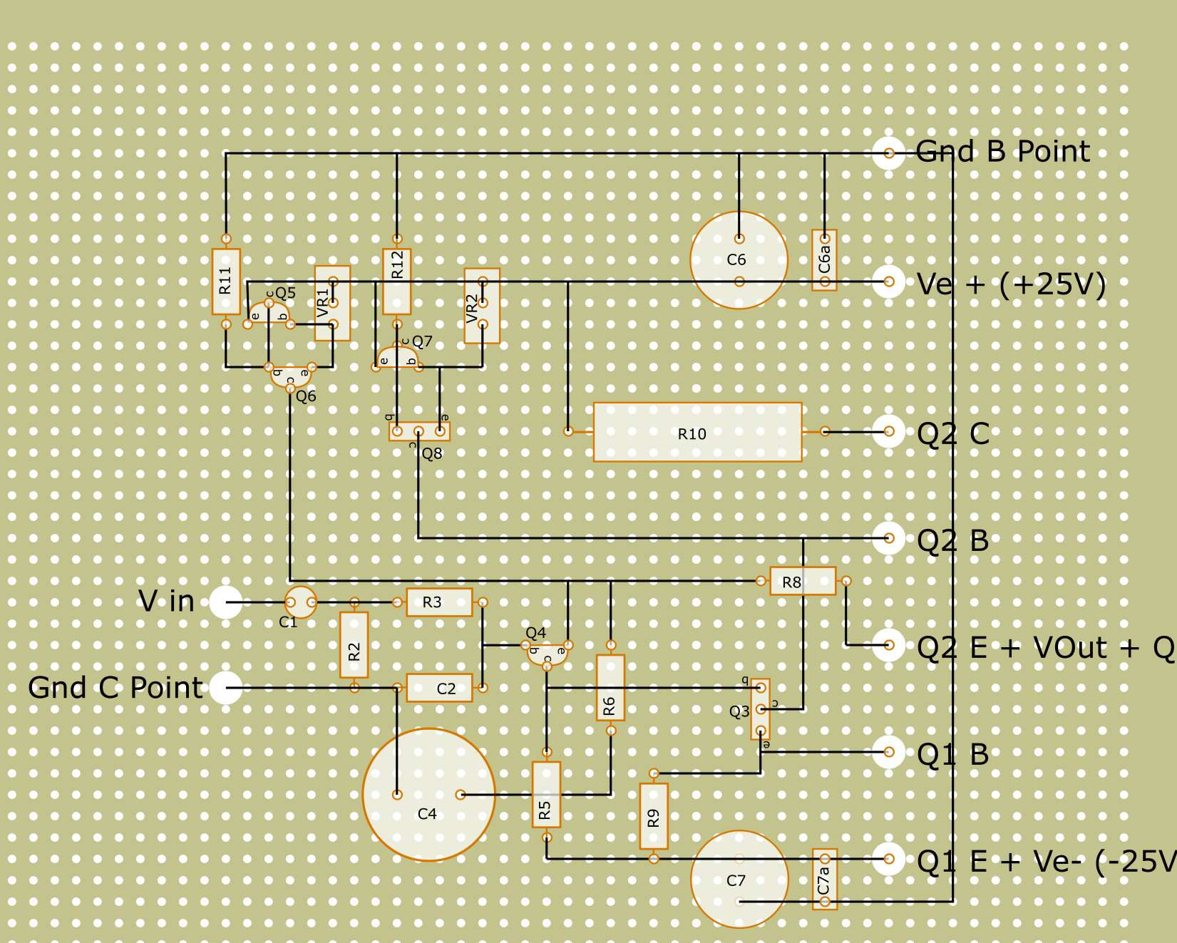

Hello,
Could someone help me by reviewing my layout? I am using the The Penultimate Circuit from https://sound-au.com/tcaas/jlhupdate.htm.
I try to let space around R10 as it will heat a bit, and also for Q8 and Q3 for its heatsink.
I also separate GND for critical and no critical parts
For Q1 and Q2 (MJ15003) il will put cable

I wrote about it before in the thread, IMHO the capacitors need to be increased abt 10x from the original design. Input cap, cd-blocking for feedback and bootstrap cap. Also output cap is important, it will react with the speaker impedance, and sometimes even increase the bass output, depending on speaker impedance and capacitance. You can simulate this with Xsim etc if you have impedance measurements of your speakers.That's all about the setup. Now, it sounds VERY good, clean and sharp. Although, it lacks on base. I don't want it to be a thumping machine, that's not what this design is for - but to slightly increase it.

Basically, you can increase capacitance on all caps, and bass should improve, original design values x10 is my general guideline. However, this amp will never give massive 'bass control', output impedance is too high to do that.

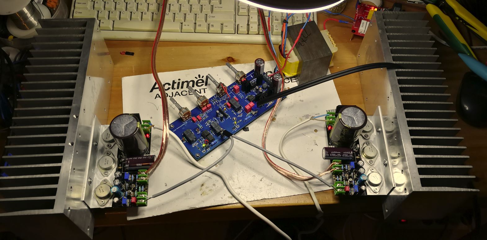

so this is my test setup for the jlh boards. these boards are 99% correct to the original.using new old stock mj480 transistors. i have chaged r6 to 120ohm r5 to 75k. with an 18v supply its running stable, i have fans but not using them at the moment.

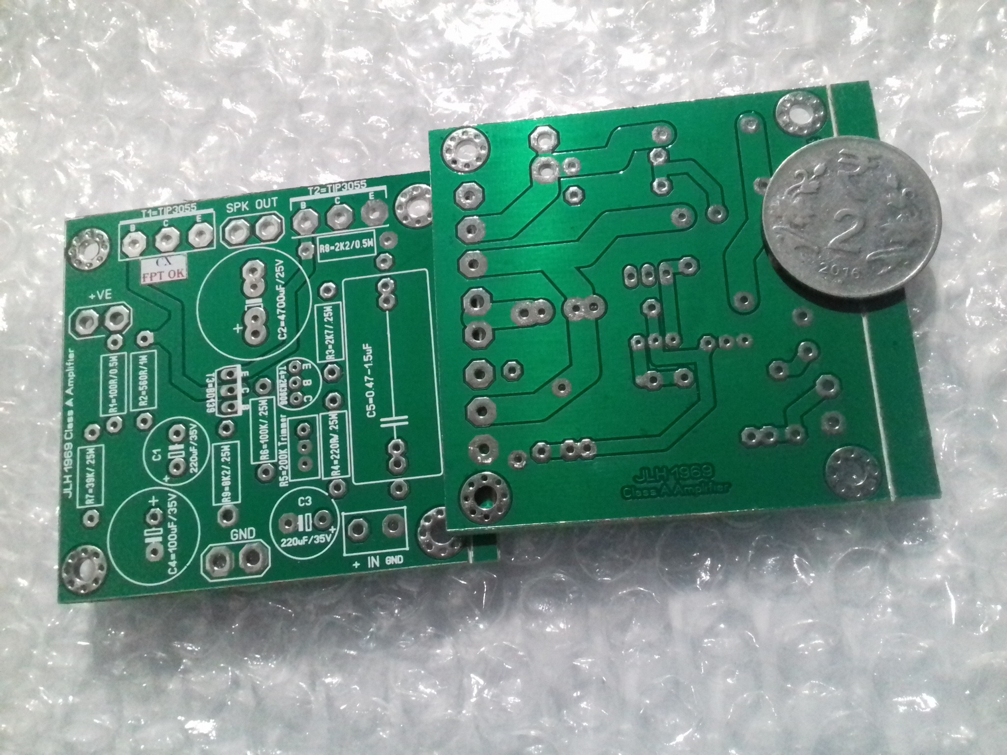

Hi everyone, i've a problem & i need your suggestion. For powering my JLH 1969 i want to use separate capacitance multiplier for each amp. Power supply requirement is 25vDC & i want to set quiescent current at around 1000ma.
My question is how to choose proper transformer for this? I mean what is the required secondary voltage & VA rating for transformer? Is dual 25v secondary & 250va transformer perfect to get clean 25vDC out from cap multipliers? As you know Peak dc voltage after rectification & smoothing is around 34vDC, so don't you think 9v differential & 125VA/secondary is good enough??
