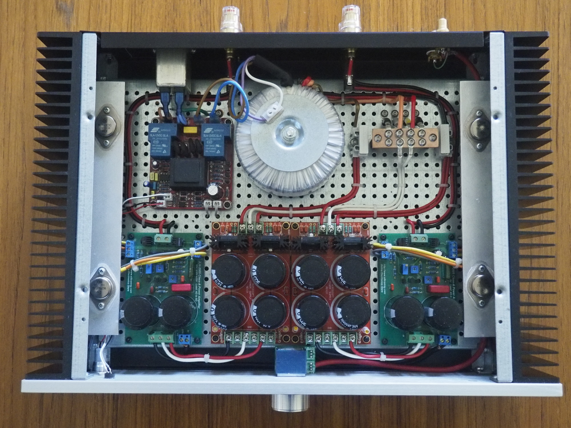

Attached is a picture of the JLH amp I built some time back. It has since been modified - I removed the soft start board (left rear), "Ground Lift" (Right Rear) and the twin PSU's (Centre front). The twin PSU has been replaced by one of Bonsai's Ripple Eaters which feeds both amps.
The output trannies are mounted on Aluminium 'L' brackets on both sides. The 'L' bracket is positioned roughly 1/3 from the bottom of the heatsinks.
The two output transistors are equally spaced on each bracket.
The case is a Modushop 2U. With ± 15V DC supply and 1.5 Amp bias, the heatsinks run at around 30°C above ambient.
Hope this helps.

I purchased an off-cut of 'L' shaped aluminium extrusion from a local supplier and drilled the TO-3 holes myself using a TO-3 insulator as a template. As OldDIY has mentioned, the thicker the extrusion the better.
The chassis is the 300 mm deep Modushop one and I ran the 'brackets' to hold the output transistors (almost, but allowed for 'space' at either end for wiring/sockets etc on the rear panel) along the length of the heatsinks and secured at multiple points to ensure a 'tight fit'.
Thermal compound was used between the bracket and heatsink to ensure good thermal contact between the aluminium brackets and heatsink. The bolts used to attach the bracket/extrusion to the heatsink, from memory, were probably M4. The holes in the extrusion would have been 4.5mm and the matching ones in the heatsink were 'tapped' to accept the M4 bolts. You just have to make sure the tapped heatsink holes are as deep as possible but do not go all the way through the heatsink (my heatsinks 'back thickness' are 5mm, from memory, which would roughly mean 4.5 mm deep holes max). The length of the bolts depend on the thickness of the Al extrusion and depth of the holes.
The Al extrusions were placed about 1/3 of the way up the heatsink. This was done under advice because as 'heat rises' the top of the heatsink will always be warmer than the bottom. Ditto the spacing of the transistors around 25% from the end of each extrusion to ensure they are equally spaced.
The bolts used to connect the transistors to the heatsink were M3, because that's the widest that will go through the transistor insulators required for mounting. Length depends on the thickness of the Al extrusion plus the transistor body insulator (I used mica insulators here) plus the bolt insulators. Drill 4mm holes (to accommodate the ± 4mm bolt insulator thickness) straight through the extrusion and put a nut/lockwasher on the other side and chose a bolt of appropriate length.
Remember to 'de-burr' the holes made as if there are sharp edges they might pierce the transistor insulator and short the transistor body to the heatsink - and blow fuses.
