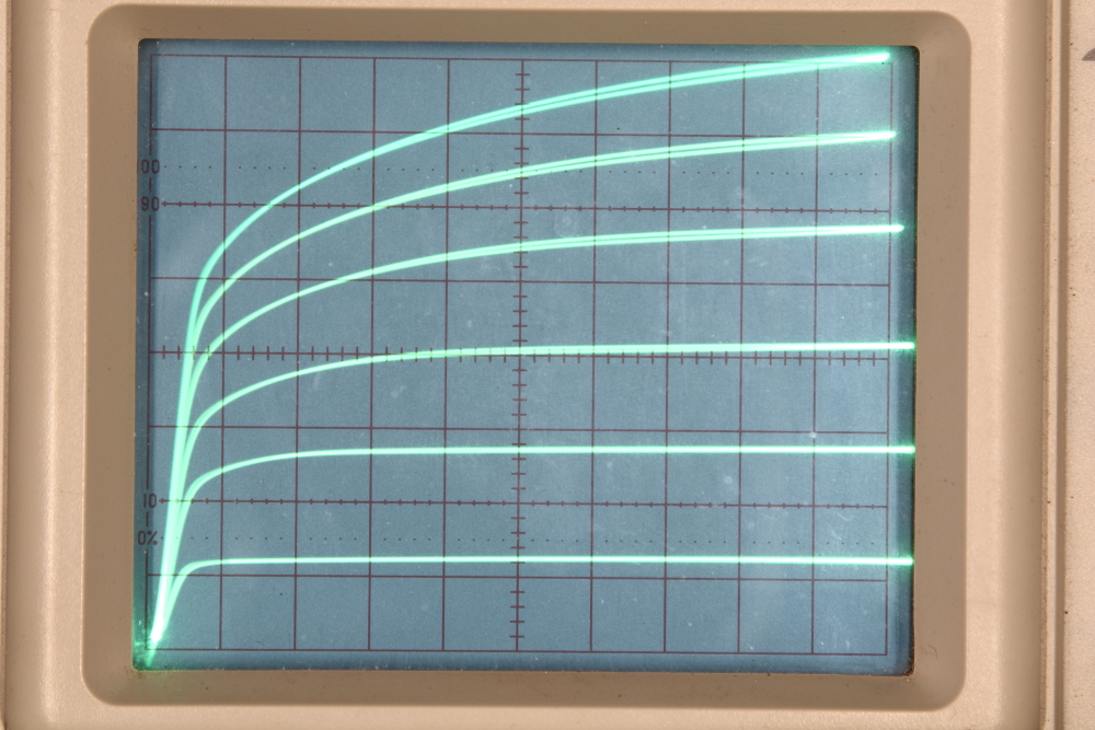

That circuit shows it is really quite simple to measure the gain of a transistor.
For a power transistor you might want the ammeter to read up to 10A.
You can build a simple gain tester with a multi-way switch to change the resistors in the base.
I usually do not use a resistor in the collector so that the collector voltage is fixed. (but there is a sense resistor in the emitter for the set-up below)
I use an ex-computer PSU with 5V/20A to provide the power.
It is essential to bolt any power transistor to a large heatsink (5V4A=20W) and make the test as quickly as possible. Gain changes with temperature, as does Vbe but at 5V supply it's manageable.
One of the projects still on my "to do" list is a pulse tester which would need low value resistors to measure the high current on an oscilloscope. I already use a similar configuration to turn a scope into a curve tracer.
This image looks like a curve tracer but is in fact a multiple exposure with each curve a different base current. (Yes, I know, it's a slow-mo curve tracer! But those old Teks are hard to find).

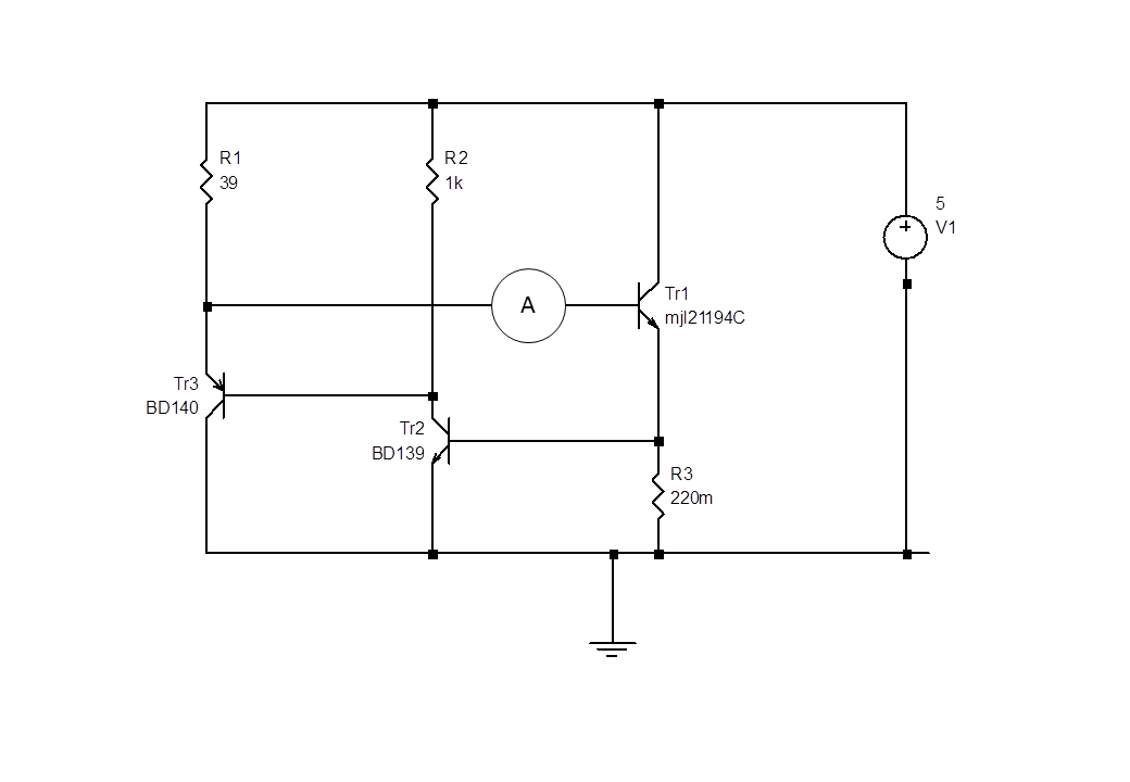

manel - here is the test circuit with the ammeter added. The current should be set to 100mA if you don't have an autoranging meter.
This determines the base current needed for the transistor to pass 3A (this current can be checked by measuring the voltage across the emitter resistor).
The base current is therefore needed in the circuit to drive the upper output transistor at full current. That is set by R1 and R2 (plus any other series resistor like R12 in Prasi's diagram).
You need to add a small margin so that the driver transistor does not cut off completely.
That would be something like 10-15% extra, but any increase has a direct impact in output dissipation, and standing current, of course.
In Prasi's circuit if the base current of the MJL21194 is 50mA, say, then adding 10% means 55mA in the resistors. The supply voltage is 24V so the voltage across the resistors is half this, less a Vbe of the upper output transistor, or about 11.4V.
That makes the resistances needed total 11.4/55mA=207 ohms. These can be split 50:50 but reducing R1 generally helps. In Prasi's circuit R1 is 47 ohms, and R2+R12 is the remainer at 160 ohms, though probably the 10 ohm is not really necessary - but the output stage current will increase a little if omitted.
