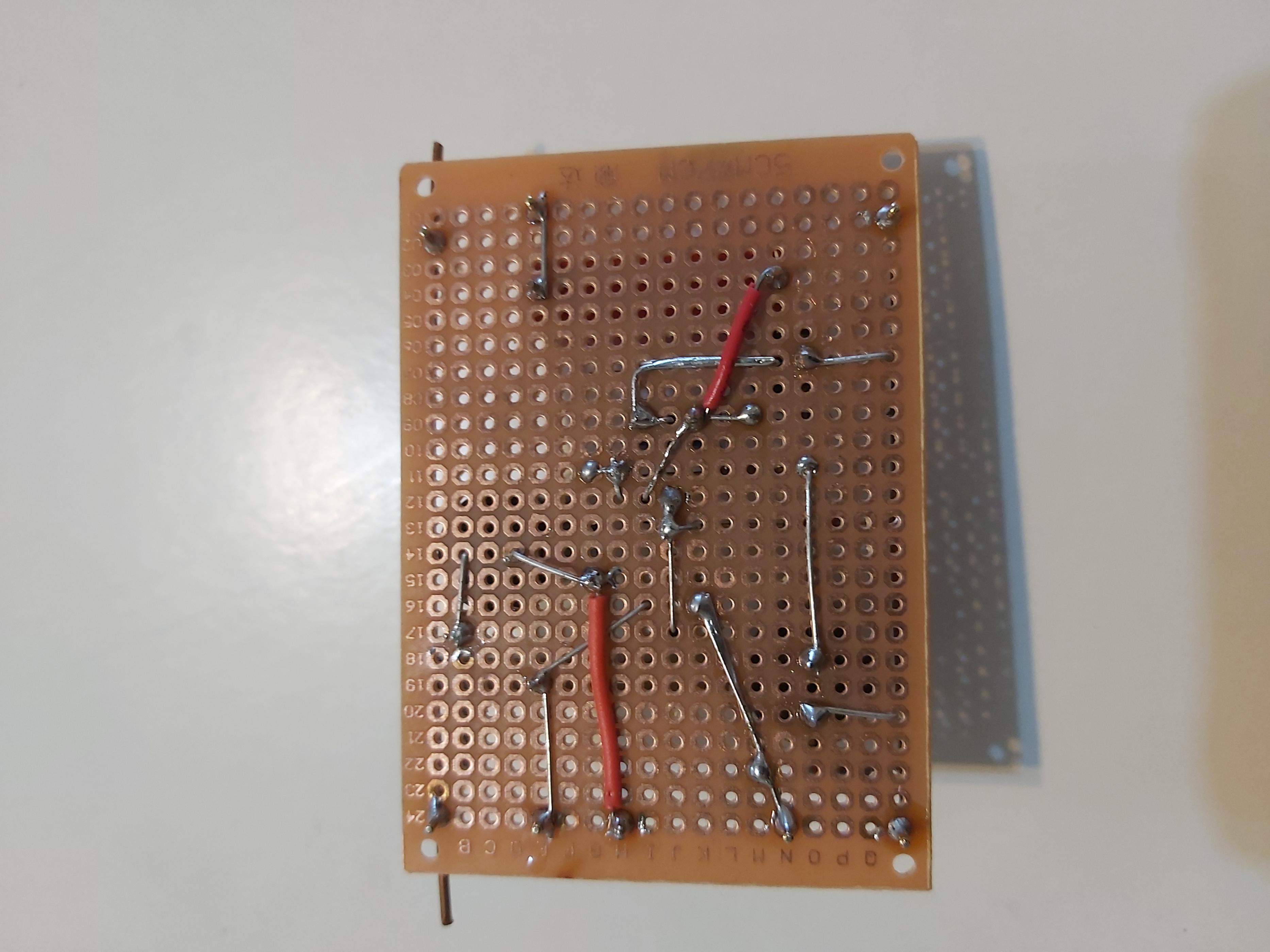

Thank John. The fan is rated to 0.63amps at 12V.
My amp is 1969 - see attached. I hear you about the preference for larger heat sink. It was a combination of things that made me think of doing it this way. One was that my version is quite low powered. I am looking at 19V after filtering into 8 ohm load. I was planning on using Iq 0.95amp which I believe should give about 4W with 18W heat dissipation per channel. Another reason would be that it would be more compact and not have hot parts exposed (young children).

Hi everyone. Wondering if I can get a little advice for my build. I have finished my amp boards and am looking at the chassis arrangement and power supply.
I am using an old amplifier chassis with perforations underneath and on top. I was thinking of using four separate heatsinks (one for each output transistor) arranged in a circle with a 200mm brushless 12v fan that I have to enhance cooling. I have tested the fan with lesser voltage and it runs right down to about 4V just slower. The fan is quiet when run off a regulated lab power supply.
I have a transformer which puts out 12.15V DC rectified with no load. I was thinking of just putting some decent capacitance across it and running the fan directly. I feel I don't need to be able to control speed of fan given fairly stable heat dissipation of Class A. What do you think? Should I just try something like a good 10000uf cap and if the fan makes no audible noise then go with it?
The mains will be split to power both this transformer and my main transformer powering the amp. A less than perfect psu for the fan won't affect the sound quality from the amp will it?

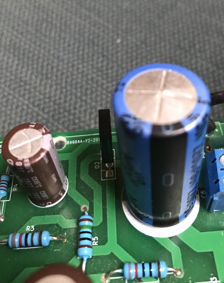

Bulged capacitor
Hi, I wonder if there's any problem with my JLH 69 that keeps bulging output capacitors. They are rated 50v and it happened in two different brands. Also, I've used them for less than a year. Are frizzing temperatures a problem?

I appreciate your answer OldDiy.
-The capacitors are Nichicon audio rated, 2000 Hrs @ 105°C

Yes, check to make sure that the polarity is not reversed on that output capacitor. I can't quite tell from your photo but I wonder if the capacitor is installed backwards.
Perhaps post a larger photo (of the full PCB) and also let us know if you are using NPN outputs or if this is one of the PNP JLH kits.
If you have the schematic for your board or kit then post that too along with the full photo.

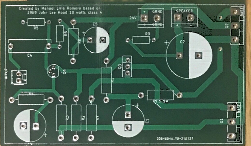

The output capacitor is definitely backwards, and the name of John Linsley Hood is misspelled. So embarrassing since I designed the board.
