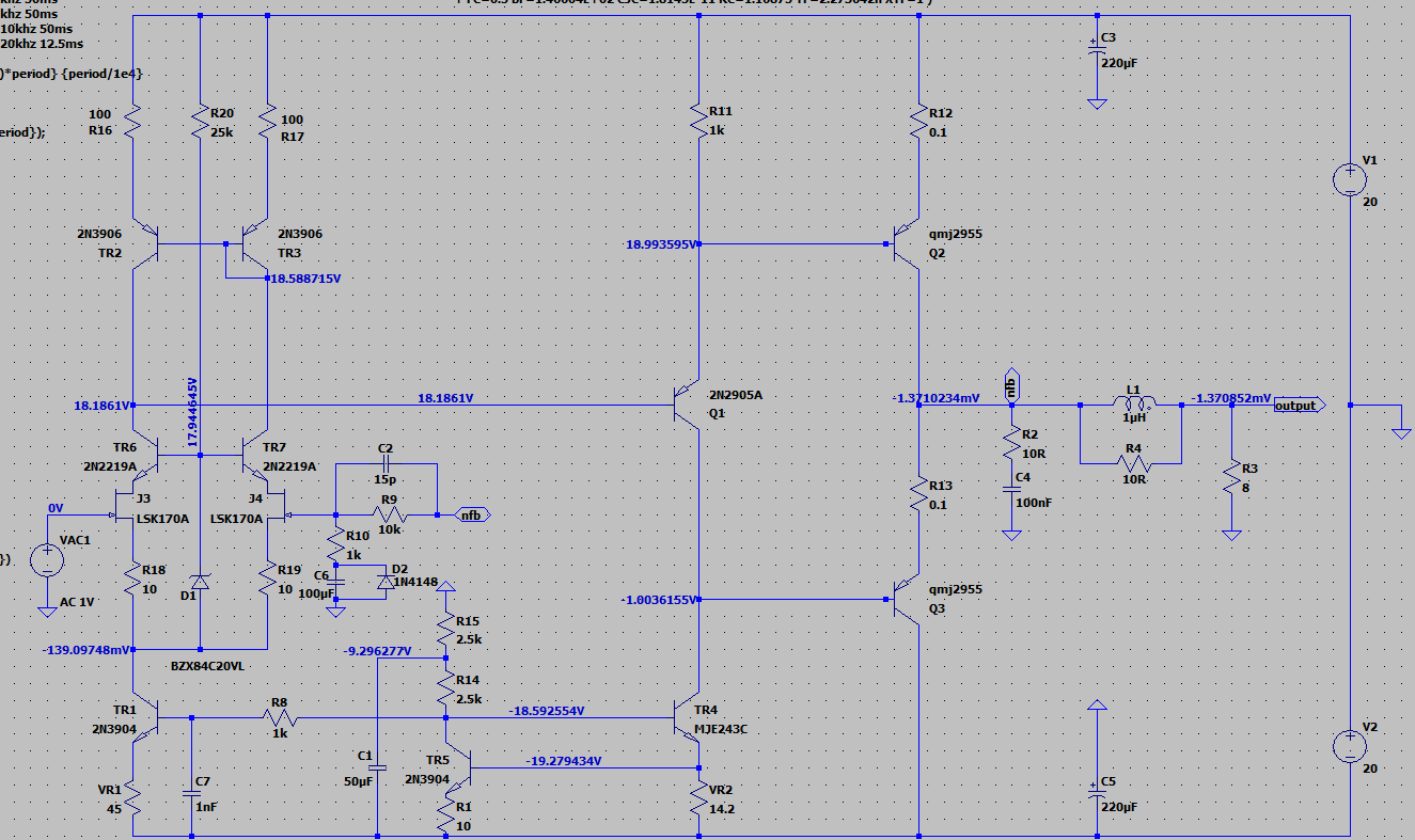

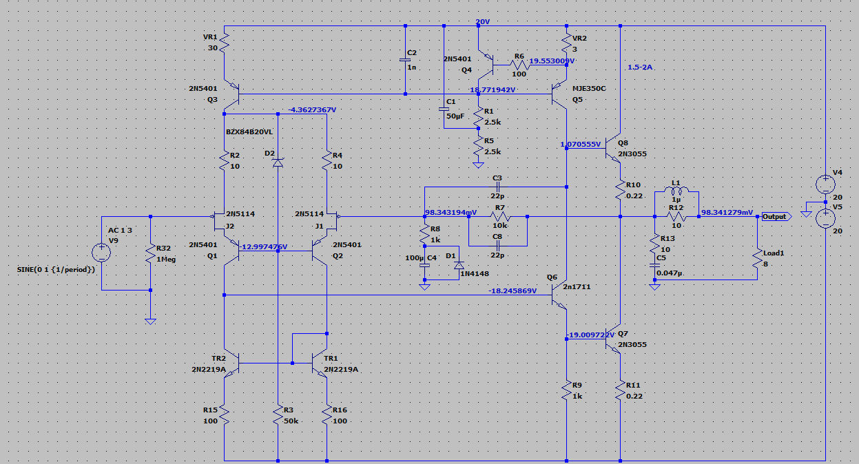

p-channel JLH and n-channel JLH with FET differential inputs
These two circuits were from a previous aborted OEM project. I do not have any other further plans for them now. So I share here and see if there are people interest in improving or making use of them.

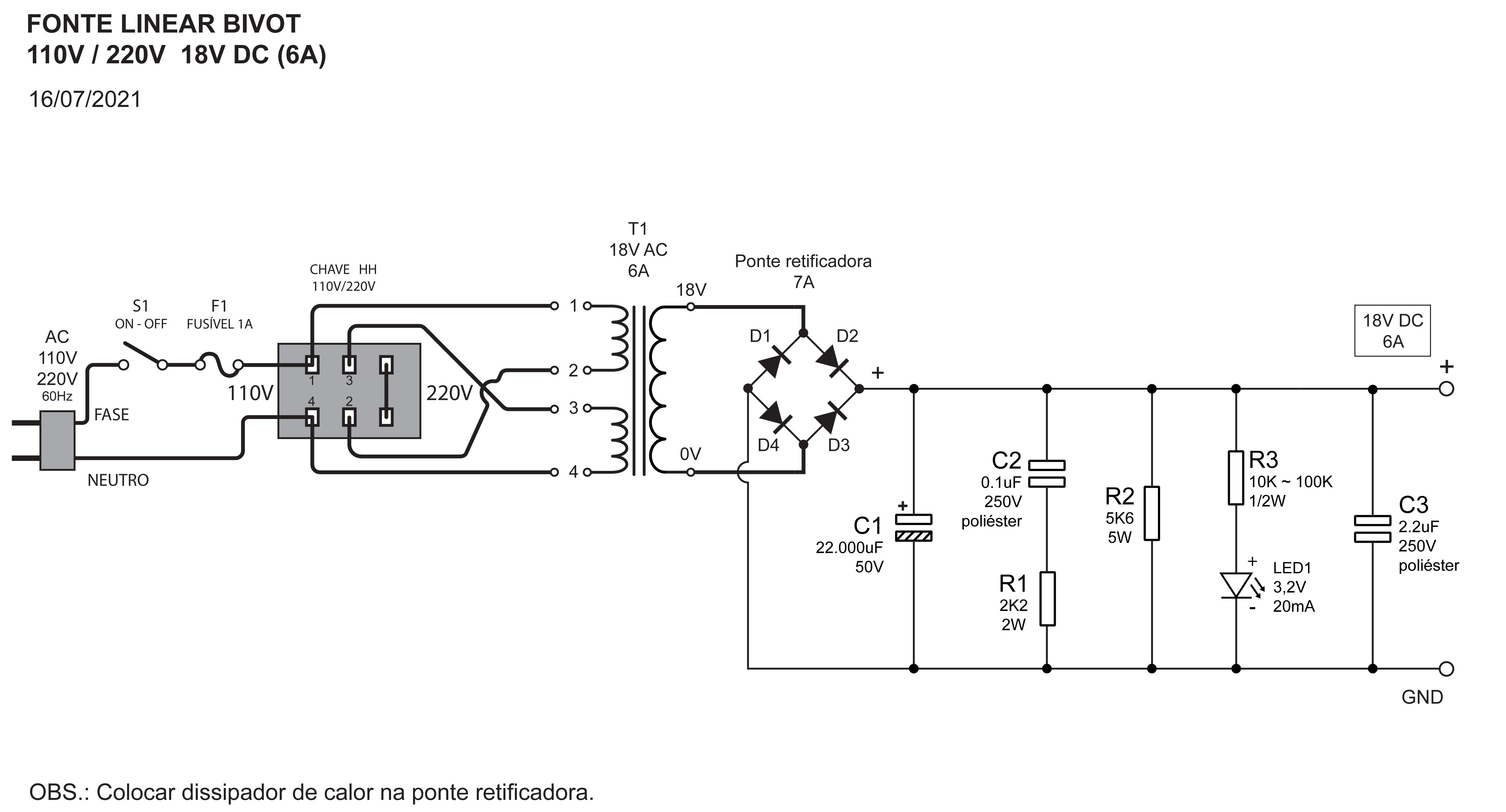

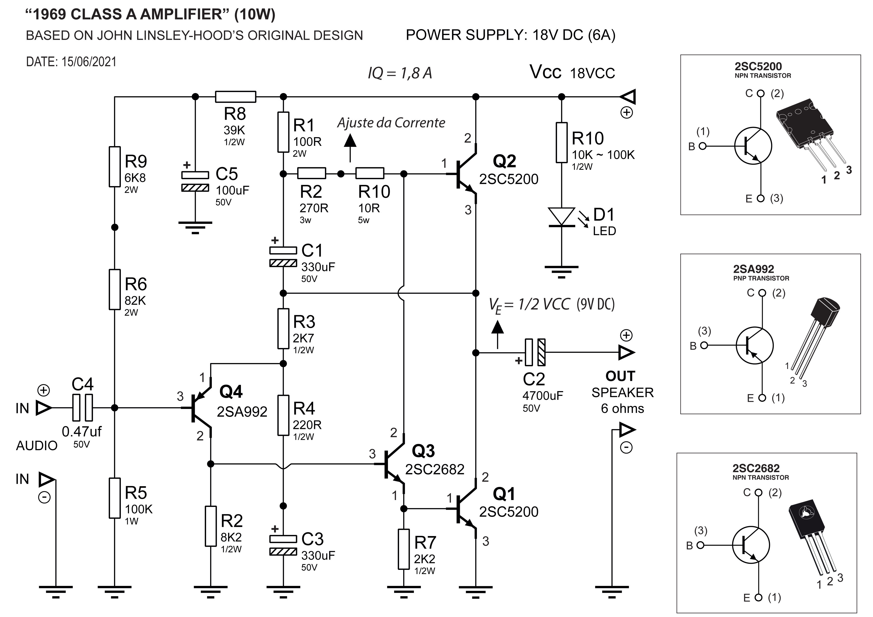

CLASS A Amplifier - JLH 1969 (10W) 18V DC and 1.8A MONOBLOCK (2x) STEREO
Hi guys, one more test of my 1969 JLH amplifier (10W) per channel.
I just put together my MONOBLOCK amplifier.
Follow the link to the video with the measurements on the oscilloscope
MONOBLOCK:
Power supply
Transformer: 110 / 220V (60Hz) • 18V AC
Rectifying bridge: 7A
Capacitor: 22,000uF (63V)
PURE "CLASS A" Amplifier
Power: 18V DC (6A)
I Q. (BIAS) = 1.8A
Acoustic box = 6 ohms
Relative RMS power = 6.2W RMS (per channel) WITHOUT DISTOCTION.
MAX input signal. = 482mV (-4db) WITHOUT DISTORTION.
Class A amplifier.
Electronic Engineer John Linsley-Hood Circuit 1969.
TESTE #6 - Amplificador CLASSE A - JLH 1969 (10W) 18V DC e 1,8A - MONOBLOCO (2x) STEREO - YouTube

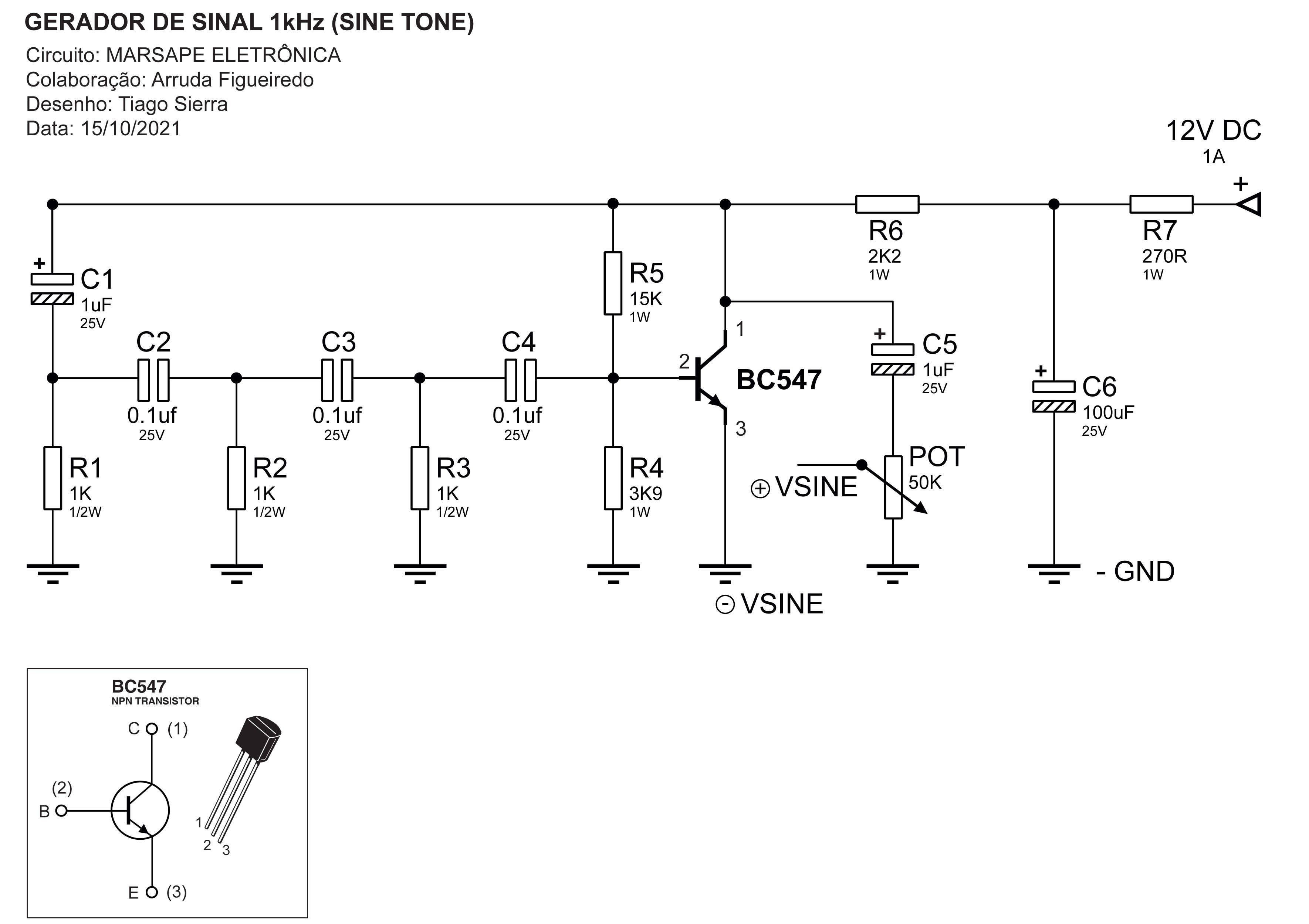

If you look at post 8135 the first wave is approximately the power supply ripple you should have. I was using an old fashioned lamp as a load which isn't 100% like a JLH. Any chance you can give a reading? We were speculating that the JLH could work as it seems yours does. On paper it shouldn't. The JLH must be better than imagined. For a simple class A design it is unusually good on power supply hum rejection. You could also measure ripple at the output when zero volume ( and other points if you like ). We then calculate PSU ripple/Output ripple. > 40 dB would be a good result. Class AB might be 80 dB zero volume. Class AB often makes people lazy about PSU design as it hides it's colouration. Julian Vereker of Naim said approximately that his amplifiers were signal controlled power supplies. That's all amplifiers really. He said some were 80% power supply and 20% amplifier ( NAP 135 ? ). A single 22 000 uF will at least be fast.
Hi Nigel, thanks for the remark. I didn't really measure my power supply. I will measure with the oscilloscope and show my results here on the forum. 🙂
