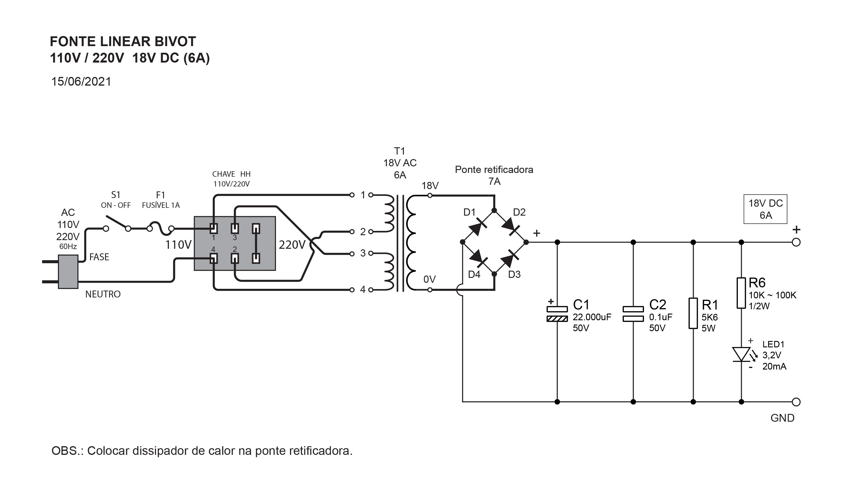

Power supply
Transformer: 110 / 220V • 18V AC
Rectifying bridge: 7A
Capacitor: 22,000uF (63V)
Capacitor: 0.1uF (104)
Resistor: 6k8 (10W)

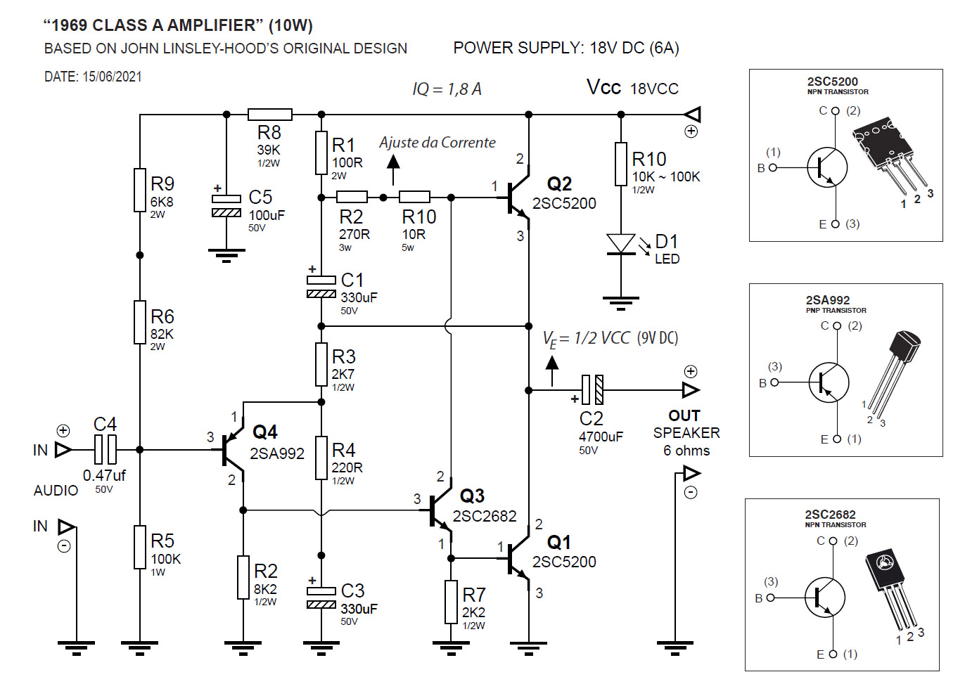

Are you using 2SA992 (Q4) and 2SC2682 (Q3) as shown in your schematic? No trimmers for mid-point and Iq adjustments?
Hello Hanair, yes I am using 2SA992 (Q4) and 2SC2682 (Q3) in my circuit, as per the diagram. I live in a coastal city here in Brazil, and in my region there is a lot of humidity. And the components rust very quickly. That's why I'm not using trimpots for current adjustment and VE adjustment according to the scheme.
After several tests, I arrived at this configuration that is in the schema. I powered my circuit with 18V DC. My speaker is 6 ohms. For me to have a PURE CLASS A, I need the speaker to pass all the current it needs. In my case: in C2 (4,700uF) it is + 9V and - 9V. With the following formula it is: 9V/6 ohms = 1.5A
I need a current of at least 1.5A to pass through the speaker so that I have a PURE CLASS A.
With that I was adjusting R2 and R10.
Current stabilized at 1.8A
Then for the VE adjustment (1/2 VDC) I adjusted R6 and R9. I managed to leave it at the right tension.
In practice it was:
VDC = 18.40V
VE = 9.20V
IQ = 1.76A
My TRAFO:
110/220V 60Hz
18V AC (6A)

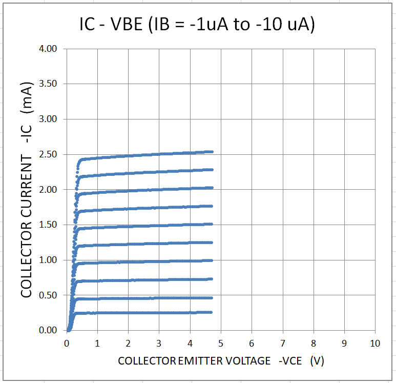

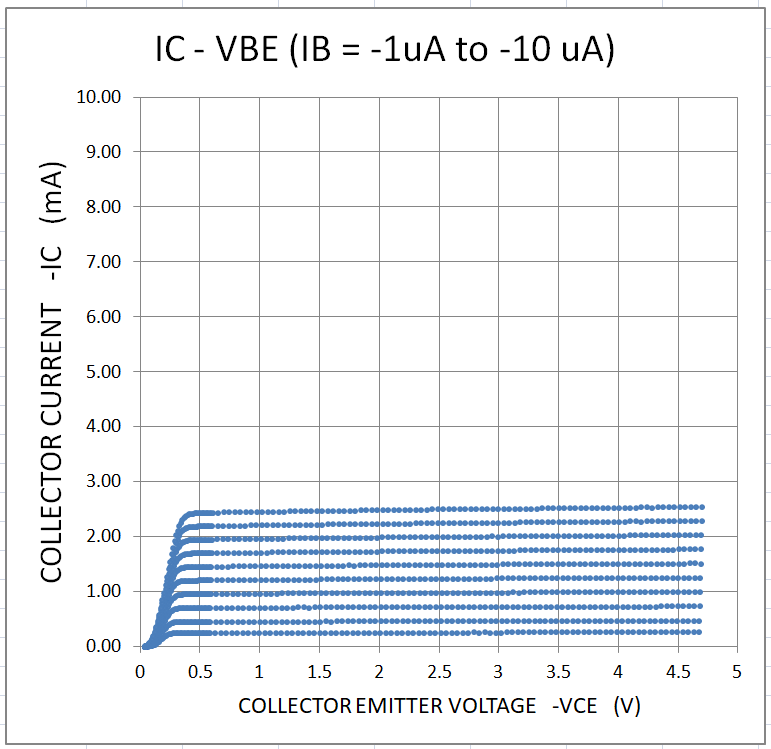

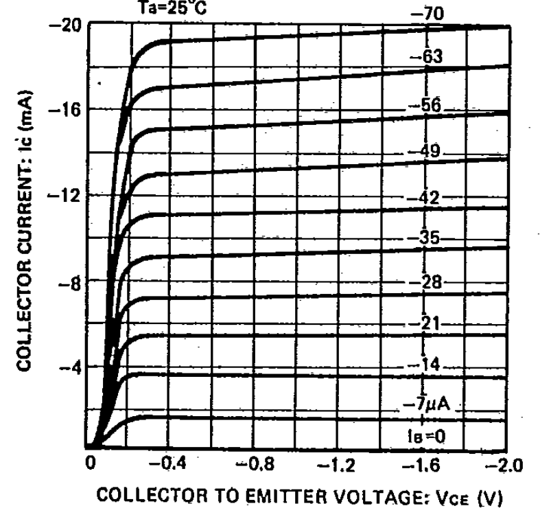

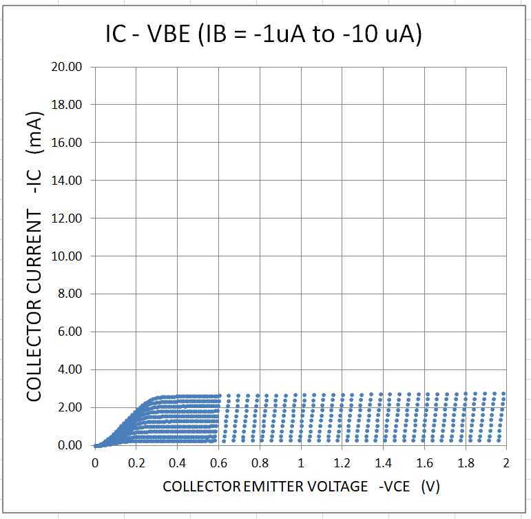

Here are early/first generic 2SA992 IV curves from my homemade curve tracer.
My next step is to add amplifiers after the DAC (along with a new power supply) to extend the voltage and current range of the measurements. I am still thinking about the best way to do that. For now it only covers a small region of current and voltage. [So I plotted the results twice for easier comparison to the NEC datasheet curves.]

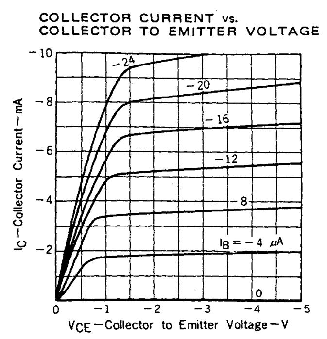

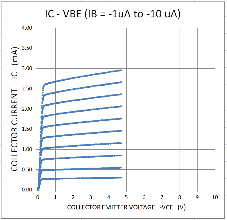

Here are early/first generic 2SB737 IV curves from my homemade curve tracer.
I am interesting in interpretations of the differences (compared to the Rohm datasheet IV curves) even though I have not yet gone to higher collector currents yet.

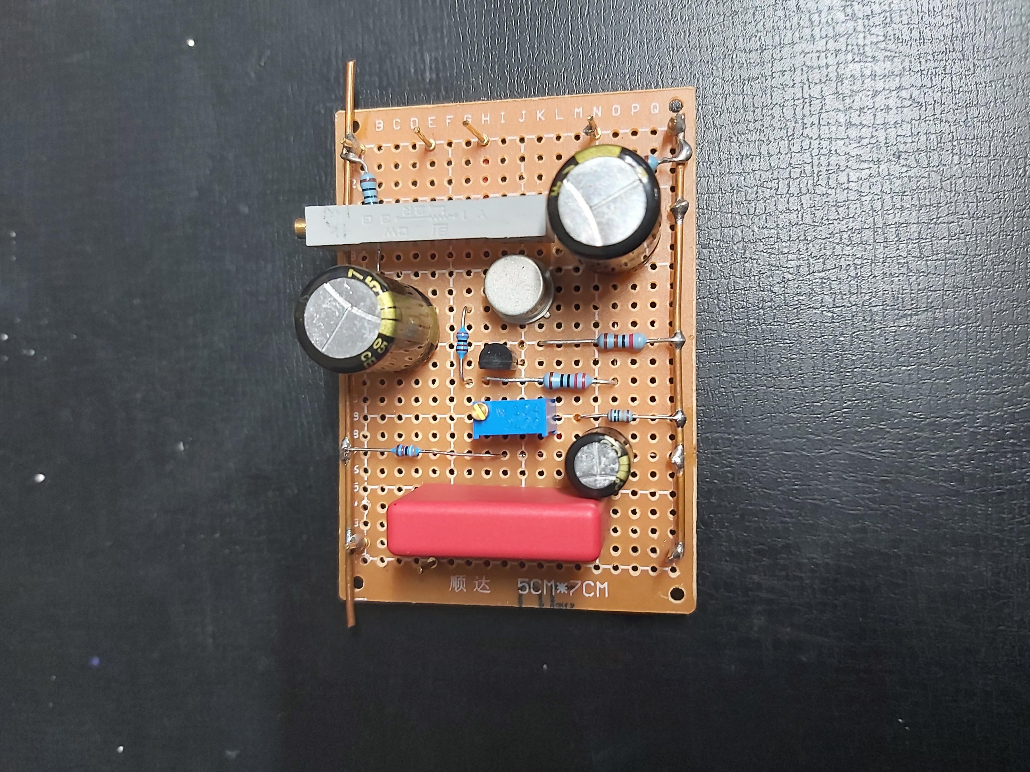

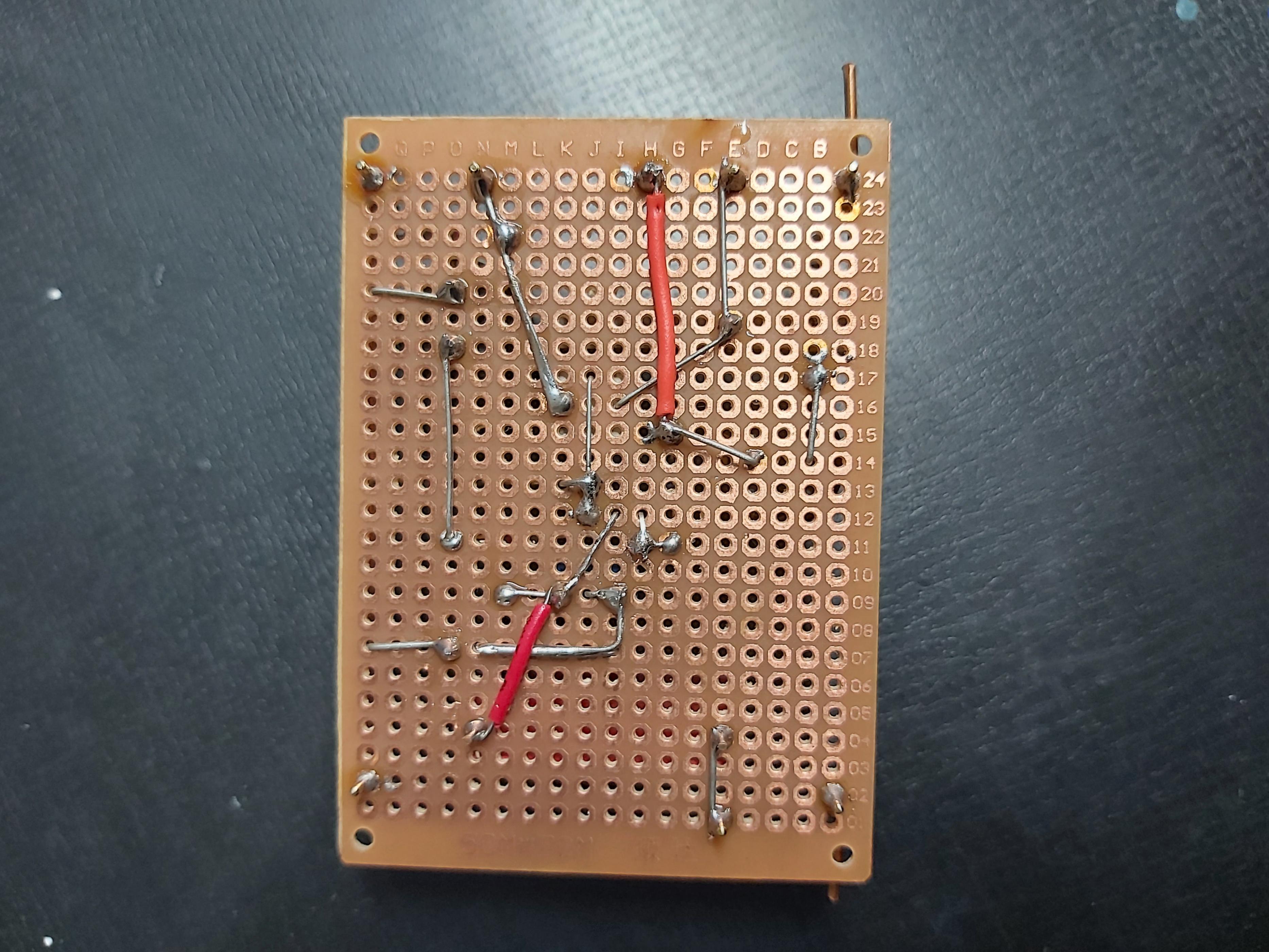

Hi. I finally got around to working on my first amp board for my JLH 69. It is the first time following a schematic and making a circuit from scratch. I tried to place the components perpendicular to each other as much as possible. I would like to test it but I only have an unregulated benchtop power supply. Would this be ok for testing purposes?
The power supply is needed for a voltage of 12v (20-27v) and a current of at least 2A (for one channel) - power 40 watts. If the power supply is unstabilized, an electrolytic capacitor of 10,000 microfarads or more will be needed (not required for SMPS). #8107
My old lab power supply goes up to 30VDC and 10amps. If I were to hook it up to an 8ohm load and power it with a voltage similar to what I can expect from my transformer (minus losses for regulation and filtering) with a 10000uf cap and have the output transistor on a heat sink then I should be able to hook up a 2v "line out" input and set bias and get an indication of the performance of the single channel?
You do not need to connect a large capacitor to the laboratory power supply. Use short wires and a 2a fuse. Recommended JLH voltage 27V / 1.3A DC at 10W / 8 ohm. The first turn-on can be done at 12v. The output transistors must be mounted on large heatsinks using thermal spacers and thermal paste. The input voltage is less than 1V, so a 10k potentiometer is needed to adjust the level.
