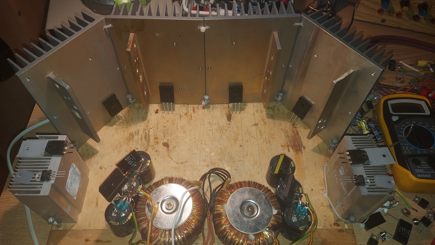

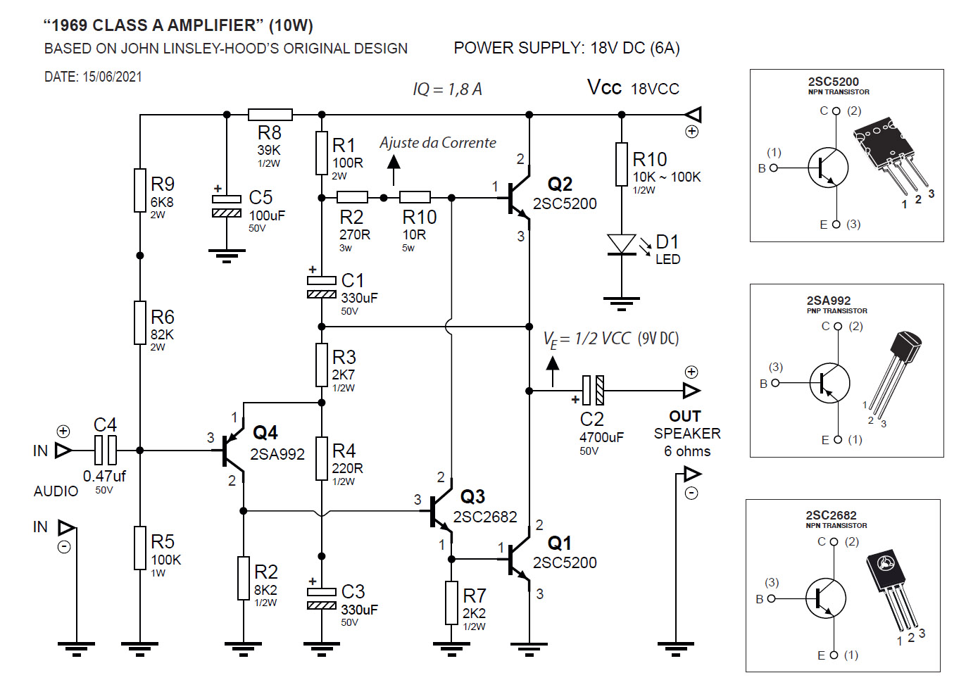

I'm doing it slowly: picture:
BIAS for PURE CLASSE A

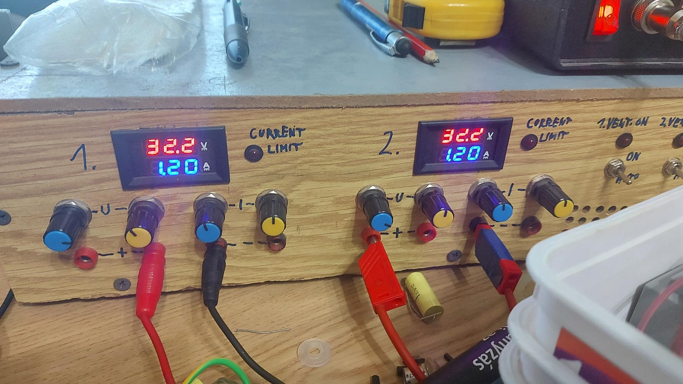

I replace the driver to 2SD882 and increase supply voltage(use lab PSU), current set to 1,3A(24Vdc):

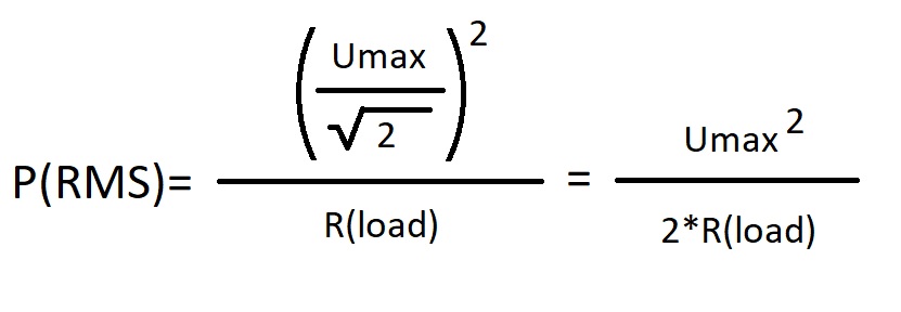

Hi bistvan1980, for you to have a PURE "CLASS A". See the following equation:
In my case my amplifier is powered by 18V DC.
The output capacitor, on the speaker will do +9V and -9V work.
My speaker is 6 ohms.
Logo 9V/6 ohms = Current = 1.5A
I need at least 1.5 amps to get a pure Class A at full volume.
That's why I left my amplifier with 1.8A BIAS
Power in RMS = (9)² / √2 / 6 ohms =
81/1.41/6 =
57.44 / 6 =
9.57W RMS (per channel)
In your case, if you leave your amplifier with 24V DC, you will have +12V and -12V in the speaker
If your speaker is 6 ohms, it would need a minimum current of: 12V/6 ohms = 2A
Bias = 2A or >
RMS power = (12)² / √2 / 6 ohms =
144 / 1.41 / 6 =
102.12 / 6 =
17.02W RMS (per channel).:)

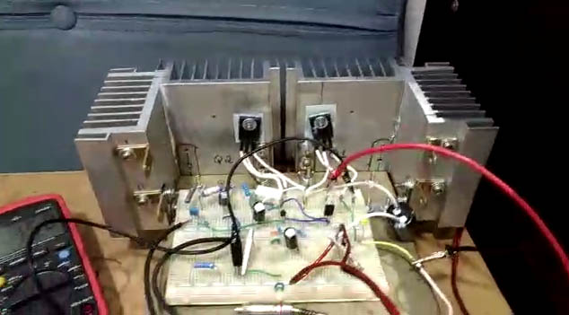

My Class A working well:
23,8Vdc, 1,22A, 8 ohms
driver 2N1711, output 2SC5200
Not tested in maximum. but: 1,22*1,22*8=11,9W(-UA7824 dissipation)

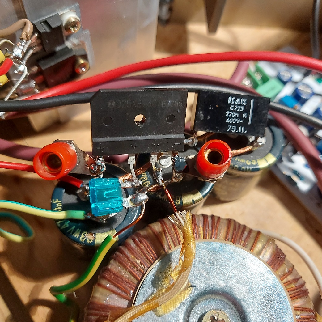

See my current circuit.
My transformer is 18V + 0v
OUTPUT = 18V AC and 18V AC (6A)
7A rectifier bridge
22,000uF (63V) Electrolytic Capacitor
0.1uF Capacitor (104)
6k8 resistor (5W)
All in parallel.
Output = 18V DC

No, I think you are assuming the output voltage stage can swing to the rails before clipping but it can't. If you refer to the original magazine article, JLH tabled the max. output limits for a range of supplies and speaker loads and these indicate around 10% less output voltage swing than the rail to rail or ground to rail supply voltages. In terms of maximum theoretical output power and it being impractical to operate the amplifier so close to clipping, the practical output power limit will be significantly less.
You would need a max. 3,5 ohm speaker impedance to obtain 10W from the JLH'69 and a stable 18V or 9V+9V power supply. To substitute a nominal six ohm speaker would not be directly comparable with that arrangement unless the input test signals and levels could be scaled up proportionally.

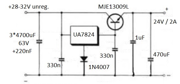

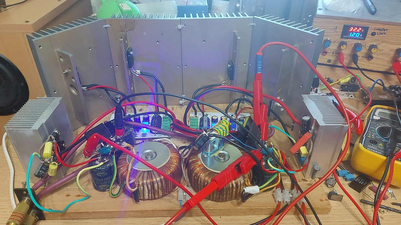

My power supply/channel:
60VA toroidal transformer, 24Vac sec. 2,5A(max), 25A bridge(without heatsink), 3x4700uF/63V+220nF, regulator 7824+MJE13009L(in/out/collector 2x330nF+out 1uF+ 470uF), Iac=1,7A
Transformers have softstart circuitry.

That is a good idea. I tried a 24Vx4A SMPS and it worked fine with no apparent audible difference. But I still thought the regular transformer sounded a little better (may be?), possibly because of the noise on the SMPS output (which was about 200mV or so at 80-400kHz IIRC). If I use a regulator with capacitance multiplier along with a fast output transistor such as TTC5200, SMPS might be a viable solution.
