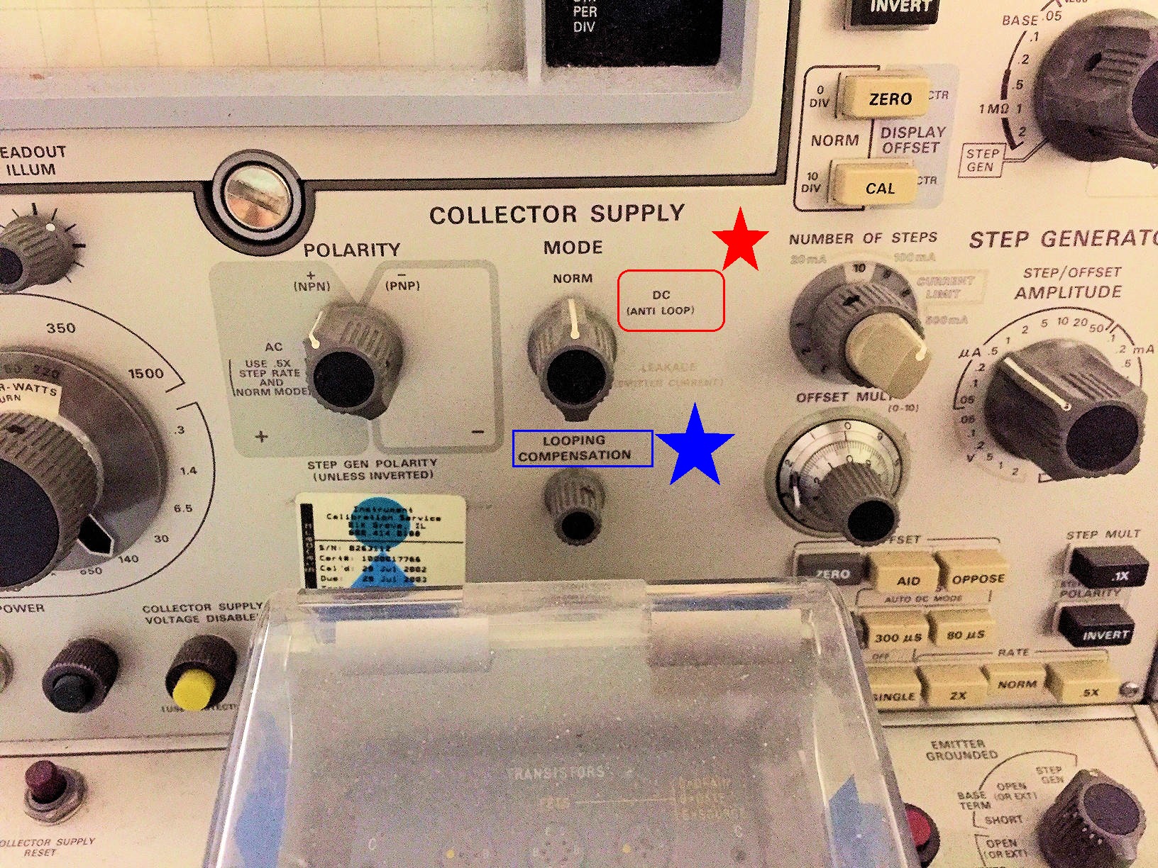

So the context of the question was why a Toshiba 2SA970 showed no looping yet a generic 2SA970 showed looping on the same curve tracer with the same settings.
So my question was whether the generic 2SA970 was different in a detrimental way to usage as a substitute for genuine Toshiba 2SA970.
I have read page 2-22 in the 576 Curve Tracer manual. At this point I am concluding (in the context of the question) that the generic 2SA970 is exhibiting either much larger capacitance or much higher thermal effects than the Toshiba.
I don't know which and unfortunately my meter is not very helpful at measuring single digit pF capacitances. Toshiba lists 2SA970 Cob as 4pF.

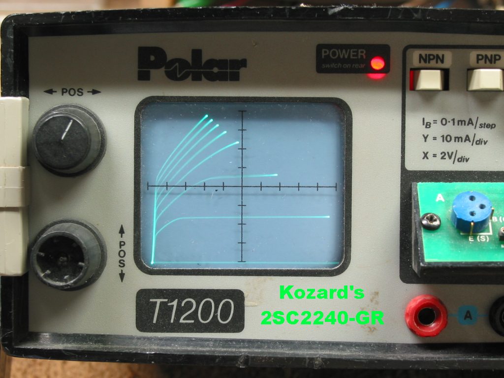

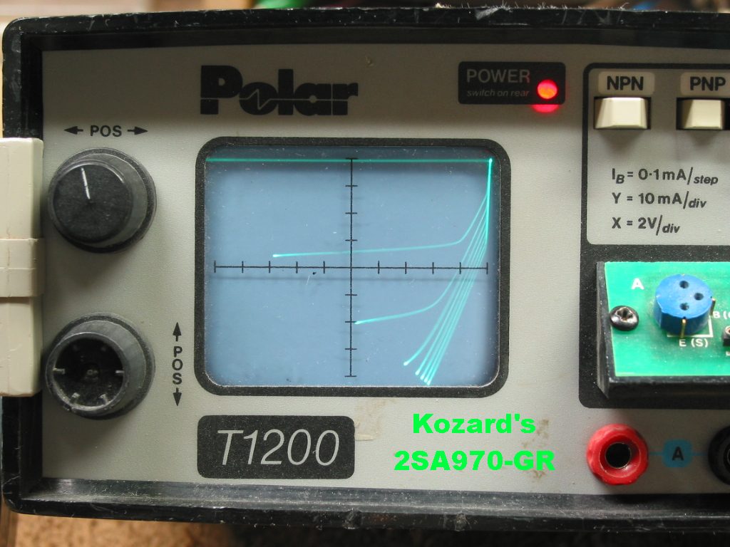

I sent him the pics but didn't post them. This is the "Generic" 2SA970 kozard sent me, along with it's complement 2SC2240. Both "GR" spec.
I also tested them at lower Ib with the Tek 7CT1N. The 970 is very linear at 20-25uA and below, at Vce of 5V and above.
It's mate 2SC2240 linearity is a bit better, good up to 30uA or so. This is probably due to it's Hfe being a bit lower, 250 vs 320.

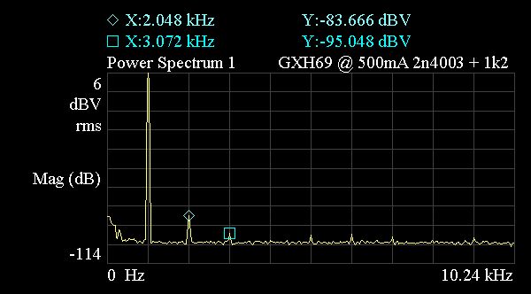

I just applied similar mods to one of my JLH69 amps as I did to the JLH headphone amp. Changed driver NPN from 2N1711 to 2SC1318 (same Hfe, better linearity); changed input PNP from 2N2907A to 2N4403 (same Hfe, better linearity); optimized the input R for 2VRMS into 25 Ohms (this one drives electrostatics). Optimum R was 1k0 to 1k2 (plus pot R).
The result was a 9dB drop in H2 to -90dB, and H3-H10 to below -100dB !
I stopped using this amp because the LM3886 amps I built sounded so much better. My bet is, this will reverse that outcome.

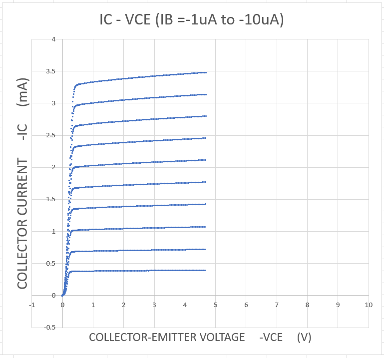

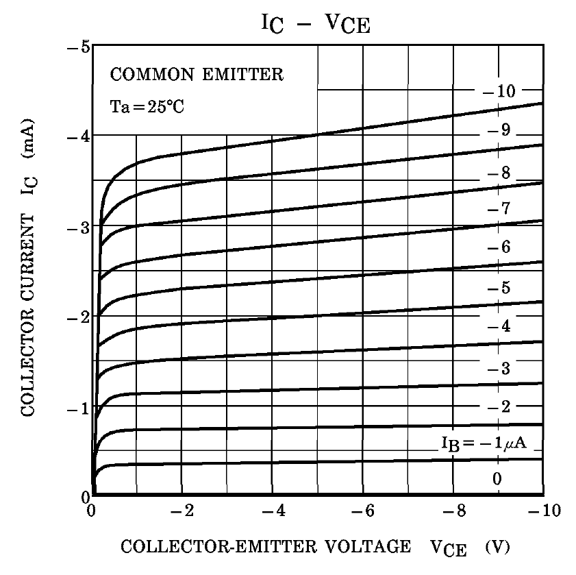

So I received the parts back and the below graphs are first the Toshiba datasheet curves and then my first attempt at a homebrew curve tracer measurement of the generic 2SA970.
