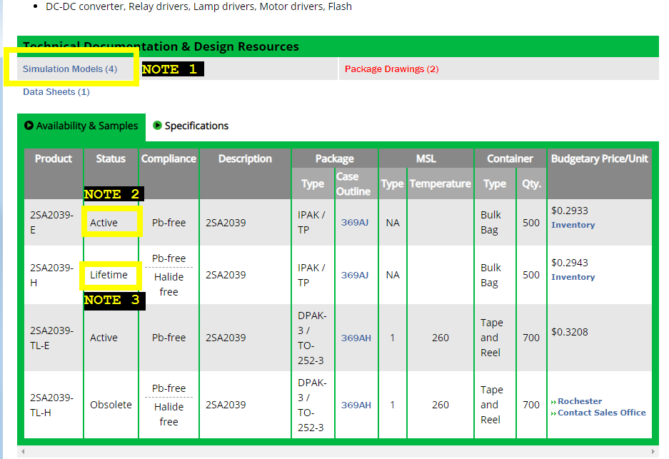

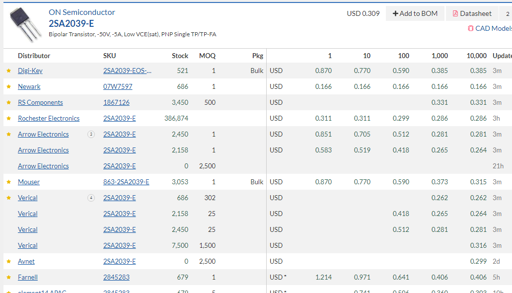

Wow, exceptional. And in EOL last-time-buy status.
I took scree-capture images this morning, at the websites of (a) ON Semiconductor, and (b) octopart dot com.
_

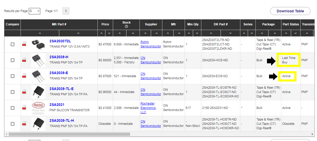

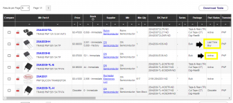

Hmmm. Digikey says "Part Status: End of Life; Last Time Buy Date: 7/5/2021. Minimums may apply."
Yes that's NOTE 3 in post #8023. Lifetime buy on (both lead free AND halide free). However (only lead free) is still in active production at ON Semi, see NOTE 2 in post #8023. Digikey agrees, see below.
Depending on how you personally feel about halide-free transistors, there might or might not be an urgency.

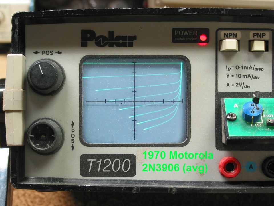

JLH specifically shows the Motorola 2N3906 as the input device in his first paper. I wondered, what were the 3906's like that he had access to?
I found six of them on an old pcb (socketed, conveniently) with the date 05/1970 etched on the solder side. Five of them were pretty much the same, Hfe of ~135, shown in the first pic. The other was 200 Hfe, shown in the 2nd pic.
At Vbe of about -8V and up, the first one has good beta linearity up to 300uA Ib, then sags.
The higher Hfe one isn't nearly as good.
Just thought I'd post this for historical context.

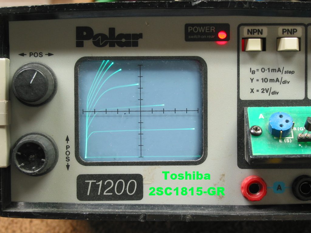

jbau put a lot of effort into measuring some of my generic devices.... Now I have a number of questions about the results.
The first question is regarding looping in the back trace. What is the physical cause of this?
The attached examples are first a generic 2SC1815 (with the loop back apparent) and then an original Toshiba 2SC1815 without the looping on the back trace.

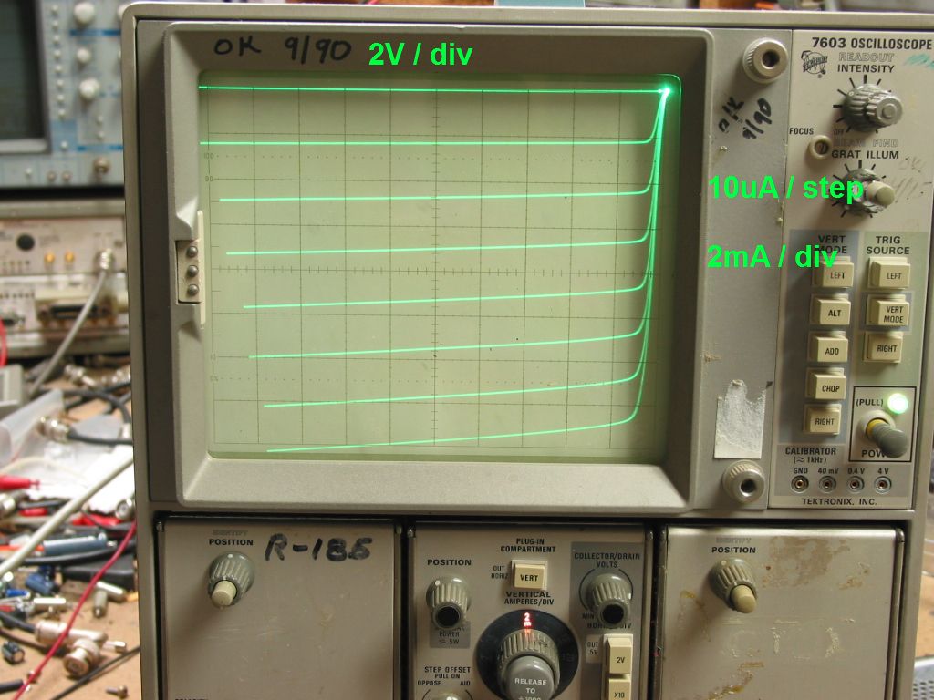

Instead, I pulled out the Tek 7CT1N curve tracer plugin that has been waiting since 2006 for me to fix. Found one open electrolytic, one shorted transistor following it, and one open pot. Replaced them and it's back in business. Having this could be enough motivation for me to put the ol' 7603 back on the bench. My aging eyes love the big display.
So I spent some time looking at the low-current linearity of numerous small-signal transistors. The little Polar tracer is fixed at 100uA/step and 10mA/division. This goes down to 1uA/step. Probably won't use that much; a more useful range is 5 to 10uA.
Most of the transistors I looked at were pretty linear in the low range. NPN's more so than PNP's. Even the super-beta ones were linear up to 10uA Ib, some 20uA. And then the beta starts tailing off, some more rapidly than others. The 2N5087 is linear only up to 10uA.
One oddball was the MPS6534. It has a very gradual beta gain all the way up to about 200uA where it started it's droop. It's complement 6531 is very linear.
Here's a pic of a Toshiba 2SA1015-GR, sought after and widely used on the input of JLH's. This one is only 220 Hfe, which is on the low end of the GR spec. But even it shows the "early beta droop" that nearly all of the high-beta devices do. Linearity is good below about 5mA Ic. Higher than than, it becomes somewhat Vce-dependent. At 16mA Ic, Beta is already 10% down at Vce=10, but only 3% down at Vce=16. A higher-beta 1015 will be even worse.
This slow, constant "Beta sag" may be what gives this device it's warm, smooth sound. It's complement 2SC1815 is very linear and shows no such droop, up to 250uA Ib.
A cool new tool always makes me wanna measure everything in sight
