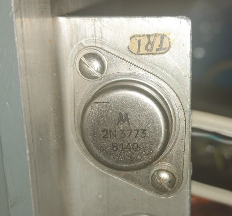

Original Motorola 2N3773 is the output. (saved from old industrial power supply)

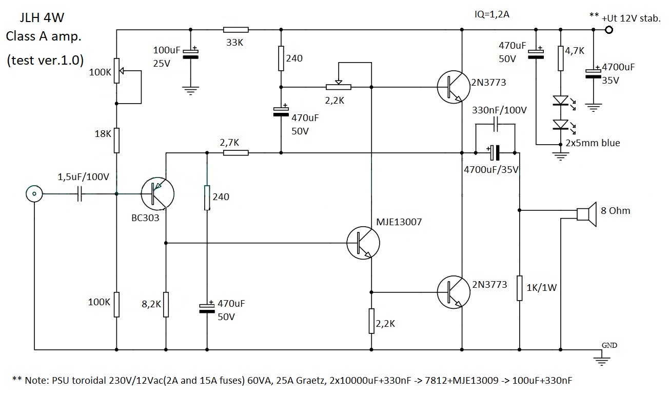

My test version schematic:

At 12V and 8 ohms, it is enough to set the current to 0.8-0.9 A. The power will be 1.5 watts.
Some used BD911.
MJE13007 can also be used at the output. For a driver, their characteristics are not quite suitable. But it will work)))

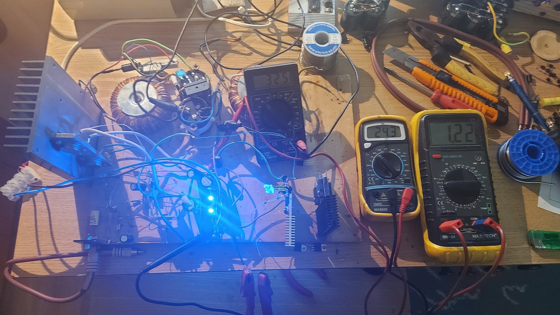

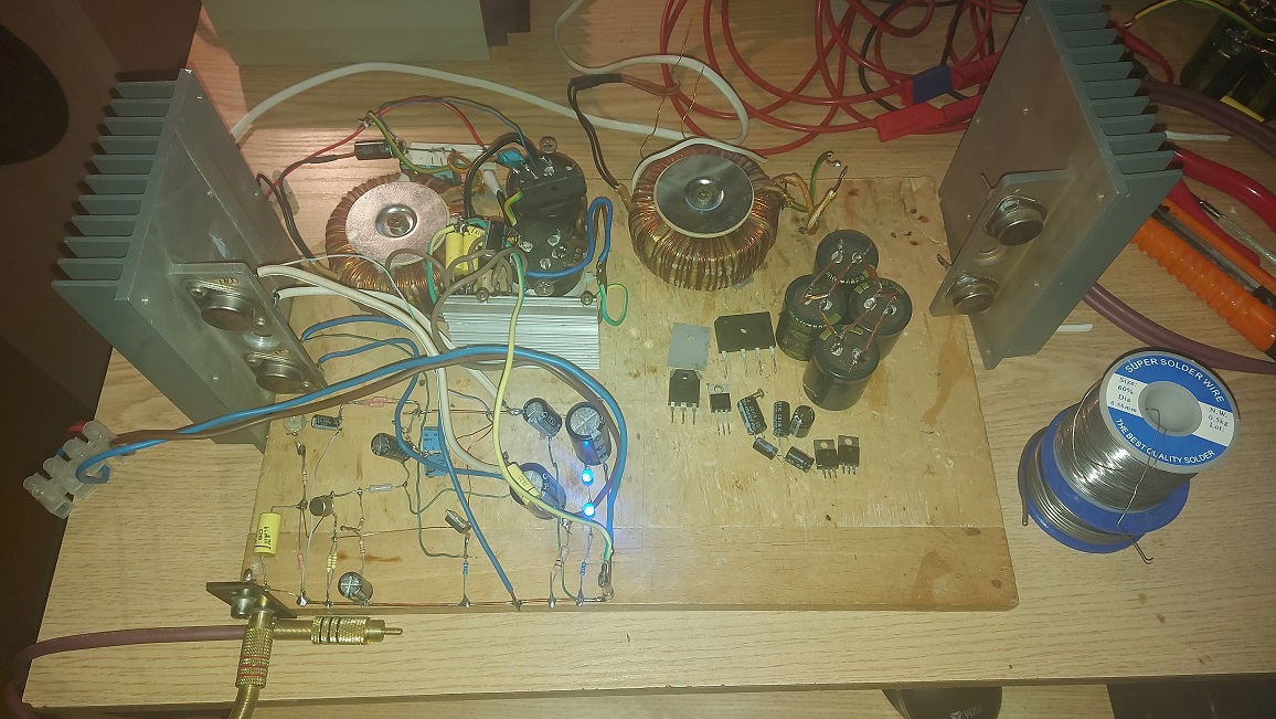

Hello! It is currently in an experimental phase.
I haven’t measured it yet, I roughly calculated 4W music peak power.
I put it together quickly based on the circuit diagram.
It sounds good and 1.5W RMS is enough for me. I'll replace the transistor in it, that's all it was at home. 🙂

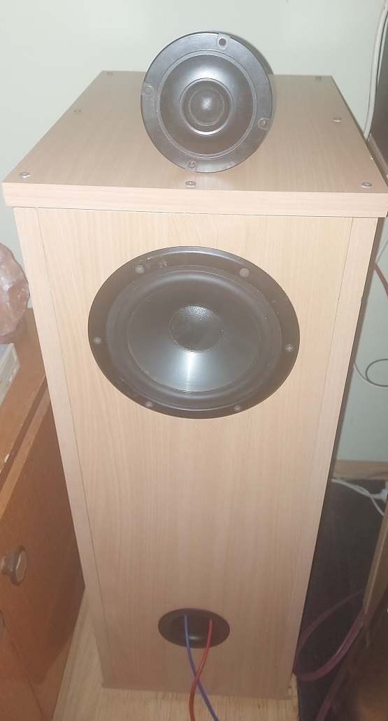

I'm sending some pictures:

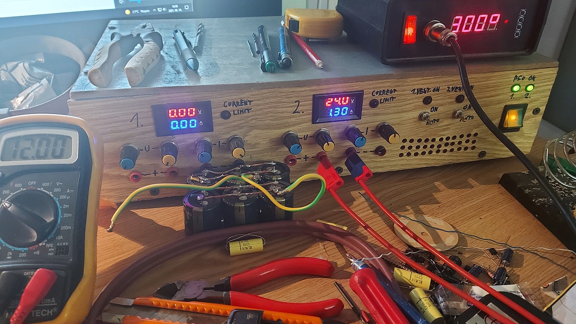

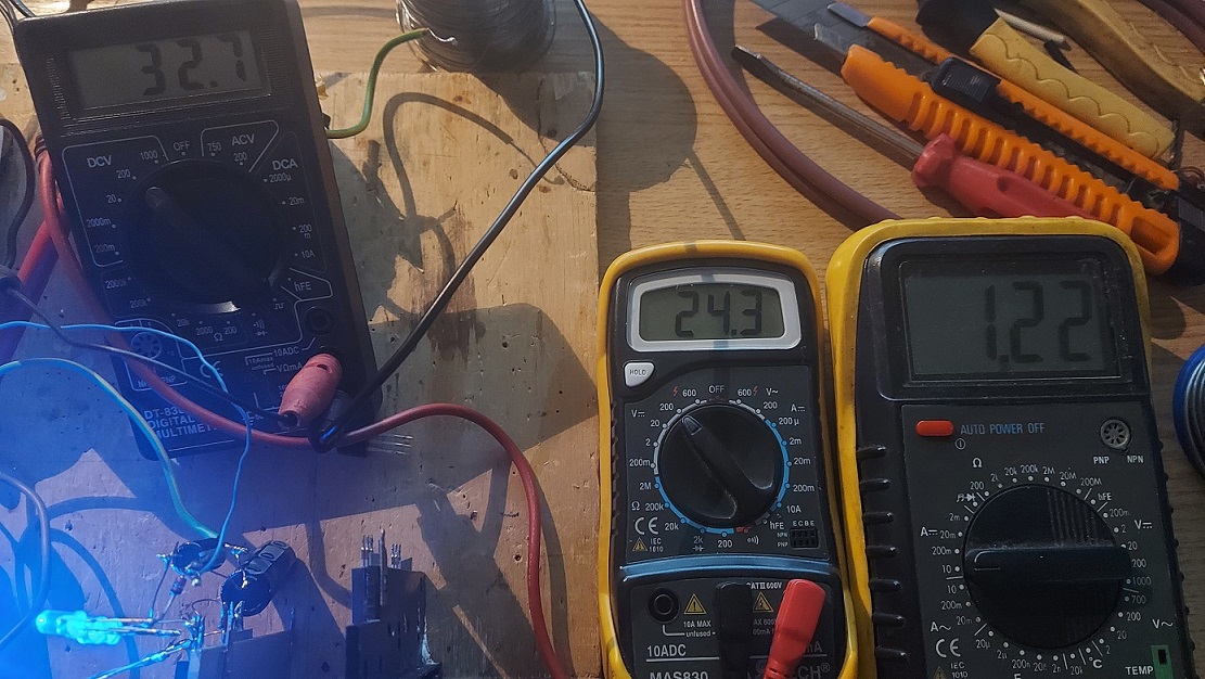

I replace the driver to 2SD882 and increase supply voltage(use lab PSU), current set to 1,3A(24Vdc):
https://www.st.com/resource/en/datasheet/2sd882.pdf
Great!
My objective: 24Vac to 24Vdc(stab.)... I'm on it.
Hi Sierratds and Hanair!
Good job!
I watched the video, now I know it's 1.2A enough. Thanks a lot! 😉

I would not recommend the 2N3773 for audio. At least, not without testing ft.
Old RCA spec ft(min)=200kHz. Maybe about the same as an OC71!
Moto's 2N3773's were made with a different process and today's 2N3773's will be epi base of some description and MAY have a better ft (around 2MHz) - but I don't have a 1981 era device to test. But the spec should disqualify as it is still 200kHz.
In the JLH the frequency response is not best aided with NFB because there is no additional drive current (e.g. from a driver transistor) to push the base current up when the gain falls. Yes it will improve at low output levels but full power at high (audio) frequencies is likely to have higher distortion.

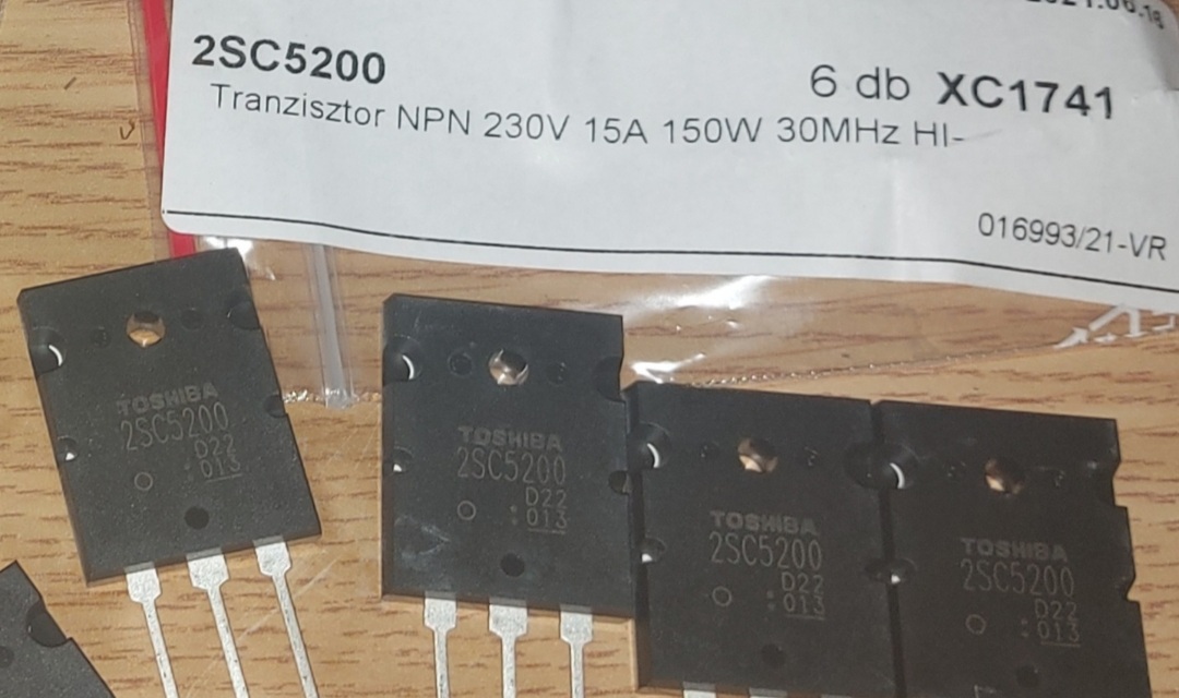

Probably true. I'll buy 2SC5200s. (with 2SC2625 is better than 2N3773? - 2SC2625 is already at home)

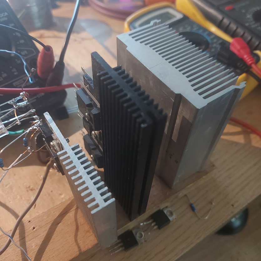

I'm testing the 24V stabilizer now. PC-PSU heatsink is small for this (old S478 proc. cooler is better)
MJE13007 + MJE13009 darlington, BZX18V + 3xblue LED. 😉
(I know the 7824 + PNP construction is better ...)
Some pictures:

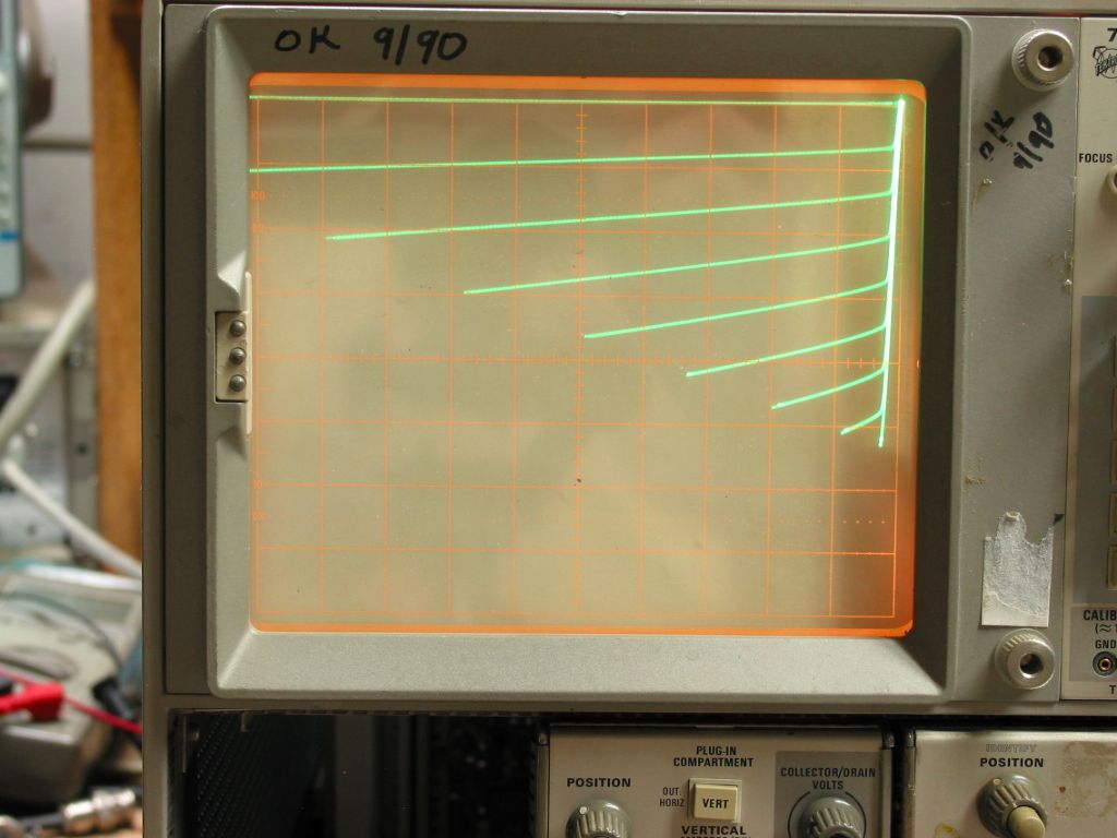

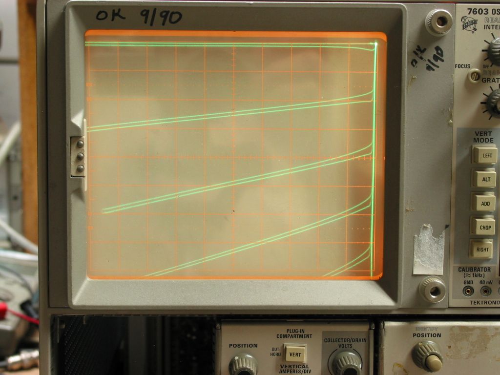

I have a feeling what you REALLY want, is to gaze at the first attachment to post #2. Like most of the other plots, that one measures out better than the manufacturer's datasheet promises. Customer expectation management (?)
The 2SC2039's I received don't look quite as rosy as your plot. These are 0-20V sweeps, 1mA/div and 20mA/div. Hfe is over 400. Lots of looping at low Ib. Linear beta at a given Vce, but beta expands with Vce. If AC appears across CE, this will be a beta modulator.

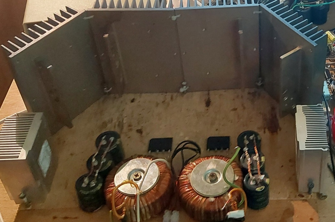

The parts have arrived. 2SC5200 and everything I need for the stereo(dual mono version).
Project restart:
Driver 2SD882, input 2N2907 or BC560, 1 heatsink/1 5200, psu 7824 based.
