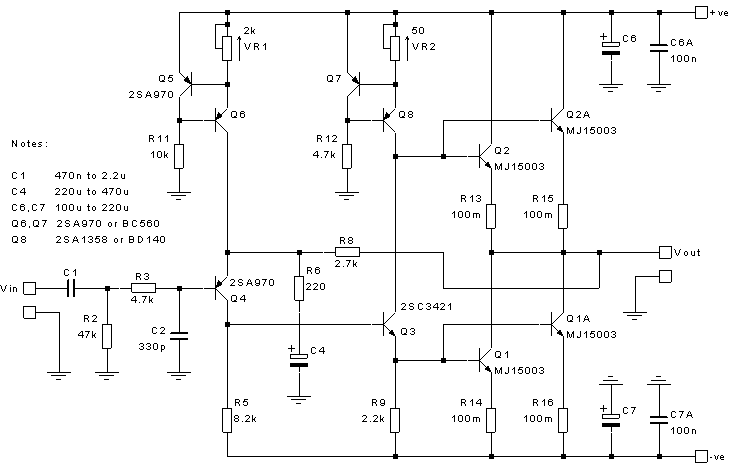

I'll be using a separate smps for each channel.
This is the schematic I'm using as a starting point: https://www.sound-au.com/tcaas/jlhupdate.htm (but with a cap in series with the feedback resistor R6)
The only DC demands on the virtual 0V are from the input resistor R2 (insignificant) and the current sources R11 and R12. I think a balancing resistor from 0V to -V will be necessary, to compensate for these. Or should I swamp them by putting 330 ohms(ish) across each series PSU cap?

Only the caps, no resistors. Input and feedback are connected to the center-point (floating ground) of the caps too. There is a small leak current to one side, so if no speaker is connected, there will be some DC-offset. This can be compensated with a large value resistor over one 'half' of the PS caps, but I have not bothered with that. Search 'sublimed JLH' here on the forum. My SMPS are HP laptop bricks, and they retry a couple of times before they have charged the PS caps enough, and then they work as they should.Is this a SMPS feeding a pair of series-connected big caps and balancing resistors, with the amplifier grounds and speaker returned to the junction of the caps?
I think if I just use a pair of series caps, then the two CC sources will pull the centre tap up via R11 and R12. So I'll either balance them with a resistor between centre tap and -v rail, or double the value of R11 and 12 and take them to -ve rather than gnd.
However, from what you say (quoted above) all works fine without modifying the circuit or adding the balancing resistor?

There will be some current going from positive rail to 'ground' via R11 & R12, so you cold probably have a high value resistor from 'ground' to negative rail to compensate for that. This is to prevent the small DC current going through the speaker. Easy to put in after it's built.
Keep in mind that the SMPS secondaries can't be connected to safety earth, they have to be floating, or you will have trouble..

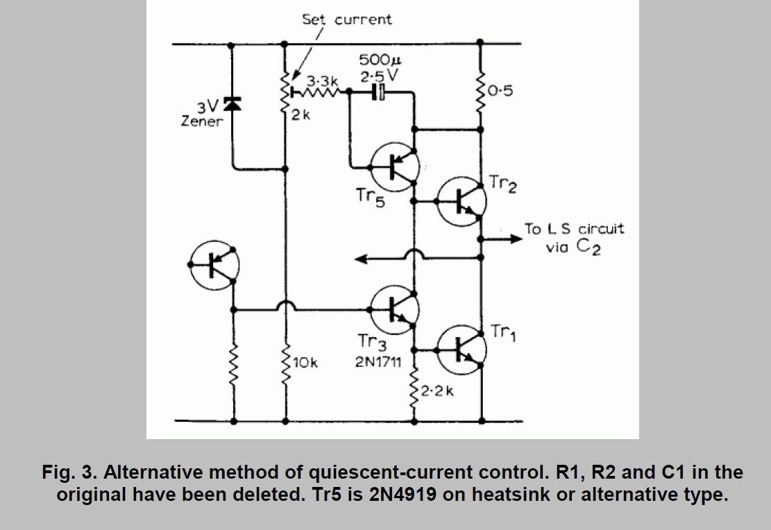

The benefit of the input CCS is that by keeping q5 and q4 close together, DC offset won't drift with temperature.

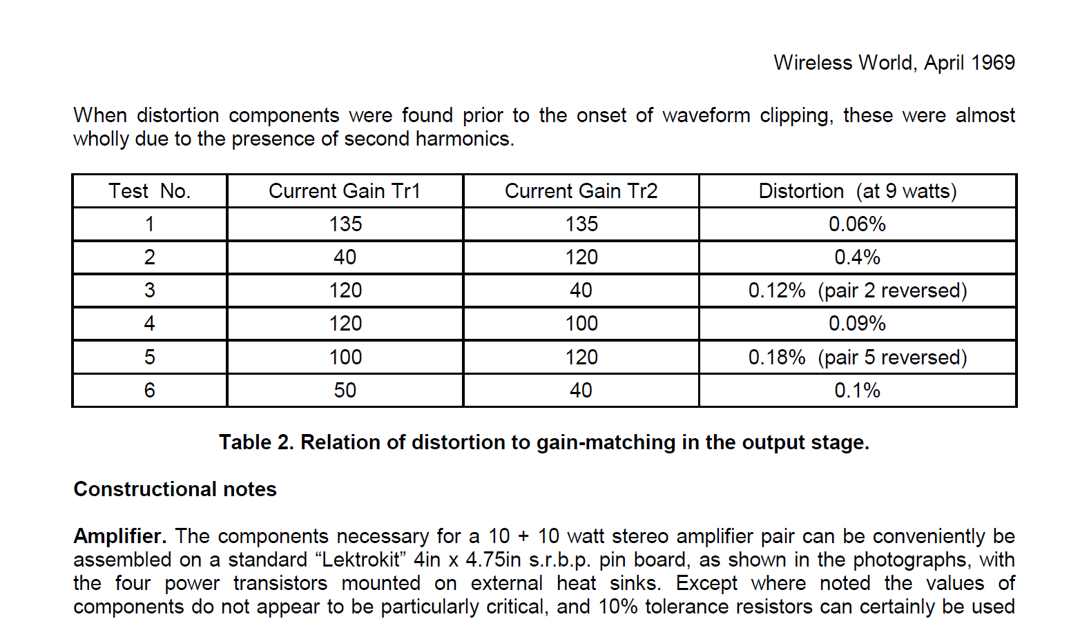

The beauty of JLH 1969 design is no match requirement of the output transistors. Even two different models are used, as long as they have similar spec. The performance shows no inferior.

With low Hfe of the output transistors, more current (power) is required.Any dissipation problem?
