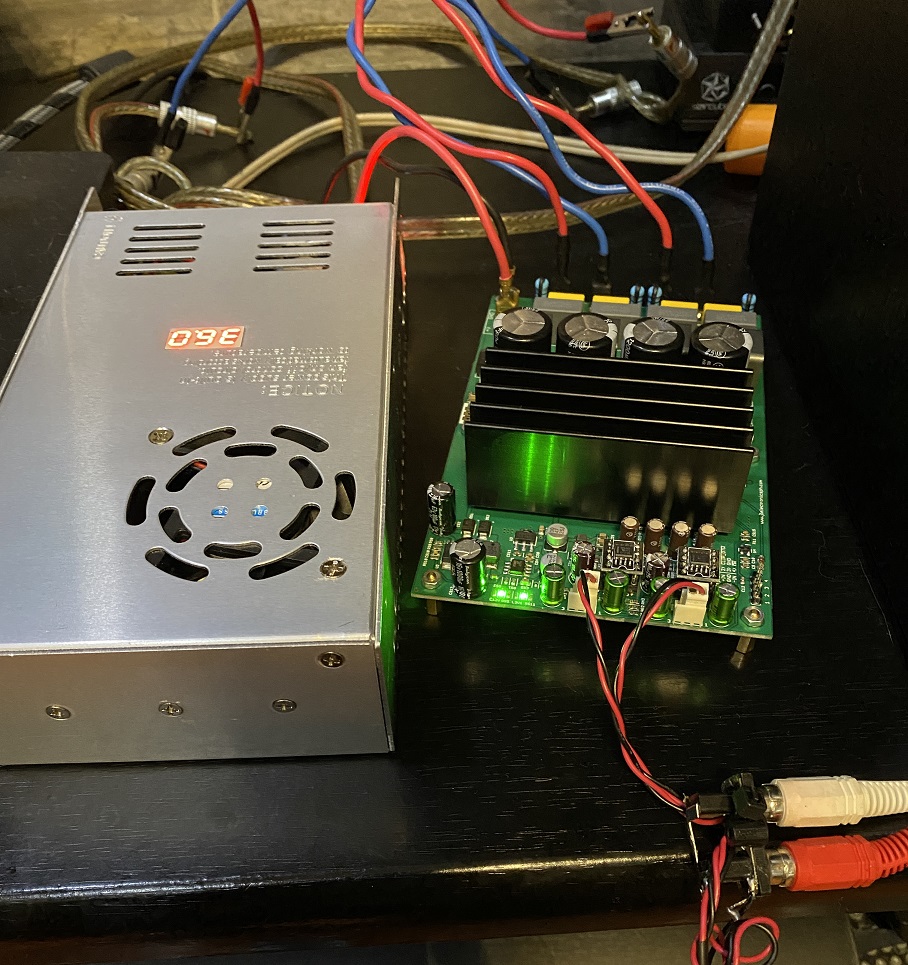

DAC and Amp installed in the living room.
Sound very. Smoothier than than old one 😀.
But problem with the level. Not enough loud, even with DAC at full.
In fact, i thought that a had a big margin because ARmin of Audiosciencereview wrote that the output level is 5.4Vrms. But it is NOT. It is half. I mesured 7.16V pp with my oscilloscope, means it is 2.53Vrms.
Sensivity of TPA is 2.7V rms, isn't it ?
I am thinking to boost the gain of the OPA1637 but i am worried of max level of TPA.
TVS or double zener on the output signal seems not be a good idea. What do you think ? Futhermore they ara often capacitive.
Second option, to limit the power voltage of OPA1637.
For positive, i can put a zener in parallel with CA4 but RA7 will burn (12-3.5)²/22
For negative, it is easy with my TPS7A30.
Third option, to supply the OPA1637 with TPS7A30 in GND/-7v. It should be the best option but will it add DC voltage mid supply on inputs ?
Any idea much appreciated ...

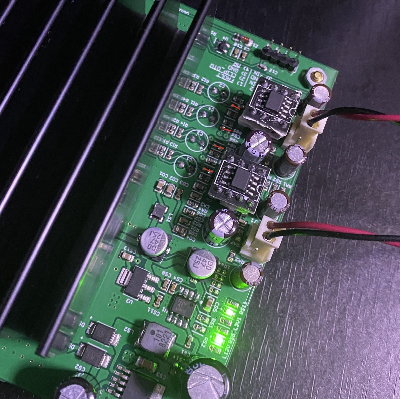

Hi, can you measure the input/output voltage ratio of the module? 2.53Vrms measured from hot to cold signal?
Also you need to remove RA7/RA8 since you are using it to get the power for your daughter board.
What I did in my latest iteration is that I used LM317 to regulate positive rail down to 6.6VDC, then the output of switching negative generator is -6.6VDC.
Finally, TPS7A30/49 to get +/-6VDC rails.

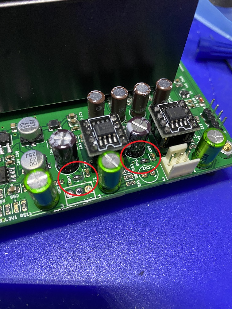

Speaking of RA7/RA8, I shorted it out and the sound impact is huge.

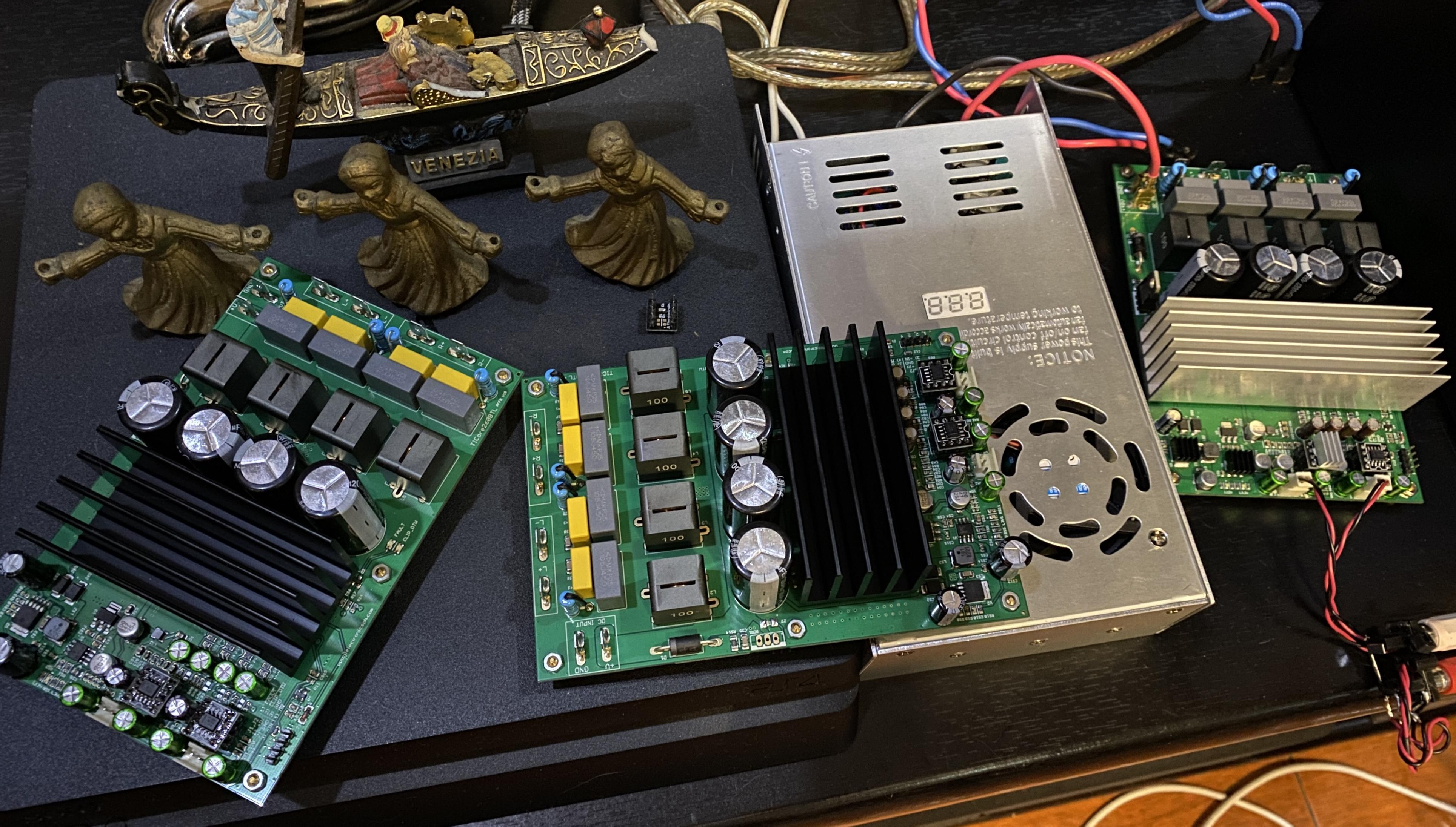

I have 3 modules here with different config (one is the orig non-pffb V1.1) to switch back and forth quickly so that I can compare the sound and select for the best.

Aside from input cap selection, I think these 2 changes are enough to get noticeable improvement in sound quality (for TICore260BTL V1, V1A, V1B).
1. Remove opamp feedback caps. (1st pic)
2. Short out opamp supply resistor. (2nd pic)

You can use L7806 (to-92 package) It can be easily retrofitted on RA7. Use heatsink plaster to secure it in place after soldering.
As for opamp with different + and - voltage rails, there will be no side effect, as long as the output of the opamp is lower than the smaller rail voltage. OPA1637 will tolerate it without any problem. 🙂

Done.
Gain of about 1.68 with 1k In and 2k feedback (because of 374 ohm Zout of the DAC).
It is much better. With some music, it begin to clip (sound distortion and red led flashing) when volume close to max.
I confirm that the sound is much better without the small caps in parallel with the feedback resistor (around my opa1637).

For 48VDC rails, onset of clipping is around (48V-8V) * 0.707 = 28.3Vrms, or 100W at 8 ohms. Increasing 48V to 50V rails, you'll just gain around 10W. Both 100W and 110W will have the same 'perceived' loudness.
Also check if the power supply output parts like capacitors are rated at 63V, if not, it's better not to increase the supply voltage.
