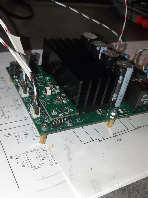

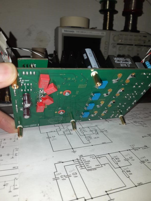

New PCB arrived and wired !
It rectifies wrong pads (SOIC8 instead of VSSOP).
It tuned a bit some feedback caps, replace Muse caps for MKT (1+2.2=3.3uf for each input), adjusted common mode of the OPA1637 to null DC offset across them, added some 0.1uF MKT 7.5mm spacing for each 2000uF caps.
Finally, the sound is amazing compare to "original" JLE board with my small Eltax in the garage.
I will build the overall amp soon and test in my living room with real speakers (SB Acoustics DIY).
Wow congrats! A good differential buffer is the key to a good sounding TPA3255 🙂 I think you are the first to use OPA1637 for TPA3255 if I'm not mistaken.
Replacing PFFB parts with C0G and low ppm matched resistors I think will have a measurable improvement on THD.
3.3uF is just right for 20K ohms input impedance of TPA3255, there is really no space for a Wima MKT on my 150x100mm board.

Thank you Lester 😉.
3.3uf seems to be the minimum, but suitable. Indeed no space to put more (1uF on top and 2.2uF on bottom).
For R, i choosen 0.01% (2K) 😀.
Take off a doubt, PFFB caps are already C0G ?

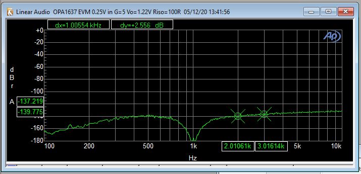

Nice update and impressive ! Congratulations ! 🙂
OPA1637 is a fully differential op amps right ? I saw someone shared some measurements via a balanced twin-tee :
843347d1589283962-diff-amp-opa1637-opa1637-via-bal-twin-tee-png
