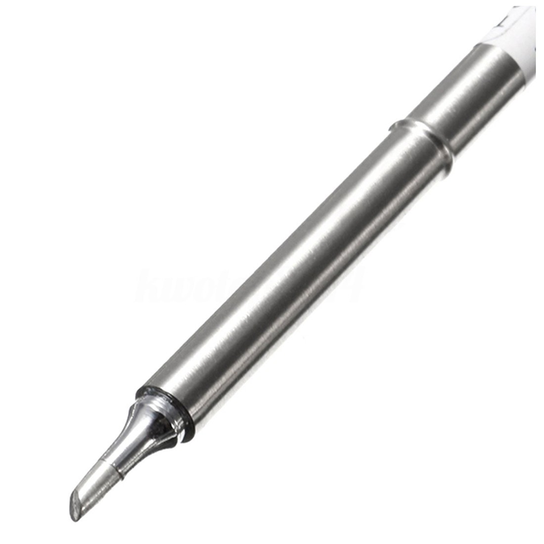

Right temperature + good tip + flux work well for soldering tiny SSOP sized ICs.
I only use wick for removing solder on the iron tip (or when cleaning the PCB trace when a component was recently removed). The iron tip itself will adsorb excess solder from the IC legs.
I use T12-BC2 tip for soldering small ICs.
Then wet tissue paper for removing charred particles from the tip.
VSSOP is a real nightmare to solder. I will give the board to a professionnal guy at work on monday for that..

To solder, i missed to say that i did a mistake on routing. I designed SOIC8 pads instead of VSSOP 😱.
