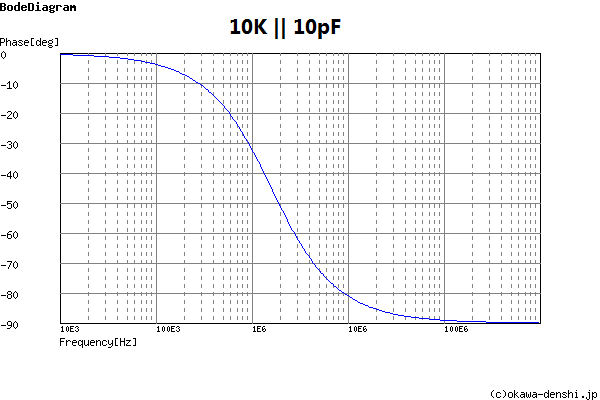

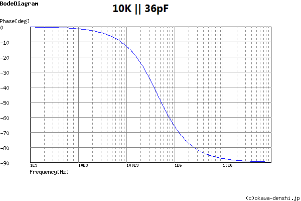

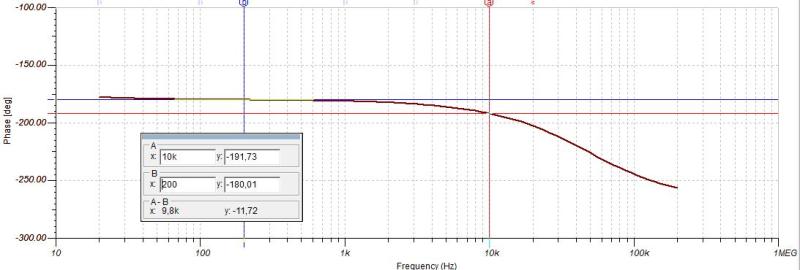

My opinion is that it should be explained by too low feedback pole with 10k//330pF.
Some TI appnote shows that (feedback pole better above 200kHz, then 68pF for 10k (1/2pi*R*C))
Below, phase with 10K/330pF shows 11 degrés dephased at 10kHz.
https://goopics.net/i/5OGNv
Yes, that explains the slightly out of phase (or laid back) voice that I am hearing with SLAA788A's 10K||330pF opamp feedback config.
10K||36pF also looks good, feedback pole is just under the TPA3255's operating frequency at 442kHz, with around 3 degrees phase shift at 20kHz.
With 10K||10pF, cut-off frequency is at 1.59MHz with less than 1 deg phase shift at 20kHz (I will be using this config in my upcoming module)
@DrMordor looks like you've used a lower feedback corner frequency, since frequency response that you've posted in Class-D photo gallery starts to roll-off at 2kHz (possibly higher opamp feedback resistor or capacitor on your module)
