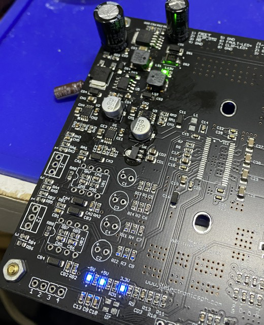

For V1A and V1B, shorting out R8 and R10 further improves the sound. (R8 and R10 is series resistor similar to datasheet, on EVM it is 0R)
Even supplying GVDD has an impact in overall sound, that's why in my latest iteration, I've placed 10uF tantalum caps close to GVDD_AB CD supplies.

Yeah, good teasing.Latest update 🙂
Good choice for the blue leds, it improves the sound also

Yeah, good teasing.
Good choice for the blue leds, it improves the sound also![]()
Haha, even their brightness are fine tuned, all of the LEDs (and the green LED at the top) now have the same brightness, lol.

Latest update 🙂
Where are the op-amps Lester? Mounted underneath? I’m presuming 1656s? Are you the guy who wiped out the supply in the US? 😉
Pete
What 😱😱😱 ?
Lester did not implement real diff driver?
My bad..you are correct....😕
I thought he was just trying to get rid of input electrolytics on this next version

Haha someone hyped up the OPA1656, that's why the demand surged.Where are the op-amps Lester? Mounted underneath? I’m presuming 1656s? Are you the guy who wiped out the supply in the US? 😉
Pete
Should I put SOIC-8 under the DIP-8 socket (like 3eaudio)? I think it will have a better connection if it's soldered directly. (After opamp rolling has been made)
Yes only dual opamps for now.What 😱😱😱 ?
Yes the goal is to have a split supply to remove the input electrolytics. Most available space was eaten by the regulators.
