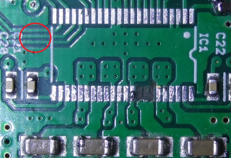

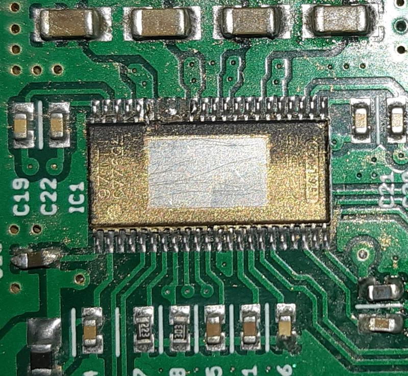

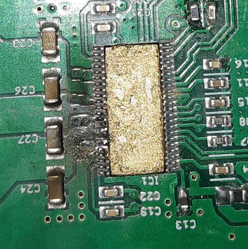

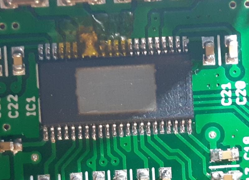

first pb this morning when adding 4.7uF in parallel with 100nF for GVDDs. When supplying, issue because interference between the caps and the dissipator.
I desoldered.
I cleaned the TPA chip. I changed the cooling paste on top of it (not the same as usual).
I supplied and ... ploufff. May be a shortcut with the new cooling paste ...
PCB is a bit destroy on the three PVDD_AB pins.
I should try the replaced it, isn't it ?

What's the cooling paste that you've used? Looks like real gold and conductive.
Chipquik with chisel type iron tip is good to remove the IC. Safer than using hot air.
After removing the IC, inspect if there are other bad traces.
If the other traces are still good, then you can still use the PCB by scratching the PVDD trace and by putting wire jumper to the IC. Then apply some heatsink plaster/glue on top to make the wiring stable.

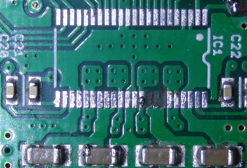

Oh, boy.
I just had a thought - what if you extended the traces just a little bit past the pad on the inside? Right now there's not much stopping the delamination, but if you had trace on both sides of the pad, the pad would be pretty well anchored down...?
Or is it just a coincidence that only the dead-end pads lifted off?

Still looks good I think, I've seen worse pcb pads being repaired in youtube.

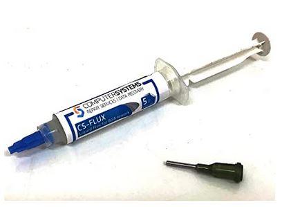

To be serious, my method is to put a lot a solder everywhere. After that, to absord it with that :
Putting a bit of solder flux help defore absborbing :
Not so difficult to do that .

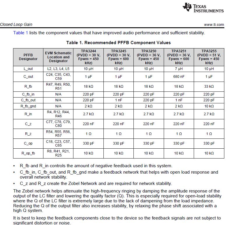

With Kenny G's "Songbird" I was able to identify the constrained sound of PFFB. (In my speaker)
The constrained sound is there because of the removal or attenuation of the 'low-end' midrange. Higher midrange is more boosted. For example, in Songbird, the saxophone's low end sound is attenuated which is not pleasant to the ears.

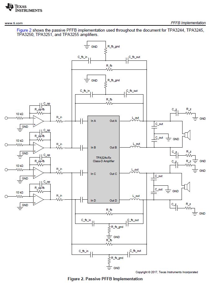

For TICore260BTL users with 36VDC rails, you can replace RG1 to RG4 with 2K ohm 0603 low ppm resistor (matched resistor with up to 1 ohm difference is better).
Since it will result to lower negative feedback, the THD will also go higher, but the midrange sound will be as good as non-PFFB sound.
For 48V DC rails it is also working in room casual listening, but I will test first for stability in high power output.

I don't have your schematic, but in the feedback T-filter, are your RG1-RG4 resistors in the same location as the TI EVM R_fb-gnd resistors to ground?
Yes, correct. But with further listening, I still detect small constrained sound + the highs are inferior to slaa788a PFFB.
I already found another solution, (I can't detect the constrained sound anymore + Bass is better) it will be available to TICore260BTL V1 to V1B users soon. (depending on the test result)
