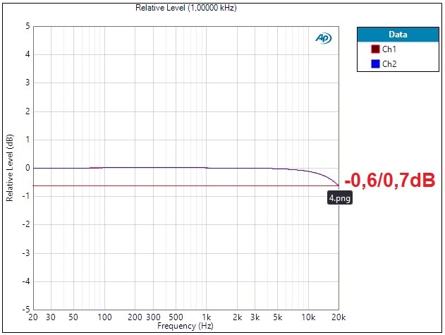

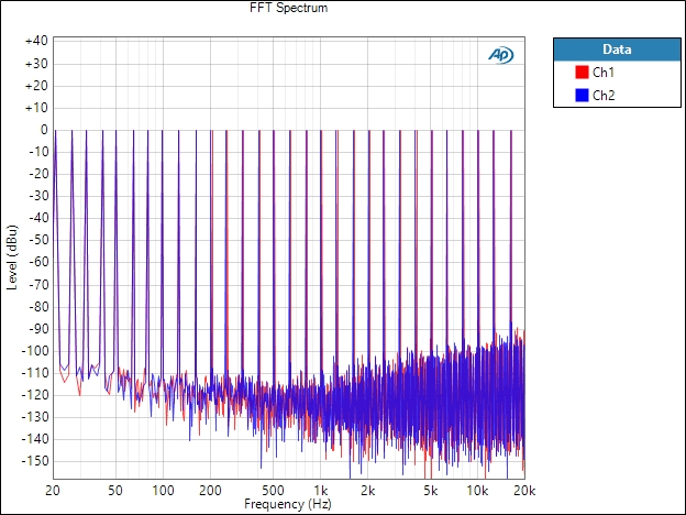

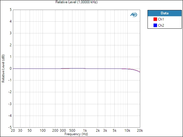

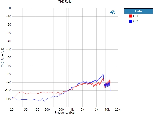

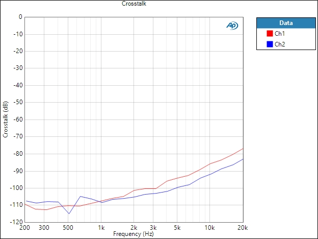

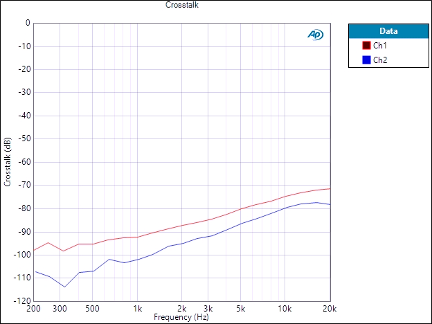

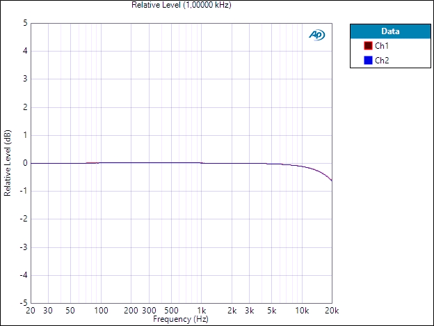

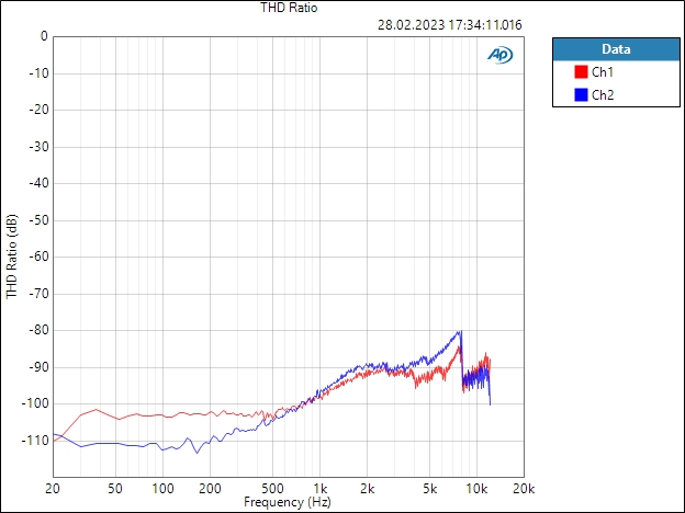

Any ways, here are some measurements on balanced (but admittedly a little wonky cabled) inputs. Measurements taken at 424mVrms as that is the point of lowest THD+N @ 1kHz. MeanWell LRS-350-48.
  • Gain: 21.6dB
  • SNR: 94.5dB
  • SMPTE: -81dB
  • Multitone TD+N: -75dB
  • Maximum Output IEC 60268-3, 4Ohm: 90W @0.1, 115W @1.0
  • Maximum Output CEA-2006, 4Ohm: 92W @0.1, 117W @1.0
  • Maximum Output IEC 60268-3, 8Ohm: 48W @0.1, 59W @1.0
  • Maximumt Output CEA-2006, 8Ohm: 48W @0.1, 60W @1.0
:cop: Moderation edit. Quza has indicated an error in the attached images and has posted corrections below in a later post..

Can't tell, I didn't find any information on how to do that. I only connected the solder bridges for balanced inputs and immediately hooked it up to the measurement rig. There were some jumpers in front of the heat sink, though.
Hello Quza 🙂
It seems to me that there must be a problem with your measurements or at least concerning your assembly because we are very far from those communicated in Audio Scien Review with Lester's device which, as a reminder, was not even optimized 😗
I'm waiting for Lester and yourself to react to this because there must necessarily be something to work on 🤔
Sincerely.
Sylph-D200 MKII uses the standard PFFB values for TPA3255 from SLAA788A, as opposed to the one on ASR, which uses the PFFB network for TPA3251. So it should get less SINAD because of less negative feedback.
My SINAD measurement for Sylph-D200 MKII is around 92dB @5W 4ohms. Sylph-D400M is better at around 94dB.
Onset of clipping on Sylph-D200 PFFB enabled is around 144W if a 48V power supply is used. PBTL version Sylph-D400 gets better output at around 200W on the onset of clipping.
Not sure why the gain measured was 21.6dB. Is this with balanced or SE input? For SE input, the gain should be 16.67x or around 24.4dB, or 18.4dB for balanced input.

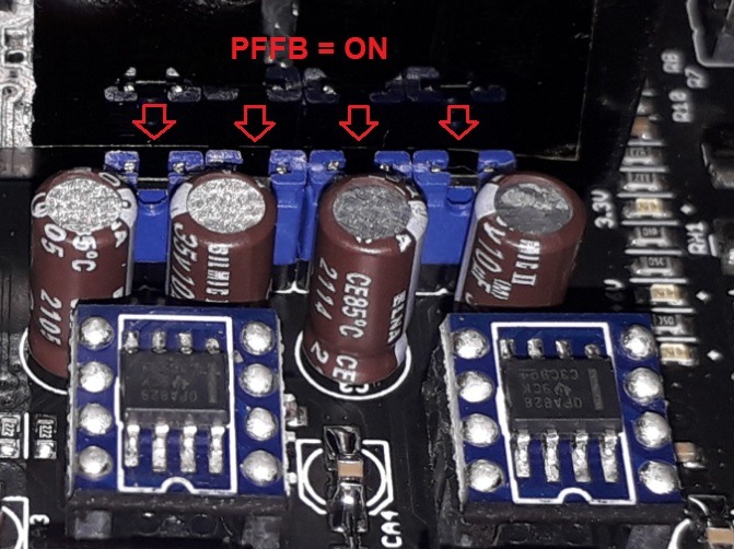

Jumpers attached between the heatsink and input coupling caps is for PFFB enabled.

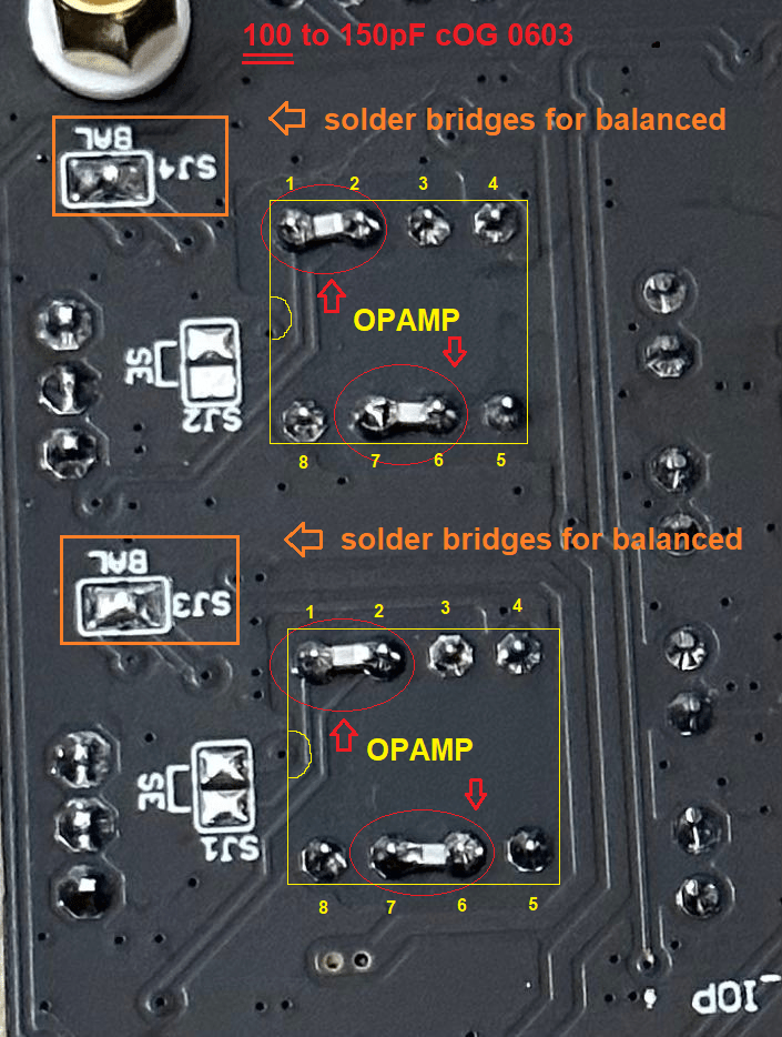

Quza, it would be necessary to show us (please) a photo of the wiring of your input, its diagram as well as the OPAMP used: it would be good too.

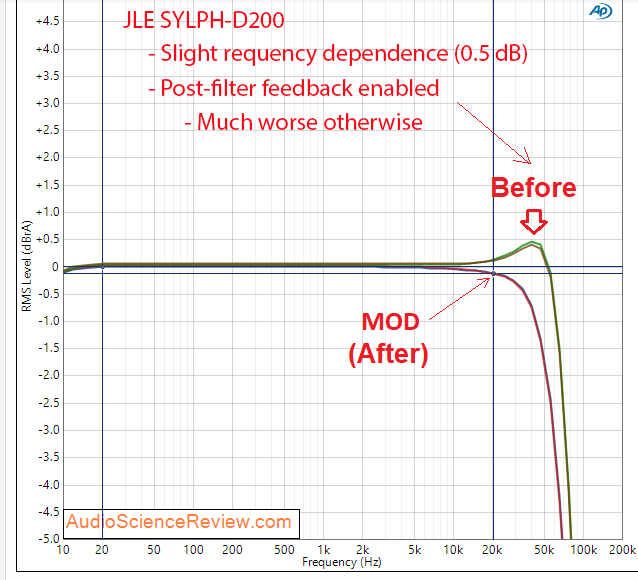

1> At first, do not change anything and activate the PFFB and redo your measurements ->
2> In a second step, carry out the modification (MOD) specified by Lester and redo your measurements again ->
However, check if your PCB does not have this modification already made:
you must obtain 200pF to 250pF between pins 1-2 and 6-7 on each OPAMP for this MOD to be effective 🙂
You should see improvements with each change 😎
Regards.
I think his module already has PFFB enabled and has additional 100pF on the opamp pins.
Last THD graph looks correct since 1kHz has around 90-95dB on it, maybe a variation on the quality of resistor dummy load will slightly affect the result of the measurements.

If the modification is effective and represents well 200pF between the pins of the OPAMP, it seems to me that the correction is too important:
it would perhaps be necessary to put another value 🤔
It would still be interesting to know the OPAMP used and its 'action' on the PCB measurements.

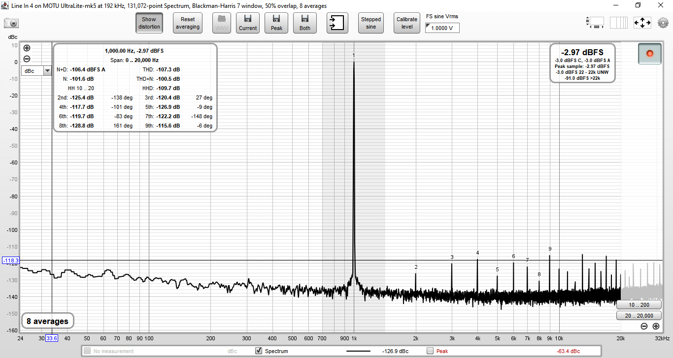

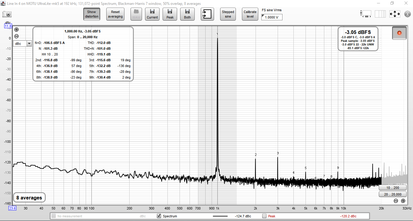

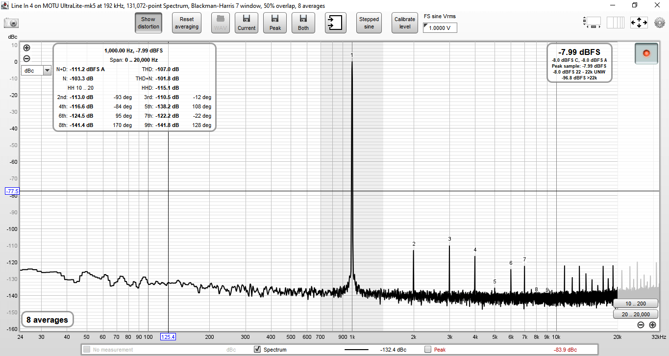

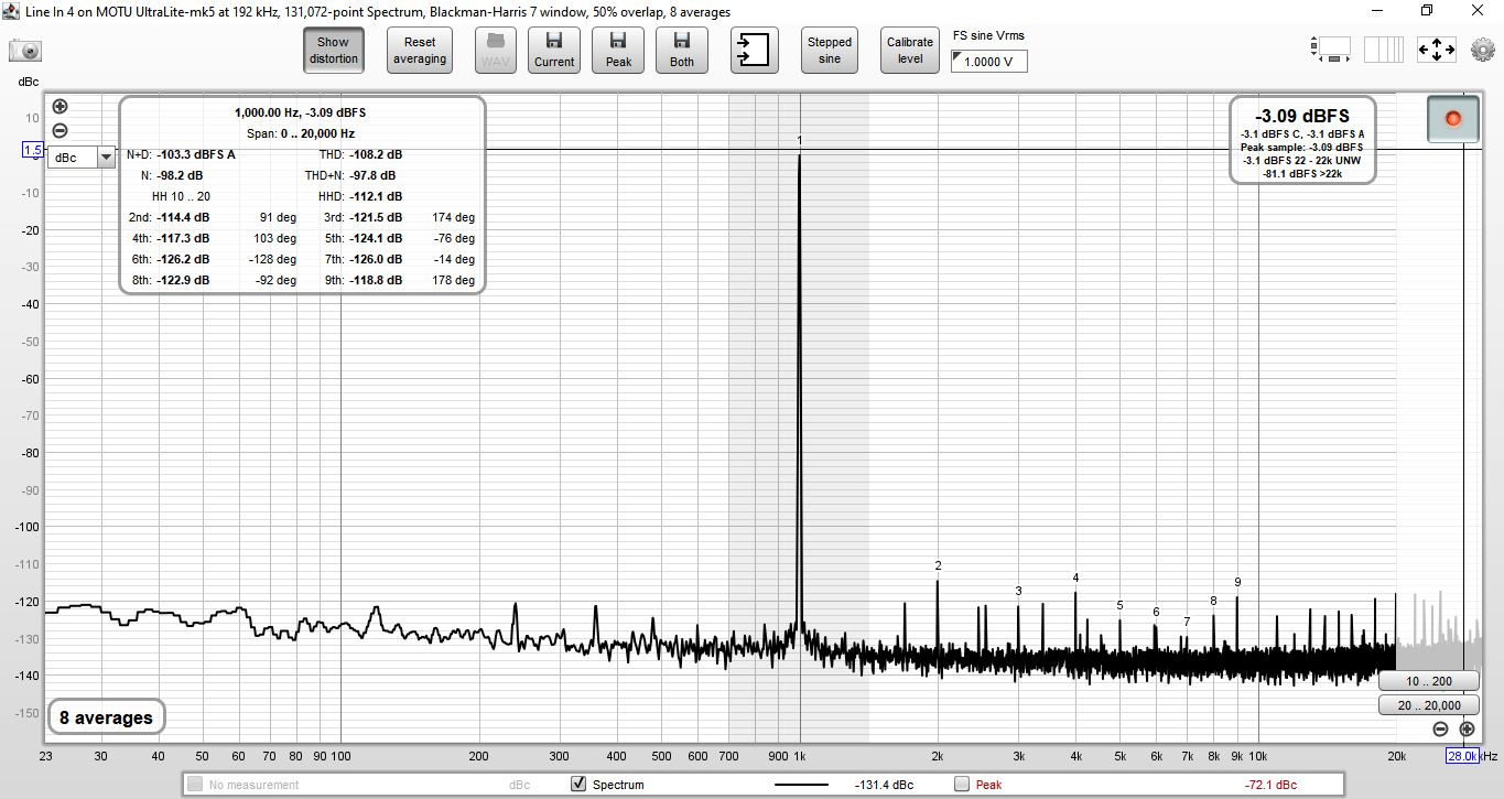

Here are the measurements for Sylph-D400M with modified PFFB.
5W_4R and 5W_8R spectrums, results definitely being limited by the Motu Ultralite MK5 DAC/ADC and soundcard interface
5W 4ohms
5W 8 ohms
4.47Vrms no load
Reactions: bloqhed

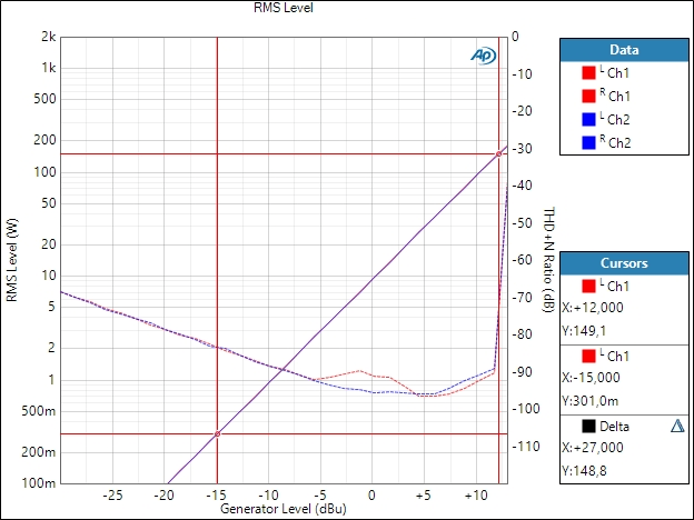

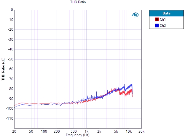

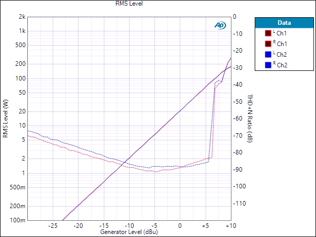

Turns out there was no problem with my measurement setup, but with setting up the amp itself. I used balanced inputs so I connected the solder jumpers for that - but I didn't desolder the single ended solder jumpers.
So here's new measurements, now also with twisted cables all around:
  • Gain: 18.1dB
  • THD+N @1kHz,+4.7dBu: -96dB
  • SNR: 103dB
  • SMPTE: -88dB
  • Maximum Output IEC 60268-3, 4Ohm: 141W @0.1, 165W @1.0
  • Maximum Output CEA-2006, 4Ohm: 147W @0.1, 165W @1.0
  • Maximum Output IEC 60268-3, 8Ohm: 79W @0.1, 90W @1.0
  • Maximum Output CEA-2006, 8Ohm: 80W @0.1, 90W @1.0
I only have one DAC that can put out +12dBu, my DSPs can't do that, so I will not be modifying the amp. I'd be very happy if Lester decided to make DSP boards that can feed his amps, too. 4 in, 10 out, please. 😀
PS: Gain is probably higher by 0.3 to 0.4dB. My cables and filters have -0.4dB when connected as loopback.
Reactions: rrobot
