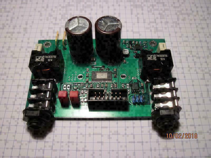

I dislike your attitude towards me. Be aware that I am not obliged to prove anything, if you do not like my comments just ignore them. I appreciate amirs work, but there is no point in measuring a hobby project by him. For your reference I add a picture of one of my PBTL PCBs specially for battery operation. And yes, they measure well with REW and ARTA.
addendum (2018-02)

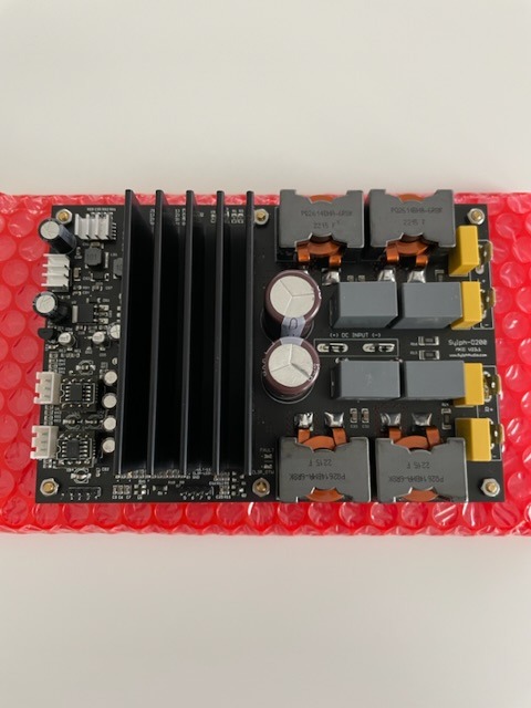

Hello Lester.

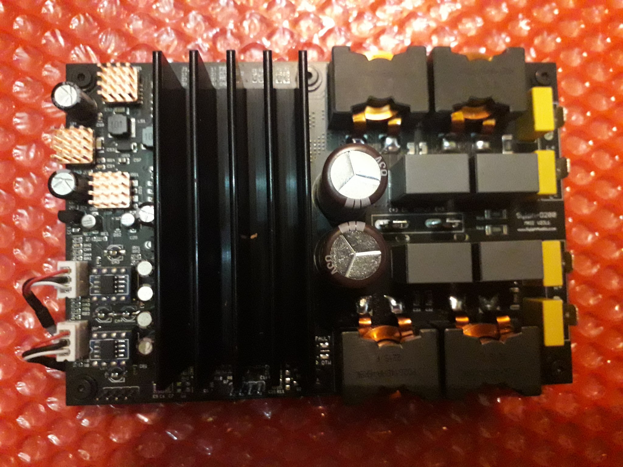

I have a case of which inside is 240x120x49mm (LxWxH). Could I use the case to fit the "SYLPH-D200 MKII"?
I wonder the height of the amp including the capacitors under the bottom is 45mm.
Sylph-D200 MKII will fit in 49mm height chassis. But there's no provision/circuit for hot plugging the 48V supply, so the power supply should be in the same enclosure which I think will not fit in that dimension.
Here's the chassis used in ASR.
Full aluminum DIY 2409 silver power amplifier chassis psu enclosure HIFI preamp box dac case 240*90*320mm
https://a.aliexpress.com/_mPya0Km

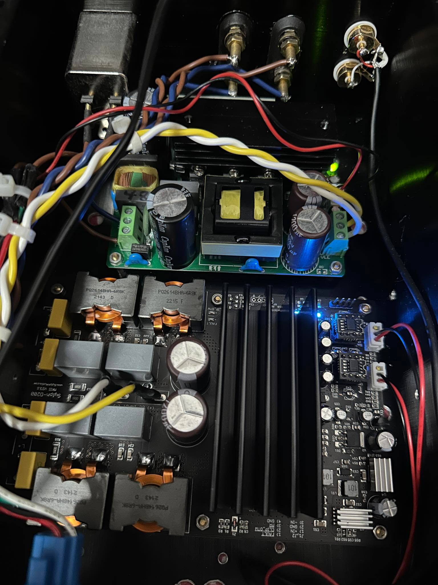

Deleted member 148505
I think I can recommend this power supply for those who are looking for 'cheap' switching supplies.
Just add an external EMI filter, and/or additional filter caps.
I actually like the sound of this smps better than LRS-350-36, though the LRS-350-36 has flawless FFT spectrum measurements.
Sound is thicker, and there's no sibilance (when using LRS-350-36, sometimes it has a slight Zzz superimposed on Sss sound). Though I upgraded the to-220 rectifiers on this and replaced the output filter caps.

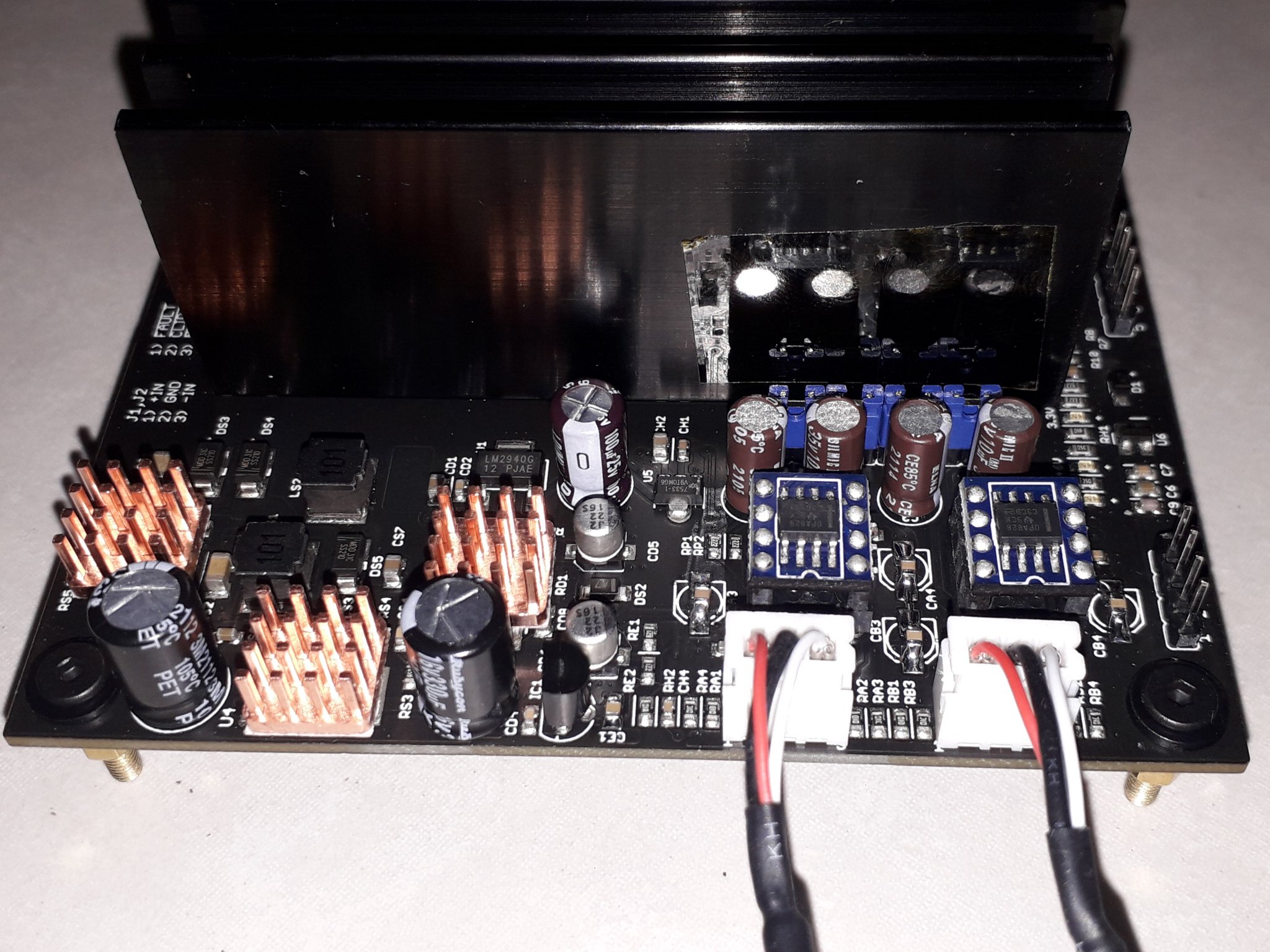

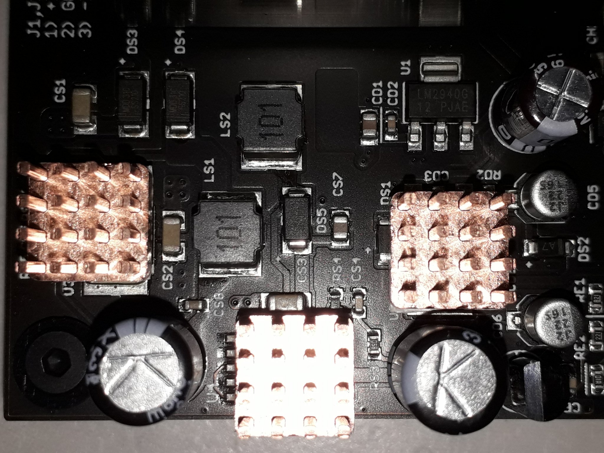

Does anyone know where one can get a pure copper 'heatsink' fot this PCB ?
The ATS heatsink used on Sylph-D modules (and on TPA3255 EVM) might get hot on idle like around 50deg C, but you will never experience overtemp fault condition on near clipping music playback, even on full power sine wave tests, it will hold on its own unlike other retrofit heatsinks which typically have poor contacts on the IC surface, they would not be able to cope up with a sudden large thermal output from the IC compared to the ATS heatsink which is really designed for HTSSOP-44 IC package.
Though sometimes I’m daydreaming of attaching a heatpipe from ATS heatsink going to the chassis so that the idle temp will be better.
