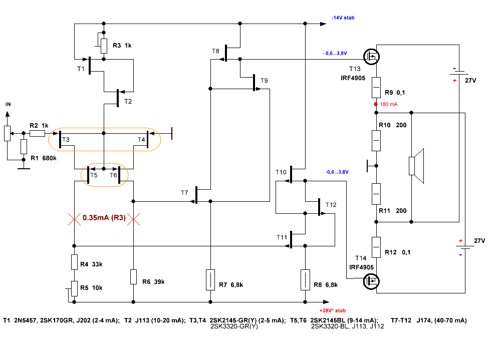

You'd better put together this circuit. Because it's easier to buy 2SK2145GR. We will call this circuit KP2.

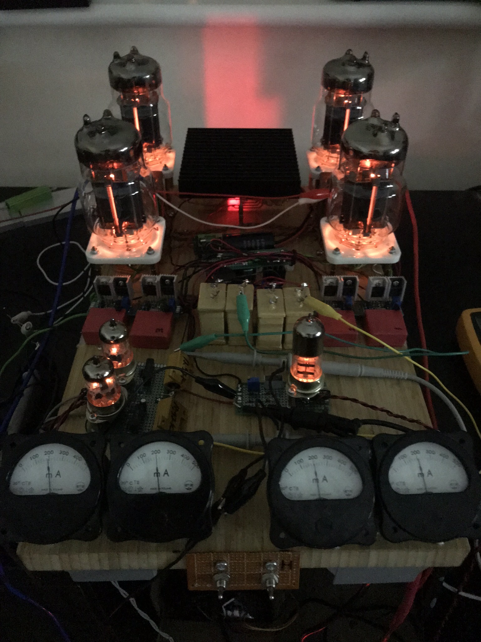

I designed and build my own circlotron with tubes a few years ago and I’m thinking to replace the 6c33c with a power JFET. Want to reach 100W in class A. I already have the cases with 4 huge heatsinks that can host some 16 transistors per side in parallel (with separate bias circuit for each).
Silviu

My amp was sent to my hometown for storage when I moved from Ireland to Switzernad. I think I still have the circuit.
It has a differential cascode with ecc88 a ccs in it’s tail with a pentode (can use a cascode also), 100k 0.01% wirewound as anode loads feeding mosfet source followers (from Bartola tubes). One source follower for each 6c33c in the circlotron output stage.
Supply for differential cascode is +300Vcc/-160Vcc, for source followers is +160Vcc/-160Vcc and for the circlotron output stage it’s 2x140Vcc
All supplies are regulated from 230/230 & 230/120 transformers, output stage supplies are SMPS. Each stage has it’s own separte supply.
Everything is fully balanced from input to output, feeding a ESL63 electrostatic speaker.
