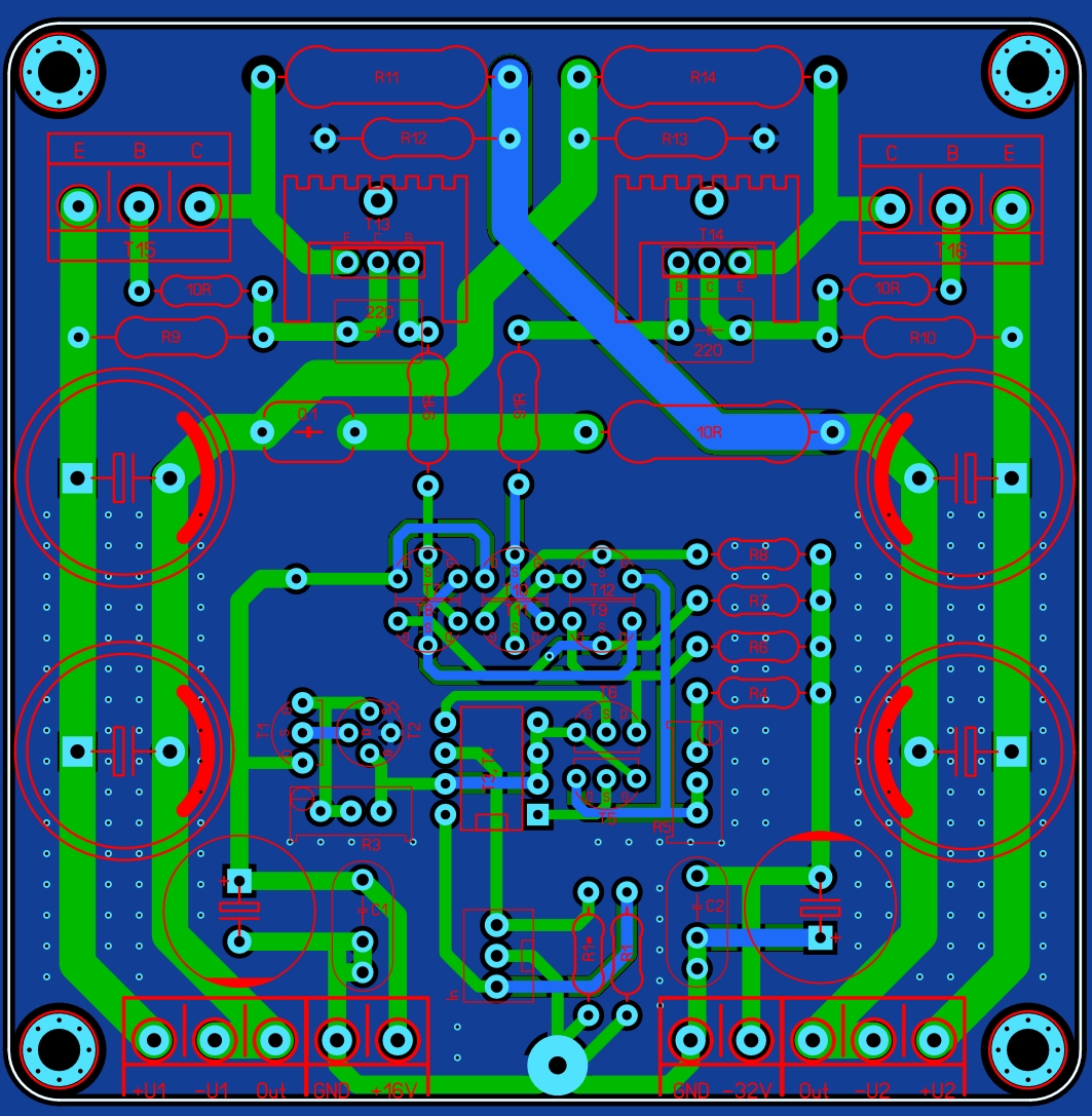

Upgraded the printed circuit board under the Germanium output transistors.

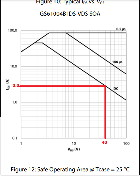

With lower voltage and power variants what worries me is the safe operating area. For example for 61004 if you have Vds=40V then you can go upto 2.5A. What is your opinion, because many times I choose FETs based on SOA and I end up with high power and voltage variants.
If you look at the graph, then with a power supply of 40 V, the maximum current is 3 A. This is at +25 ° C.

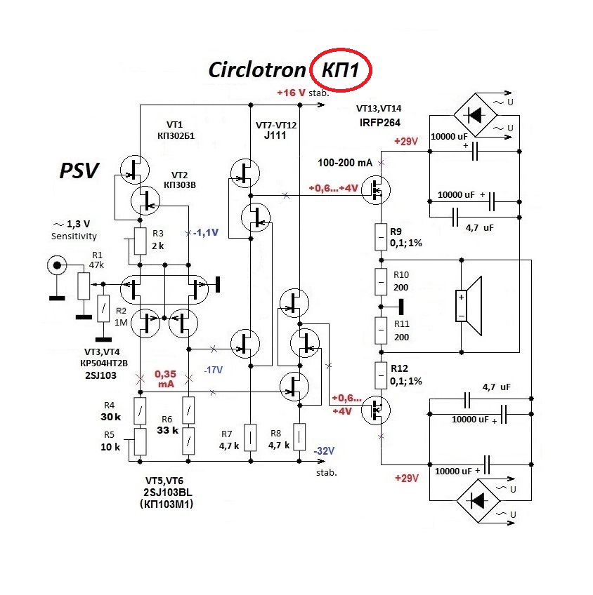

For this circuit KP1, these transistors should fit. It is not known what maximum power can be obtained with these transistors according to the KP1 circuit. And what is the output impedance of the amplifier.

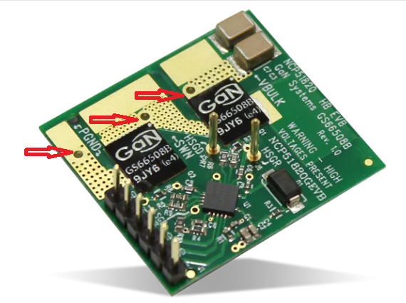

the BEST solution is to make bare 2mm copper pad. Other solution is to buy different package GS66508B-MR GaN Systems | Mouser Europe and to make aluminum substrate pcb. GAN GS61004B for 100 V will work safely until 30V@1,2A. 45V@1,2A might be too dangerous
Hmm so even lower from what I suggested. So we need another FET and for sure I need something with higher power for another application. In any case, I am considering the options, because distortion numbers from simulation were very promising...
Levelup says much lower and don't expect these to work at 25C, i believe much more. So we need a more powerful but I see we agree for SOA consideration. Which schematic is the KP1?

The KP1 bias voltage seems right.
For now the simulation I had run was on Class A, not circlotron. I will put it on circlotron simulation and see what happens.
